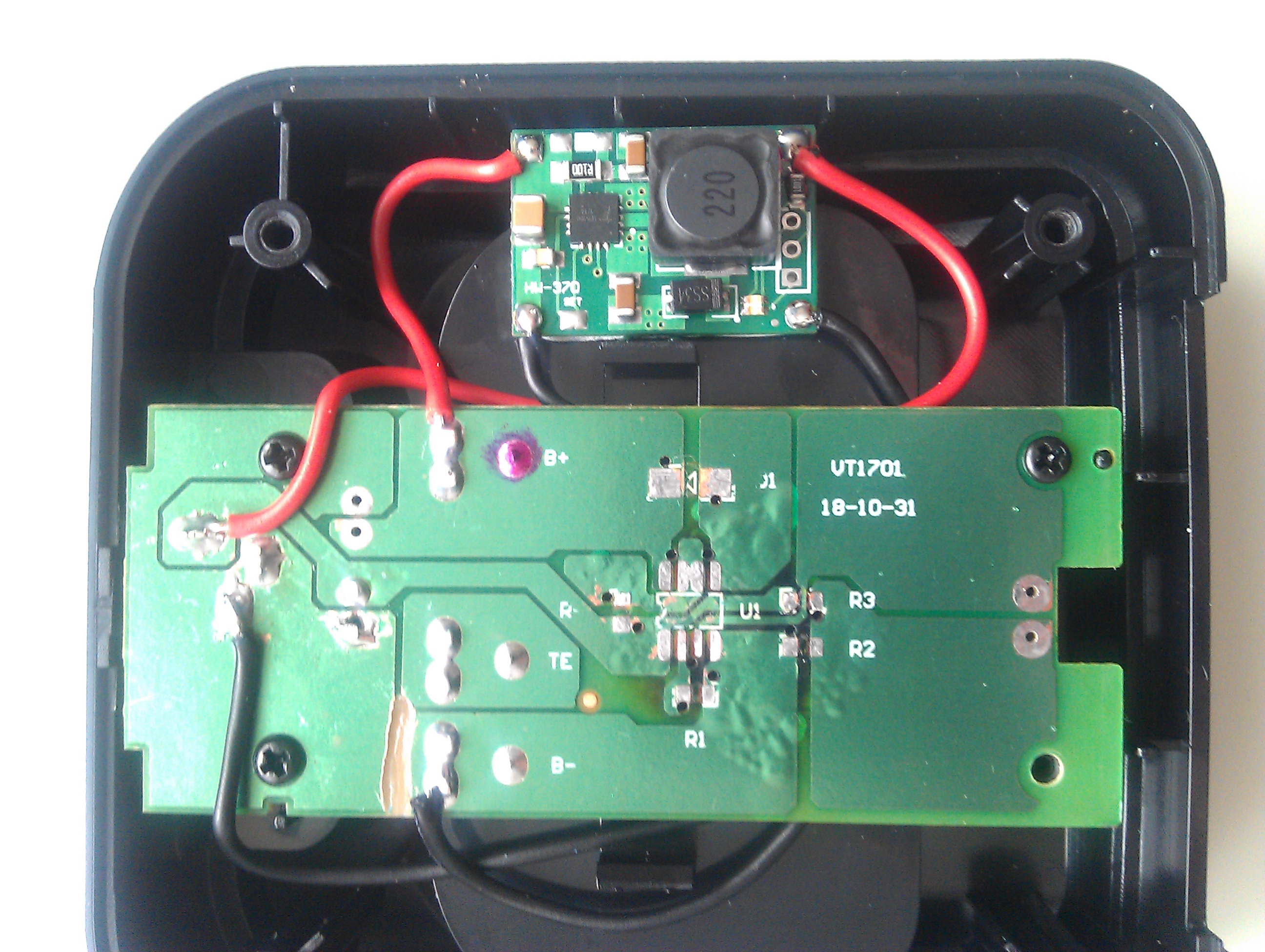

    TP5100 module.
    1A charge, 10-18v input

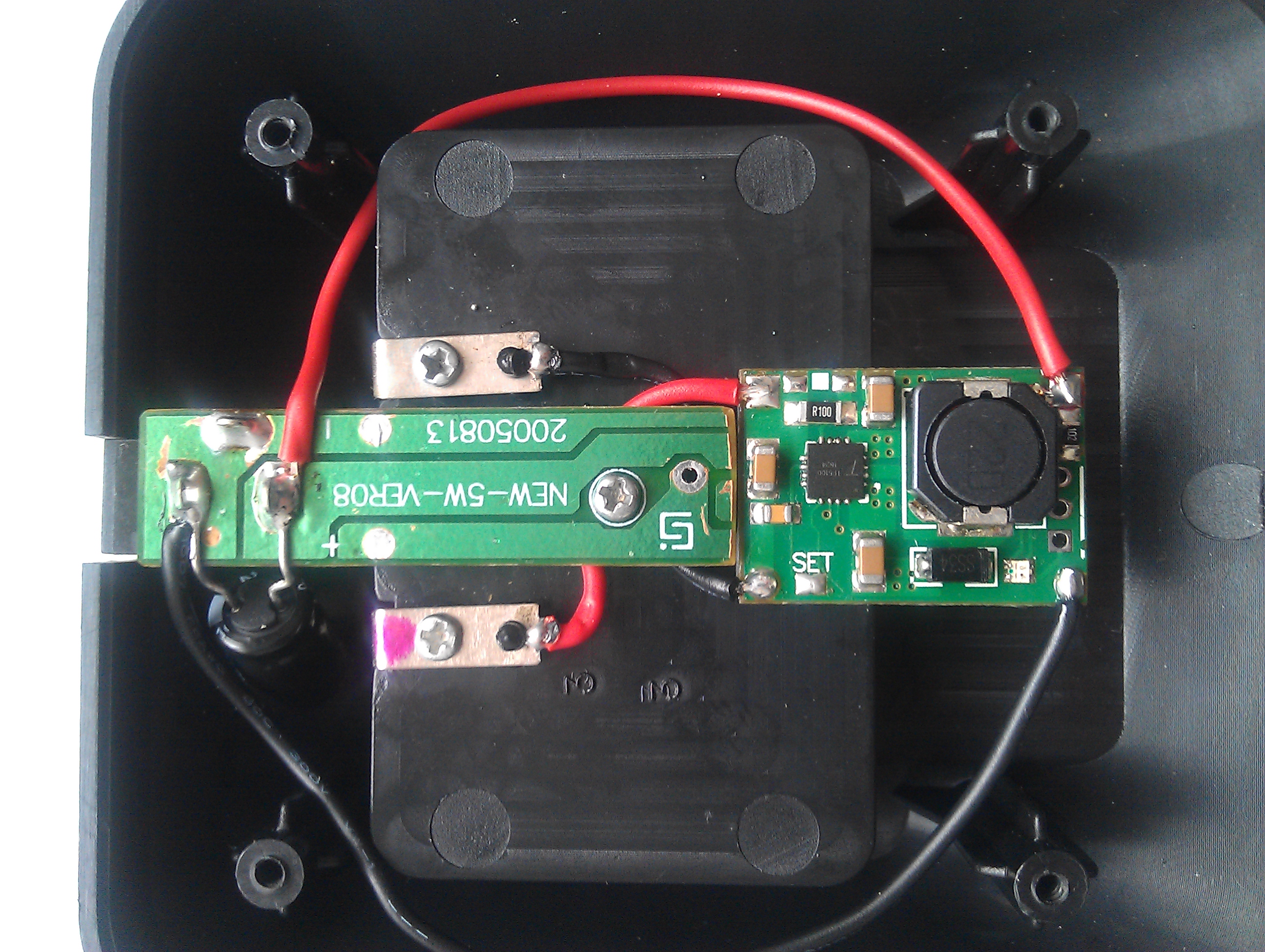

    How well dose it work
    So goes to a radio receiver
    Three different models
    In the last picture what type of ic chip was there
    I like your idea for this mod

      all those bases had the same circuit, sc6038 based linear charger.
      slow as fuck with a 10v maximum input.

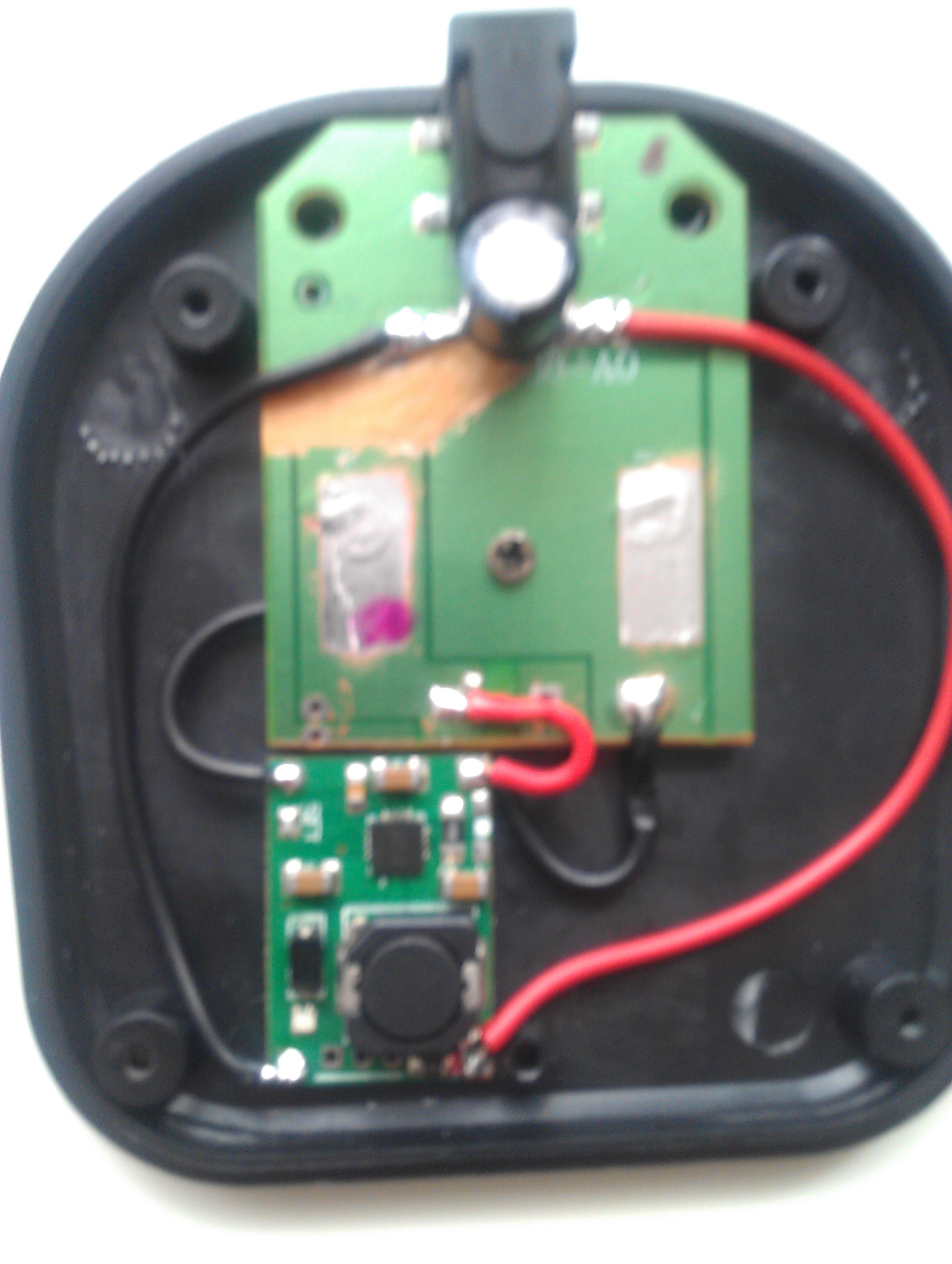

      what you cant see is that i sliced 2 of the boards up to retain the input connector and mounts.
      it works well - upto 2Ah charge(i set it to 1Ah) and it smart-charges a 2cell lithium pack.
      older iCOM stuff could really use this mod!!

          old circuit charged an 1800mA pack in about 6hours!!
          it's a compromise,
          they used a linear charger so you could keep the radio on in the base,
          but because it's linear they had to keep the current low and the voltdrop to a minimum(10v) to keep it from getting hot!
          i did not try to run the radio on the base now, but i bet there is lots of rf noise from that inductor!

            Based on what mine was before it croaked, it was set at a charging current limit of 400mA, so 1.8Ah in 6h is about right taking in account absorption phase and charging inefficiencies.
            At 400mA the chip would have to dissipate 1W+ which is excessive for a SOP8 IMHO.

              you should get one of those modules - they dont even warm the case up!

                  to set the board for a 2cell pack you blob-link a pair of pads,
                  to switch from 2Ah charge to 1Ah you remove one of a pair of 0.1ohm shunt resistors that are in parallel
                  the board has leds on it - you can see it through the case - but i want the original look so i ordered these:
