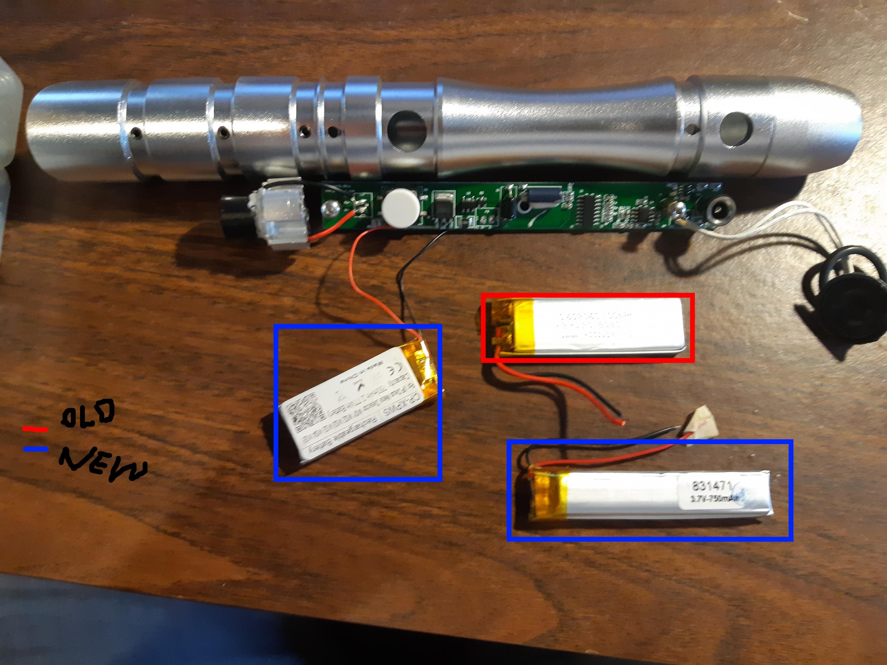

    hello everyone, I am attempting to replace a battery on a toy light saber for a friend. I finally found two batteries that actually fit in the hilt.
    The original battery is a 3.7v 700mah lithium ion cell charged through a barrel plug in the hilt, via cable into any 5V usb type A slot.
    the only replacement batteries I could find are 3.7v 750mah batteries and when they are connected, a small component on the edge of the board and a screw post (to secure the board inside the hilt), get very hot. I figured that the board could must be using the hilt as a heatsink since it's milled aluminum, but the components make a lot of heat while OFF! the battery doesn't seem to get hot, but I haven't left it connected for more that 10 or 15 minutes out of fear of burning out a component.
    Could the 50mah bump on these batteries be causing this issue? does the thickness of the wires from the batteries matter? they are slightly different from each other.
    I'll add some photos if necessary

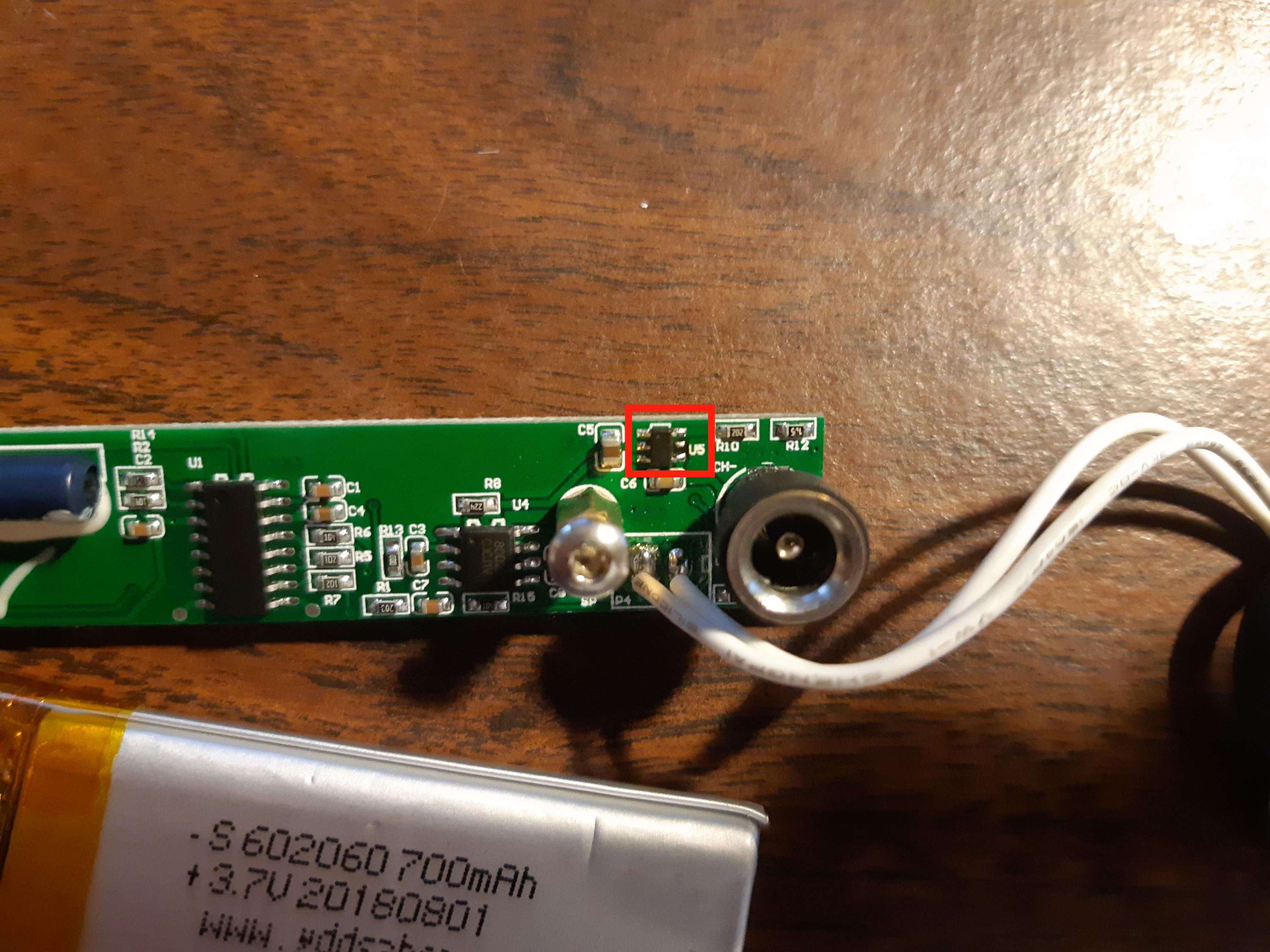

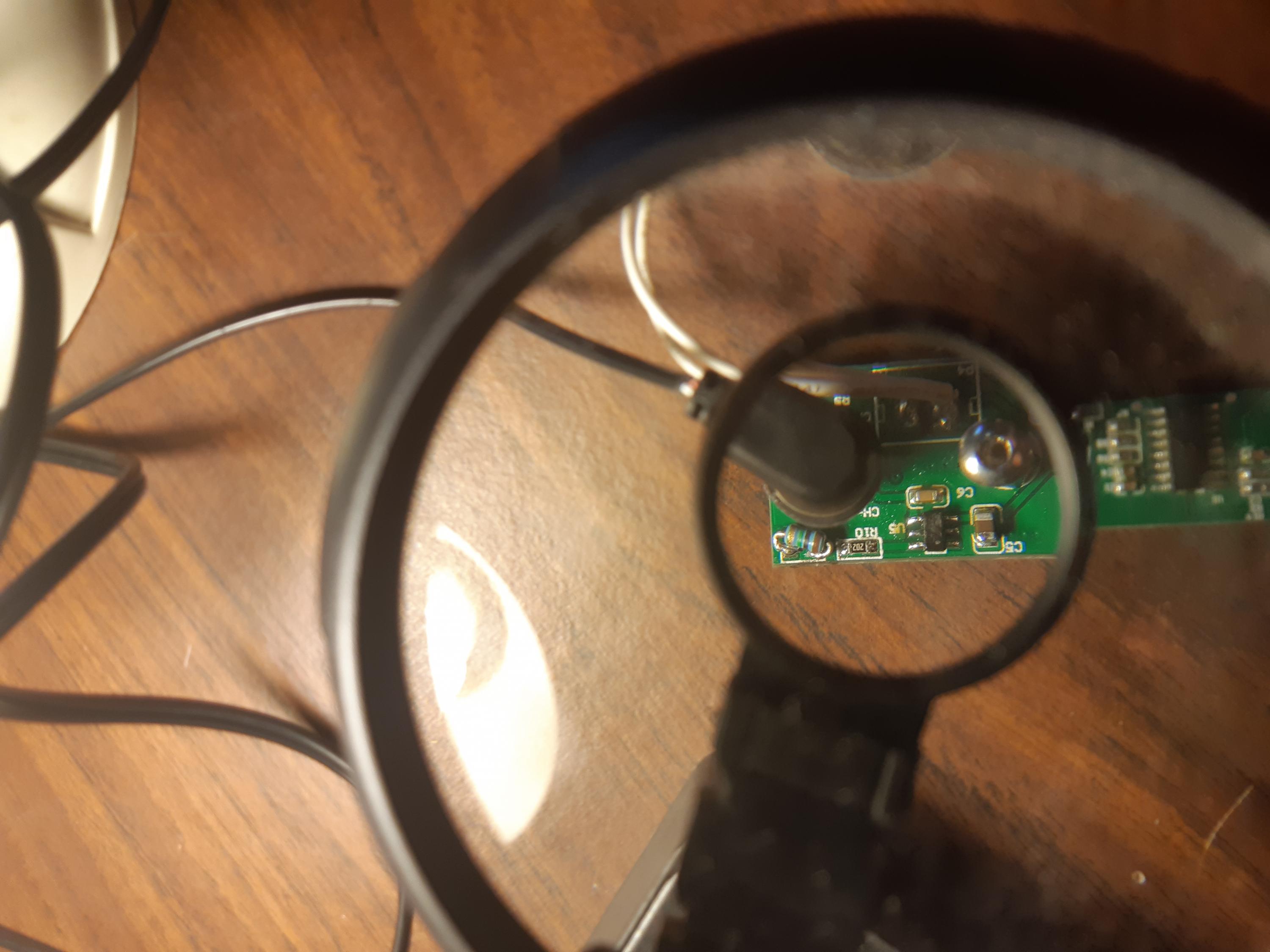

        Re: YDD Light Saber repair

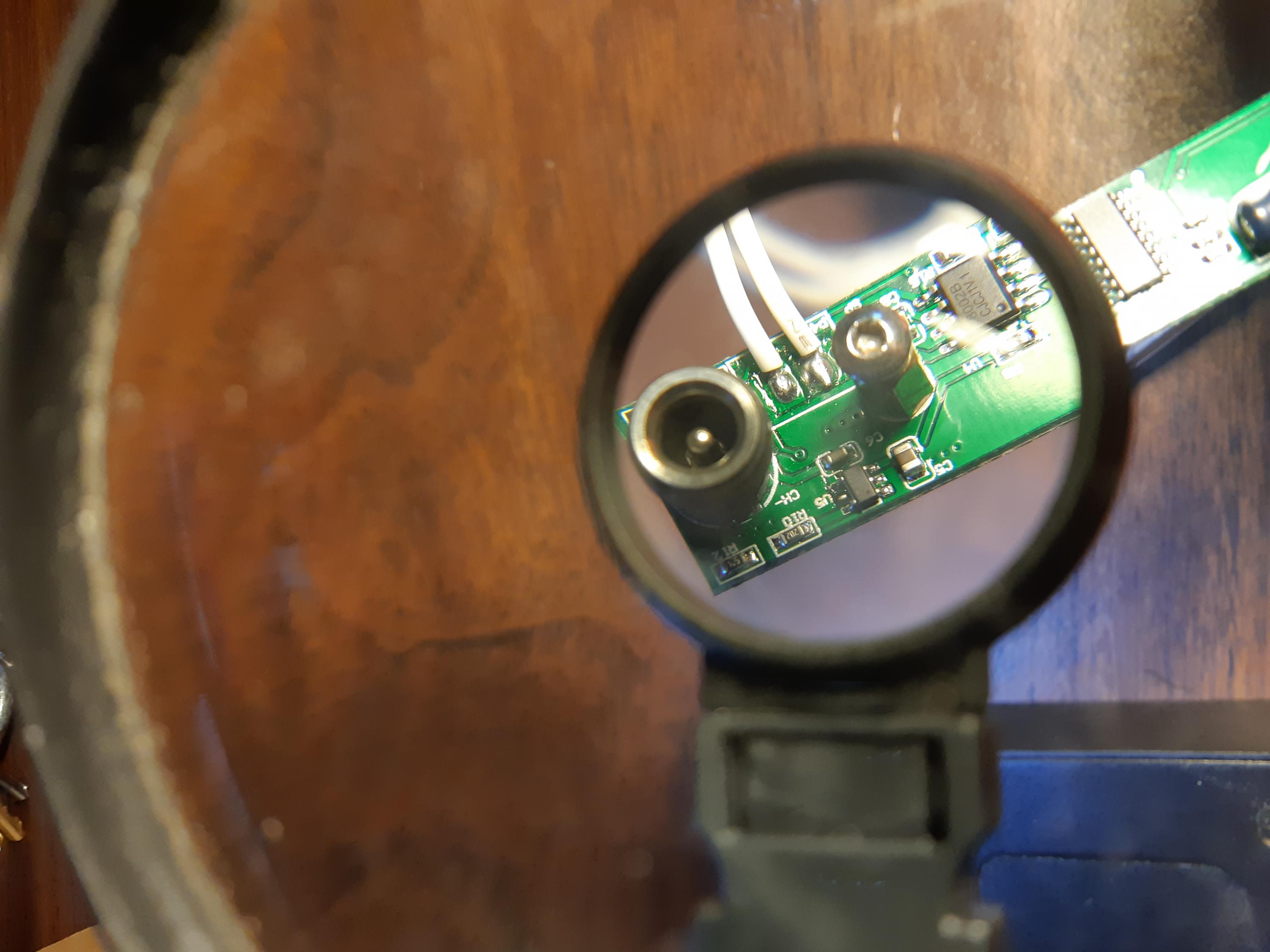

        Okay, here's some pics to help this make more sense.

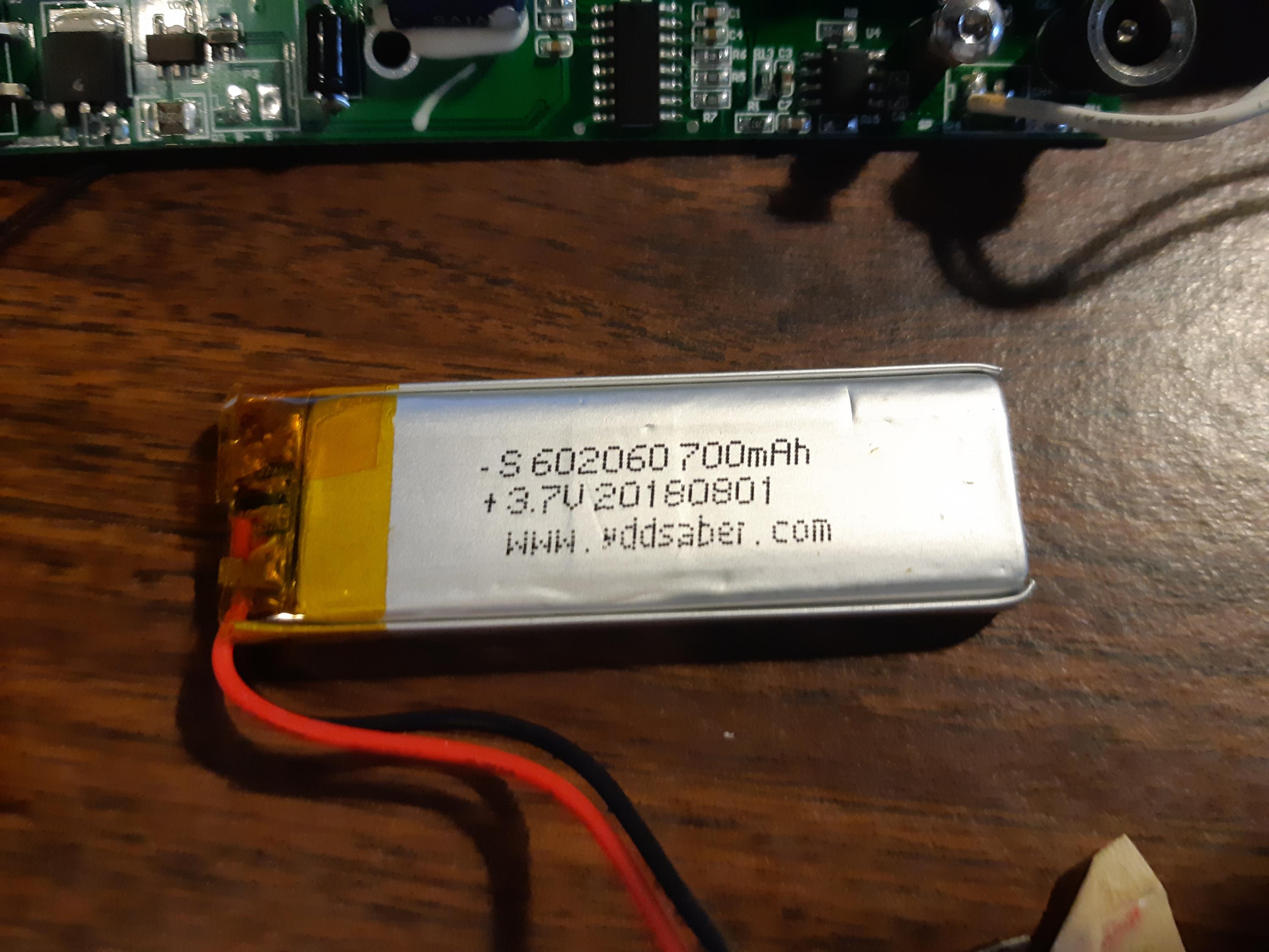

        First pic is the original battery; The website leads to a dead domain, I've tried contacting them on facebook and ebay, but they will not sell replacement batteries.

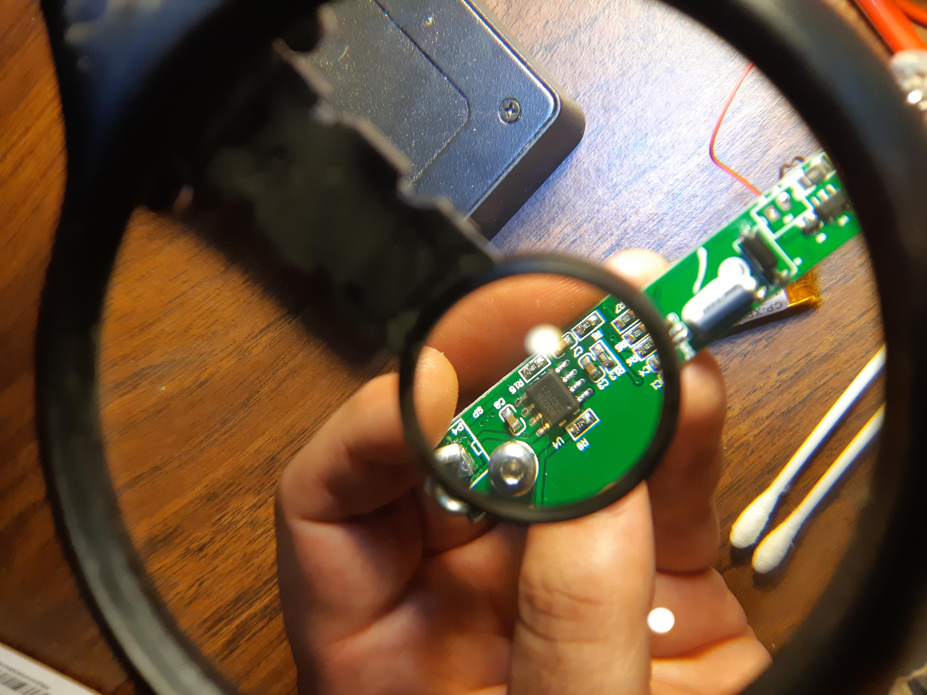

        Second pic a close of up the IC that gets hot

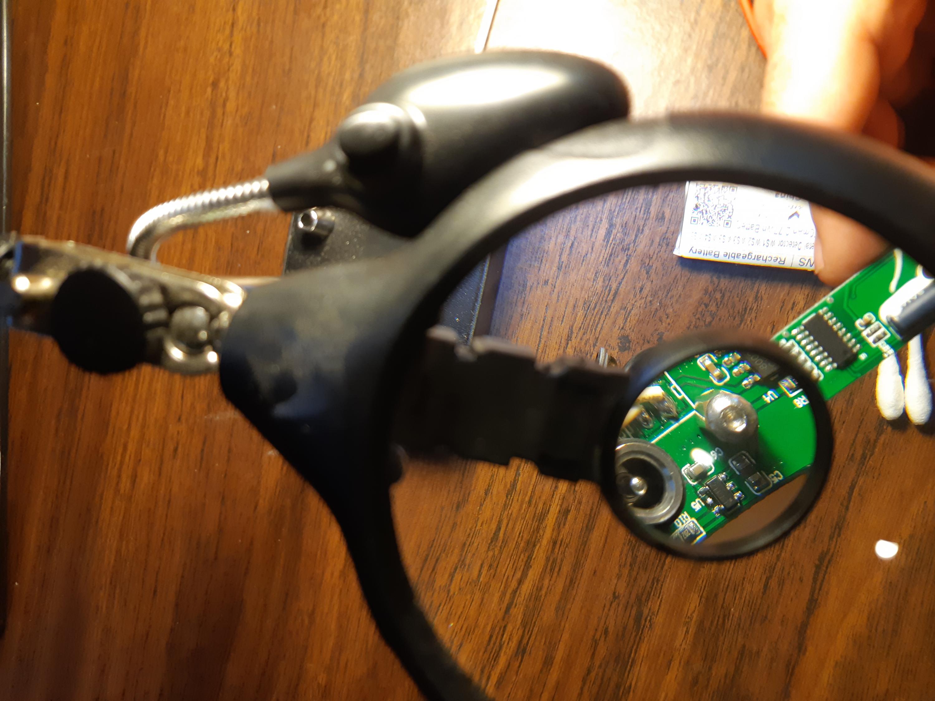

        Third pic shows the board in relation to the hilt. You can see two screw posts that mount the board to the hilt, only the post on the right gets hot.

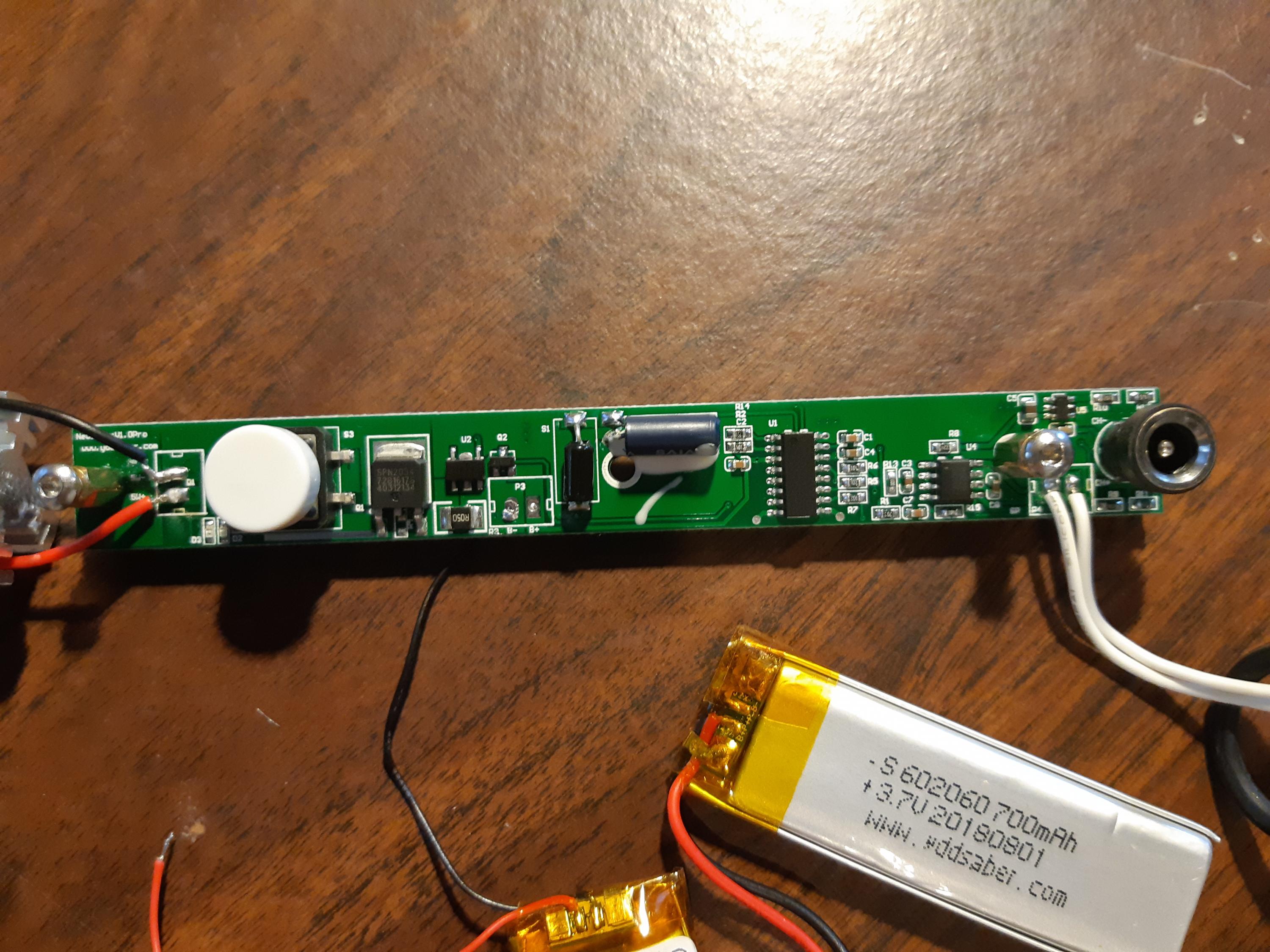

        fourth pic is a close up of the board at full length
        I hope this helps.
        The device functions completely when I close the circuit with the battery, but the component gets hot, and I don't want to fix something just to have it break.

          602060 is the battery size.
          why does R12 look damaged?
            Can you read what is printed on IC U5? It looks to be some kind of Voltage regulator.
            Is there an insulator washer for that metal post so the post will not short out the copper traces under it?

                it appears to be unmarked, but take a closer look if you'd like

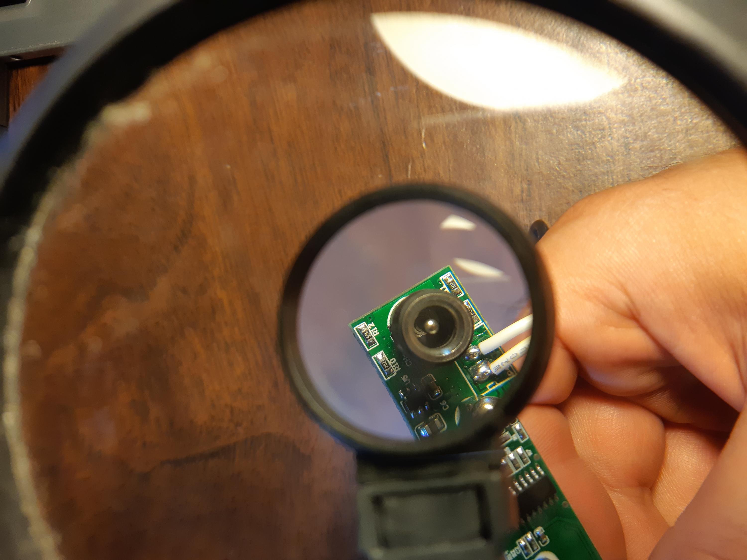

                  https://www.badcaps.net/forum/attach...9&d=1595621882
                  Did you try removing that metal screw post and inspect the copper traces under that metal screw post? it looks to me that the metal screw post can make contact with many traces of the board if no insulator washer is installed under the post.
                  Remove the post and see if the IC still get hot or not.
                  Also check the RESISTANCE of C5 and C6.

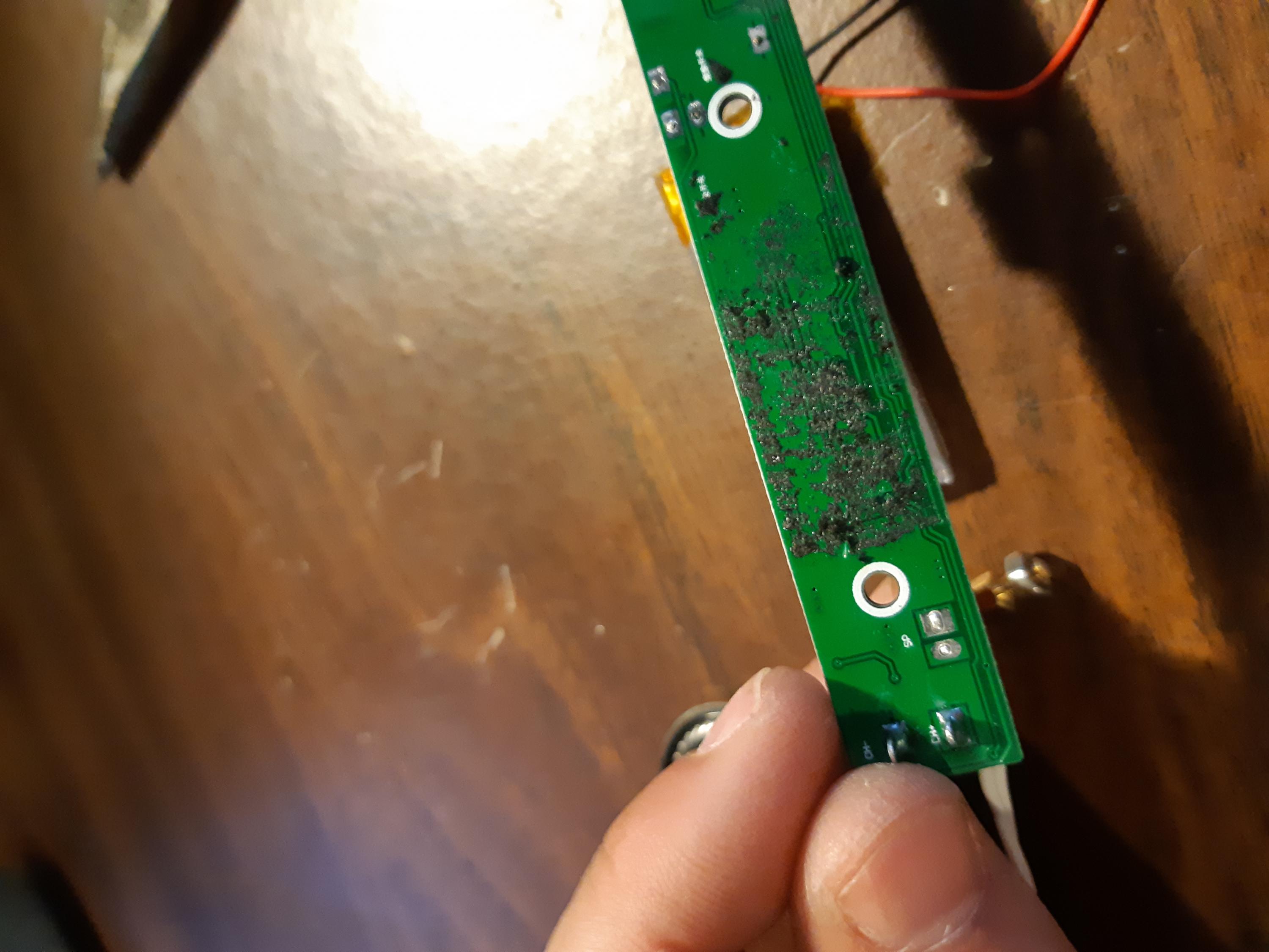

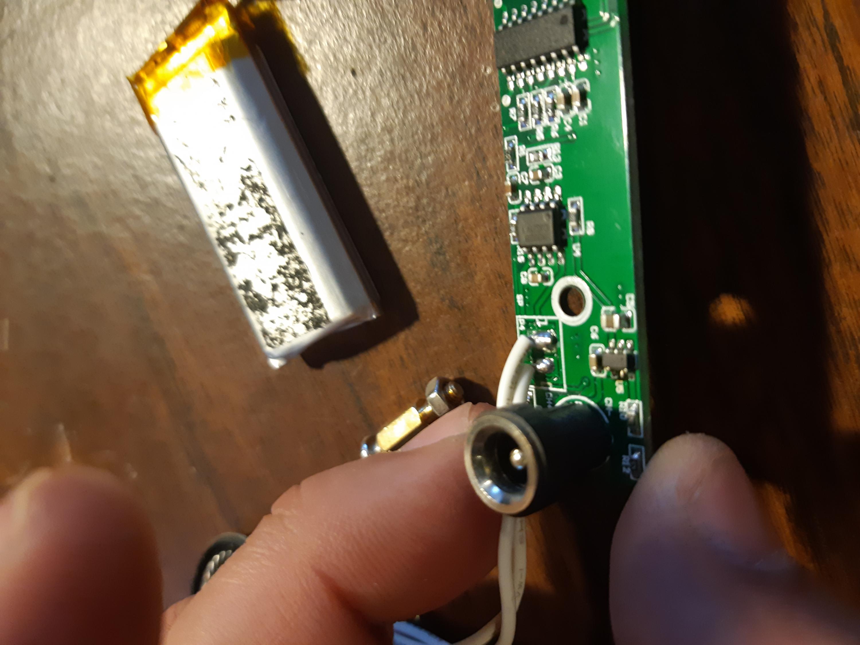

                    I removed the post, and the IC still gets burning hot, in a matter of 10-15 seconds. I'm not super skilled with a multimeter, and mine is german for some reason (I'm in canada). If the info I provide is wrong, let me know and I'll try again. I moved the dial over to the ohm section and chose the smallest increment; 200.
                    C5 reads a resistance of 13.0, and C6 sits at about 142.9-142.2
                    R10 won't register until the I select the 20k range, it's measurement is: R10: 2.01
                    R12 won't register reliably until I move to 2000k, my result moves around a lot, from a negative value of -400 to a positive value of 318.
                    R12 seems busted, and I don't have the means to replace it. This toy was dropped off to me because the battery no longer charged or worked at all. Could a bad resistor kill the battery? I know a small shop in town that should be able to fix this for me if they have the replacement part.
                    I've attached some pics of the board with the post removed. I don't see any traces or contact points, but those could be sandwiched between the fiberglass.

                        I've attached a pic of U5 and U4, it's hard to read, but some characters are stamped into the top. it appears to read "LTH7"
                        U4 reads "8002B" and "CJCJ1V 1"
                          Originally posted by Skunch
                          Yes, C5 and C6 are on the 200-Ohm scale
                          8002b is the amplifier IC, pin 6 is Vcc, pin 7 is GND.
                          LTH7 (LTC4054) is the Li-ION charger control IC.
                          https://www.sunrom.com/p/ltc4054-lth7-sot23
                          C5 (13 Ohms reading) is connected to BATT pin 3 of LTH7.
                          C6 (142 Ohms reading) is connected to Vcc pin 4 of LTH7.
                          When you test C5, is the battery still connected to the board?
                          If not, I would remove LTH7 and see if the 13 Ohms reading gets higher resistance.
                          BTW, you did not accidentally connected the battery in wrong polarity at any time, correct? That can damage the IC.
                          You can see how the LT7H connected compared to the application circuit, it is connected just about the same a shown in the spec sheets.
