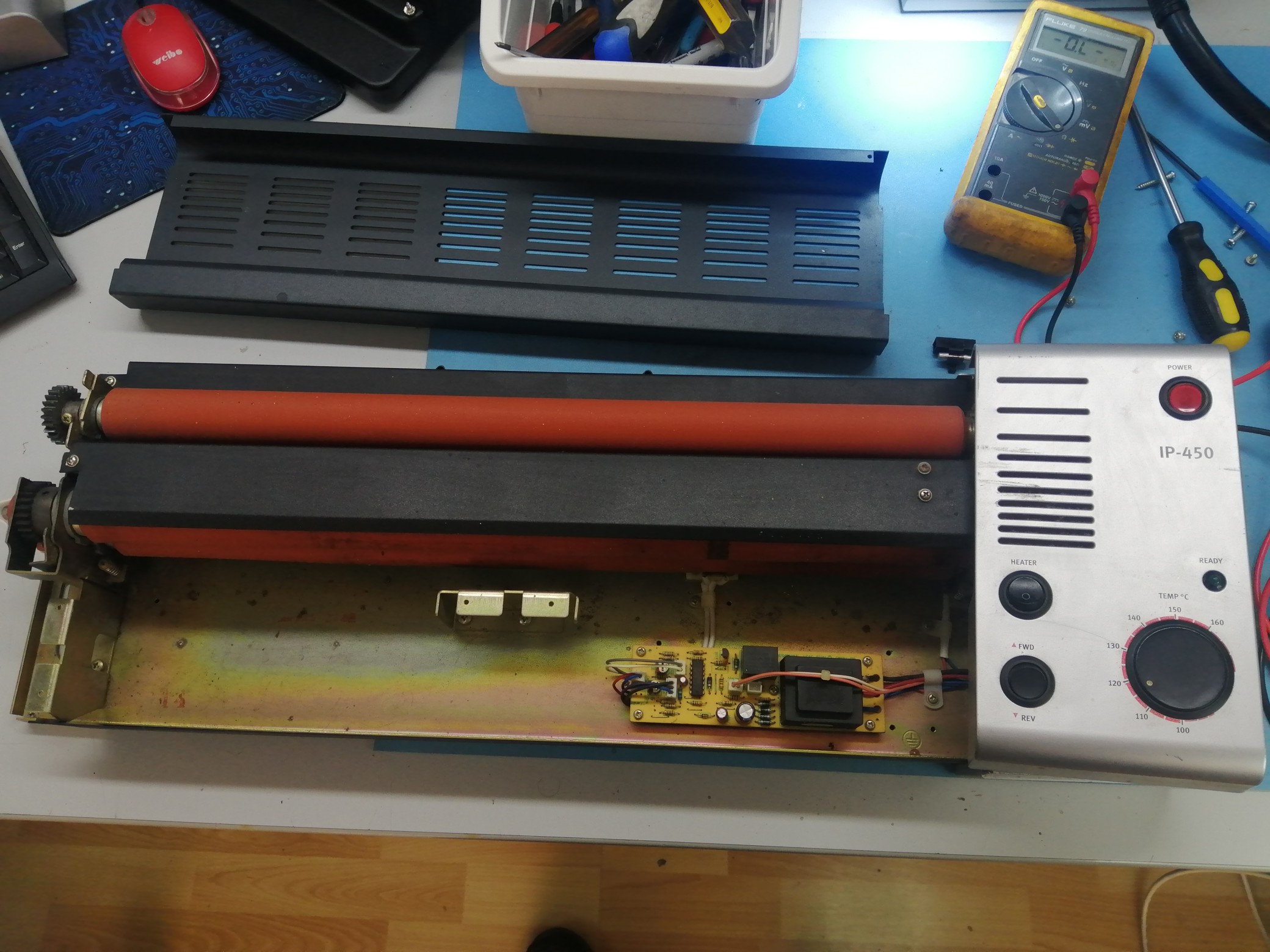

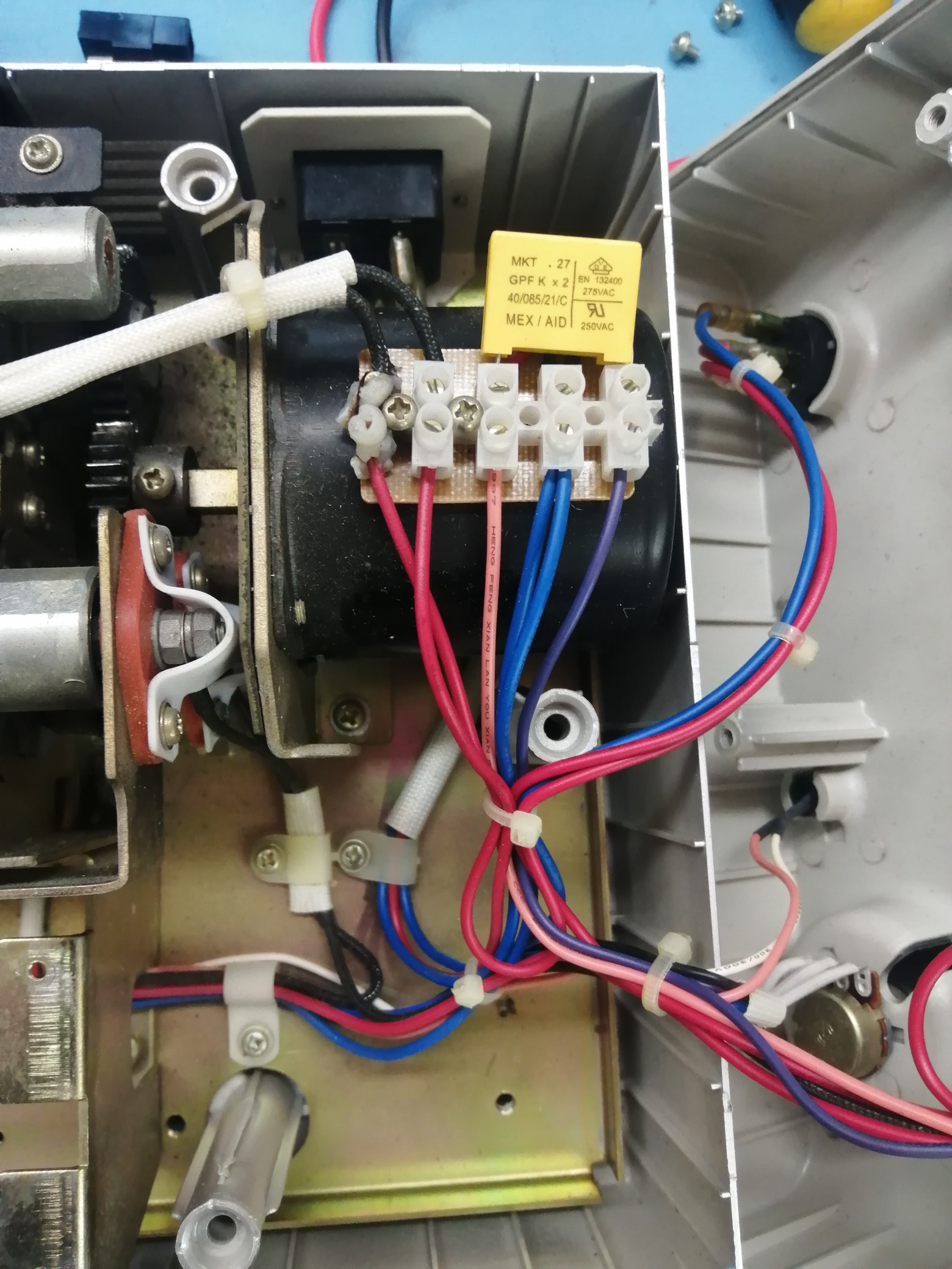

    So here is a 'weird device' it is an IKON IP-450 A2 Paper laminator
    The customer says it was warming up then suddenly tripped out the 220V mains
    He replaced the 5A fuse which had blown but it did the same thing straight away as soon as powered on, it trips out the power in his apartment. He tried another power lead and tried it at a friends address but the same occurs
    So he brought it to me, having fitted a new fuse again.
    I plugged it in and it worked fine - it was drawing about 3Amps and warmed up to maximum working temperature no problem in about 5 mins.
    Having scratched my head as to why, it occurred to me the only thing I was doing different was that I had it connected to my 220V isolation transformer.
    So I connected it to a normal power outlet, it blew the fuse instantly and tripped the mains out. The fuse is vapourised.
    I then replaced the fuse, put it back on the 220V isolation transformer and it works fine

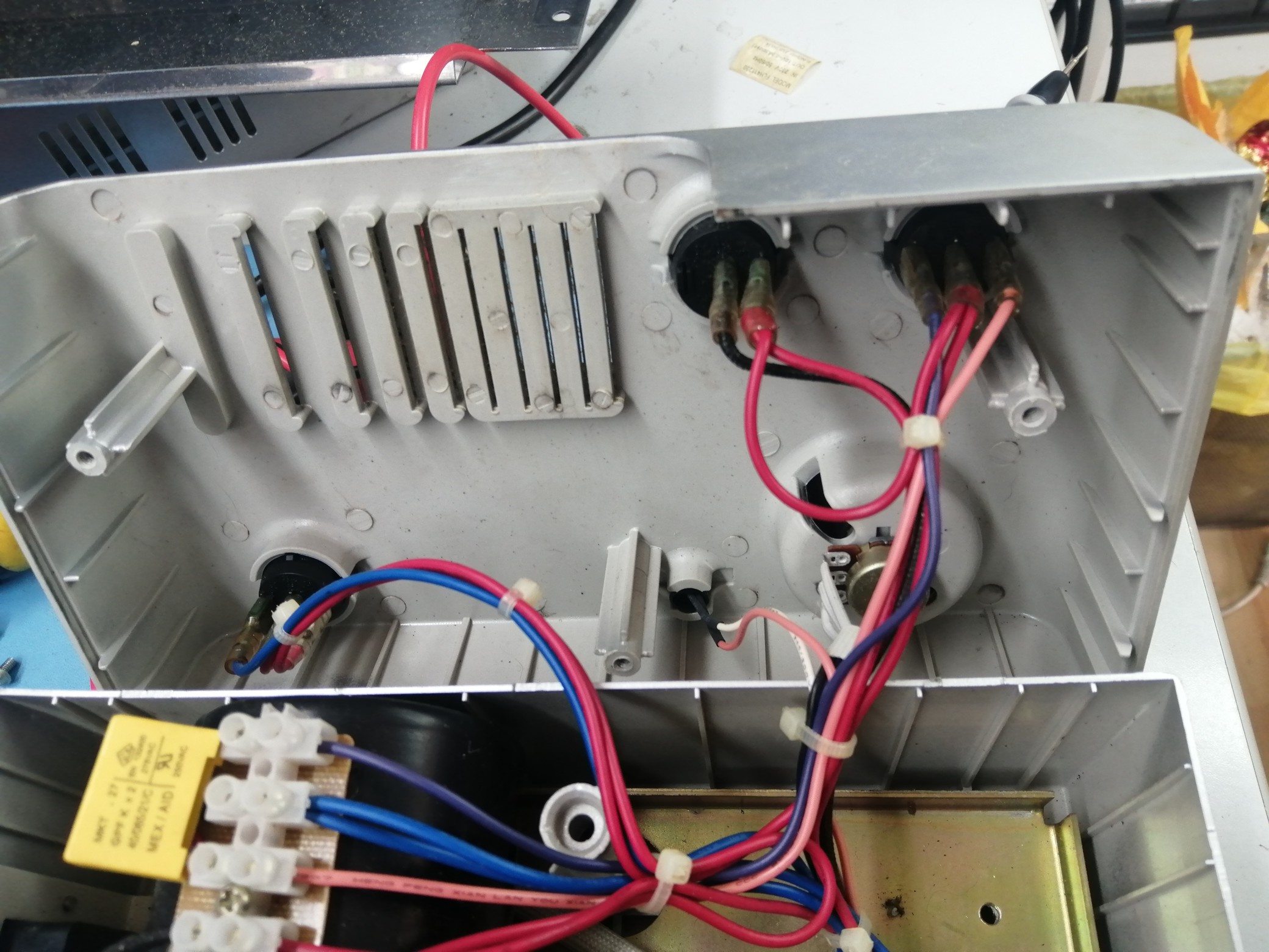

    Thing is I can't see any shorts to explain this, either across the power or to ground. The heating element does read short circuit on my multimeter, but it obviously works OK.
    The only thing I can see is one of the plastic terminal blocks that connects the power to the heating element has melted and looks a mess, but there is no short form this terminal to ground or to the screw next to the terminal block
    So what's going on and why does it work on the isolation transformer?

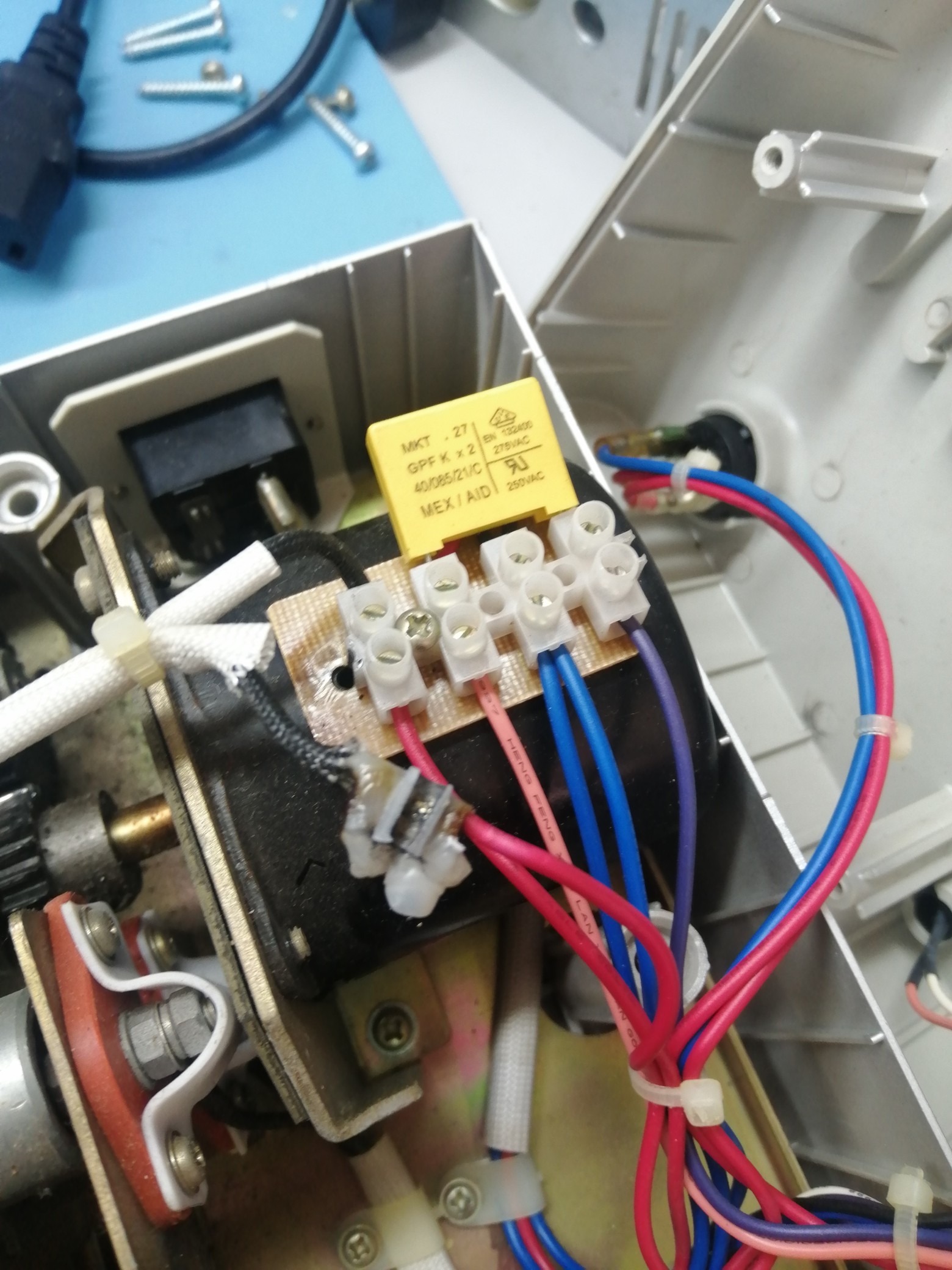

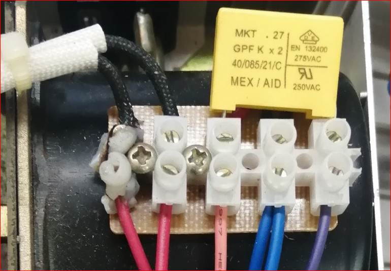

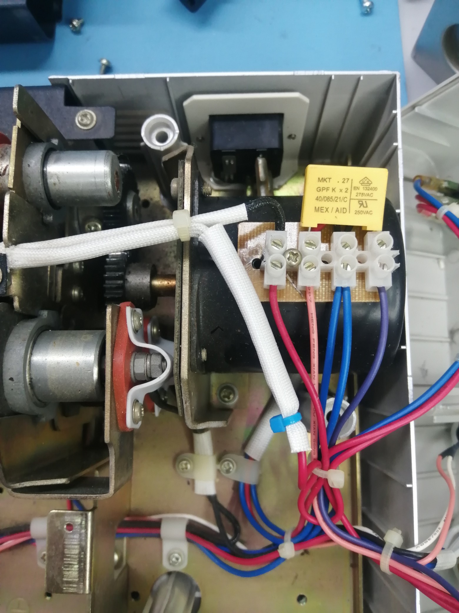

                Look in the pic, the terminal block has melted and is shorting to the mounting screw.
                    Yes I thought exactly that as well. And as I posted on the OP I checked the terminal to the screw (or chassis) reads open circuit

                      • redwire
                        • Dec 2010
                        • 3912
                        Re: Laminator blows fuses and trips the mains - but not when on my ispolation transfo
                        Uh, give it a wiggle

                          and a good place for a ceramic terminal block and bootlace-ferules!
                            OK it's fixed. It was that screw where it went through by the melted terminal block. It read open circuit from the terminal to the screw on my multimeter, even if I tried waggling the connector which actually would not move. But once I removed the screw and cut the melted part of the connector away I could see there was some bare metal inside and it had been arcing in there.
                            I didn't have any ceramic connector blocks so I soldered the wires and used heatshrink and then that white heatproof sleeving.
                            It works fine now
