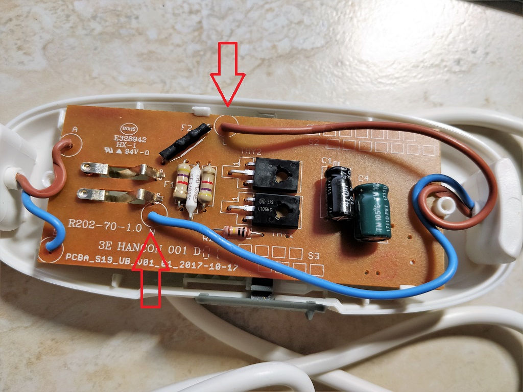

    This is an electric blanket, from the LIDL brand SilverCrest
    Issue: Not working (of course, what else!)
    First thing I noticed is that when I check the input voltage (which is AC, as there is no transformer in between) on the positive and negative of the wire that's connected directly to the board from the plug, it's measuring 2VAC ( I am attaching a photo and marking the AC in). PS. There's plenty of stuff going on on the other side of the board (although nothing looks burnt out). Just want to start from the basics
    As a newbie, and for the learning purposes, the first question would be:
    As a device (an electric blanket), does it need to change current from AC to DC? Are there devices that actually run on AC, and if there is, why is that?

    Re: Troubleshooting Electric Blanket
    If you only measure 2vac where the cord connects, don't you think the fault would be with the cord? or the plug?
    The blanket element is supplied with ac also and controlled by the scr's
        Sorry forgot to mention that I already desoldered the connections and tested the voltage directly, and it measured ~240.
        Thanks for the explanation about the AC. Am I right to say that the SCRs are the two black components next to the caps?

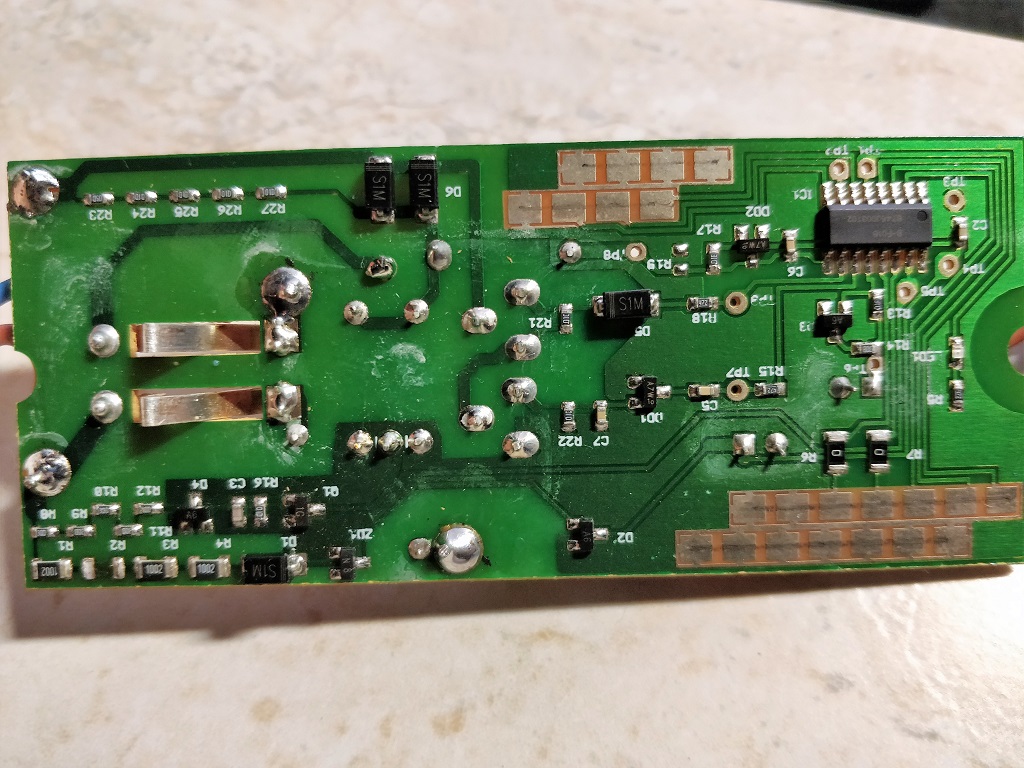

          This is the other side. "There's plenty of stuff going on on the other side of the board" was a little bit exaggerated
          EDIT: Pads on the top control the timer, pads on the bottom control the temperature.
            So your measurment in post #1 was wrong? and you do have 240vac across the two points with the arrows? If that is the case, check both fuses F1 and F2 (white) on the board. If they are ok, Check the voltage across C1 & C4. also check the resitance across the two wires going to the blanket, it could be the blanket element is open.

            • Harvey
              • Apr 2007
              • 264
              Gotta love how the live wires (240V) have been crushed, by the screws that hold the case together.

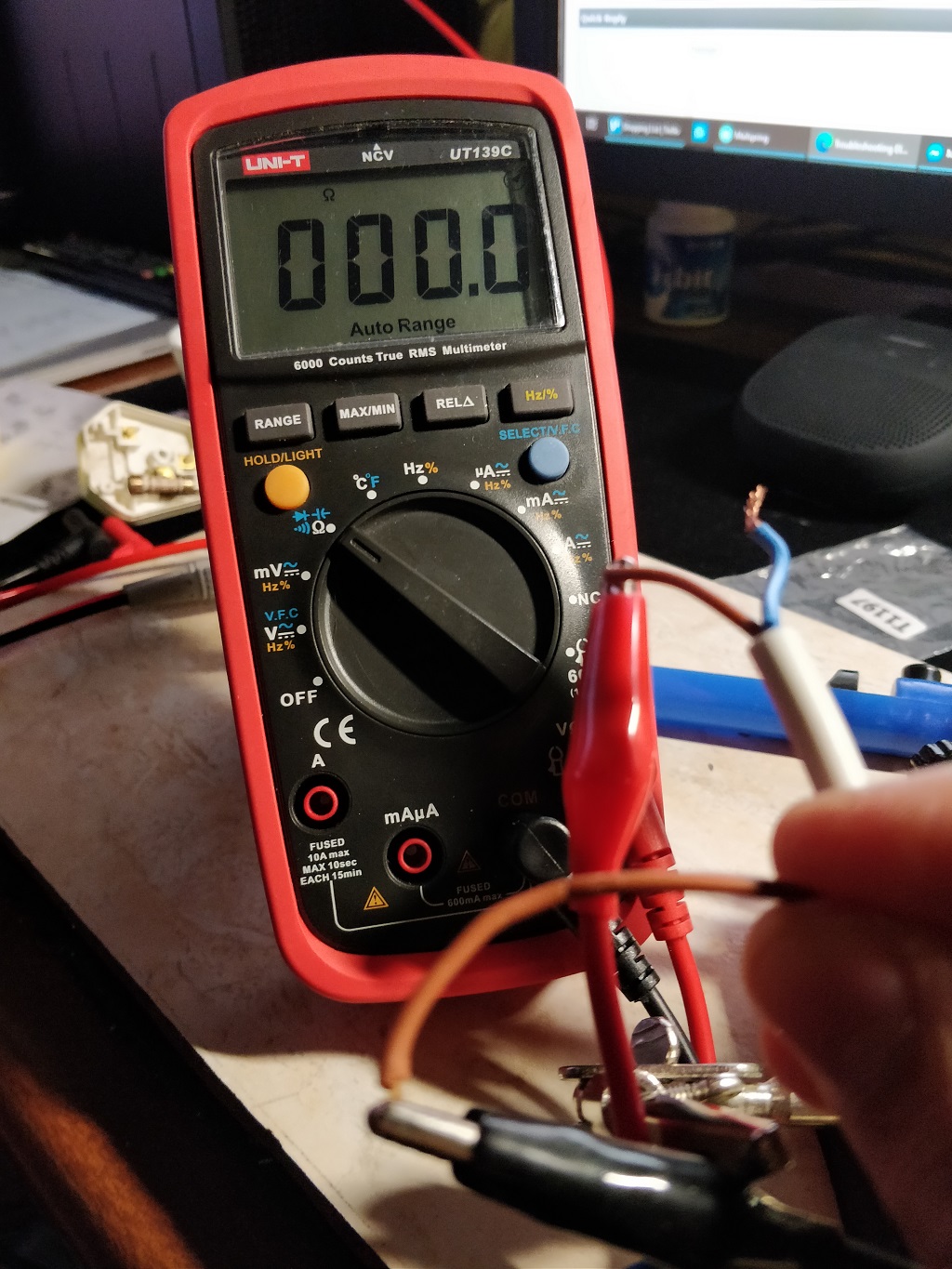

                            So this is the voltage measurement of the cord (i.e. from plug to meter).
                            I'll check the resistance. So I just have to remove the wiring from the plug itself and check each wire from one end to the other (for resistance), right?
                            EDIT: Resistance is 0 on both wires (I've zero'ed them out before measuring).

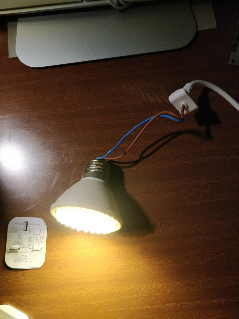

                                Good question as I said, I'm a newbie. If you say it's impossible then something tells me I'm measuring something wrong. Not sure what to tell you really
                                In the meantime, we have light. So this tells us that the wiring is fine right? I can solder the wiring back onto the board and measure voltage on the contacts again, unless there's anything else you'd suggest we test.
                                      F1 is a thermal fuse. If should check like a short, if it does not, then it is open circuit. It can be jumped with a piece of wire ONLY TO TEST. then it MUST be replaced with a thermal fuse.
                                        OK, now I have 220V on the connections (on the circuit). So, this confirms that my readings were wrong.
                                        So F1 is the white one in between of the resistors right? If so, then yes it's good.
