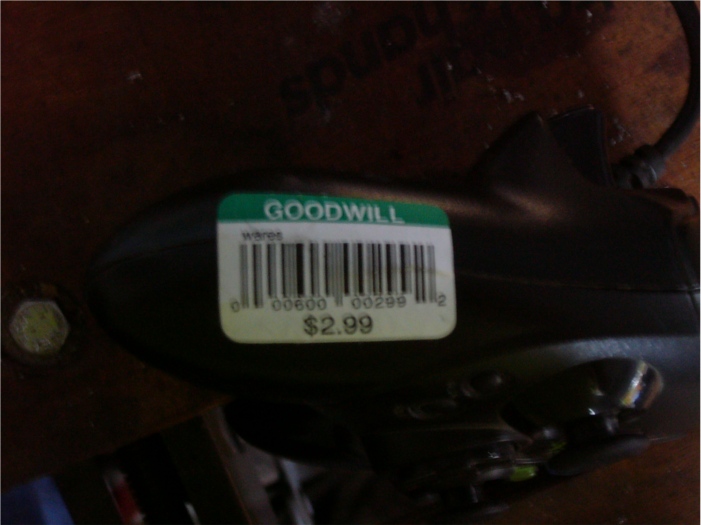

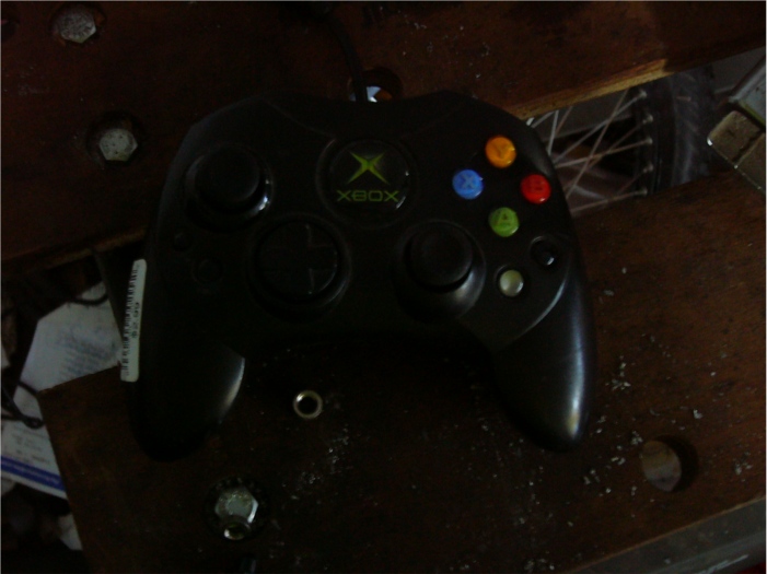

    an xbox controller. 3rd party ones work, too. mine was cheap:
    see? goodwill is your friend

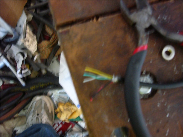

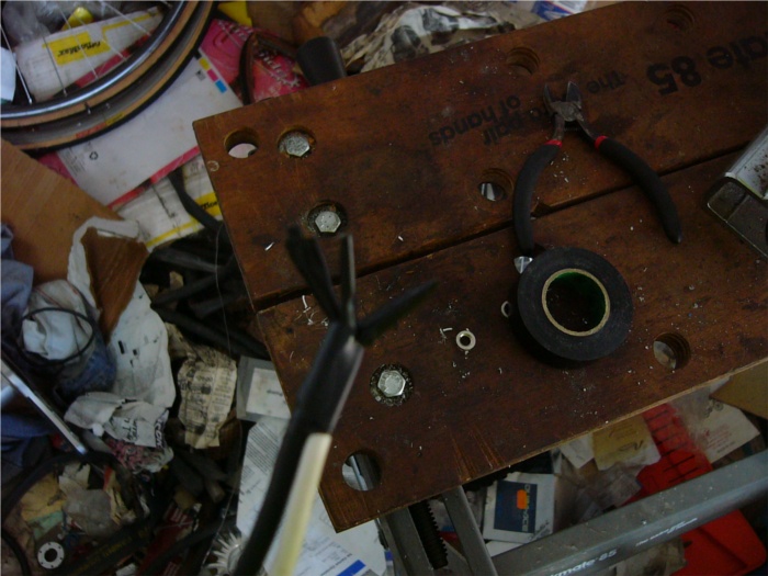

    now: expose your wires:
    WAIT!!!
    why does the xbox have a yellow wire, but the usb doesnt?
    idk why. but all you do is cut the yellow wire:

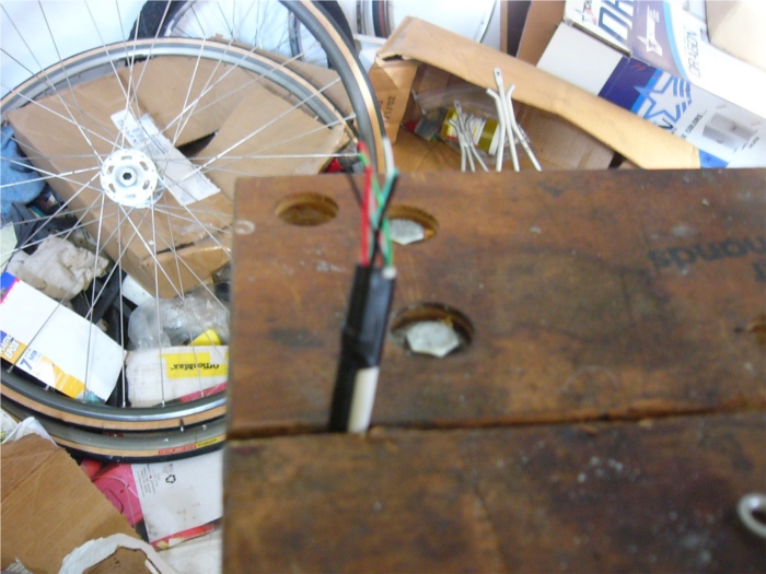

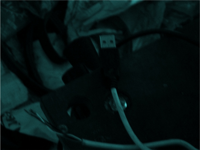

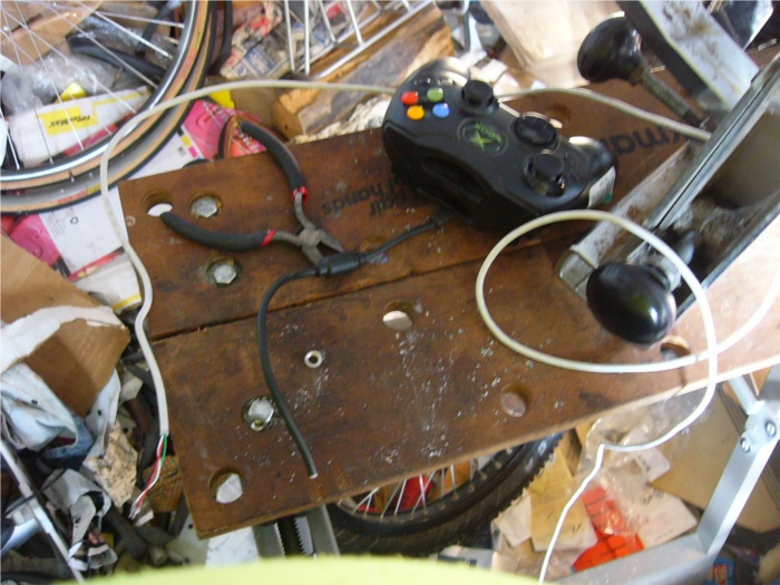

    next, tape the 2 cords together like so (see below pic) and mout them somthing like a vice , helper hands, etc:

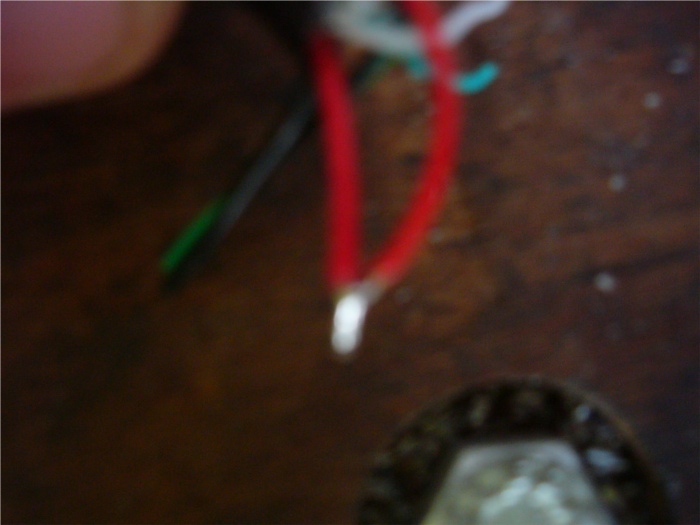

    next, strip your first wires. now that yellow is gone, the colors match up. i did red first
    then twist them together and solder:
    cut some off the end off, since the solder is not structural and the end is usually ugly and sharp:

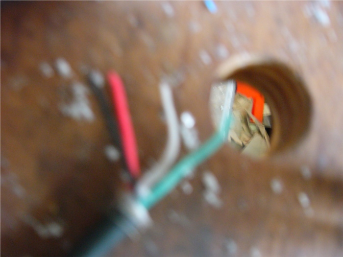

    repeat for black, white, and green.
    when you've done that, it should look like this:

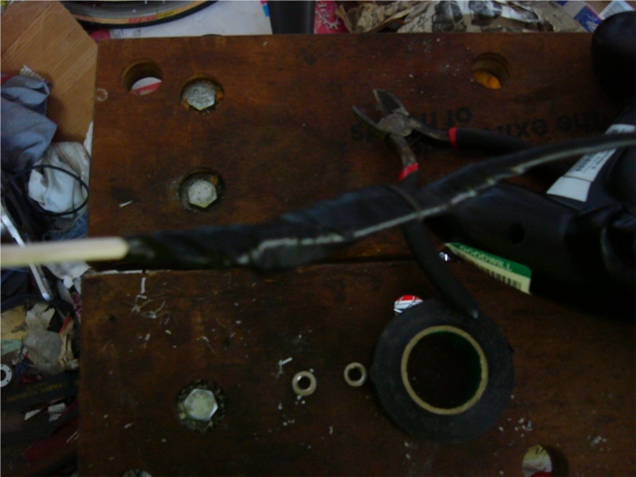

    now, tape around each splice:

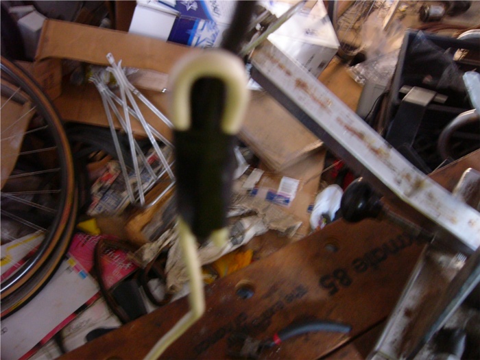

    then tape around all of the splices:

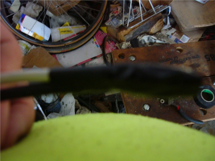

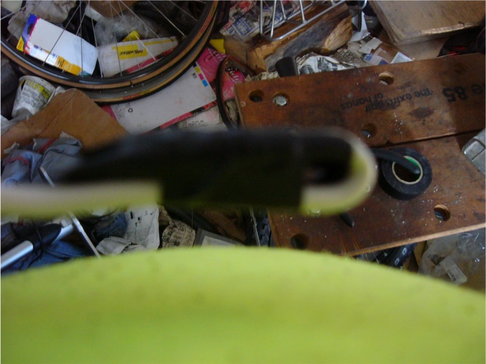

    then, fold it over like so and tape:
    and fold over one of the cords and tape:
    and tape over the whole wrap:

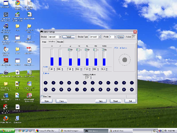

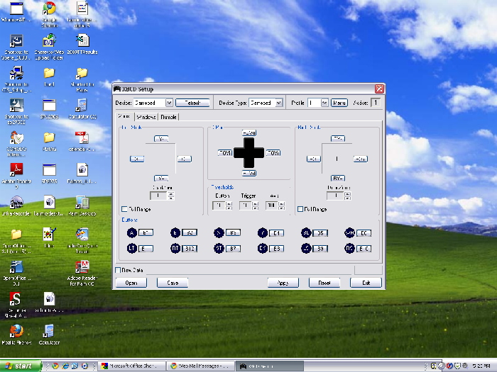

      download xbcd @ http://www.redcl0ud.com/xbcd.html
      it works really well. i installed it on my dad's xp box:
      the xbcd monitor. oddly, this stock controller has sticks that dont center well. the other 3rd party ones centered fine. even the crappy madcatz one.
      the windows style monitor, to see what windows sees.

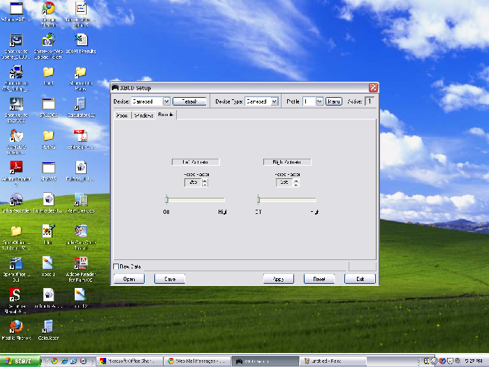

      rumble tester. moving the sliders will make the controller vibrate.
      fyi, the card slots work, too to use them, download the action replay driver. idk where you can find it but someone out there has it.

          yes you could, but this is how i was taught to make a strong strain relief. the solder should be non-structural. since its bound to be jerked around a lot, the strain relief is needed.
