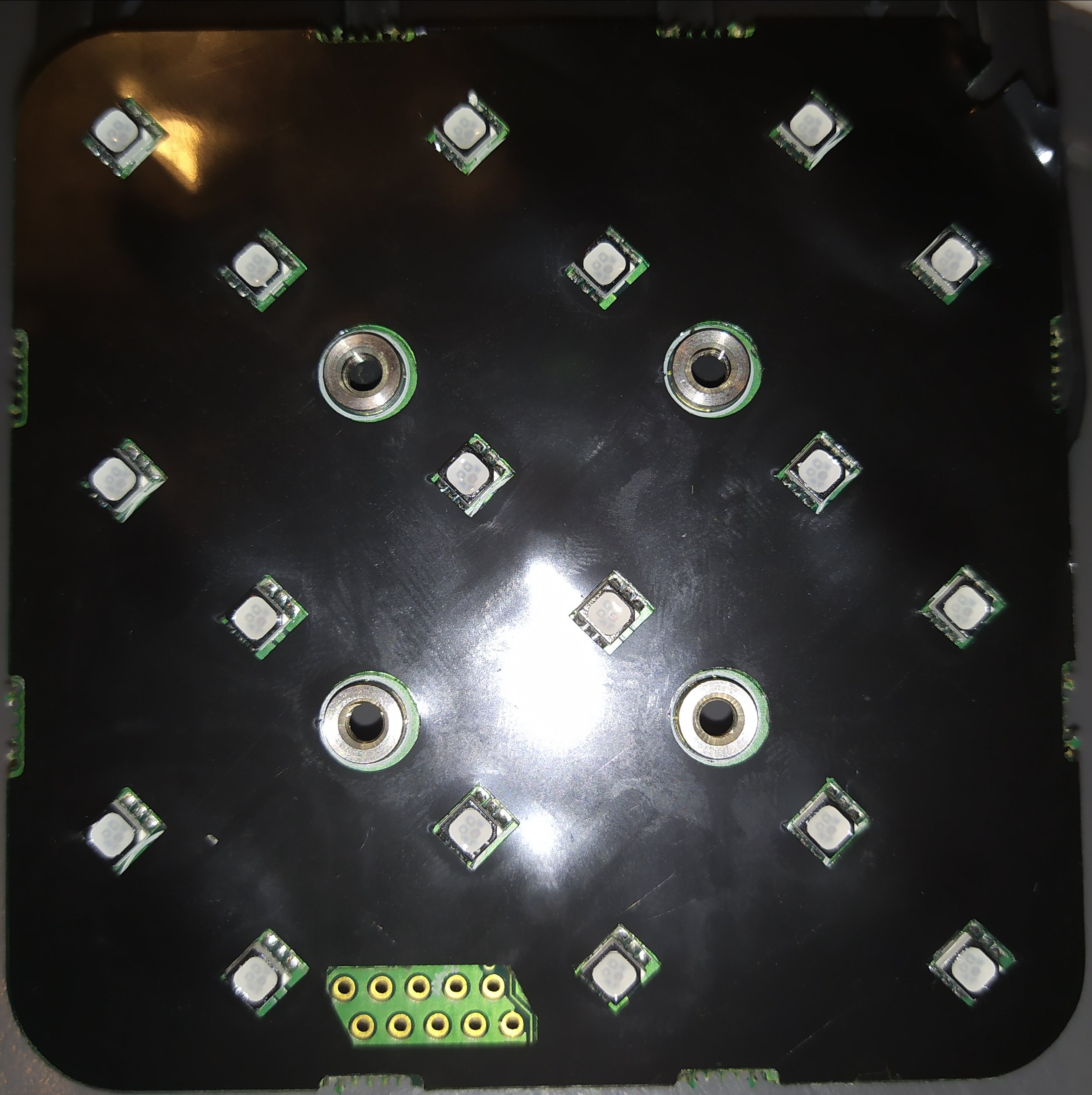

    Hi There. I have this weird device that is not fully working.
    It is a keypad used to control several tools in a harvester. It uses CAN bus to communicate with the devices in the machine.
    When it is powered on, it should flash all the buttons for a second, and then only the functions that are active, should remain lit. If you press a button, it should send a CAN msg and corresponding light behind the button should turn on/off.
    The broken keypad still keeps its control abilities 100%, but you have to work blind, as the leds behind the keys don't light up at all. No powerup test flash, no working lights, nothing, but when you press a button, the specific tool is activated, so CAN connectivity seems ok.

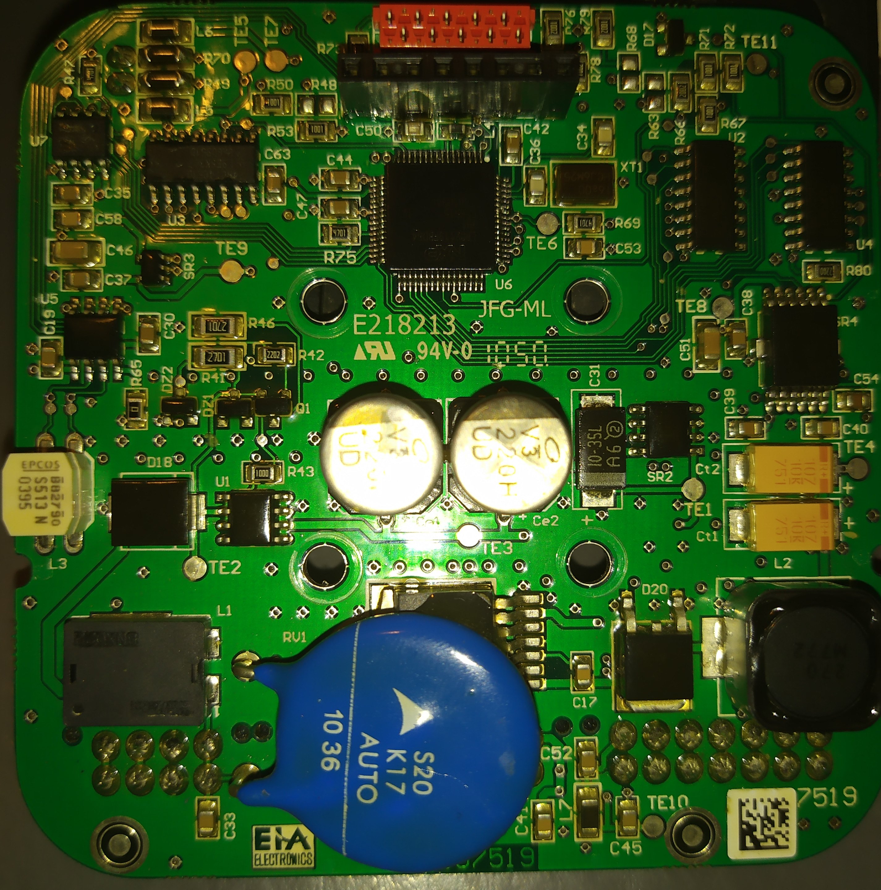

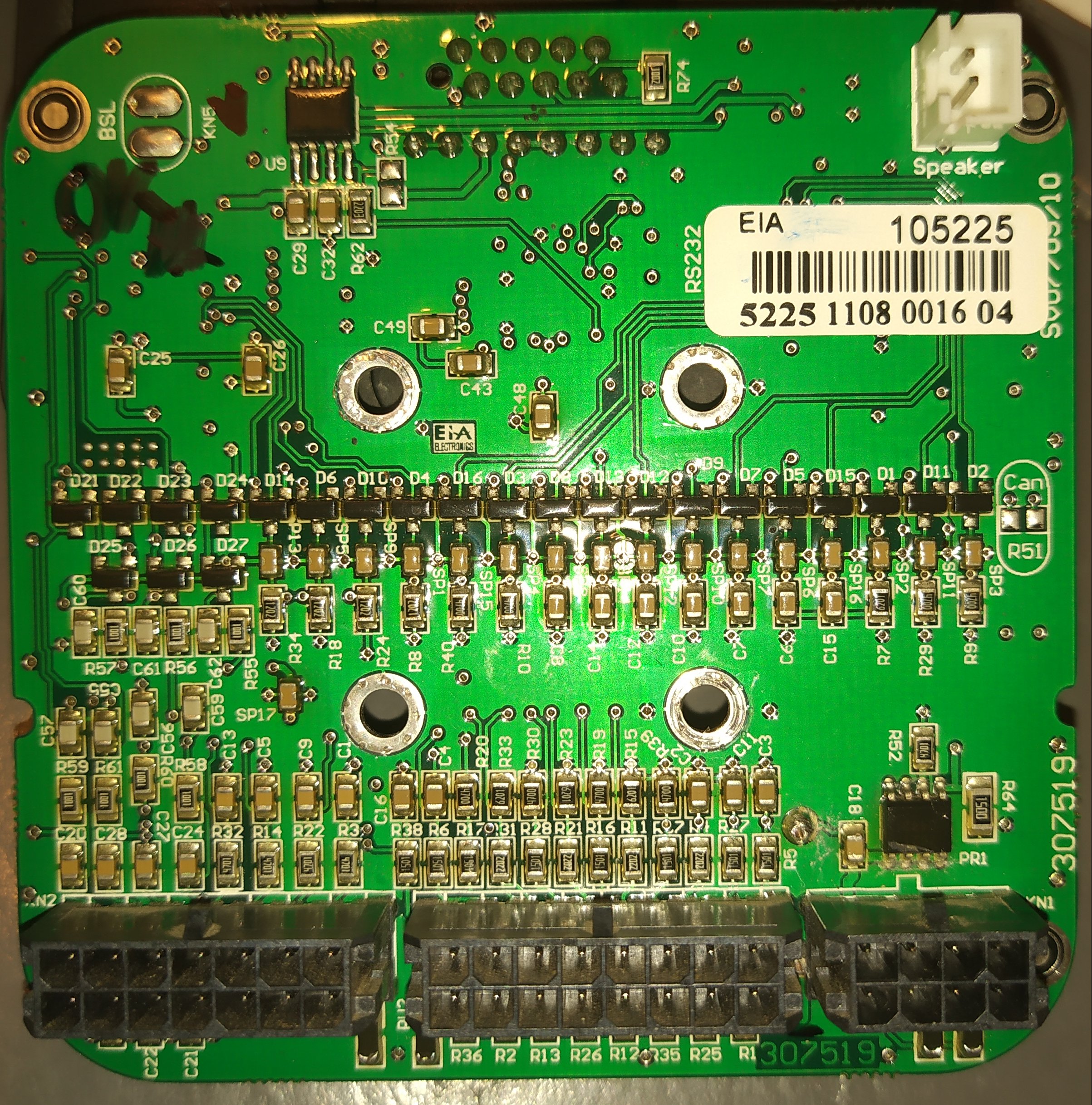

    Inside, it has 2 boards.
    Board A (check pics) has connections to harvester. Only 12V, GND, CAN-H and CAN-L are used in a real harvester. It has several transistors, probably for functions that are directly driven by the board, probably connected to the spare plugs, never seen them in use.
    It has a small connector to board B. Connector only has GND, VCC, CANH/L and 2 more unknown pins.

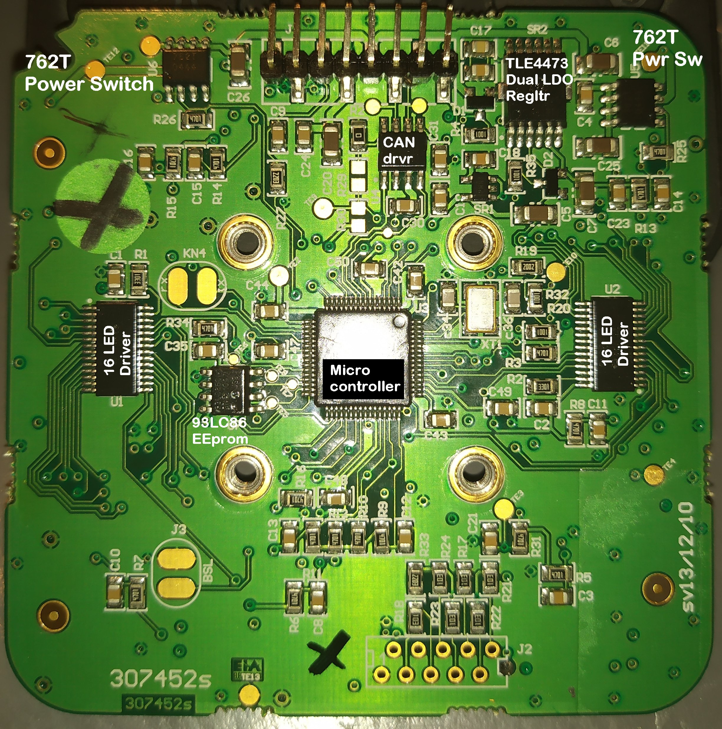

    Board B has all the logic to drive the CAN signals and the LEDS. LEDS seem to be RGB, as they are driven by several pins, and I have seen them flashing in different colors. Each key has 2 leds. One helps you locate the function it does at night, other turns on/off whether the associated tools is activated or not. This is the faulty board, when I use this board on another Board A, it still fails.
    IC's on this board are:
    1xTLE4473 GV53, this is a LDO dual output regulator, for 3.3v and 5v (5v seems to be inhibited and unused)
    2x762T, these are power FET switches. I think one activates TE11 and other activates TE12.
    1xA1051/3, this is the CAN line driver, to interface with microcontroller
    2xTCL5943, these are 16 output LED drivers
    1 microcontroller
    1x93LC86, this is an EEPROM for the microcontroler
    As everything but the lights seem to work fine, I believe the problem is in some current driver for the LEDs set, but I can't tell how it could be driven.
    I have a complete working set and another broken set (only board B is actually failing, as tested exchanging boards)
    Can you provide any help on how to diagnose what could be wrong?
    I uploaded pics of both boards (you can ignore board A) on both sides, and one of front B with annotated IC's markings
    Thanks in advance!

        Are those 3 color led's? I see 6 leads per led, and what looks like 3 seperate emitters in each led.?
        • CapLeaker
          Leaking Member
          • Dec 2014
          • 8086
          Re: Harvester keypad. No lights
          he did state that they are RGB
          "Board B has all the logic to drive the CAN signals and the LEDS. LEDS seem to be RGB, as they are driven by several pins, and I have seen them flashing in different colors."
          I am guessing that that one LED is like a back light. When you press the button it changes color for example to green (for the function being engaged indicator). Now you have nothing, no backlight and the indicator doesn't change color either when pressed, correct? LED's are current controlled, not voltage controlled. What is the part number on these LED drivers?
          Did you ever compare the Test Points between the good and bad board B? Maybe it is something simple like a missing voltage or a shorted SMD cap.

            he said they are TCL5943 .couldn't find much on them . i guess they will need some sort of supply voltage to work .

              I think that was a type-o. Here's a TLC5943.

                        As RJ mentioned above, it's unlikely that both drivers (U1,U2) failed at the same time. However, if they are daisy-chained, a problem on U1 could take U2 out. Check for continuity between U1-pin24 (sout) and U2-pin5(sin) to be sure.
                        Also, you mentioned that the led backlights can be turned on for night use. I assume that the board gets a signal when you turn the headlights on. Need to see if one of the pins into B board is changing when you turn on the headlights. You'll need to replicate that for out of circuit testing.
                        Lastly, I doubt that you get any info, but have you tried contacting the manufacturer and asking for either a schematic or test point data? (EiA board 105225 pcb 307452s). Might be worth a try:

                                Ok, I found a proper way to connect both boards without bending the inter-board socket, and some early conclussions, all about the TLC LED driver chip:
                                Vcc for the chip is 3.3V
                                BLANK is LOW (mV)
                                Iref measures 1.2V. Attached resistor measures 3K3. Same as markings on SMD chip
                                Xerr gives out pulsed Lo-Hi, at the same rate as the leds are blinking in a working board to indicate that CAN bus is not detected
                                All this, so far, gives same values on both working and not working board. Working board has this Xerr pulses while it flashes so this is not the issue.
                                Then I measured LED outputs from the drivers (OUT0-OUT15) on both working and failing boards. This differed... Values were aproximately the same, if OUTx was HI on one board, it was HI on other board, if it was pulsing on one board, it was pulsing on other board. BUT, some of the outputs had the same voltage on working/non working board, while some other outputs had like 0.2 - 0.5v less in non working board.
                                Could it be that the LEDS individually failed? I don't see any black spot inside them, I see visually exactly like on the working board
                                What else could I test? Thanks again!
                                • edugimeno
                                  • May 2017
                                  • 568
                                  • Spain
                                  I also measured SIN and SOUT on both IC's, both boards, giving same pattern (digital tiny flicker around 3.1v).
                                  I checked the LEDS to determine their internal wiring. Found that 3 corner leads are common anode and 3 remaining are cathodes for R / G / B. When I apply low voltage with multimeter in Diode test mode, on good board I get full R / G / B light on each pin, but same test on bad board, I barely get any light (very dim) and sometimes it seems colors get mixed even when Im carefully with leads.
                                  Could be a bad diode, but also the shortcircuit could be in the feeding driver IC (TLC)
                                  At this point Im stuck between bad diodes or bad driver. I guess I should remove one LED and test it isolated, but Im afraid Im going to fry the board as I don't have any good and thin solder tip neither any special tool to desolder 6 pins at a time
                                  Any other hint on how to diagnose?

                                    Look into getting a tweeter soldering iron they cost a little bit more than a regular soldering but for you are doing it should work for you
                                    Here is one version of what I am talking about
                                    https://www.ebay.com/itm/938D-220-11...gAAOSwdNRc5EOp
                                      • 30977
                                      hot air needed - those chips have a center pad under them.

                                        Those TLC5943 drivers can be had for less than a buck on aliexpress. I would get a couple of these and put those in first.
