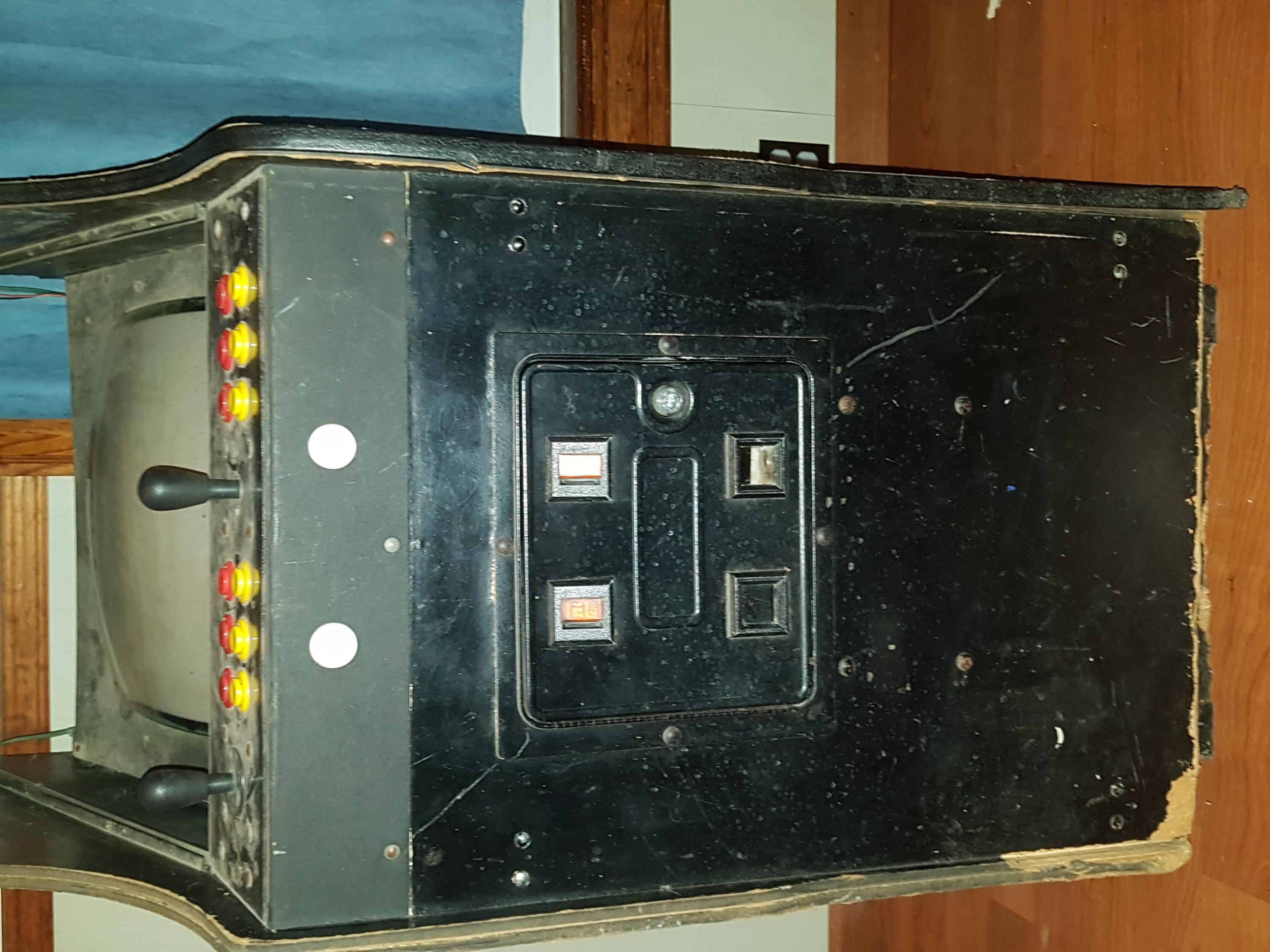

    Hello!
    I am soon to be the proud owner of a Capcom CPS-1 Street Fighter II Turbo Hyper Fighting Champion Edition Coin-Operated Arcade System!
    Back in the 1980's and 1990's, there was a shop on Market Street named Faulisi's Newsstand. It could have been there before the 80's, but I was not born until March 14th of 81, so I do not know. My brother would go there with me and we would play this exact arcade. They went out of business and this arcade was sitting in a garage, wasting away.
    During middle school and high school, we'd sneak into Faulisi's and try taking a peak at the dirty magazines and Mr. Faulisi's would give us the boot! It was the hot spot of my town for a long time.
    There is a coin-counter in this machine and it shows 44,076 quarters passed through it.
    The game boots up, which is good, but this arcade needs some work. I want to replace the cabinet, replace the marquis. I want to restore it.
    The current cabinet I do not think is original. I believe it's the same cabinet that was in Faulisi's but the marquis on the very top was cut to fit the cabinet and it looks more like the CPS1 board was placed in this cabinet.
    I was thinking of using original parts but I am having some issues finding them. Does anyone have any experience with arcades? The coin mechinism appears to work, the jamma wire harness is there, but not all the wires are hooked up. The test switch has been disconnected. I was thinking of just rewiring the harness where needed. But I'd like to try and keep it as original as possible and I am not sure what type of connectors where on the end of those wires...
    Does anyone want to help me find the parts to restore this or want to talk about it? I've always wanted an arcade. On the side, it looks like theres glued down decals, but I do not think they are supposed to be there on the official cabinet. I was looking at the Arcade Mueseum and they have a picture of what I believe is the original cabinet.
    I do not think the buttons are original either. Six buttons by the joystick for each player. Top row are red, bottom are yellow. Then above the coin slots are two white buttons that I believe are start buttons. I'd like to find an original joy stick / button do-dad, but I am not certain what the original for the USA version looked like.
    Thanks!

    Re: Capcom CPS1 Street Fighter II Turbo Hyper Fighting Champion Editon
    i'm not sure capcom imported cabs to the u.s., just kits with the pcb, controls and artwork.
      That is good to know.
      So perhaps I could make a cab for it that looks really nice, or order a non-US cab? I am tempted to replace the CRT with an LCD LED type monitor, but I am not so certain I want to. I might just try and find a new CRT or a used one in better shape.
      I could really use some help with finding a wiring diagram for a cab. Some of these wires have been unhooked. I think someone was trying to by-pass the coin slot at one point in time. The TEST switch has been removed, but the wires just dangle, stripped and everything. I wouldn't mind rewiring it proper like.

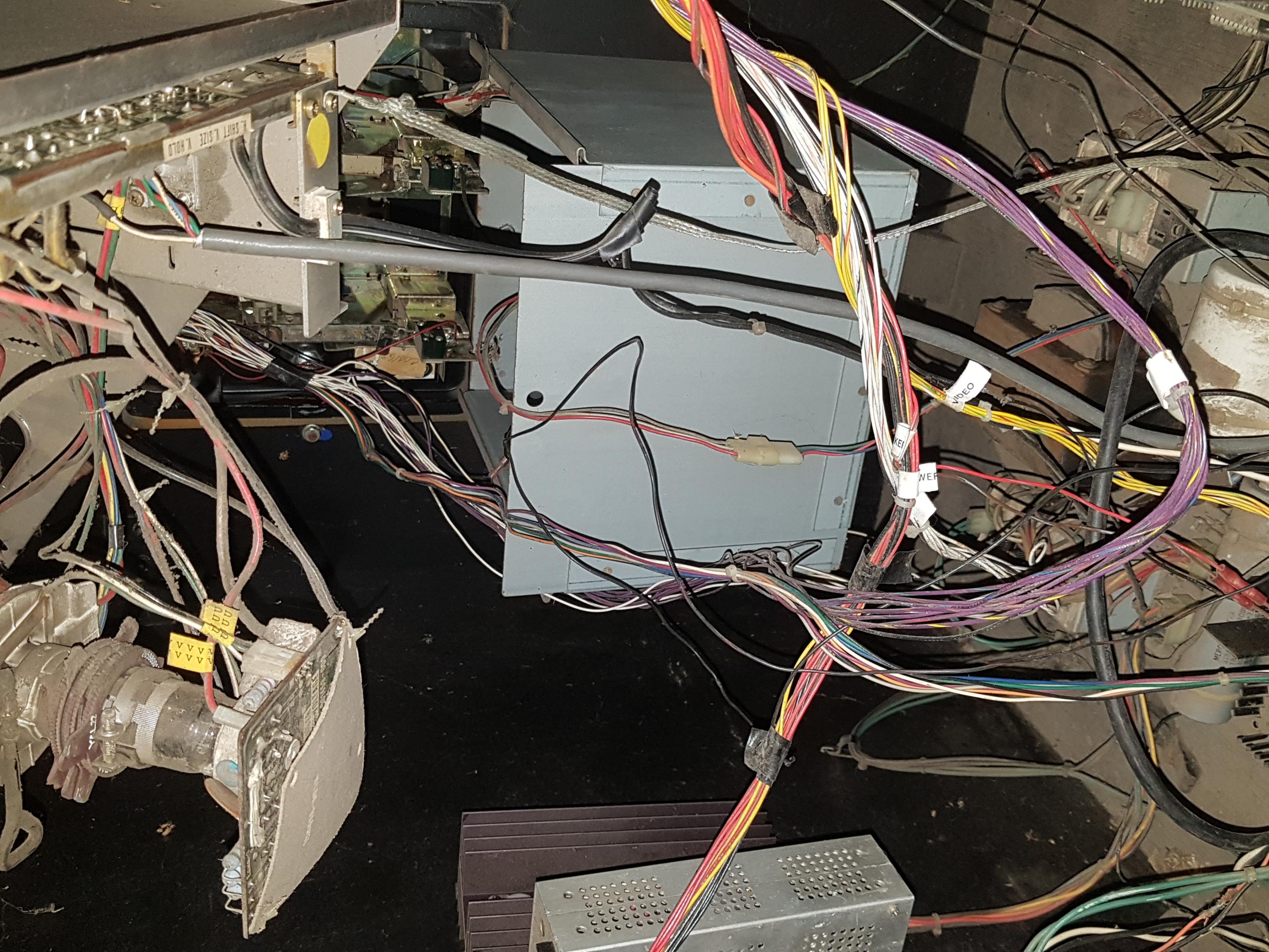

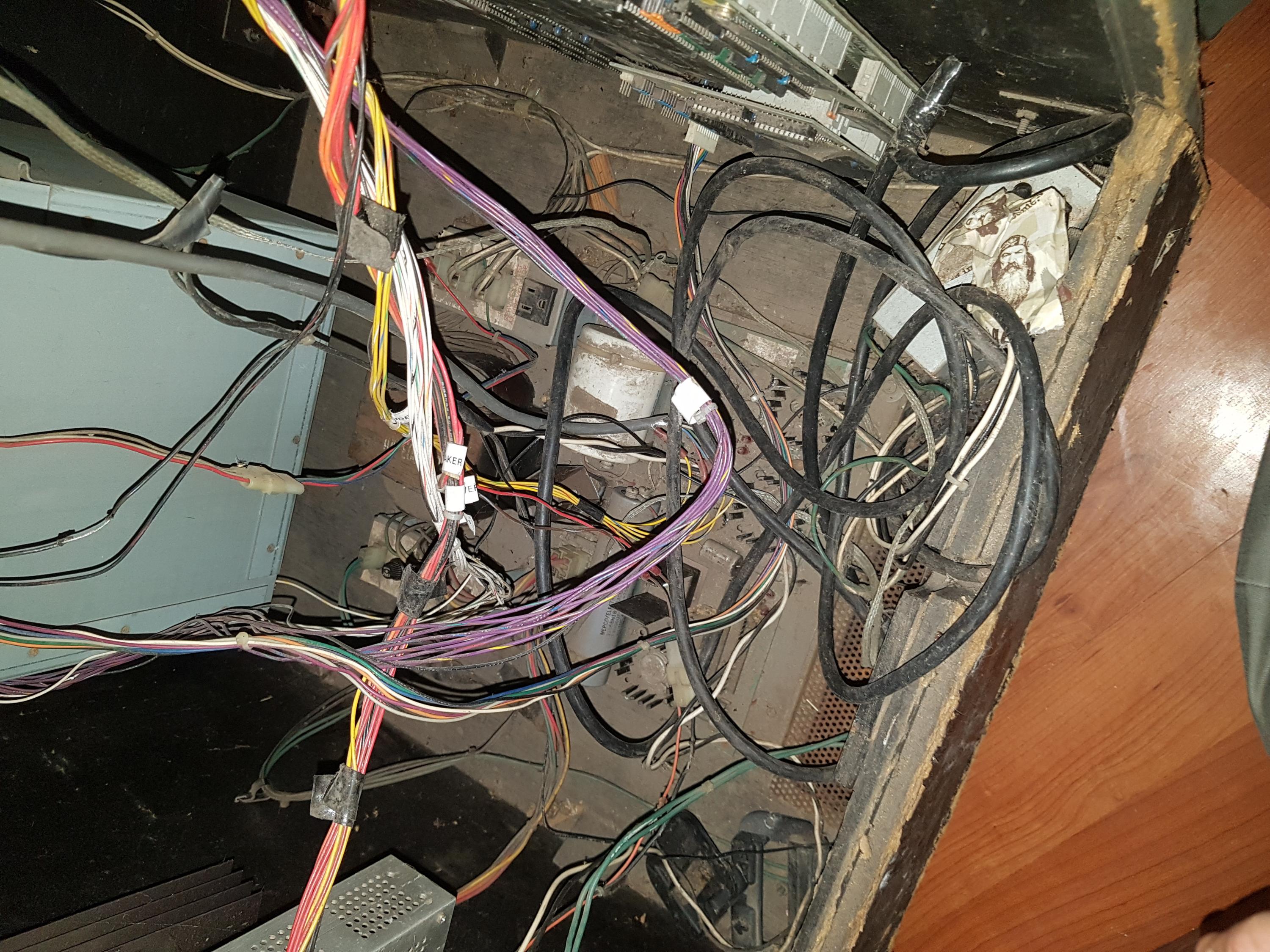

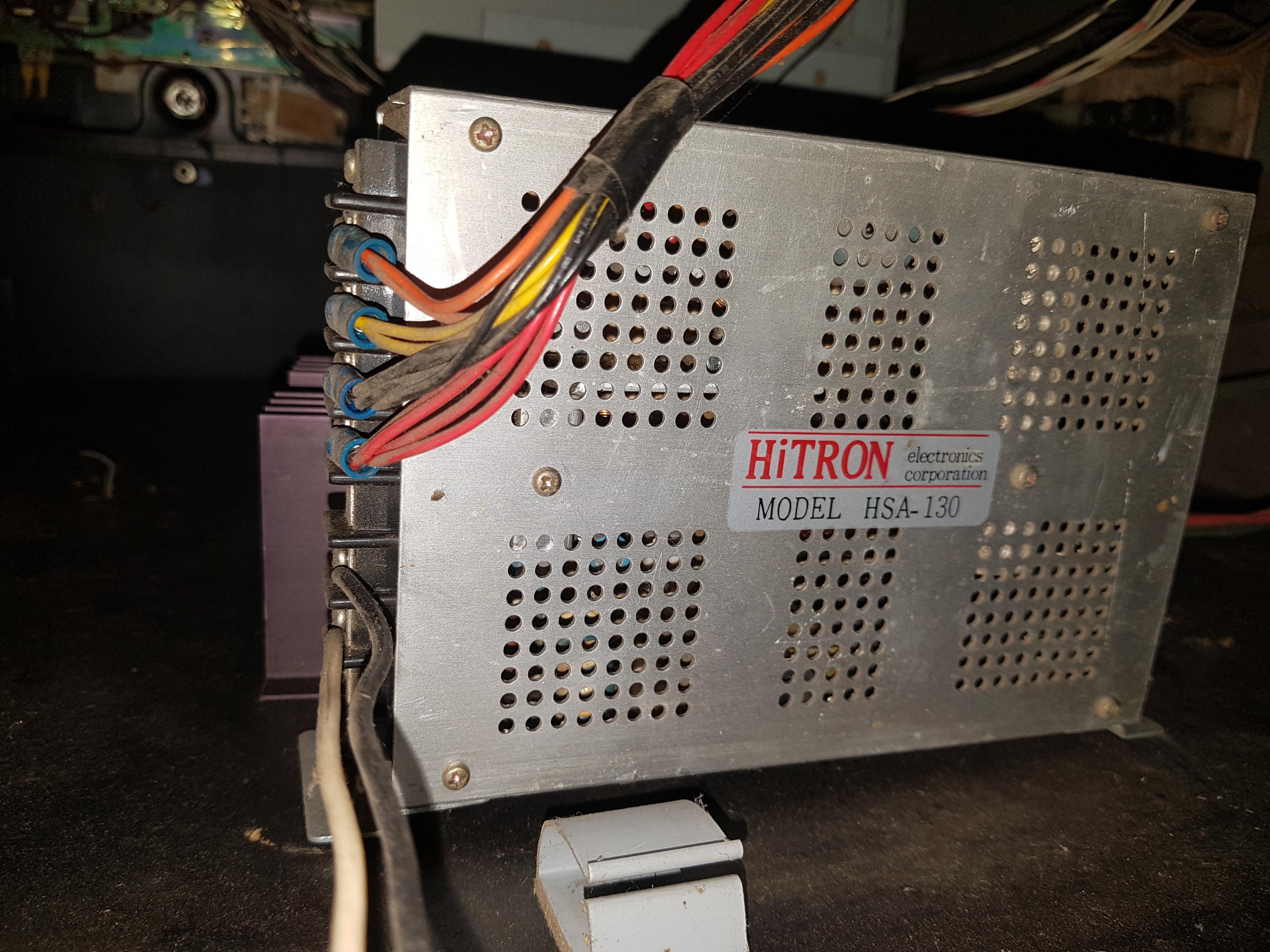

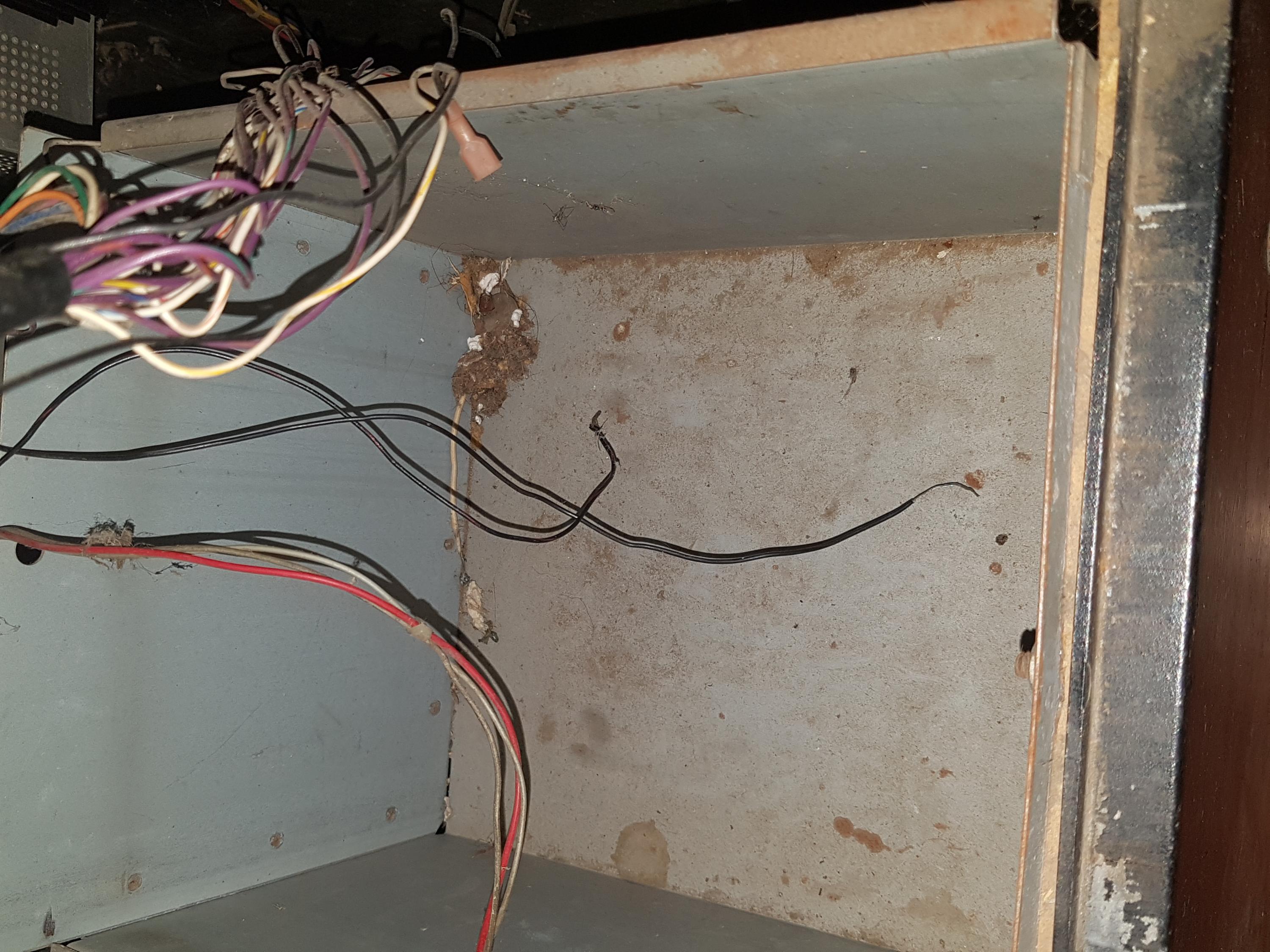

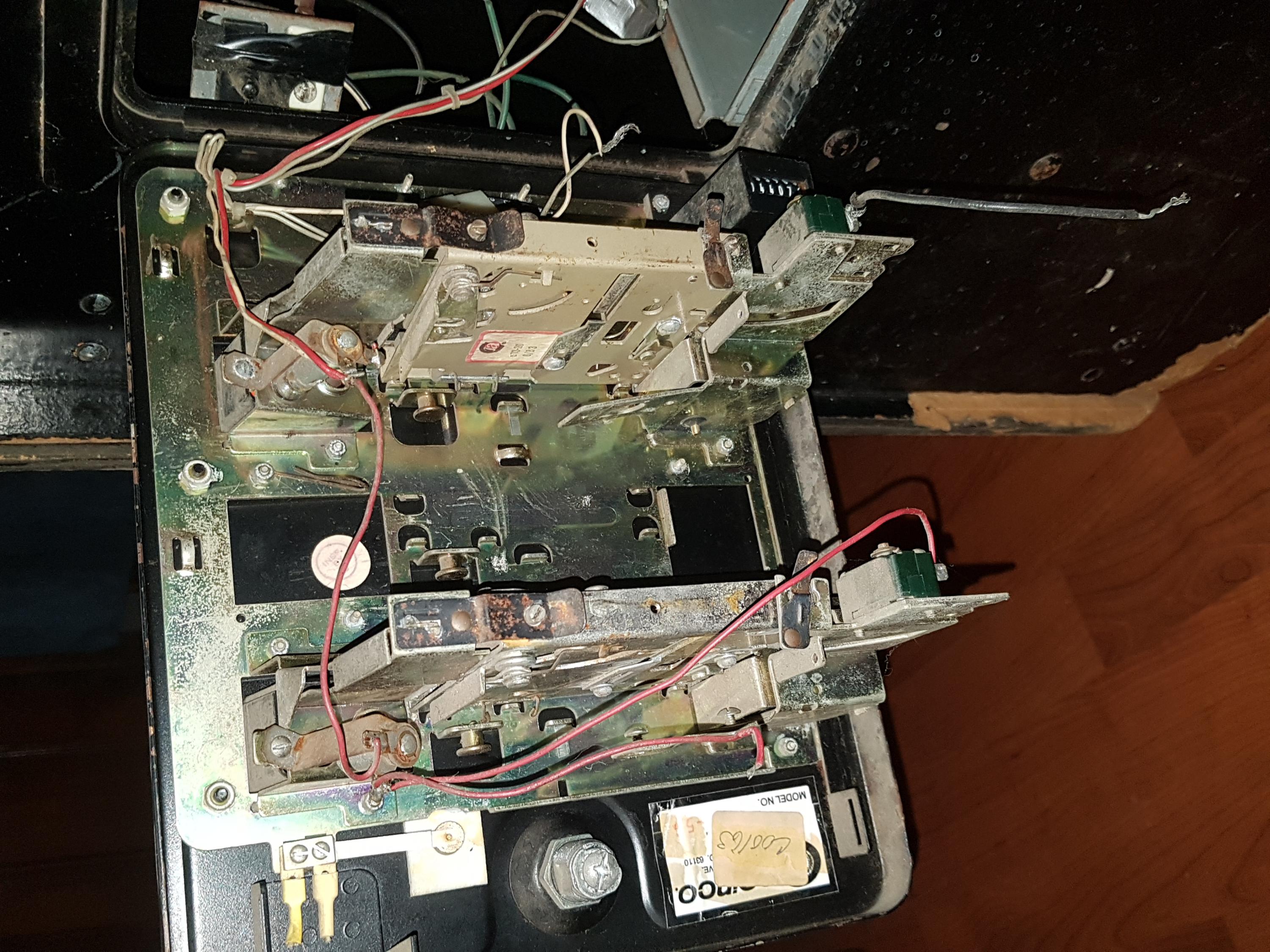

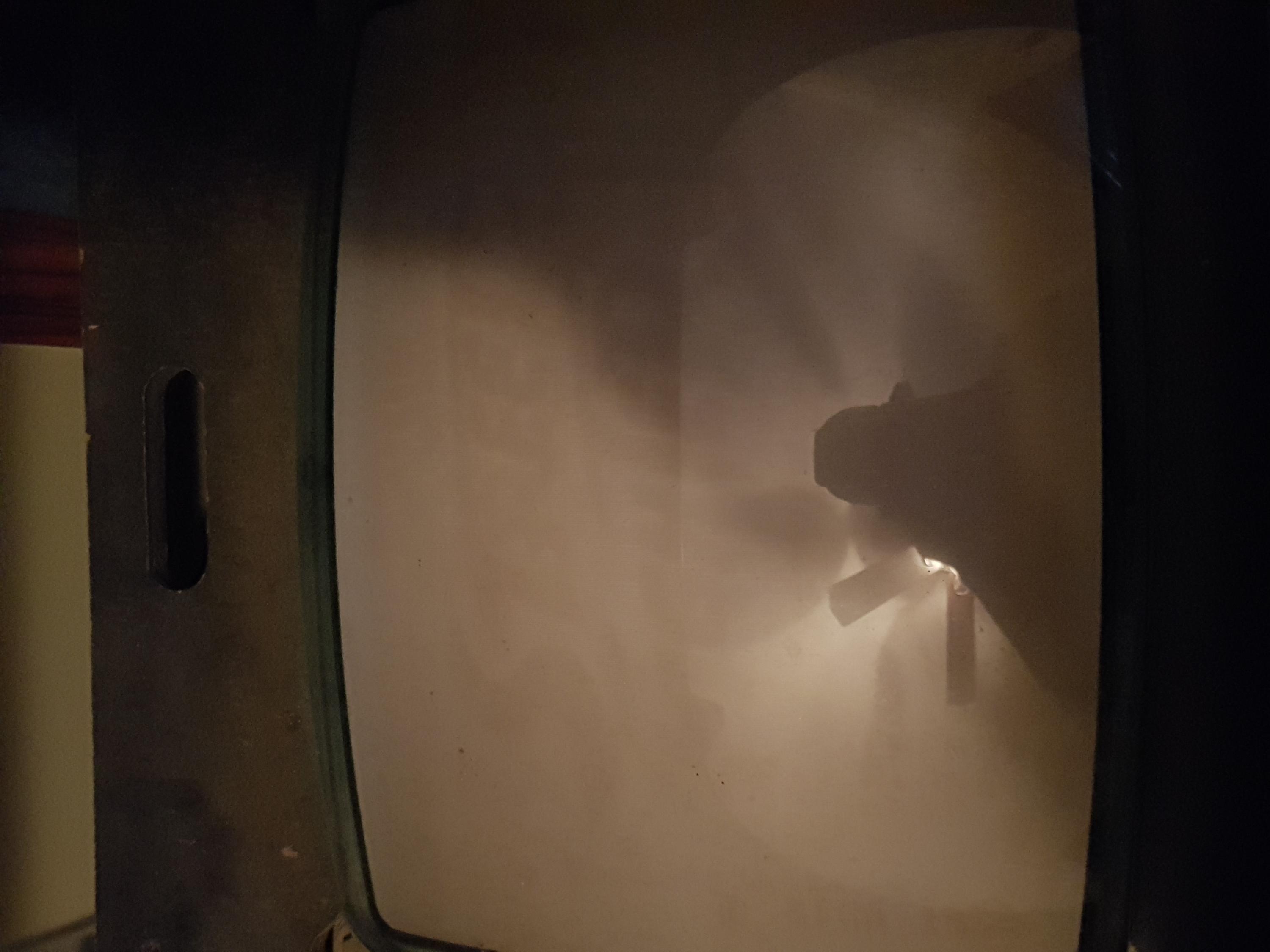

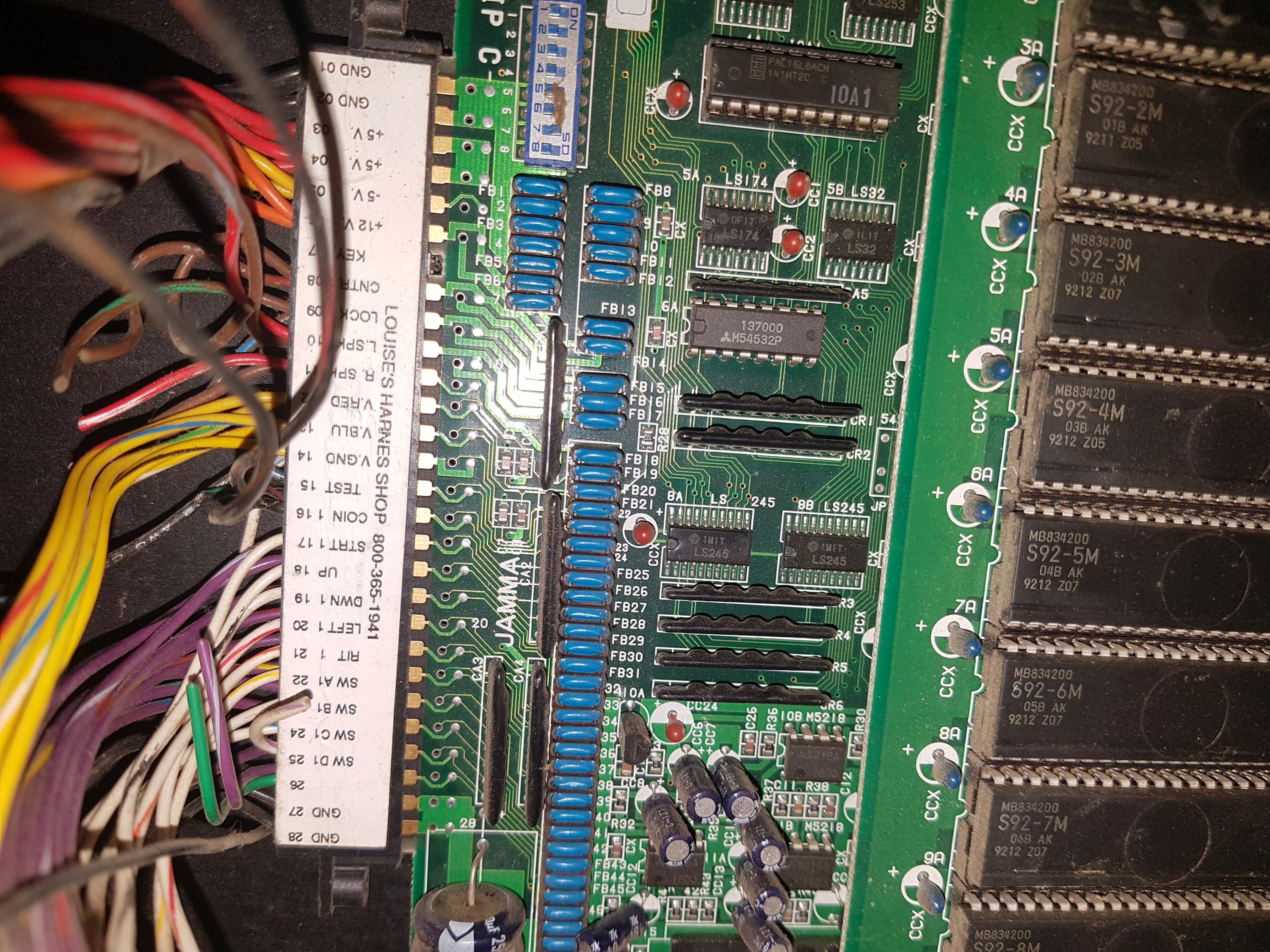

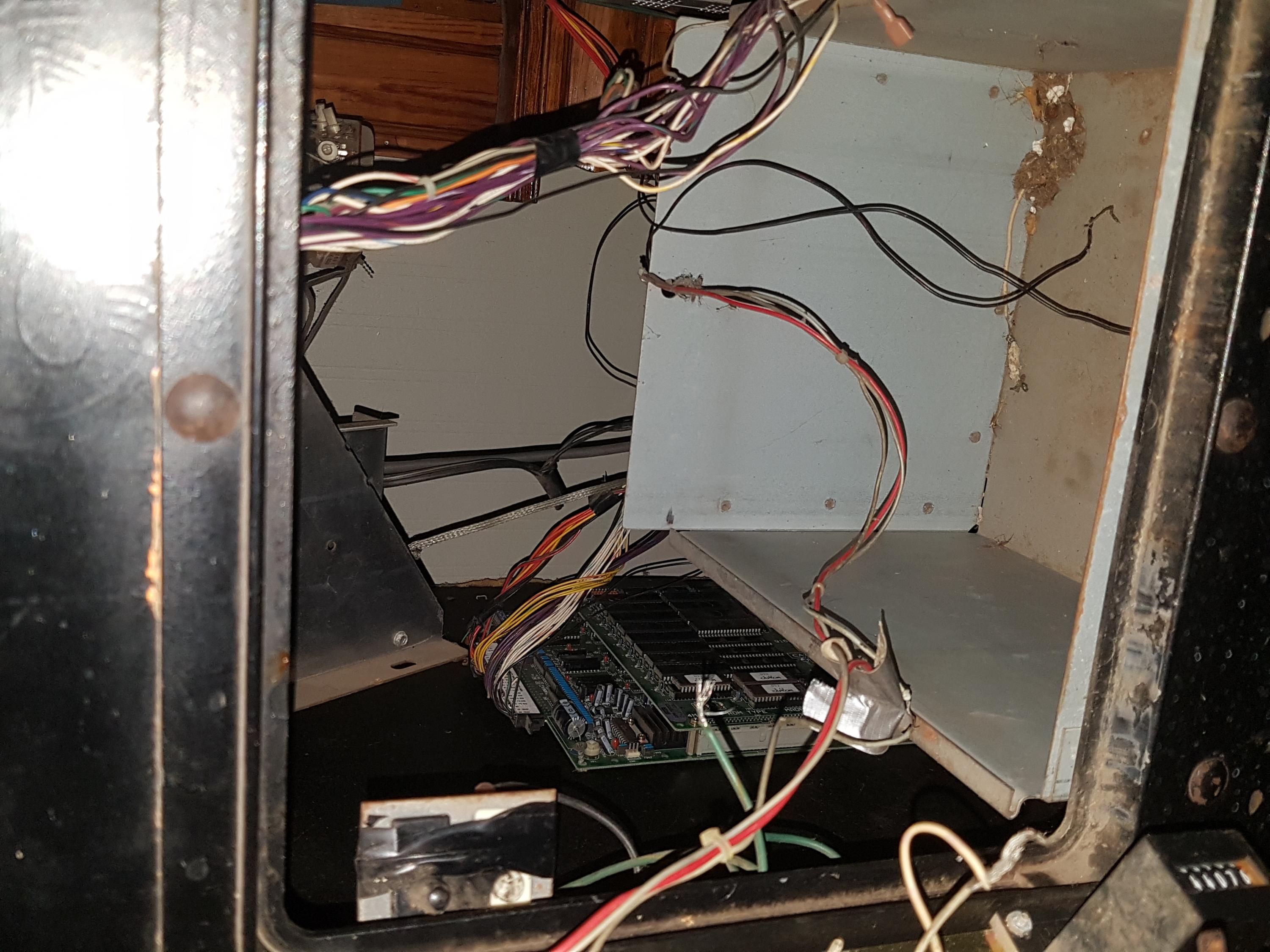

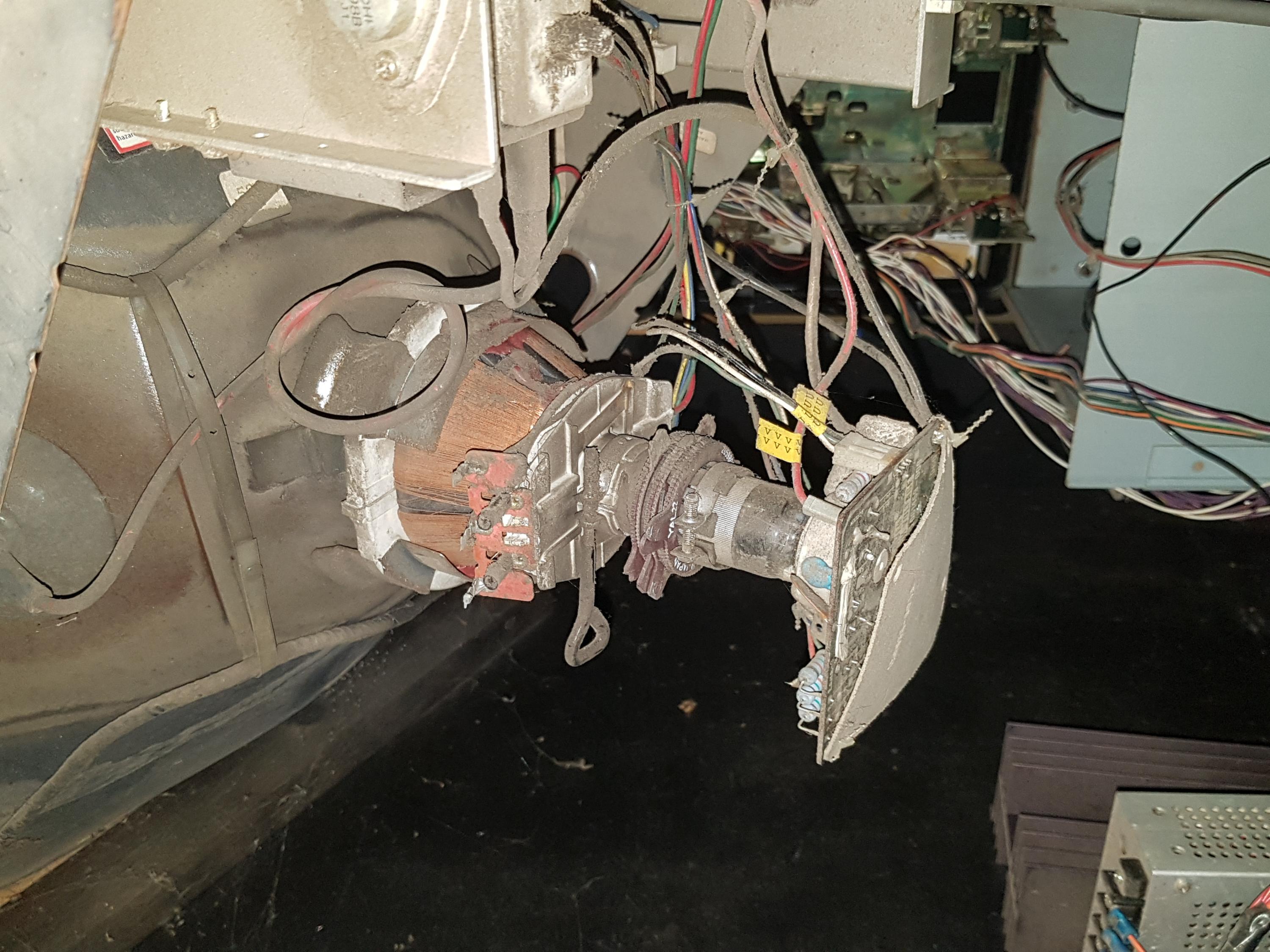

                  Here are those pics I promised. It's a mess inside. The Jamma connector I think is called a Jamma Plus connector, because it has the Kick Harness built-in, but it's definitely not a CapCom part. It lists a company and contact info for it, Louise's Harness Shop.
                  There's some weird devices / boards on the bottom of the cabinet that I am not sure of. I took the best pic I could currently take of this, pic 11. Perhaps it's the power supply board for the CRT? They're mounted on a piece of plywood and there appears to be a huge ass transformer in the back of it. On the sides, there appear to be some weird power strips that take molex and some other funky connector I ain't sure of. There is a shiny power supply mounted on the left side (if you're looking at it from the back), but I think that just goes to the various marquee lights and the CPS system.
                  In pic 10, it might be hard to see, but I'm sure you can see at least some of the burn-in. In real life, I see more than the camera pic seems to show. Like Player Select, Insert Coin, stuff like that.
                  This is what I found on ArcadeHacker:
                  The design consist of a number of interconnected pcbs known as A, B and the later added C board and Q-sound board. Here's a description of each layer:
                  A: the base board containing most of the system hardware. eg: cpu, memory, sound, etc...
                  B: the game rom board containing a combined number of mask roms and/or eproms.
                  C (later added): an small satellite board containing a video logic custom chip, and sometimes additional IO.
                  QSound (later added): a full size intermediate board providing new sound capabilities, the board is sandwiched in between A and B.
                  Note: C board was introduced right after the two initial game releases: Forgotten Worlds & Ghosts and Ghouls, and wasn't part of the original CPS-1 design. Instead, its contents were an integral part of the B board.
                  So that little square circuit board, the very top most one, in picture 13, is that my C board? Where is my QSound board? I am guessing the little tiny one that has the games name printed on it is not the ROMs like I originally thought. The ROMs are on the board under that, in those DIP chips, right?
                  My C board has a custom made video logic ASIC it seems. That's the chip with the B-21-whatever.
                  Thanks!
                    it's just jamma plus a kick-harness for the extra buttons.
                    btw, go here for help.
                    https://www.arcade-projects.com/forums/
                    You was right, but it's too late for me to edit my post.
                    I thought the Kick Harness was on the A board, and an addition to the Jamma harness. It's on the C-board. I don't know how I missed that connector on the C-board. I found a video where the guy goes over this game, with the cabinet.
                    https://youtu.be/f9abjfINgq0
                    I think I understand what he's saying. I can use a Champion Edition cabinet, or find one of those made by the company CapCom hired to make the cabinets. It's a Z type cabinet I guess.
                      I think maybe the SF CE cabs are the Dynamo HS-5's, and I just need to find a donor SF CE cab. They included a 25" CRT monitor.
                      -- Law of Expanding Memory: Applications Will Also Expand Until RAM Is Full
                        • 31117
                        if you lose sound, replace the z80 cpu with a z80A or B - the original is overclocked!
                        pcb schems are around for some cps1 variants,
                        cab wiring etc may be here:
                        http://antelopearcade.com/files/inde...cade%20Manuals
