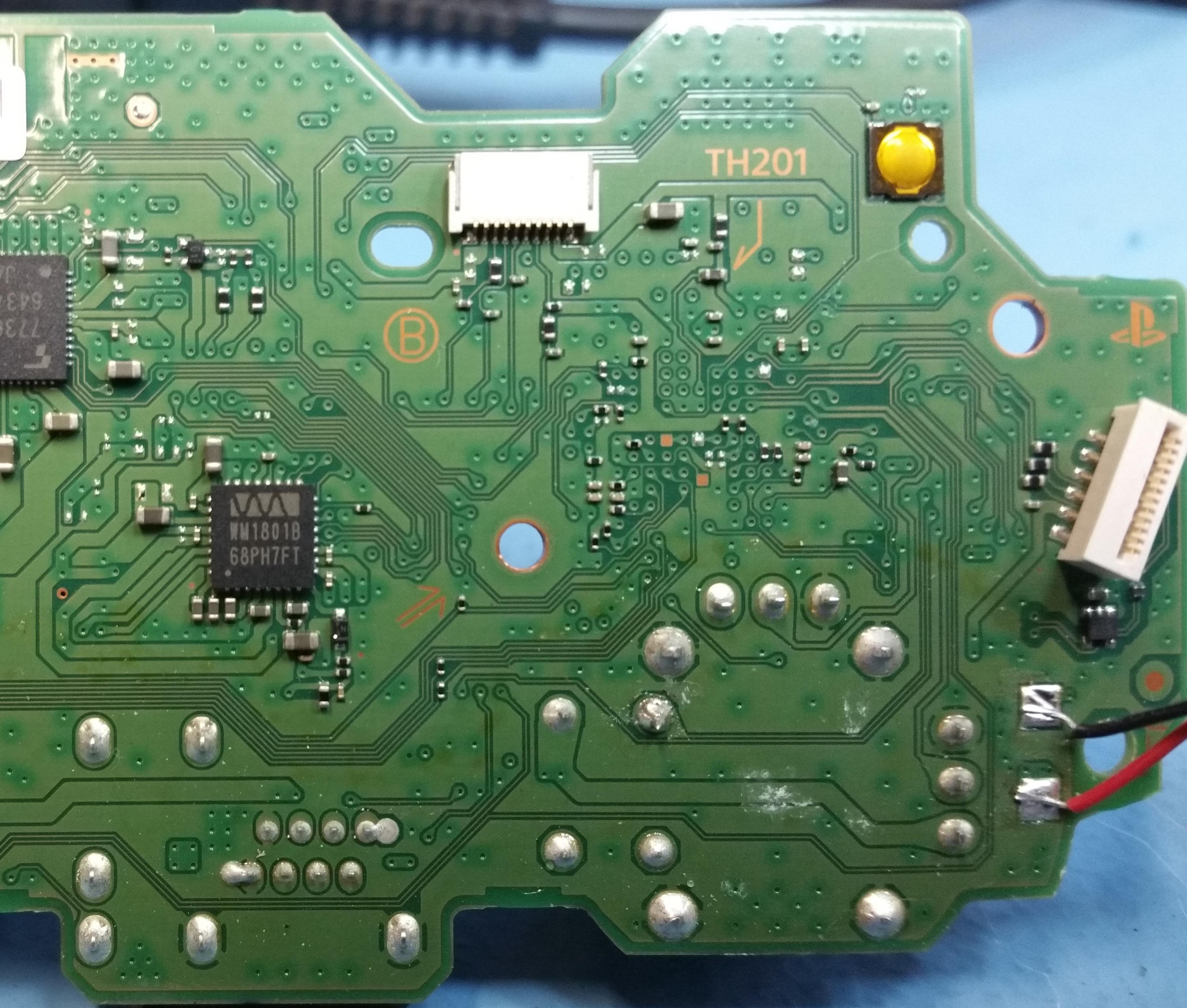

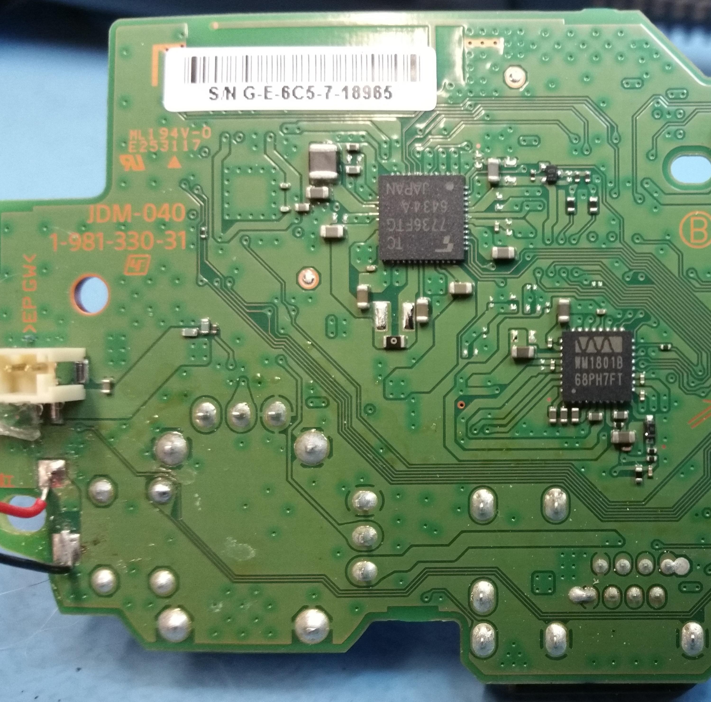

                      • xmetal
                        Tinkerer
                        • Nov 2010
                        • 6
                        Re: PS4 Controller acting weird
                        Looking at your board it looks like you might have some liquid damage at this point.
                        https://www.badcaps.net/forum/attach...1&d=1572802025
                        • ngth82
                          • Jul 2015
                          • 541
                          The residue is likely the no-clean flux.
                          -Thomas
