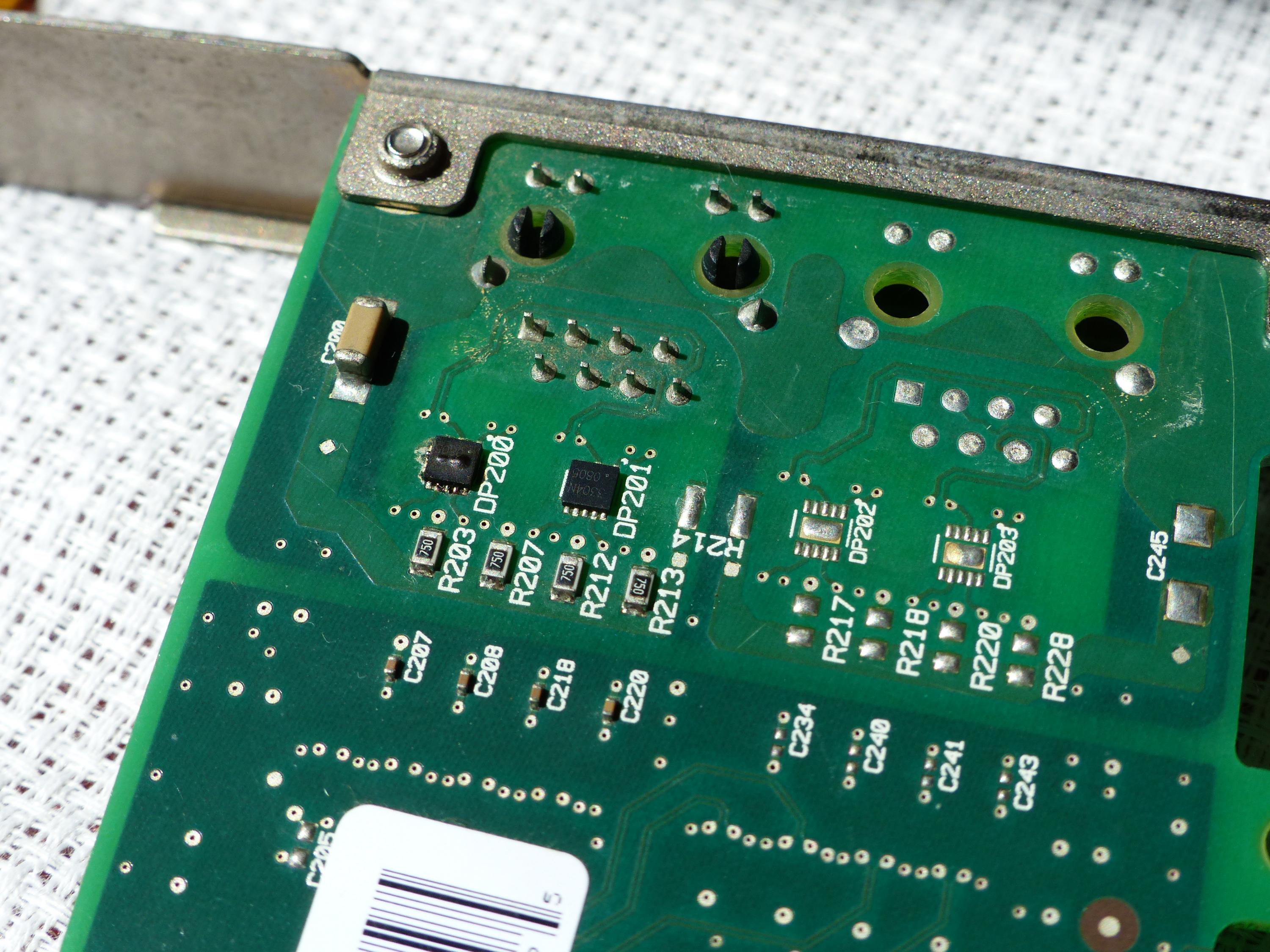

    A few months ago I received a network card that no longer connected to the network, although it was seen in the device manager and the drivers were installed automatically. Intel Proset Software also diagnose a TX signal problem.
    At first glance, I thought it was a driver problem and I installed a clean Windows, but the problems persisted. Last week I came to the place where I have most of my tools and I decided to inspect it very carefully with a magnifying glass.
    Only reflection of natural light helped me to find a piece of 2,5x2,5mm with a slightly burned look, a sign that made me think there was a short-circuit there. This is a 3304N
    The protective features offered by this diode make me think that there was a serious problem because when I tried to desolder, it just disintegrated and took with it the pad that I suspect as holding a ground role and 4 pins. Of the 10 pins I noticed that only 4 connects, as the routes suggest.
    Is there a risk that the Pulse h5078nl will also be affected?
    I thought I'd give him another chance, but I need some help with diode grounding and the connections of the four pins.

    Since it is just a protection device the card does not need it for the card to work, so once it is removed and nothing else is damaged then the card should work, if not then you have more damaged components on the board.
    Was it hooked up to PoE that or something like that, etc.?

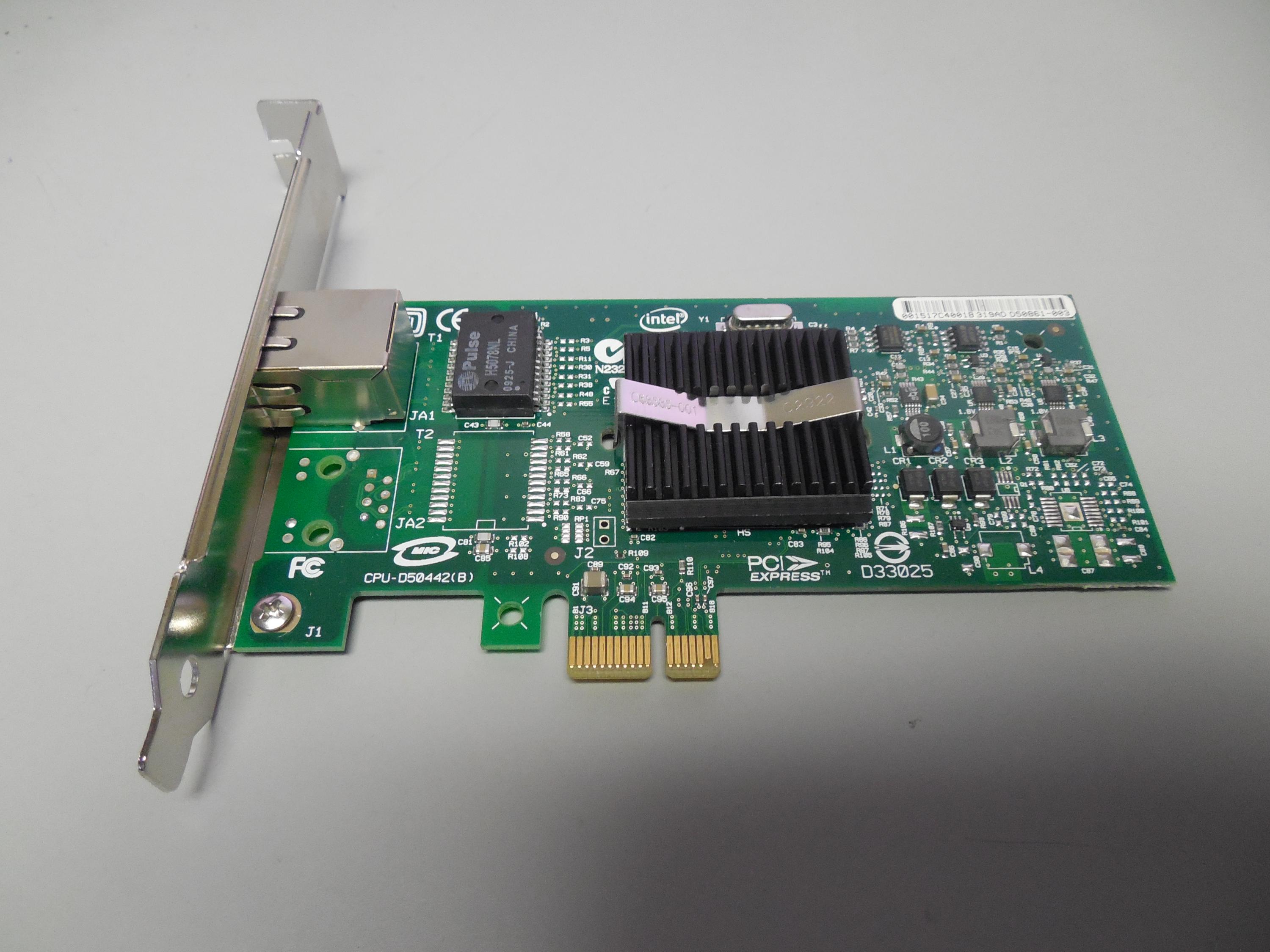

      before you spend time on this, see if the heatsink is getting very hot, then unclip it and and make sure the chip does not have a hole burned in it.

        @stj, I also thought I'd check if the IC is warming up. And yes, it gets hot, but I can hold my finger without feeling too much heat. So clearly it does not have over 60 degrees Celsius. I have an IR thermometer and I will check it for curiosity.

          the usual problem btw, is thunderstorms.
          the long network cables act as an antenna and the transformer converts it into something more damaging!

            But I did not know if that test was done before or after the protection device is removed, the way I understand your thread is that you did the clean install the driver but it still does not work then you inspect the board and found that blown device, but I did not know if you try it again after removing the protection device or not, sorry if I did not read your post correctly.
            And if it still does not work then you have more damaged components on the board.

              I installed and checked the board from the beginning, that is, a few months ago. I have already said that it was seen in Win 7 with default drivers but I also installed proprietary Intel drivers. I also did the Intel Intel test that detected RX or TX data packet transmission problems, I do not remember exactly.
              The visual inspection I did last time, that's 2 weeks ago, when I've also desoldered the component. Because it was strangely detached from the underlying footprint, I did not think of installing it on a pc until I know what I'm doing.
              Now I'm beginning to understand that the possible overvoltage exposure may have favored the destruction of the ground pad of the pcb under the TVS diode.
