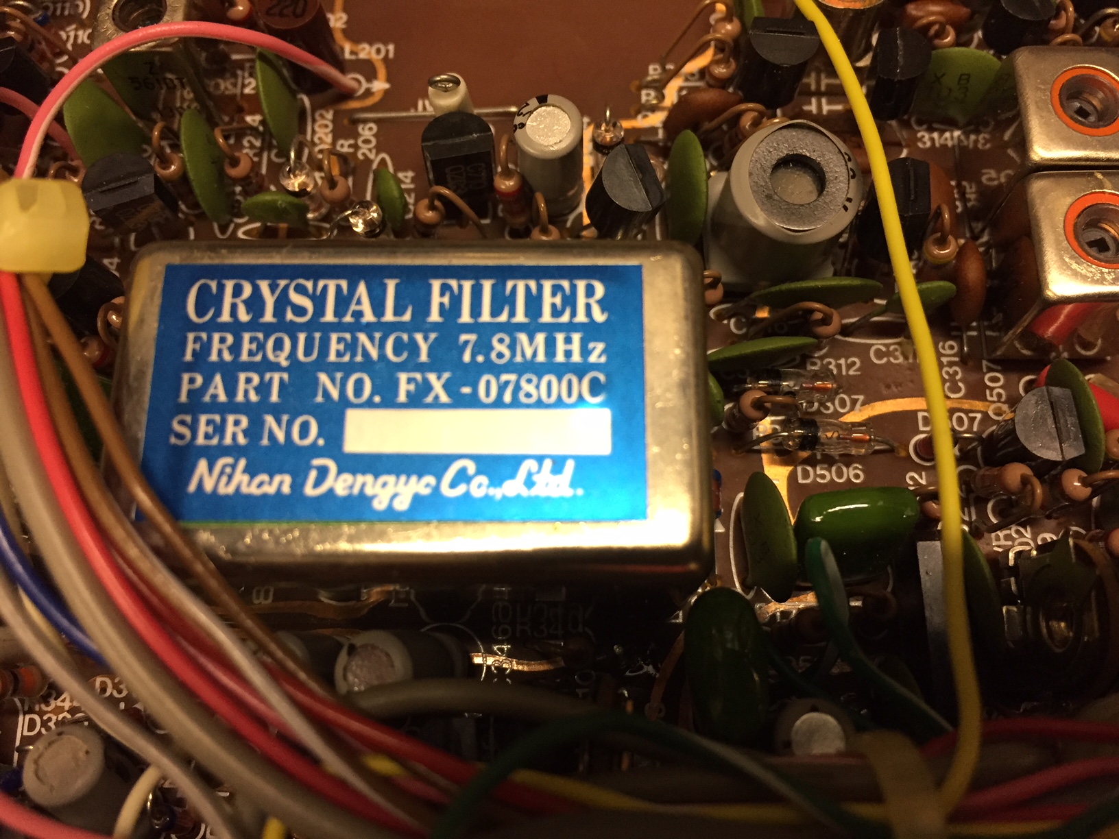

    Belcom LS120l radio (crystal filter)
    I am in need of a replacement crystal filter for this set, 7.8mhz not sure if these are repairable as it seems the set is passing both side bands and carrier through the filter. The problem is intermittent, I have addressed the bad soldering around the input and output pins which immediately helped with the problem (well the heating did) but after a few hours am back to the same intermittent failure.

      Opps I'm sorry I got this into the wrong forum, could some one please move it to
      Troubleshooting Game Consoles & Other Weird Devices please, There wont be any electrolytic s in there, maybe some ceramics in there though, casing appears sealed though. Will have to scope it, annoyingly it seems to be working at the moment.

        Just a crystal in it... or a bunch of crystals. Yeah unfortunately you'll need to locate an identical unit or substitute, there should be no electrolytics in it.
        Likely one of the wires or plating fell off a crystal, and getting it back on would be tough...

          in the past maybe, now we have carbon-loaded conductive glue.
          very cheap on ebay.

            Would that affect the crystal vibration frequency with additional mass?

                From my understanding of the lattice crystal filters, they are made up from a series of crystals strung together, each one sealed along with the housing itself sealed with solder. The amount of thermal mass and heating required to disassemble the outer casing will probably cause more damage. I think I have located several candidate crystals rather than attempt to repair this one.

                  Yeah probably difficult to open, especially if it's crimped and soldered together. I wonder how much of a loss it would be if you replaced it with an RC filter, alas the Q is going to suck.
                  Getting a pile of 7.8MHz crystals will be tough too, I wonder why they don't make them anymore? I feel for you, this is worse than my crystal problem for my 2m radio...

                                    filter here ..https://www.ebay.co.uk/itm/Uniden-7-...YAAOSwI-BWIQ7P

                                      lol... that meter had a 15K resistor soldered, and it's still NOS? Hmm.
                                      I wish that guy showed a picture of the pins on the filter... might have been removed poorly.

                                        Thanks Pete, that was one of the candidate filters I located, the other being a US vendor who wanted 40$ just to put the thing in a jiffi bag and ship it. Well I have ordered the https://www.ebay.co.uk/itm/Uniden-7-...YAAOSwI-BWIQ7P and hoping it fits the pcb and more importantly works lol.
                                        will keep you updated
