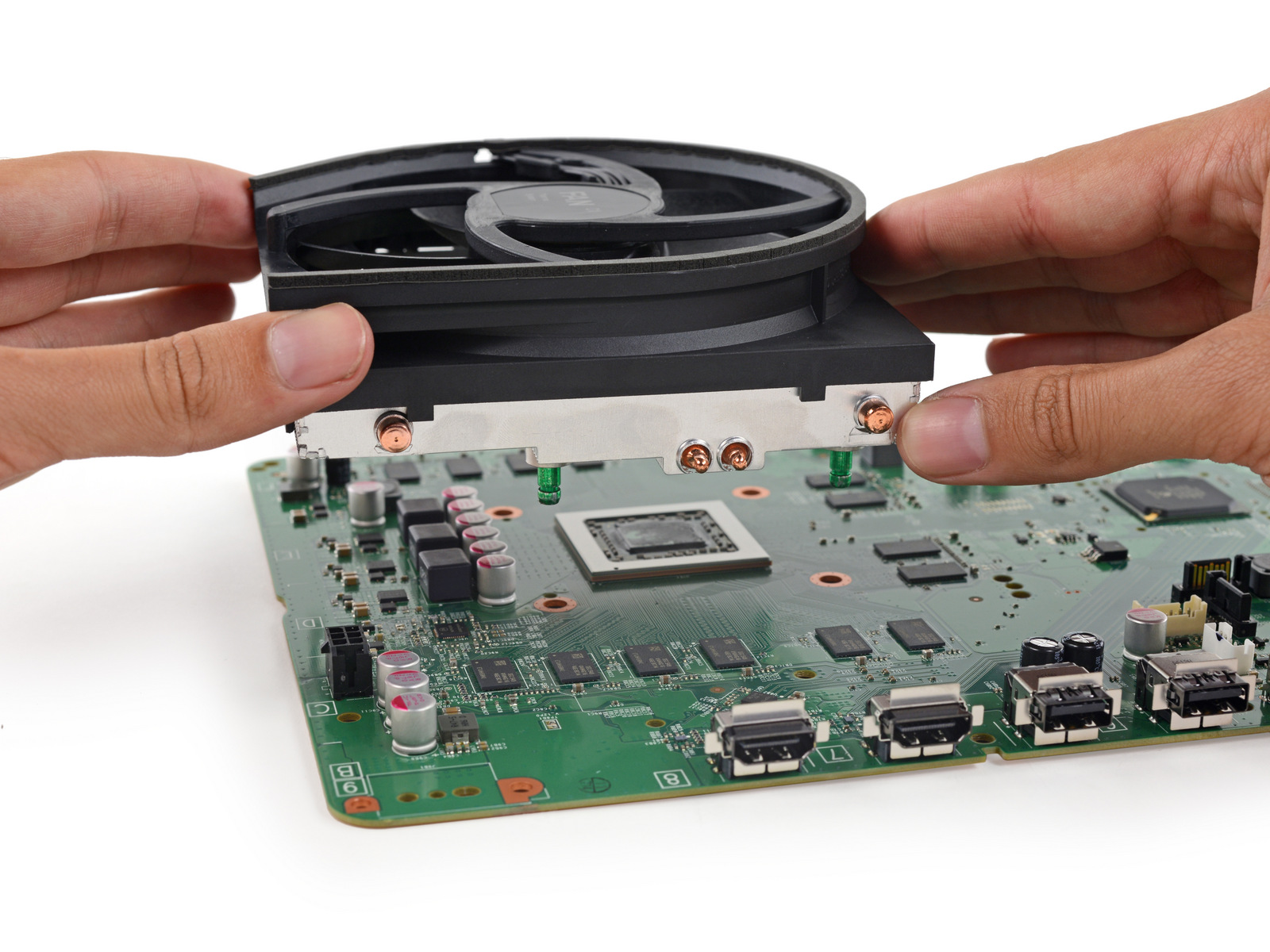

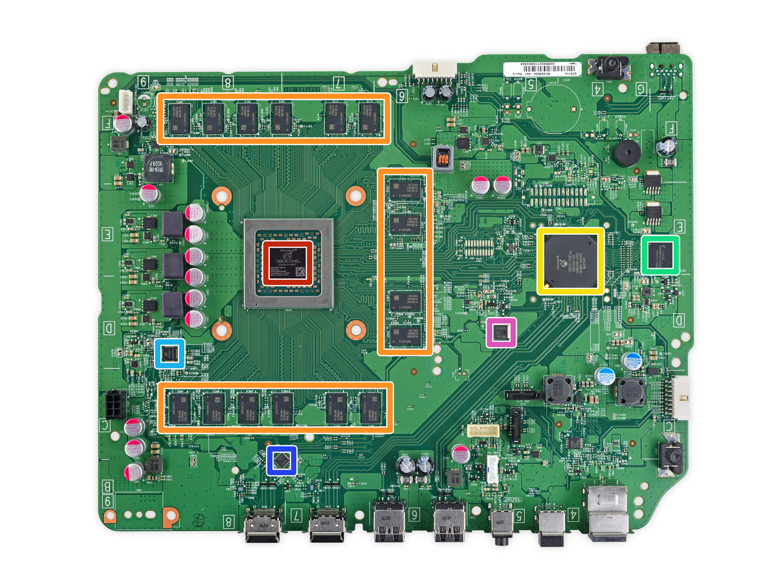

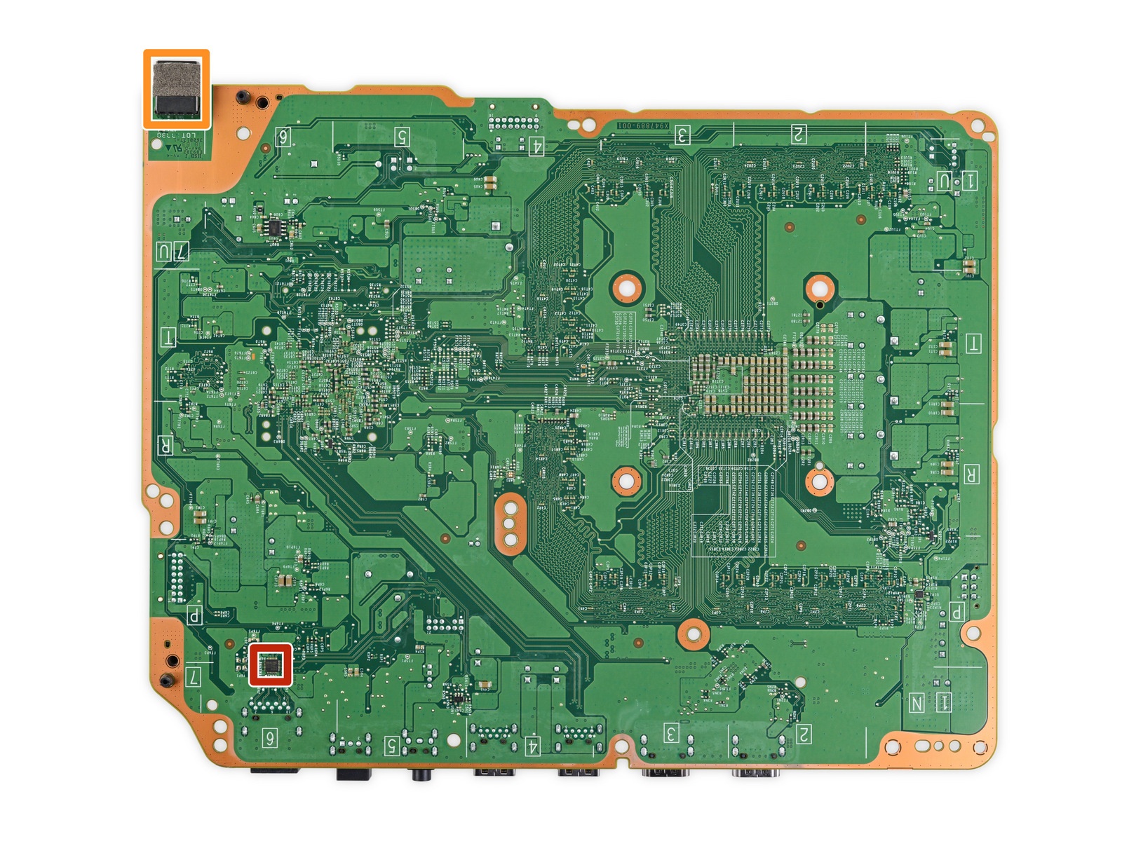

        Re: XBOX One S USB Port
        Some photos courtesy of ifixit

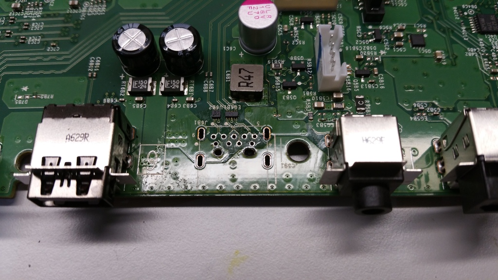

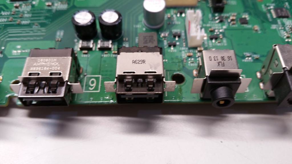

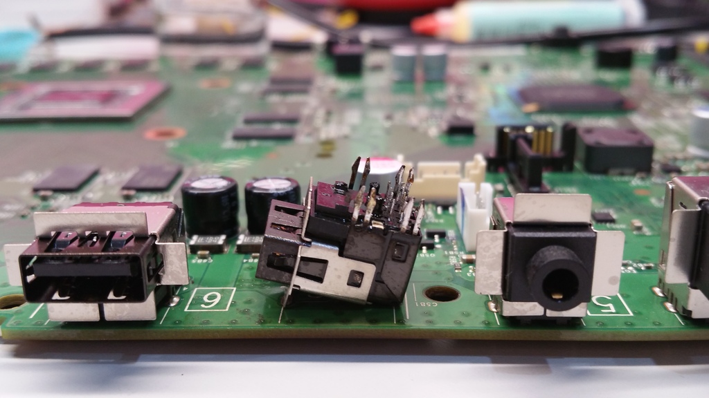

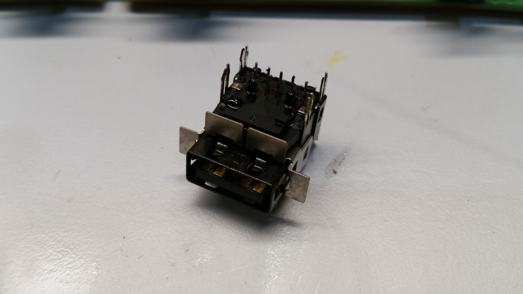

                        This is the customers board with the damaged USB port
                        I have removed the USB port from the donor board
                        Donor board is undamaged
                        First thing was to dilute the lead free solder by flooding it with nice new lovely leaded solder and then get the hot air gun on it. That took a while, but it came away eventually.
                        Next thing to do is remove the damaged port from the customers board, wish me luck!

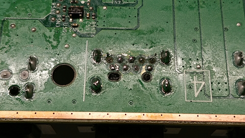

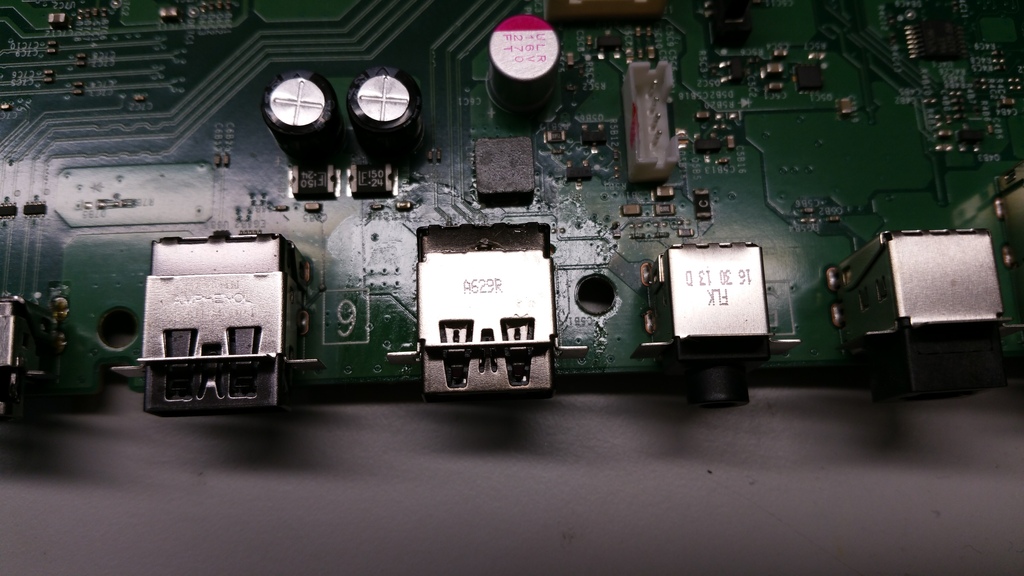

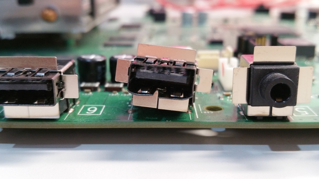

                          Getting the damaged USB port off the board was an issue but I got it.
                          Replacement in place
                                    I use the silver bearing solder and love it, but it's from RadioShack. I cannot get anymore of it, but am running low. I always do like you, but add the silver bearing, which I believe requires a bit higher temp.
                                    But can you recommend a good brand of silver bearing solder by any chance? Glad you got your ports off and everything fixed.
                                    Oh, did you preheat the board, so it didn't warp, or wasn't it an issue?
                                    Could you please upload the pics here instead of the photobucket, as requested by the other users? I'd like to see them. You probably cannot edit your posts now, but perhaps just reply with the same pics? Click on Go Advanced and you should see an option to manage attachments.
                                    Thanks!
                                        Here are the photos in no particular order.
