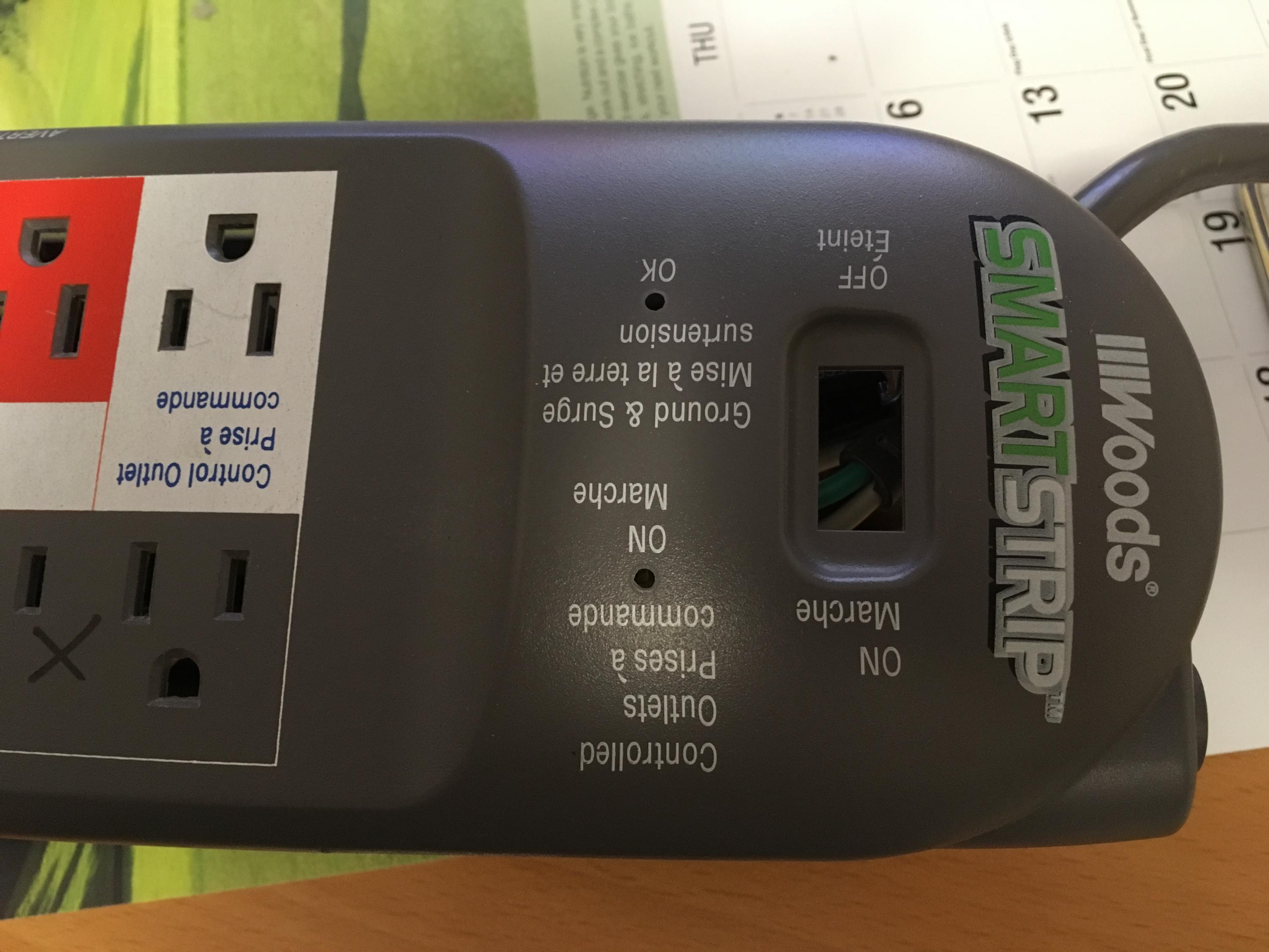

    This is my second wood's power strip / smartstrip that has failed
    I believe it is made by CCI and I see that the new ones are a different color (I don't actually know if it's the same model/ design).
    They last between 2-5 years and in this case, the controlled outlets would no longer turn on.

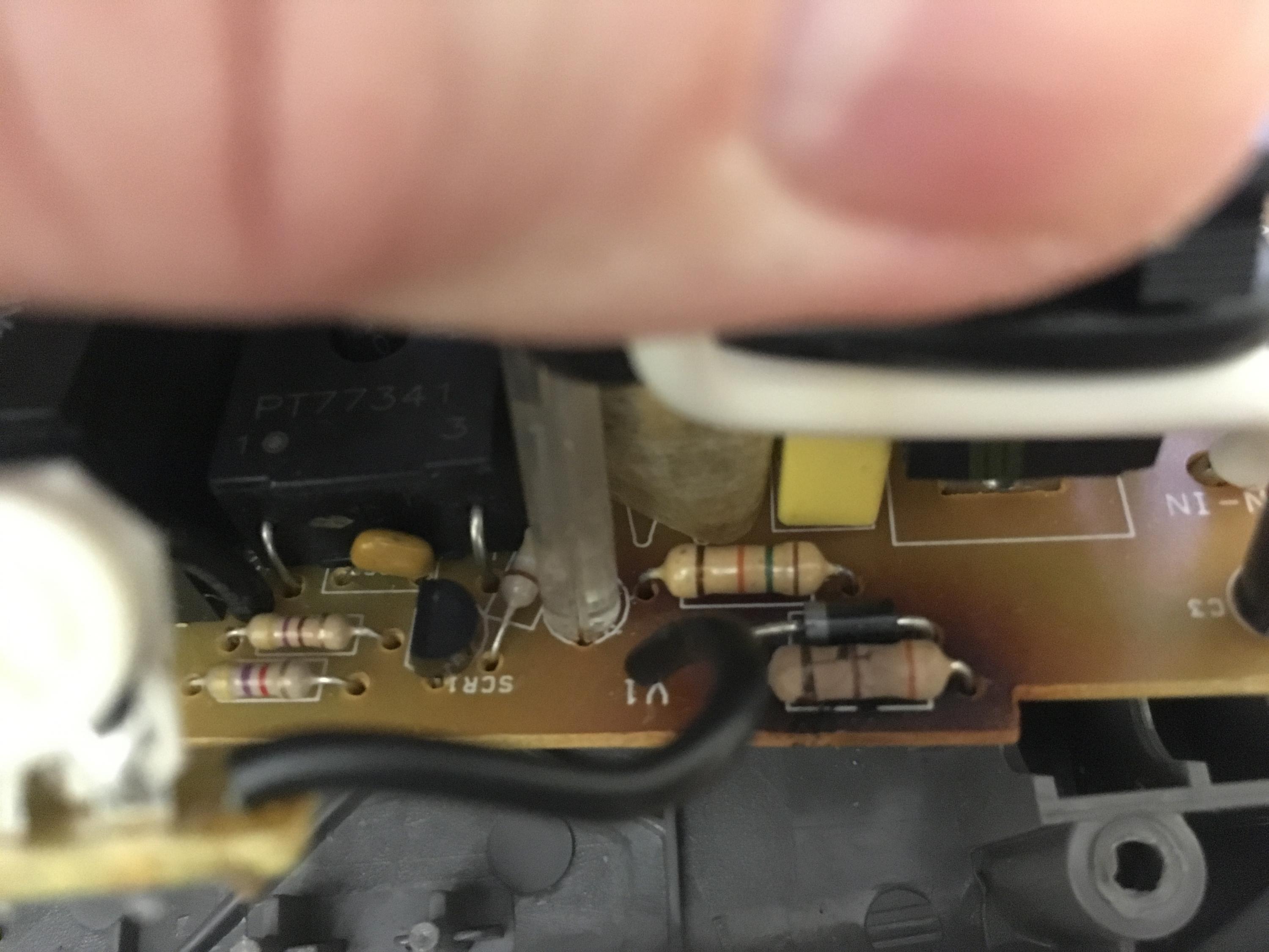

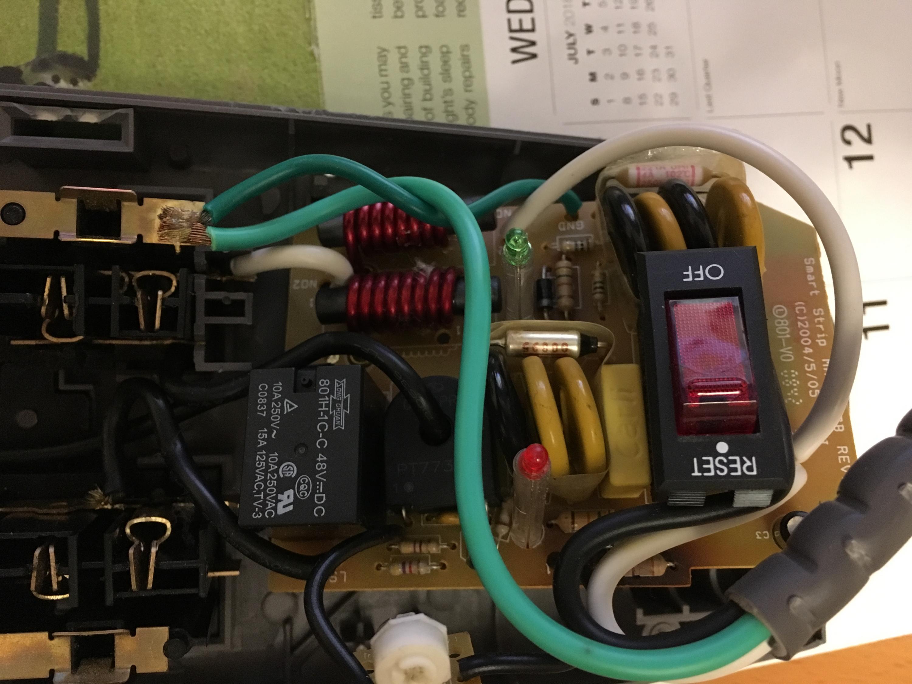

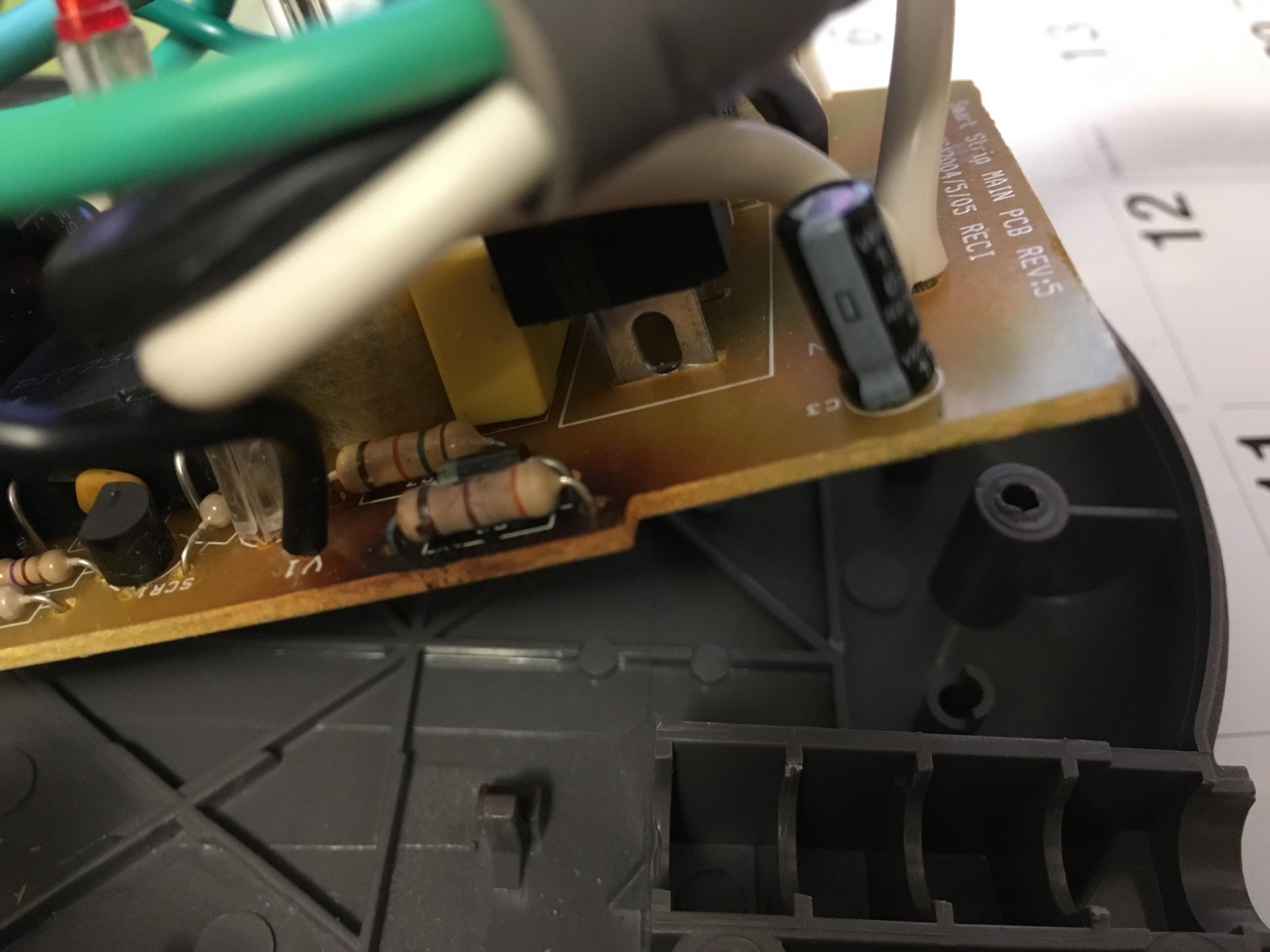

    I thought it was a bad cap but upon disassembly, I see it is a burnt out / cracked resister (at least on this one).
    I have appended pictures but will not attempt a repair as 1) power strips scare me...I've done computer power supplies but there, they are surrounded by a metal to contain the heat hopefully.
    Anyways, in case someone has the same power strips and find that they are failing, this might give you an idea of where to look.

      I'm not sure about the thermal fuses-MOVs, though those are typical failures, I don't believe the 'smartstrip' feature depend on those (though I could be wrong). The overheated resistors are possible however as they may be sense resistors. I'm not exactly sure how the SCR fits in, usually used for latching but you want the strip to turn off... A detailed picture of the back side of the board would be interesting. And I wonder what that PT-77341 is...just a coil?

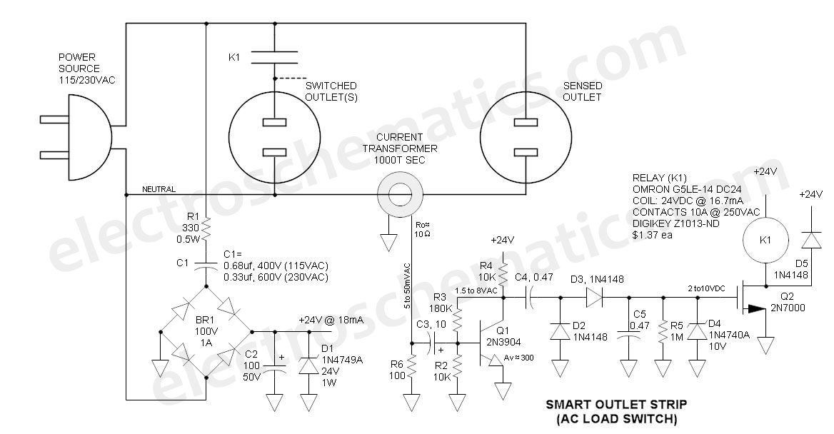

        That pt-77341 looks like a current transformer (sensor) It detects current from the load device then switches on the remaining outlets. The burnt resistor may be for the dc supply for the circuit, as it has current flowing through it all the time it might have just opened up.

          The 48VDC relay coil and the circuit that drives it probably uses the capacitive coupling power supply, we need GOOD CLEAR straight shot pictures of the whole bottom side of the board to trace out the circuit.

            The trouble is finding out the cooked resistor's original value. The resistor should not heat up unless the relay coil is on?
            It's a basic circuit, the CT turns on the SCR, which rectifies mains and is filtered to DC by tiny C3, which drives the relay coil.
            The Song Chuan 801H 48VDC relay needs only 7.5mA
            There must be 25 patents on Smart Strips, but I could not see which (SCR) one Woods is using.
              I second this - probably a failed capacitor-coupled power supply that's burned that resistor and making the strip not function.
