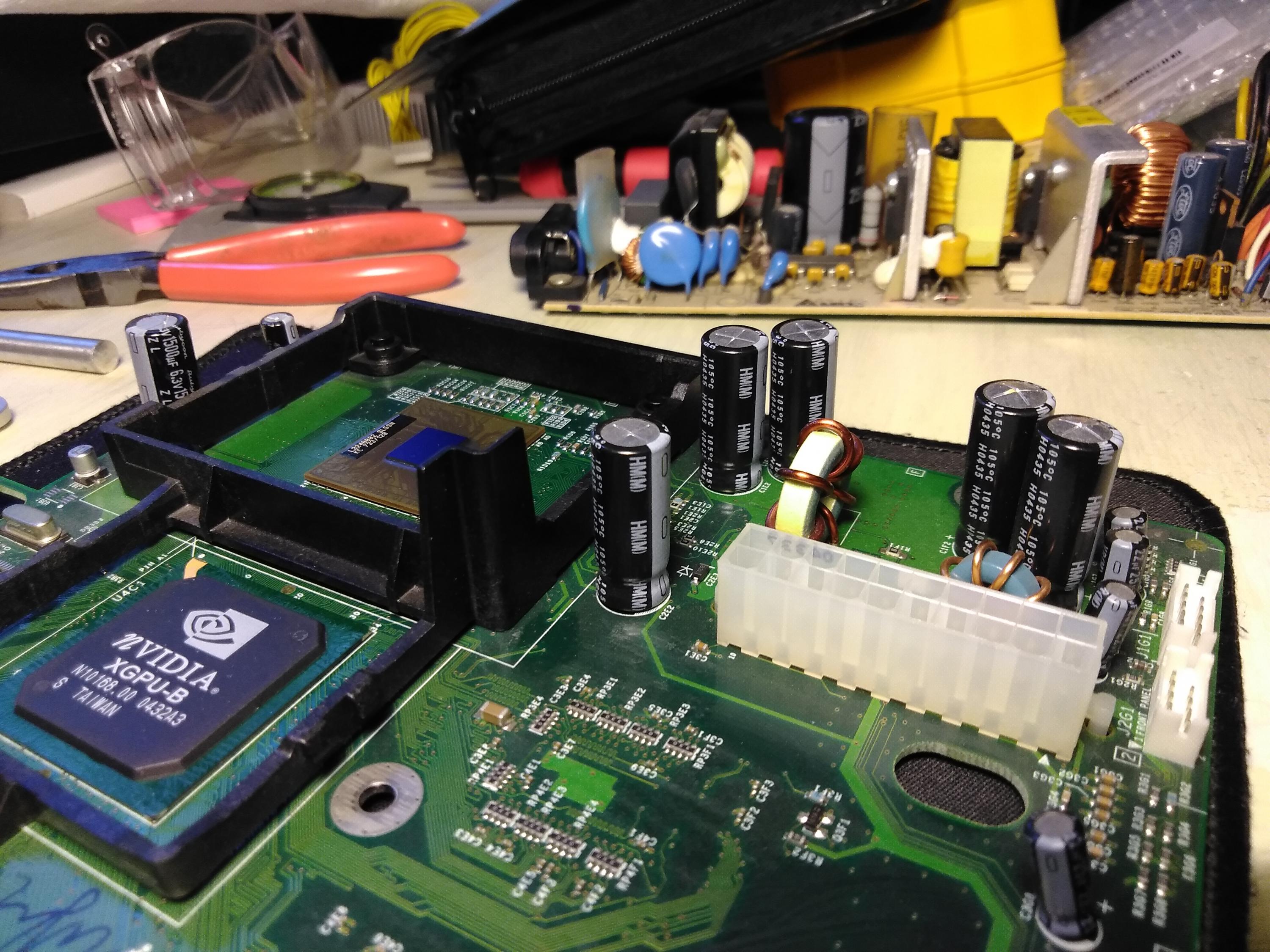

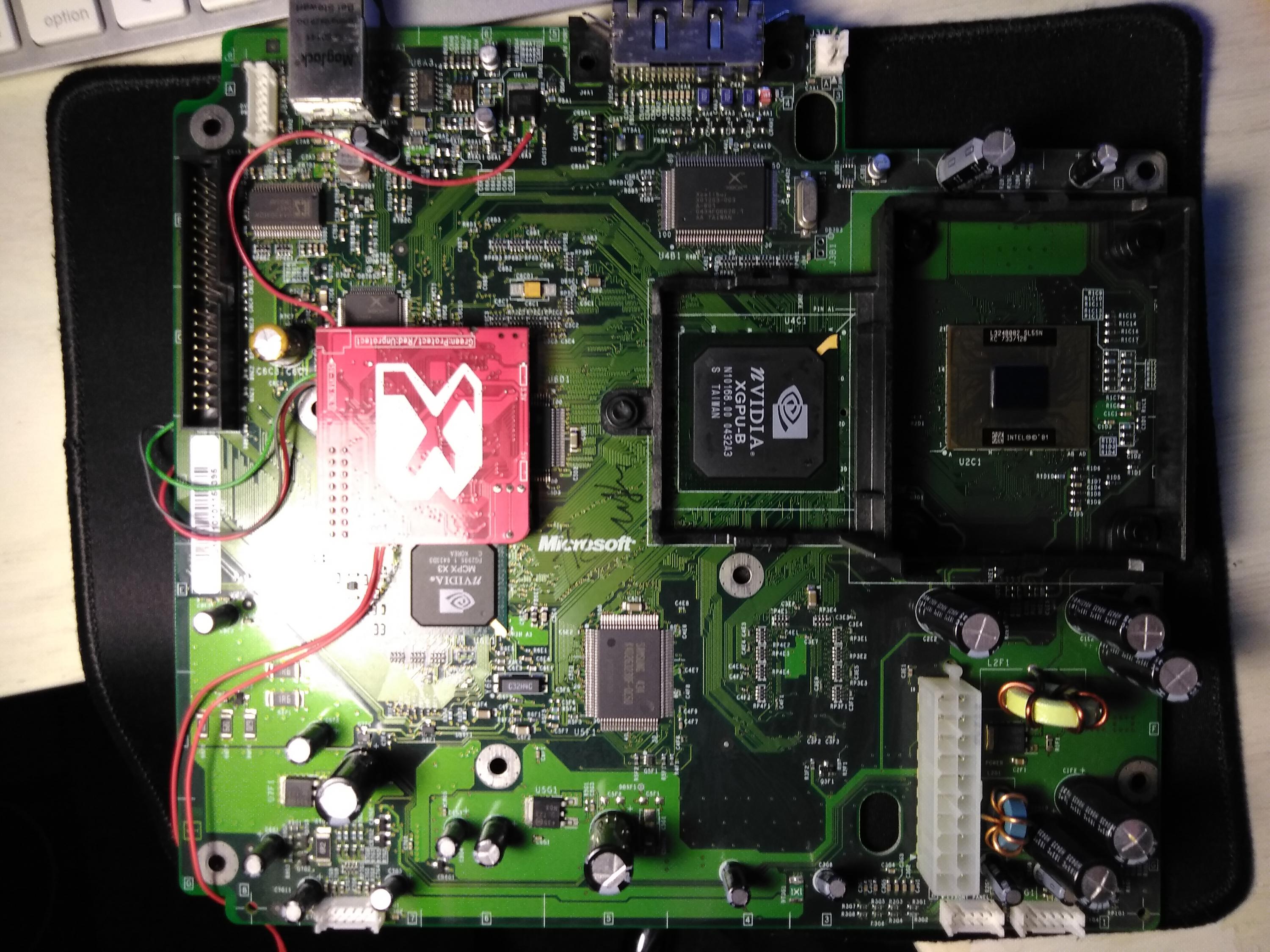

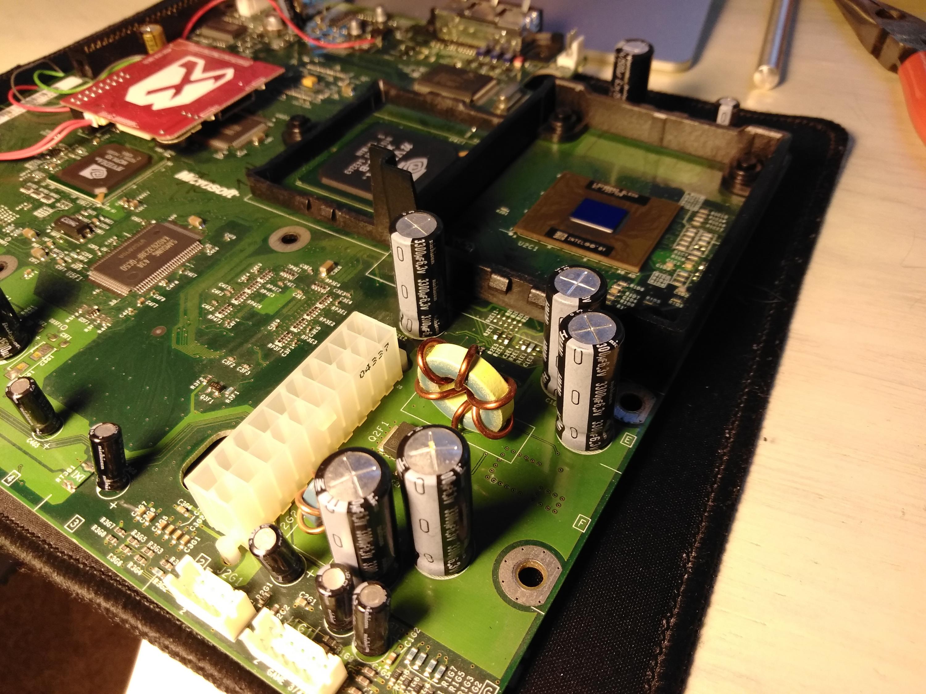

              Here are some images:
              https://imgur.com/a/bX9iHmP
                • 31199
                Re: XBOX V1.6 with bad caps
                for the 4 along the bottom, use these:
                https://www.aliexpress.com/item/32909529195.html
                for the 3 below the cpu, you may get away with them but i would get some 2000 or 2700 uf ones myself.
                worth trying the 1500's though.
                what's the rating on the one above the cpu?

                      That one above the CPU is a Richicon 1500uF 6.3v ZL 105C T0435.
                      "For the 4 along the bottom"
                      The two largest ones on the bottom left of the board are the same as the one above the CPU that you asked me about; Richicon 1500uF 6.3v ZL 105C T0435.
                      The two next to the power connector is the same as the 3 below the CPU, though.
                      Are you saying I should use the ones from Aliexpress for all 4 of those (2 bottom left, 2 bottom right?) even though they are different ratings?
