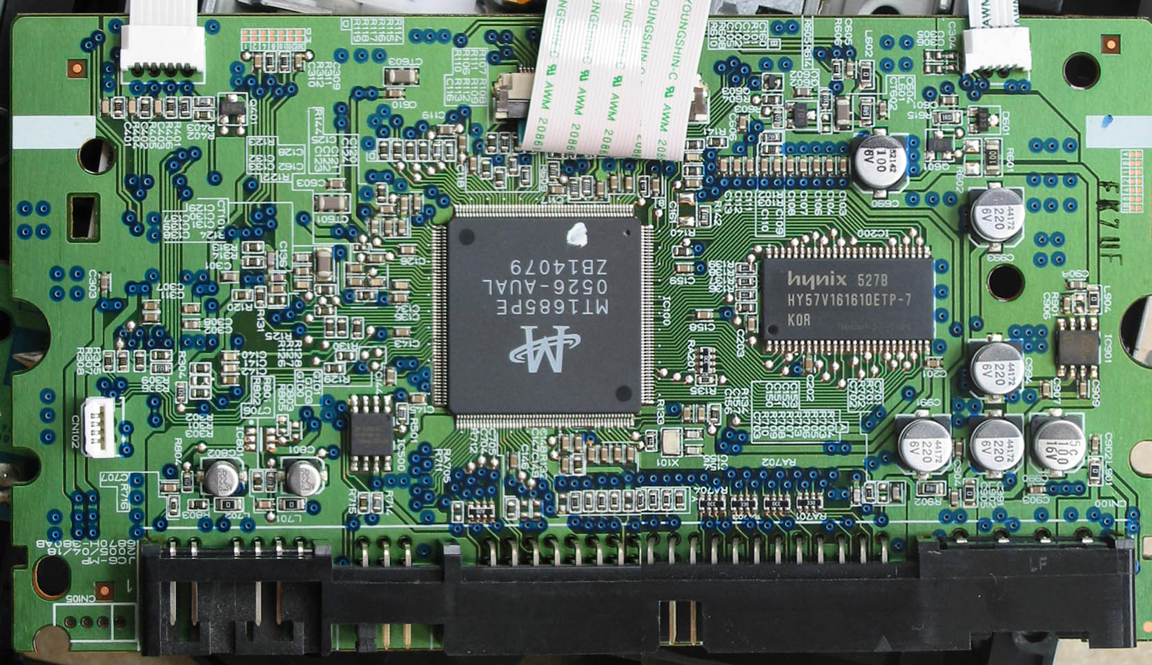

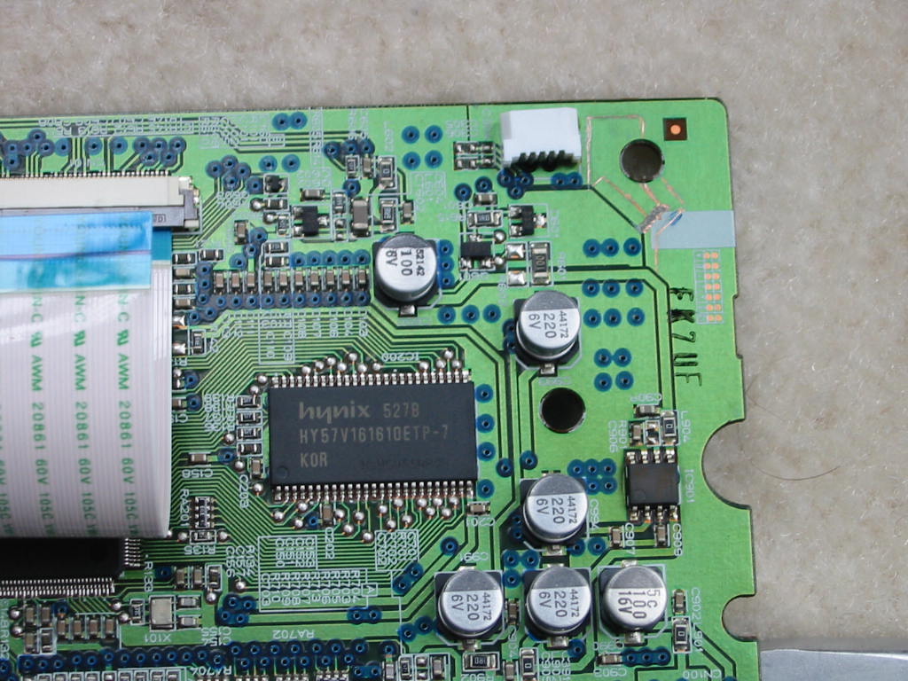

    Upon opening it, nothing seemed obviously wrong. I reseated all connectors and tested by powering up the drive with an ATX power supply, but it was still doing the same thing with the LED. So clearly there must have been a faulty component on the PCB. Speaking of which, here are the top and bottom pictures of the PCB:
    https://www.badcaps.net/forum/attach...1&d=1500859375
    After seeing all of the SMD caps, I wasn’t too excited about removing them to test. The first idea that came to my mind is solder some caps in parallel to see if that eliminated the problem. To do that, I started checking how the caps are connected (i.e. which voltage rails).

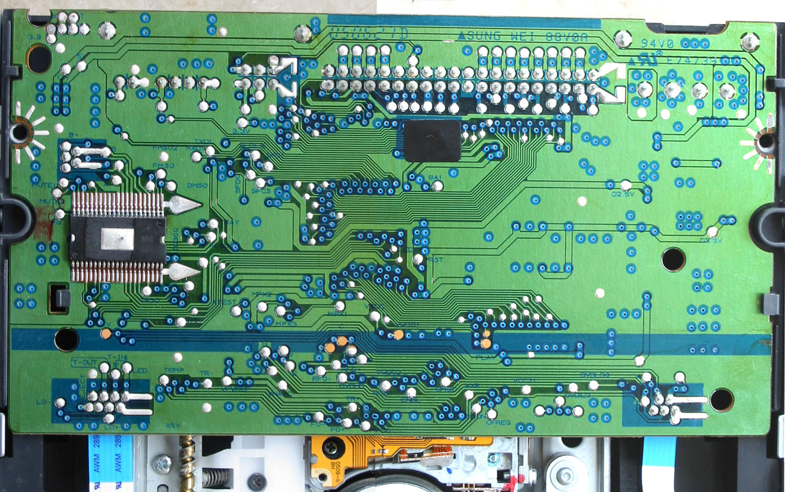

    While at it, I noticed a few more things: the bottom of the PCB had all kinds of test points marked on it. On the right side, I saw two test points: O3.3V and O2.5V. Measuring the voltage revealed that O2.5V was not present (just a few mV), but O3.3V was okay.

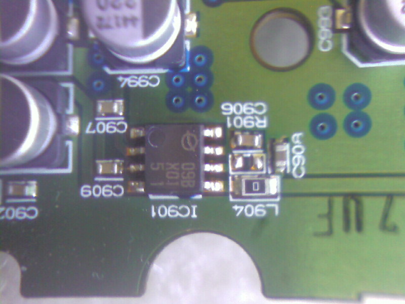

    This led me to look for the regulator responsible for generating the O2.5V rail. With not that many components on the board, it only took a few moments to trace that both O2.5V and O3.3V rails were connected to IC901 (labeled 09B X01 5 1, for which I couldn’t find a datasheed). Here it is from up close
    Resistance/continuity measurements revealed that this IC was indeed the source of both the O3.3V and O2.5V rails. I found the caps responsible for filtering its outputs, too: C690 and C994, respectively. I soldered some caps in parallel with these, as well as the input cap for IC901 (I can’t remember which cap that was, but I think C391) in hopes that the caps were the problem. Then I connected everything back up and applied power… but same thing again: LED stuck ON and 2.5V rail reading close to zero volts.
    The next logical step was to check resistance of IC901’s 2.5V output to ground. However, it was not shorted or low-resistance to ground. As such, I decided to go a bit “experimental” here and see what would happen if I inserted 2.5V from an external source without disconnecting IC901. I didn’t have an adjustable PSU bench (yeah I know, such a shame for someone that likes to troubleshoot electronics ), so what I did instead is take a diode and wire it from the 3.3V rail on my test ATX PSU to the 2.5V rail on the drive. With a diode drop of 0.6-0.7 Volts, I figured I would get about 2.6 to 2.7V. It looked like the 2.5V rail was used for the RAM cache chip, so 2.6-2.7V didn’t seem too dangerous. I also put my multimeter in series with that to measure the current, in case there is something wrong (in which case, I could immediately power down my test PSU… though I don’t suggest anyone to do rely on this method, as you can still do quite a bit of damage if something is shorted).
    So I wired everything and gave the ATX PSU a quick power on. Almost surprisingly, nothing smoked. However, I did get a bit frightened as I wasn’t expecting any noise. The noise came from the tray motor as it pulled the tray closed and the drive did a disc seek. But that’s good news – it’s probably alive!
    The 2.5V rail drew about 200 mA, if I remember correctly. And with my plain diode, it was actually dropping a little over 0.8V, meaning I was feeding the 2.5V rail with about 2.45V. Seemed good enough for me, so I popped the tray open and inserted an audio CD, then closed it. The CD spun and I could hear the drive start to read. – Yup, the drive was definitely alive!
    With that said, I started to think how to generate the 2.5V rail inside the drive. Surely I could take a diode again and have it drop voltage from the 3.3V rail from IC901. But that didn’t look appealing to me, as I thought it might overload the 3.3V output on the regulator (and knowing that the regulator already wasn’t outputting 2.5V, that just screamed bad idea). I also knew I had a bunch of 3.3V, 1.7V, and adjustable 1117 regulators from the numerous Xbox 360 motherboards I had scrapped over the years. The adjustable regulator seemed like a better idea, as I needed around 200 mA of current and I could use the 5V rail to supply that.
    Some quick power dissipation calculations revealed that with a 5V input and a 2.5V output, the regulator would be dropping 2.5V. At 200 mA, the power dissipation would be 2.5V x 0.2A = 0.5 Watts – definitely something the regulator could dissipate if mounted on a small copper pad on the PCB.
    As such, I took a SOT-223 1117 adjustable regulator from my parts box and started thinking where I can place it on the board so that it could have its own small copper pad to dissipate heat while also being close to the 2.5V test point. Next day, I came up with an idea. I drew on the PCB where I needed to make cuts and decided to proceed.
    Probably not the cleanest job I’ve ever done, but at this point I just wanted to have the drive fixed.
    I scraped most of the mask off the pads I had just cut away and soldered everything into place. This is the result:
    As you can see, it is just a standard 1117 adjustable regulator design with two tiny SMD resistors of equal value used as the dividers to set the output voltage. I don’t remember what value I used for these, but I think it was 1.2 KOhms or something like that. Basically, I just started pulling resistors from a scrapped Xbox 360 motherboard, and these two were the first that had an equal resistance value that seemed reasonable for the circuit.
    Preliminary testing revealed that everything worked. But then I realized, the input of that regulator is probably too far away from any caps. So I did a small revision and added a 4.7 uF ceramic cap right by the input of the regulator.
    Unfortunately, I couldn’t add an electrolytic cap on the input anywhere nearby as I didn’t see any space. However, I was able to conveniently place an electrolytic cap at the regulator’s output – yes, that’s the blue cap sticking out of the board like that. I know I should be ashamed here – not because of the way I mounted that cap, but because that is a crappy Jun Fu HK cap It did test okay on ESR and capacitance, though. Speaking of which, I forgot what capacitance and voltage ratings it had (most likely 100 uF, 16V).
    I probably should have done this repair a little better. Not only could I have used a better cap, but I imagine some of you cringed when you saw the thin magnet/copper wires loosely running over the PCB (but patted down with hot glue ), connecting to the 5V rail and O2.5V output. (On the other hand, think of them as wires with built-in fuse protection! )
    In any case, even with the crappy cap and whatnot, this CD-RW/DVD combo drive has worked out alright. I did the repair back in January and have had the optical drive installed back in my PC since then. Still works, so I can’t complain.

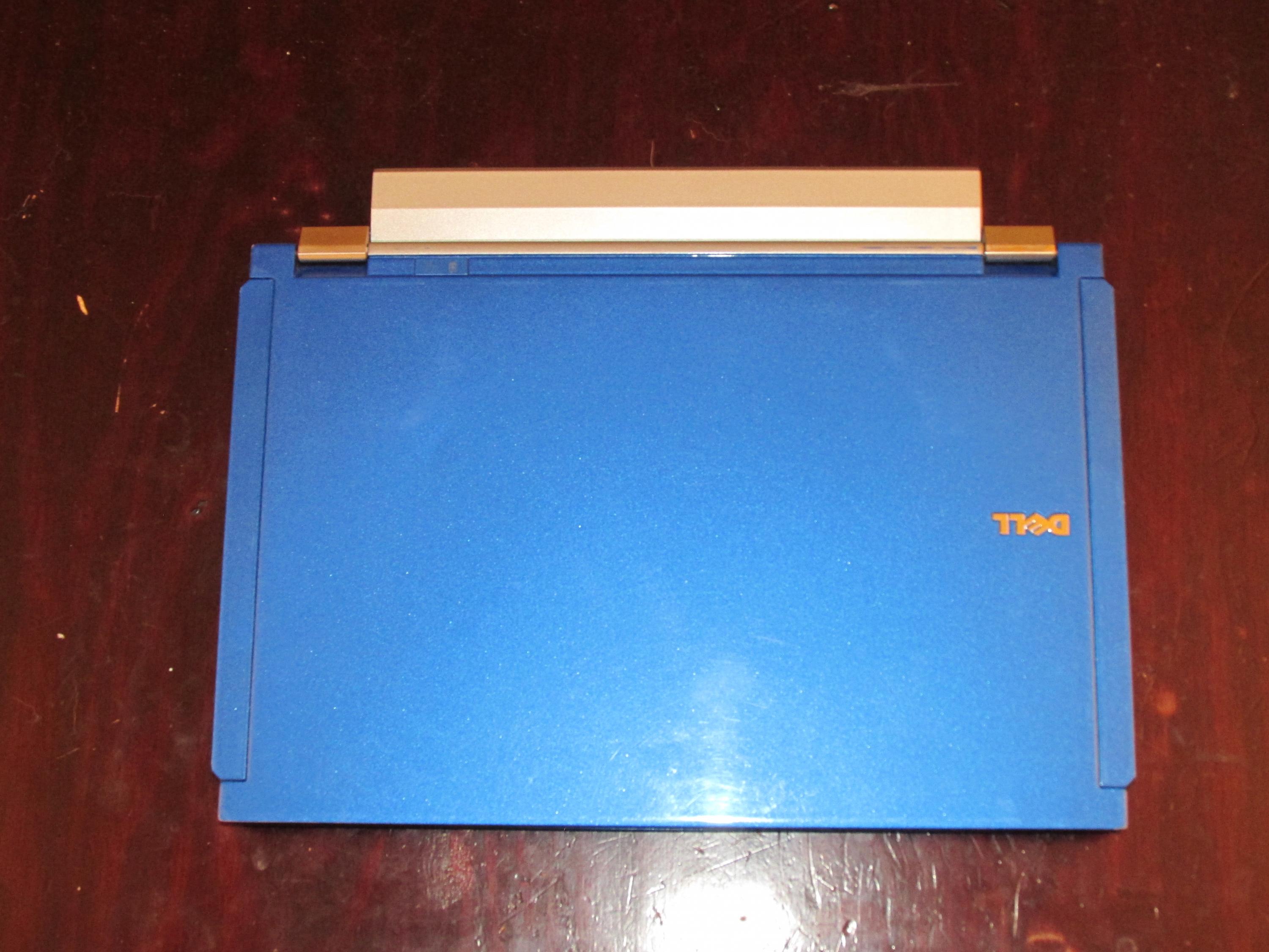

        I got this stripped (no SSD, RAM, Charger, dead batt) Latitude E4200 for $20, and proceeded to throw about $100 worth of parts at it (64Gb SSD - $30, SSD Cable - $5, batt. - $20, RAM - $20, Charger - $10) to get it working, you can pick up a working one for $50-$75 on e-bay these days (in silver or black), but I really wanted a blue one (somewhat rare color for these):

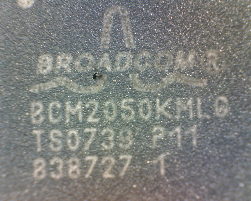

              One is 100% dead, it's from this thread: https://www.badcaps.net/forum/showpo...86&postcount=6
              As you can see the WiFi chip has a hole where the magic smoke has escaped, as does the amplifier!
              Oh, and the main processor is fried too, I guess this one is a bit beyond economic repair
