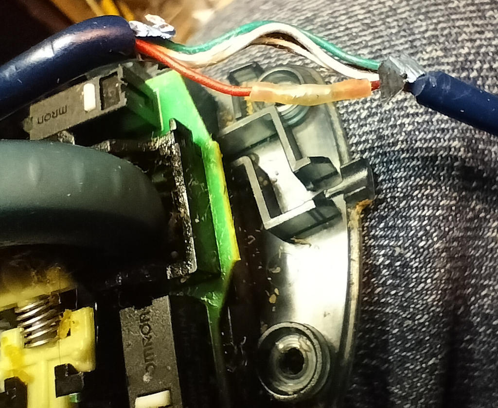

            Have not forgotten:
            Click image for larger version  Name:	pointless.jpg Views:	0 Size:	156.0 KB ID:	3525103
            Why did I bother... I'm currently using secondhand units from a thrift shop that will never have this problem.
