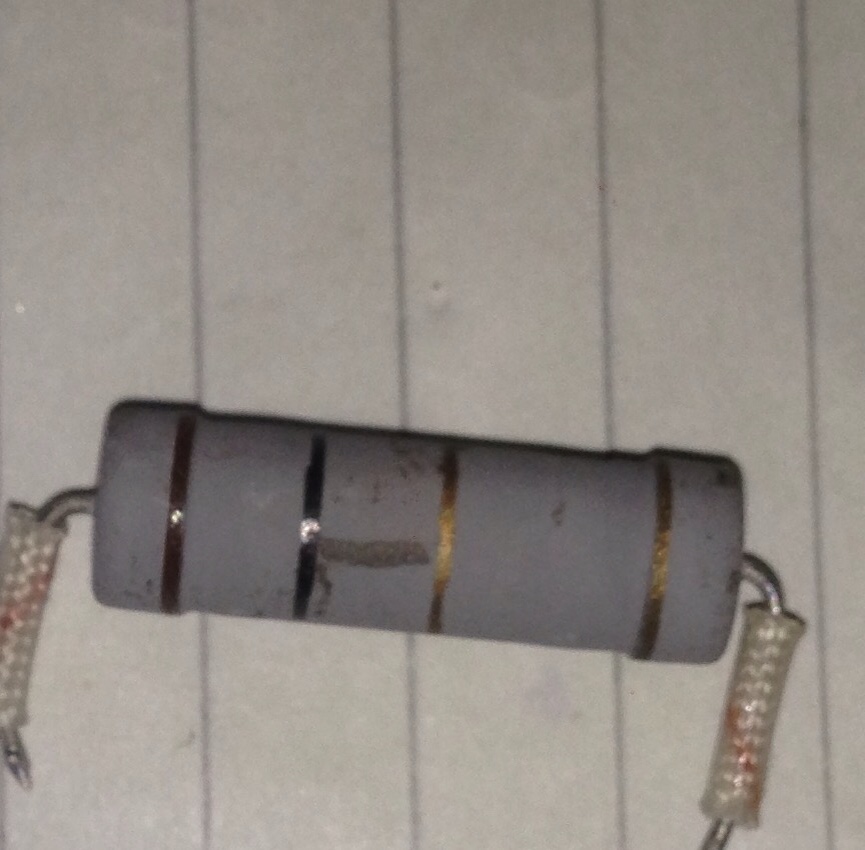

    Had csi 825 hot air station go bad.
    Getting bad readings on this resistor
    Could do with some help identiying the rating
  • zomi
    • Nov 2011
    • 505
    Re: Some help identifiying a resistor
    So its
    Brown Black Gold GOld
    1ohm resistor
    Its massive through
    3cm wide
    Its been used as a fuse resistor
    Any recommendations on where to source repalcement

      1ohm 5%
      wattage will depend on size.
      it's a flameproof type btw.
        http://www.maplin.co.uk/p/wirewound-...m-resistor-h1r
        will that replace it ?
        Its 24mm Length
        8mm width

          If it's used as a fuse resistor you may have a short somewhere else too.
          Source from wherever you like. eBay, Farnell, Digikey, etc.
          That one you linked to should be fine, but it's not going to fail like a fuse in the same way as the old one did on overload. You may wish to add a real fuse in series as well.

            The element blew out
            And took the fuse resistor with it..
            A glass fuse ?
            thanks for the info guys
              • 31090
              dont use wire-wound - they are inductive.
              use metal film type

                Glass is OK, ceramic is better.
                Would the inductance of a wire-wound resistor really matter here, given that the heating element is probably coiled and has its own parasitic inductance anyway?
