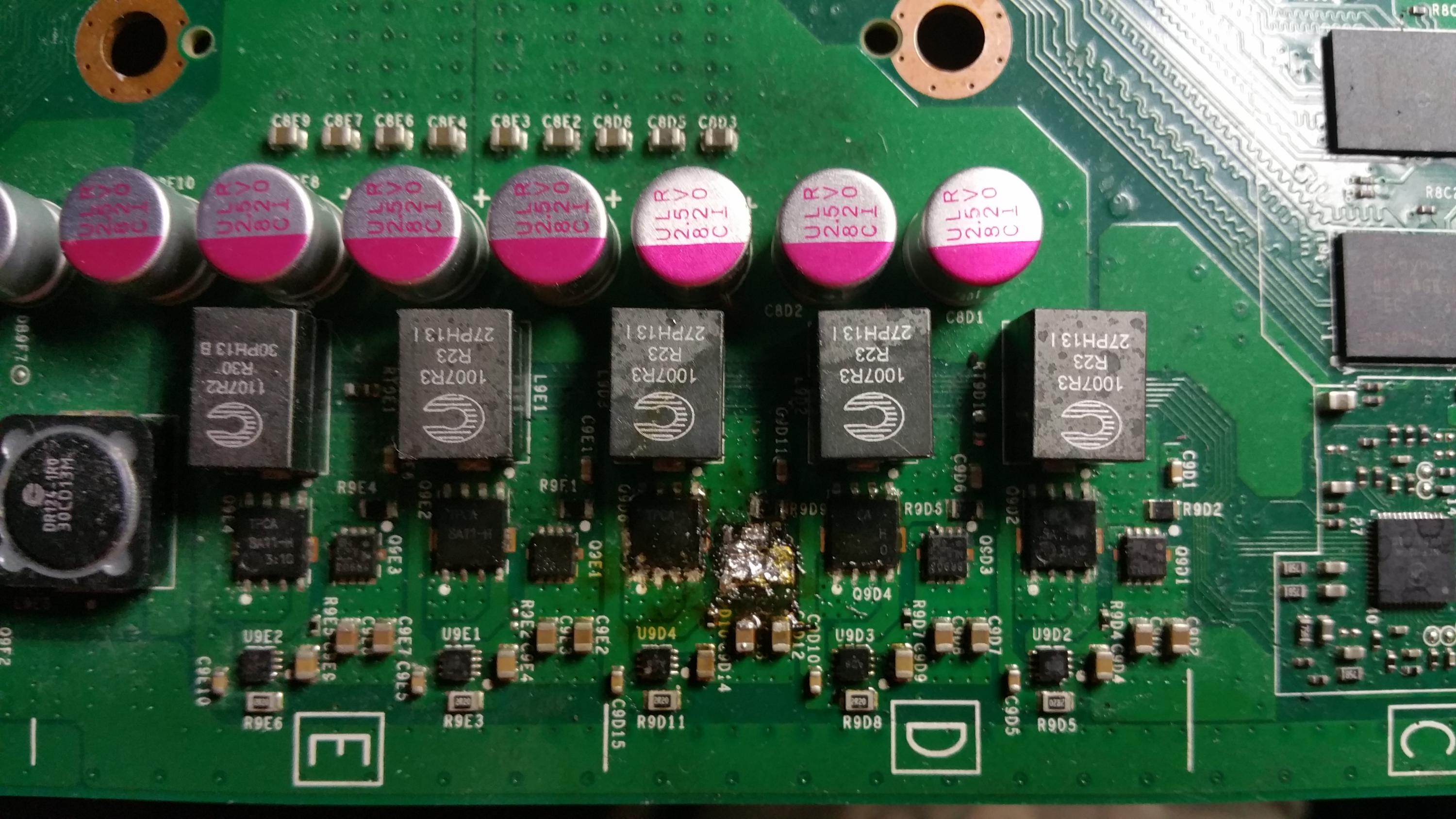

    The 12v line is shorted right at the power connector. Nothing looked bad until I removed the heatsink and found a destroyed mosfet. After removal the short remains.
    This component is in a bank of five identical circuits as shown in the pic. I'm getting strange reading off these, some read shorted whIle others don't. Not saying it's not possible but something tells me not to trust these readings just yet.
    As this board is a challenge to work with because of its thermal mass was hoping for a little guidance. Searched for schematics but evidently there are none.
    What's the best course of action ?

        Those 5 switching circuits look to be BUCK Converter, so I would check the Diode for the output section and the filter caps too.

                              remove all those 1007r3 inductors that are connected in parralel (the all 5 should be, but if you can then you should remove all those five inductors)to the shorted one. If the short is still in there then you have a fried cpu/gpu chip. That´s it. By removing inductors you can tell where the short is - in the vrm side or the gpu/cpu side. And when you are going to replace the parts replace the mosfets in a set (lower and upper) + the phase driver IC

                                    Just have to get it open and start testing. Since the 12V line appears shorted at the power connector, I would check all of the high-side MOSFETs on the CPU/GPU VRM first. Any MOSFET that shows short-circuit between Gate and Source or Gate and Drain is a very probable suspect and should be removed and tested outside of the board again.

                                        That's normal for *some* of the MOSFETs (since the CPU/GPU has a very low resistance and will make MOSFETs on the lower side of a buck converter to appear as shorted).
                                        So do check if there are some that have Gate to Source or Gate to Drain short-circuit... or resistance less than 100 Ohms.
                                        If not, then I guess it's time to start pulling MOSFETs and testing them one by one outside of the board.
