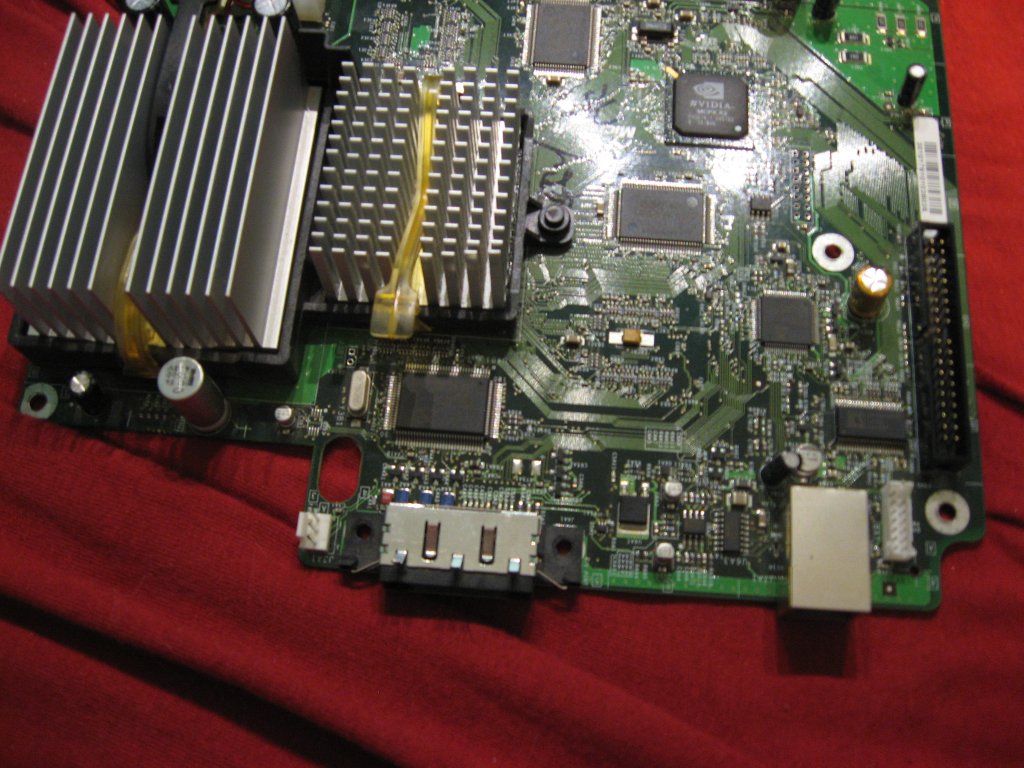

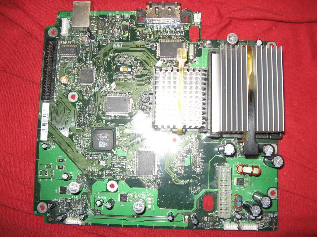

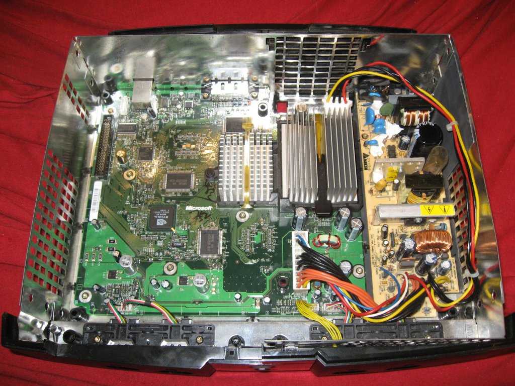

        Sorry for the late reply, but I did some parts swapping and now I know it's the motherboard. Now to fix it. I'm going to upload some pics, maybe someone will see something I didn't see. Sorry if some of them are blurry.
        Here is the system in its case, minus HDD and ODD.
        Here is the motherboard by itself.

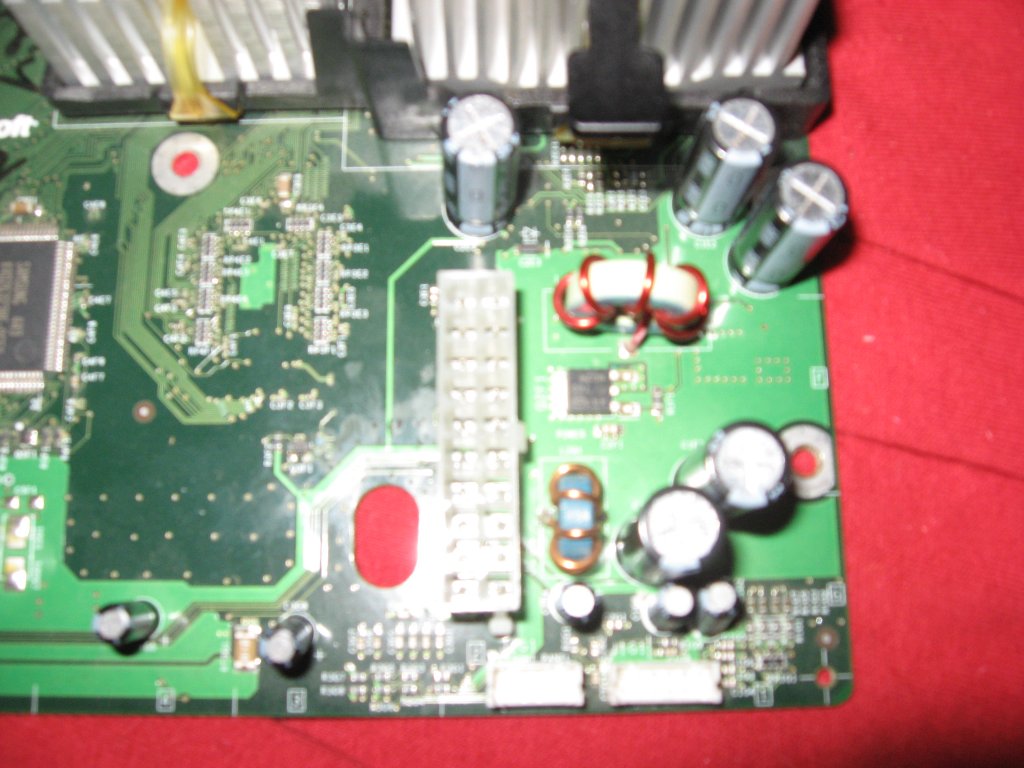

        Here is a close-up of the board at the power connector.

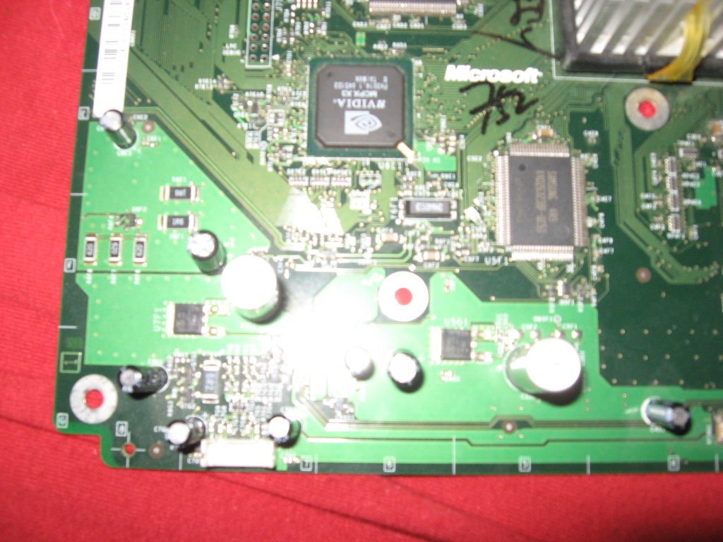

        Here is the front left corner of the board.
        Here is the back left of the board.

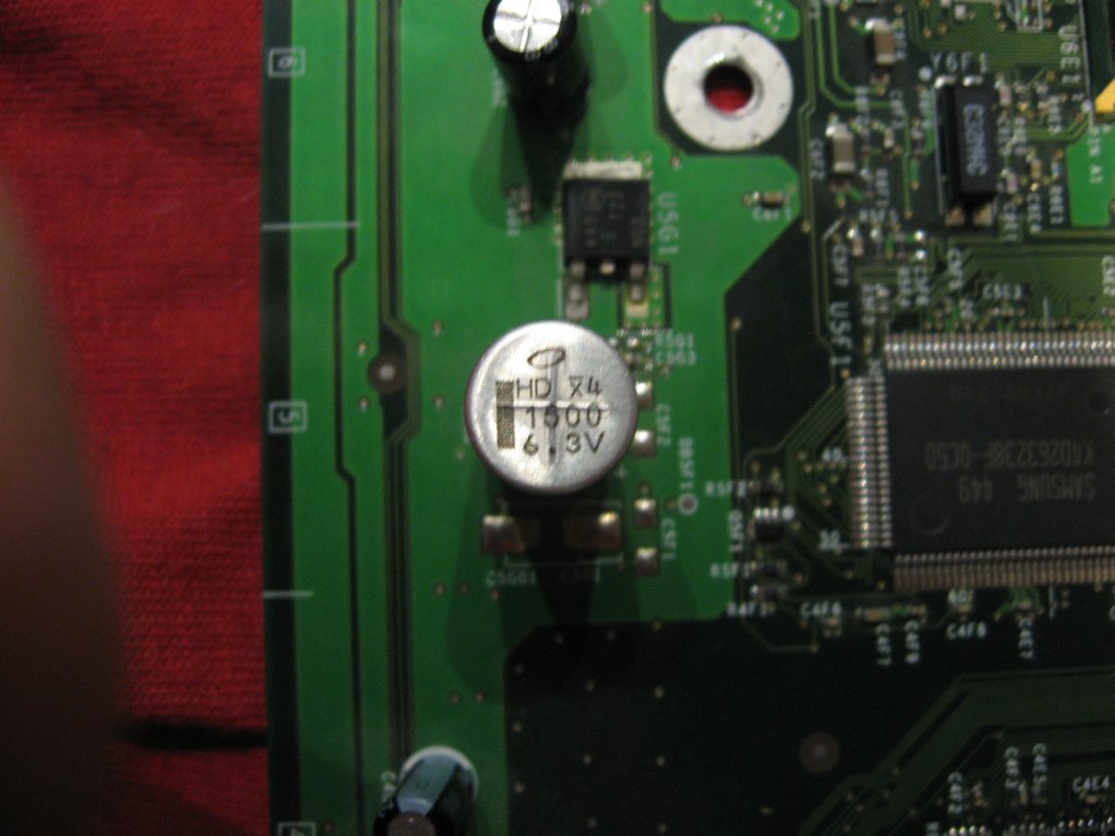

        Here is one of the large caps. doesn't appear damaged (to me).

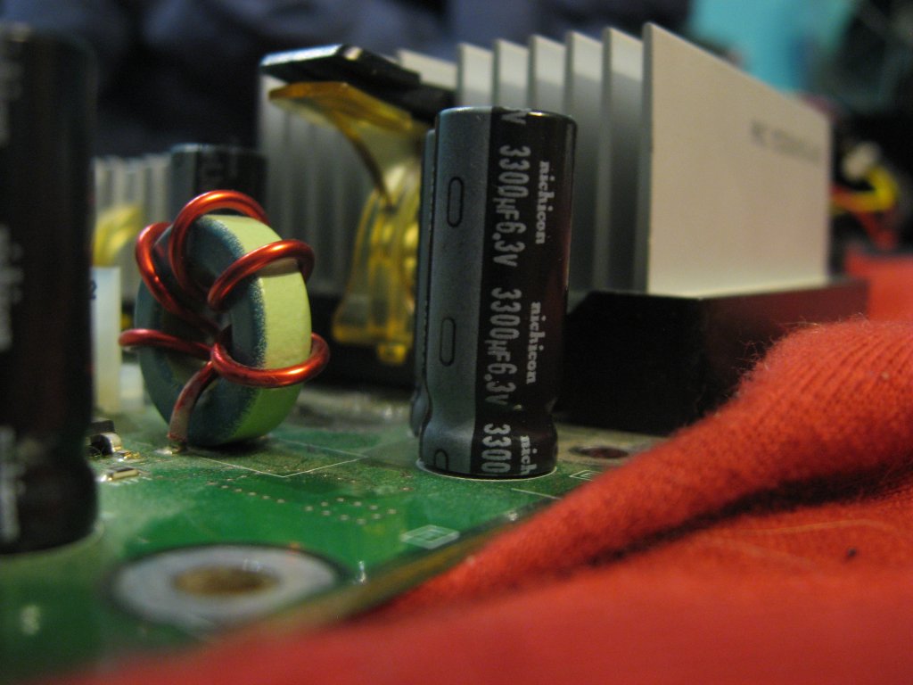

        Here is one of the other kind of large cap on the board. Is it a different kind of cap, or is it just a different package?

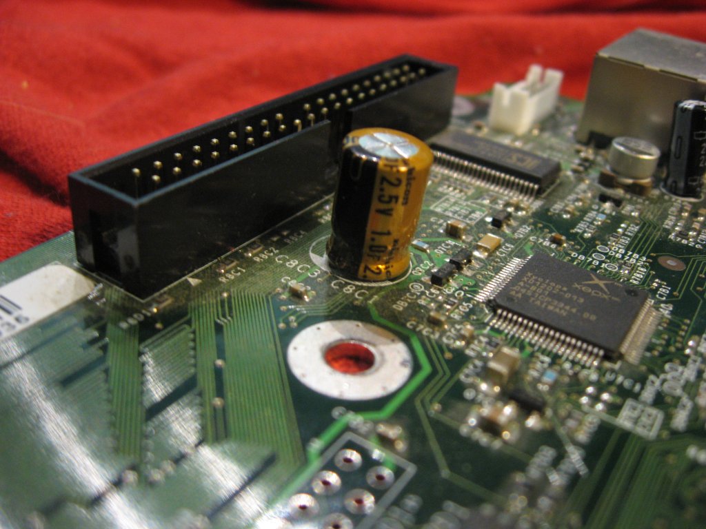

        Here is a gold colored cap. Is it different, or just has a gold wrapper?

          Alright, here is a list of the through-hole caps on my motherboard.
          nichicon 3300uf 6.3v X5
          hd x4 1500 6.3v X3 see note below
          nichicon 22uf 25v X6
          sme 22uf 25v X5
          nichicon 100uf 25v X3
          nichicon 1.0f 2.5v X1
          total 23
          Note: I'm not sure what these are, pic 7 is a shot of the top of one of these. Hopefully someone can explain the value of this cap to me.

              The 1.0F capacitor is a backup capacitor used by the real-time clock, and I have read about problems caused by this capacitor - some have installed larger units (during repairs) for extended backup time during power failures.
              So therefore, the Xbox is designed to be plugged in all of the time to keep this capacitor charged and the real-time clock running.

                  the airogell cap is a bastard, if it leaks on a 1.6 then replace it with a 220uf low impedence cap.
                  if it's a 1.0 - 1.5 board just remove it straight away even if it's not leaking.
                  because it will.
                  1.6 boards wont start if there is no capacitance there - guess how i found out!
                  older boards run fine with nothing

                    The gold cap is from what I've read a RTC power cap, that's rated for 1 FARAD (kinda big, don't you think), but it's not leaking. I was poking around with a multimeter and found it holds a charge of 2V with the motherboard unplugged, so I don't think it's at fault here.

                    Now, could anybody tell me what the cap in the 7th pic is? And what about esr and temp and all of these other ratings that aren't labeled on the caps. How would I find out EXACTLY what I need to order? Also, should I replace all 23 caps, or just a certain group? There are also a few surface mount caps, do those need replacement? Is there a way to tell if this board is too far gone, or is it fixable?

                        Sorry, I'll reupload them. In the meantime, try google chrome.

                        Here is the clock cap. Seems fine to me.
