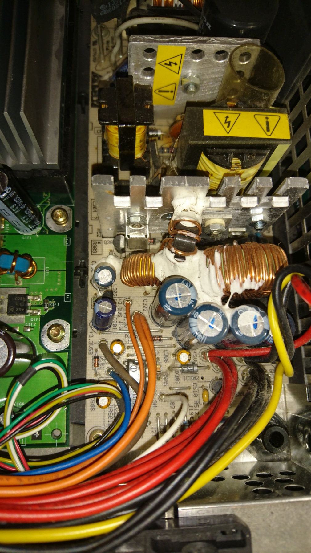

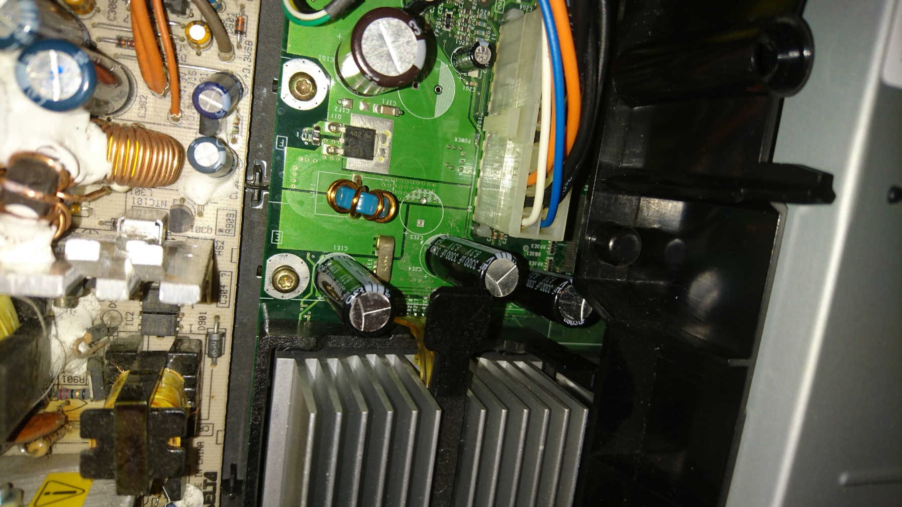

                          • Xan03
                            • Jan 2021
                            • 52
                            • Europe
                            #173
                            Re: Original Xbox Replacement Caps
                            Greetings,
                            I have a 1.4 Xbox that had those bad 3x3300uF+1x680uF Nichicon HM caps, symptoms were screen flickering etc. as mentioned above, already swapped those with Panasonic FR and the system is working great again.
                            Now regarding the PSU, not sure if I'd trust those caps there long term so I'm thinking of doing a preventive recap before putting in a new HDD. I neglected to make a pic of it but it's a Delta unit with Ltec 2200uF (LZG series according to an earlier post here). Did anyone who recapped theirs put an ESR meter to those caps? Mainly asking because all the glue in there does add some difficulty to it.
                            Also, I can choose between Panasonic FC and FR for the recap, I'm sure both would work but ideally would I just go FR for the entire thing or look up each cap and try to match ESR? For example LZG would be 0.030 or 0.035 ohms (not sure which size was used) while FR is lower at 0.018.
                            If I do go through with the recap I'll be sure to post some readings as I do have an Atlas ESR60.
                            • jayjr1105
                              • 281
                              #174
                              Those power supply caps hold up surprisingly well considering they are tier 2 caps. I recapped a Foxlink for fun and all the old caps tested fine with ESR. If you want to do it for preventative measures then more power to you. I used Rubycon for the most part as Panasonic's were always bigger.
                              Back in this thread a few pages you can find my foxlink recap pic... https://www.badcaps.net/forum/showpo...&postcount=124

                                #175
                                Well looking at it again I think I'm going to leave it alone for the time being, unless someone comes up with a report of those Ltec caps failing. There's a ton of hard glue between the coils and those caps, going at that with a knife has a risk of cutting up the board. I know isopropyl could probably be used to soften it but that would be messy as well.

                                  #176
                                  They do, but not as often in these older power supplies. Not sure if because older Ltec were of better quality or because PSUs just didn't stress them as much back then. But if you see Ltec in equipment made after ~2007, definitely replace them, because they are guaranteed to be bad or go bad. At least from what I have seen, 2006-2008 is when they seem to have started (or went) downhill. Nevertheless, keep an eye on those Ltec caps once in a while if you do intend to leave them in there - especially after the Xbox has been stored for a long time with no use (over 6-12 months.) For some crap caps, keeping them in storage without use can be just as bad for their reliability as using them.

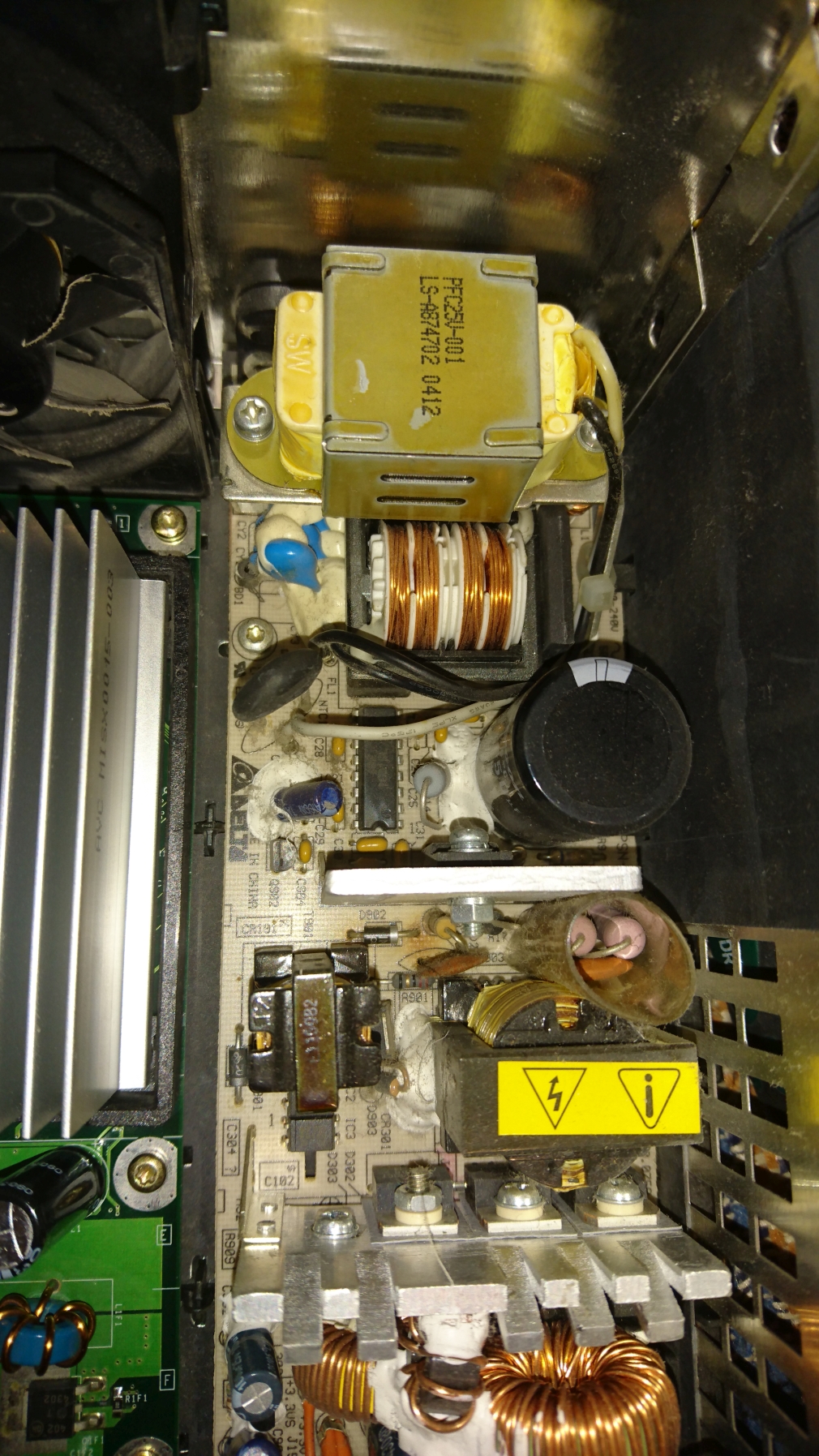

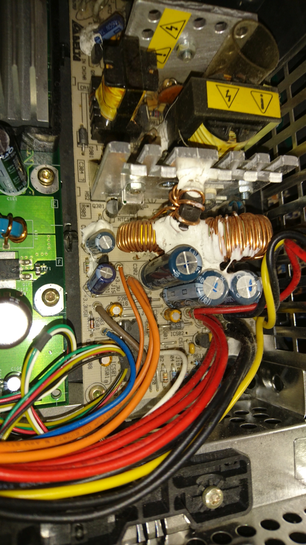

                                  • Xan03
                                    • Jan 2021
                                    • 52
                                    • Europe
                                    #177
                                    Thanks for the info, and yeah, that was the story with those Nichicon HM as well. The unit worked when I got it some years back before even knowing about them, then didn't use it for 2-3 years and that's when they crapped out.
                                    I actually went ahead and did some pictures of the PSU, there's some discoloration on the PCB between a diode, resistor and ceramic cap (?), did anyone see that before?
                                    By the way, what's the story on those sub-1uF electrolytics? I don't see any Panasonic etc. for sale with such low capacity so I guess you replace them just with whatever is available? And for things like those Taicon VX is it safer to use some 105°C GP stuff instead of Panasonic FC and the like? I can't even find any ESR ratings in the VX specsheet.
                                    Edit: nevermind the discoloration thing, skimmed through the thread again and it looks exactly the same on this pic so I guess it's normal for those PSUs.

                                      • 31199
                                      #178
                                      what sub 1uf??
                                      nothing like that on the mobo - you mean the psu?
                                      • Xan03
                                        • Jan 2021
                                        • 52
                                        • Europe
                                        #179
                                        Yes, I assume those are the three orange ones near the Ltec caps.
                                          • 31199
                                          #180
                                          so what value are they?
                                          i would use polyester film to replace anything under 1uf
