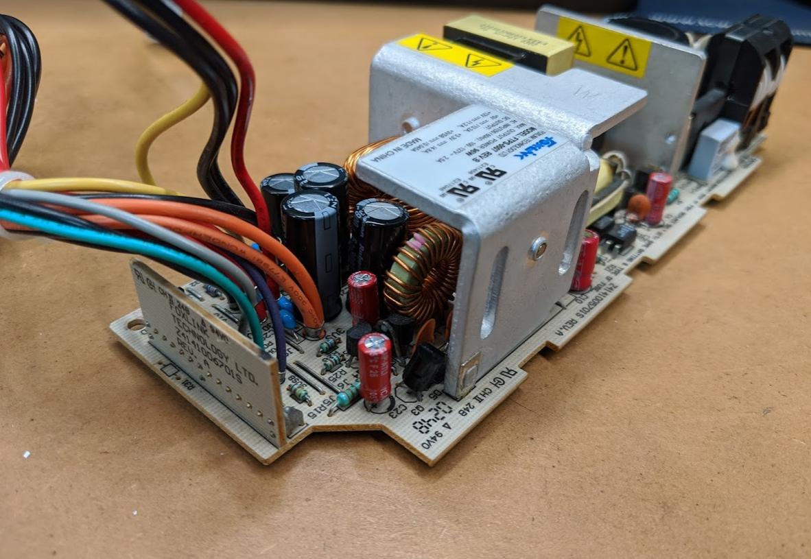

      Originally posted by jayjr1105
      My power supply is a foxlink, should I replace the 4-5 teapo's in it? I think they are mostly 2200uf 10v
      if it's like the european foxlink supplies then check the 1200uf caps.
      they always seem to be trashed.

        I took inventory of the caps on it and ordered everything, minus the Mains filter cap everything is getting replaced. My Ali poly's are taking forever to come in so the PSU is getting electrolytic's

          Foxlink recap all done

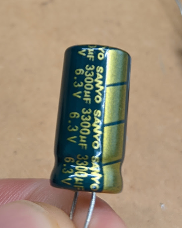

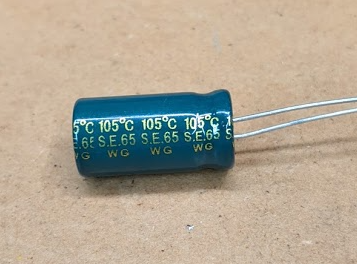

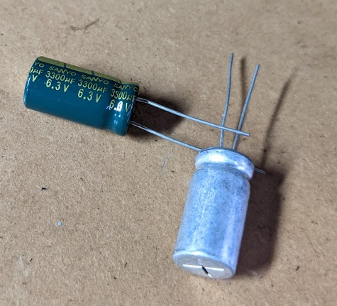

            I got all my Ali caps in today. A little disappointed in the 1500uf 6.3 poly's. Using an LCR meter they all tested rather low but not out of spec. 2 of the 20 did test out of spec at 1000uf. The rest were 1300-1400uf. Not a single one at or above 1500uf. I find that odd.
            Anyway, here are the 3300uf Sanyo WG's. Probably fake, you tell me.
            https://imgur.com/gallery/y1vqqhO
            I did remove the label from one of the Sanyo's to find a vertical scratch, usually indicating a fake but it tested right at 3300uf with 0.01 ESR

                Re: Original Xbox Replacement Caps
                the images dont show the bung
                  Here you go

                    #129

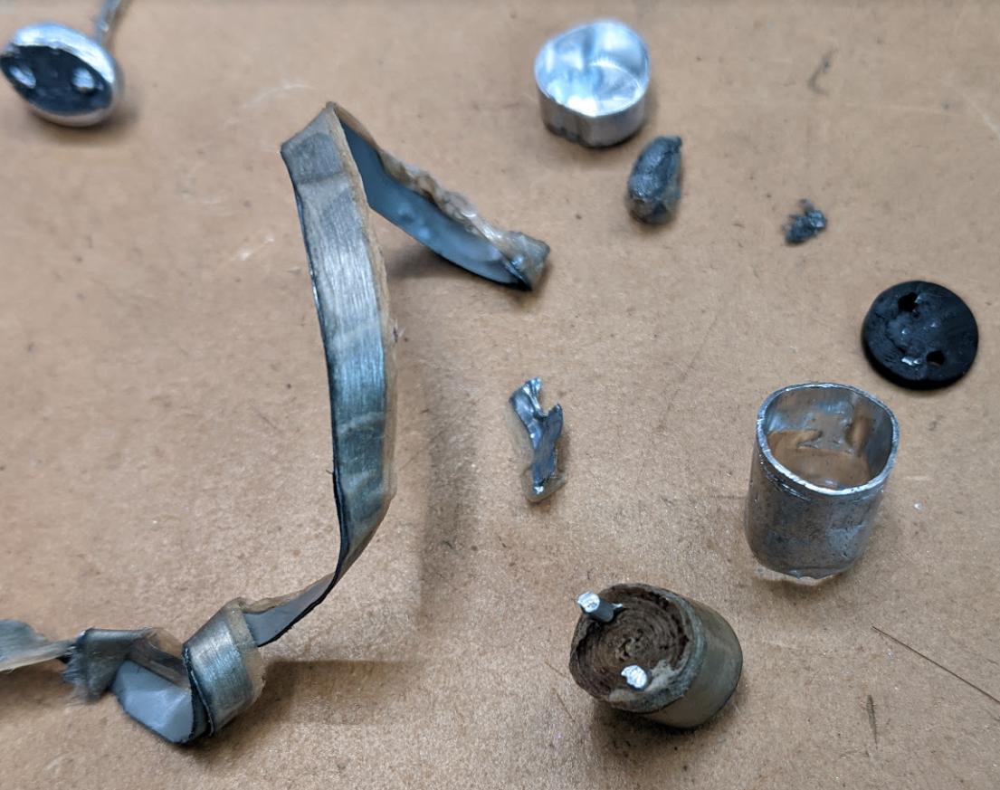

                    Bonus pic, cut the naked one open with a razor blade. Wound very tight with many many layers. Had good moisture. If it's a fake it's not a bad one.

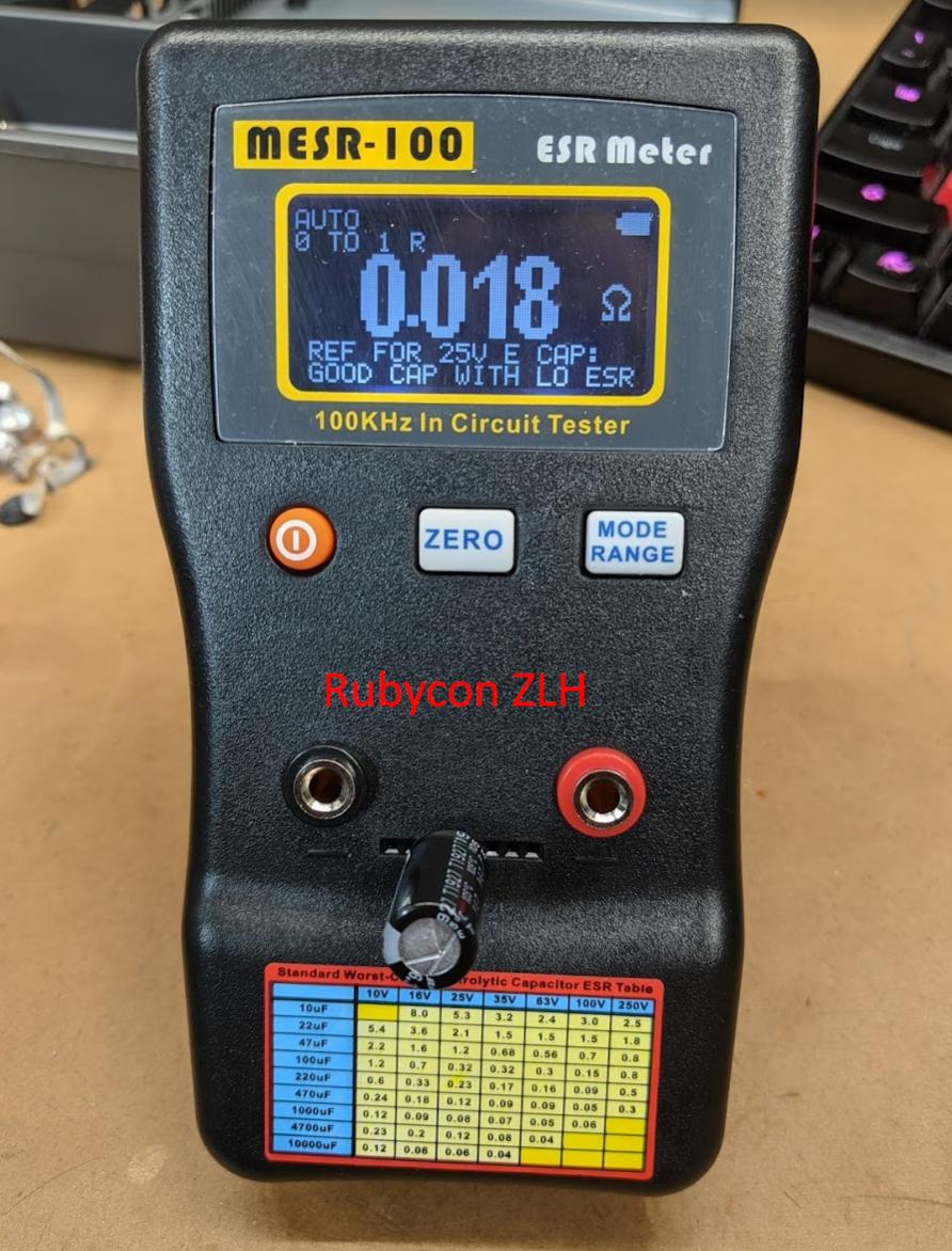

                      #130

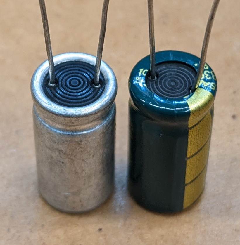

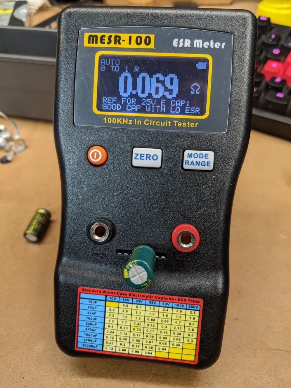

                      Nevermind about them being real. They are 100% fake. Further ESR testing shows them between .03 and 0.6 ESR (tested all of them) and the datasheet specifies .012 max at 100KHz 20c
                      Similar caps new and old test accurately around .02 to .01

                        #131
                        Yea 100% fake, Sanyo / Suncon do not use bungs with concentric rings.
                        And only some larger caps have the X vent, 10mm caps have K type vents.

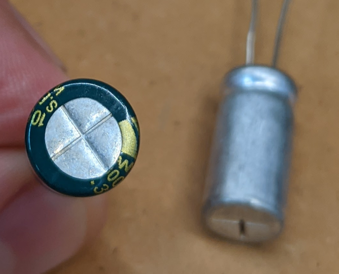

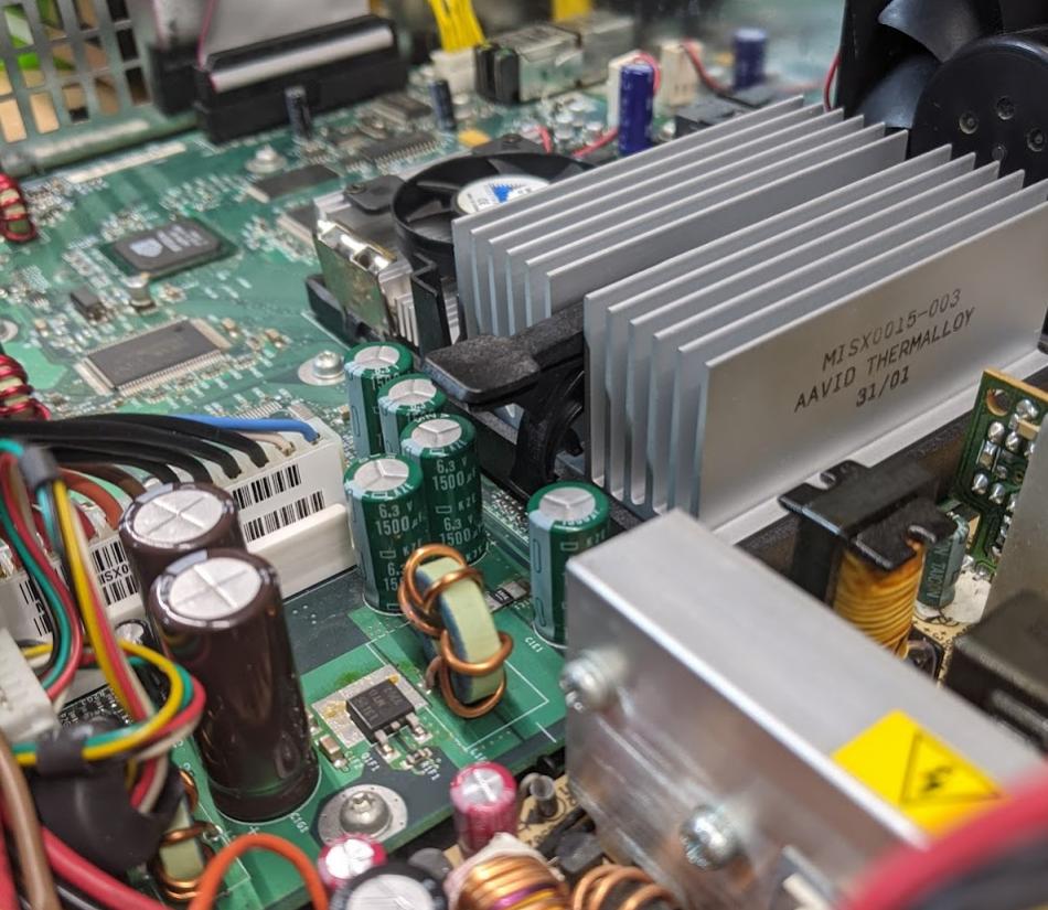

                          What's the story on these green KZE's? XBOX is a 1.0 and a very early if not first batch.
                          They look okay but wasn't sure if these were capacitor plague era or not.
                            KZE -> very very reliable
                            I would leave them.

                              #134
                              I would leave them.
                              I still don't see half of the images from the offsite links, but the one that did load up eventually... yep 100% fake indeed.
                              jayjr1105, can you please attach images with the forum's built in attachment tool? (click "Post Reply" or "Go Advanced", then click on the "Manage Attachments" below the message prompt.) Someone's going to view this thread a few years from now, and I bet you most of the off-site images will be gone.
                              Thanks, I did pull one of the KZE's yesterday and it tested out great, very low ESR and well within spec for capacitance.

                                What brand officially uses the concentric rings? Seems fairly common as a fake.
                                BTW I have a bunch of the fake WG Sanyos 2200uF 10V that look just like the 3300uF 6.3V units above, concentric rings and X and all. What really annoys me about fakes is that pretty much all leak at the rated voltage...
                                  Of the 10 I ordered, some actually had a totally different bung that was more traditionally shaped but still had a X vent instead of K. Also tested well above an very low esr for such a cap.
                                  Stock photo not my actual cap but the bungs on some looked like this https://images-na.ssl-images-amazon....1E3hWoeCmL.jpg

                                      Teapo... at least I've seen it on a number of small SC series (6.3V, 1000 uF) that came from HP OEM ASUS P4SD motherboards... but not all of them had the concentric rings, so who knows what Teapo did there.
