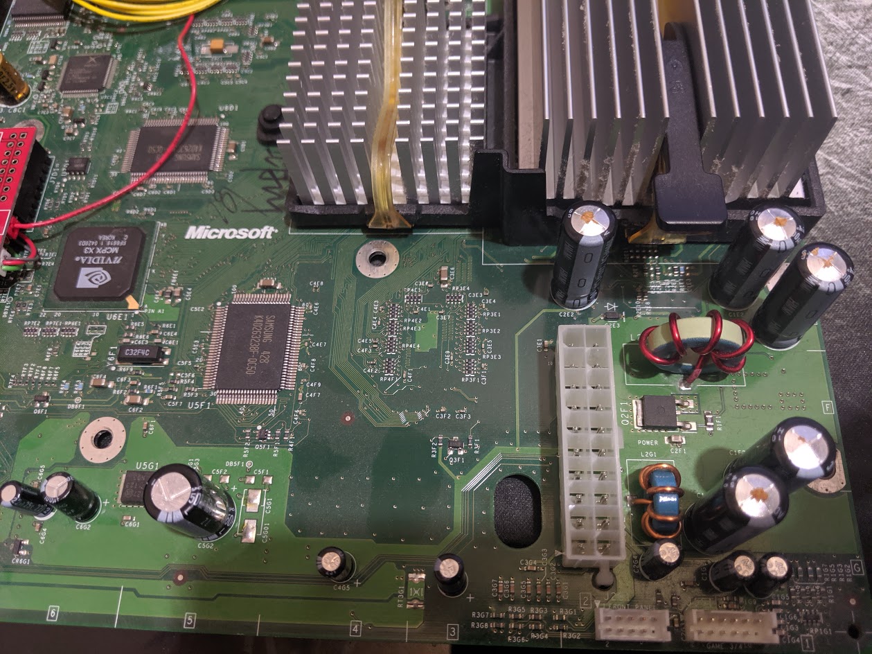

            Resurrecting this thread as it contains some great information when it comes to capping 1.1->1.5 motherboards.

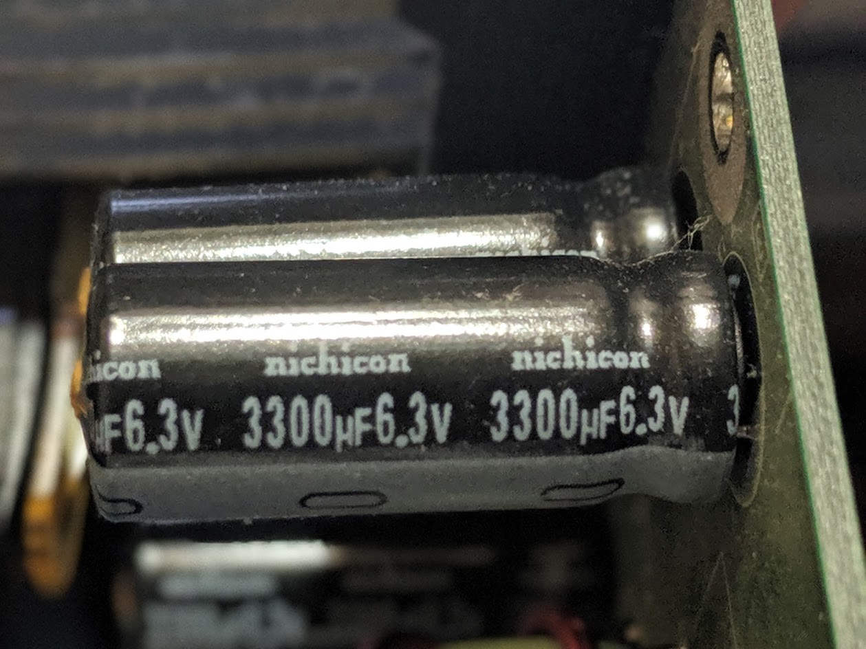

            I'm looking to repair a 1.6 motherboard. There's 5x 3300uf 6.3v Nichicon HM series capacitors on this revision. It looks like the advice on 1.1->1.5 was to use 5X 1000μF 6.3V instead 3X 3x 6.3v 3300uf Nichicon HM. Unfortunately the 1.6 motherboard is laid out differently (there are no empty holes for additional caps).
            Pic1 shows the 5x 3300uf 6.3v Nichicon HM caps with blown tops. The other 2 are closer shots of the cap details.
            Would something like these work? Look similar, but HM(M) vs HW(M) on the side. I'm fine with a soldering iron but the world of capping is new to me:
            https://www.aliexpress.com/item/10pc...29904c4dCvzjAY
            Thanks!
              • 31199
              #86
              Re: Original Xbox Replacement Caps
              you can get 2000uf polymers now,
              i used one in an intel motherboard to replace a 3300uf electrolytic.

                  • 31199
                  #88
                  polymers should have the highest esr possible.
                  i know that sounds strange, but they are so much better than electrolytics that a cheap polymer will be better than a really low esr one.
                  i dont know about the other caps, i'v not tried replacing them yet - but i will now china sells cheap polys/tants

                                      From 3300uF to 1500uF is quite a drop for those CPU caps, no noticeable impact as a result?
                                        • 31199
                                        #99
                                        there is not much drop,
                                        your replacing 3 x 3300uf (9900uf) with 5 x 1500uf (7500uf)
                                        because most xboxes are designed for 5 caps and have the extra spaces.
                                        infact on the first boxes they used 5 x 1500uf or 1800uf electrolytics.
                                        also the esr and ripple capacity will be much better with the polymer caps
