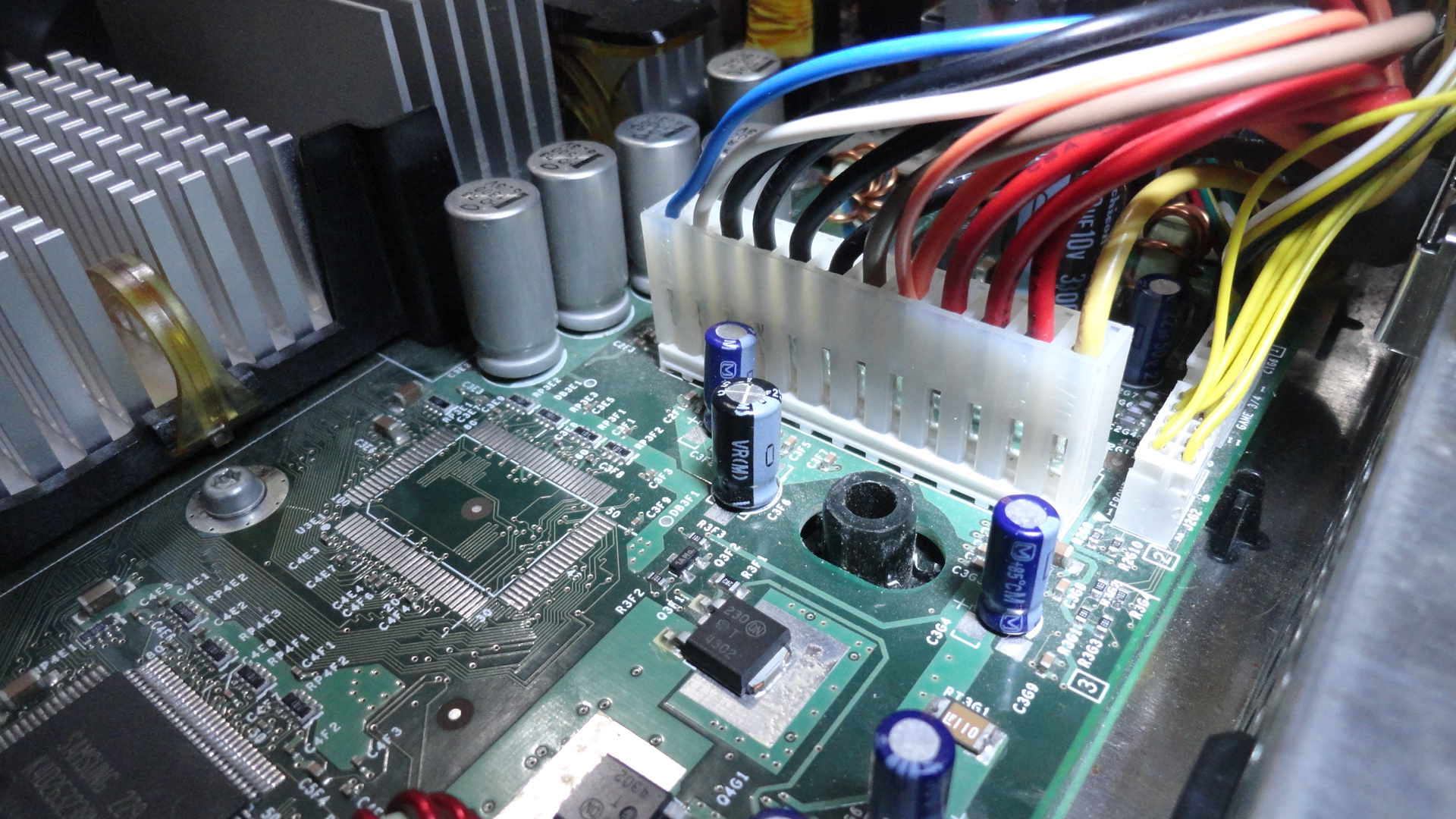

    Originally posted by Wester547
    I noticed a blue, ventless capacitor in the 1.0 - 1.1 image. That's either Panasonic M or Nichicon VX series, depending on whether there's a boxed M logo on the sleeve or if it says Nichicon.
    Good eye!
    Yea, I forgot to mention this 1.1 mobo...
    I have 5x v1.0, 2x v1.1, 2x 1.2-1.3 3x 1.4-1.5 and 3x 1.6
    This is the only board I have where it uses 22uf 50v instead of 22uf 25v
    There's a boxed M logo on the sleeve, as shown...
    Any reason why they went to 50v?
    Could Nichicon VR or PW 22uf 25v be used instead?

      Re: Original Xbox Replacement Caps
      Originally posted by NeMesiS34
      Would it be okay to replace Chemi-con with Nichicon?
      Either brand would work fine.
      Maybe they ran out of 22uF 25V capacitors in their stock at the time. Or they used 22uF 50V Panasonic Ms where they used 22uF 25V Nichicon VRs and Chemi-con SMEs interchangeably.
      Yes, I doubt the voltage across these capacitors is any higher than +5V actually. They use those large values because these are general purpose, 85*C capacitors.
