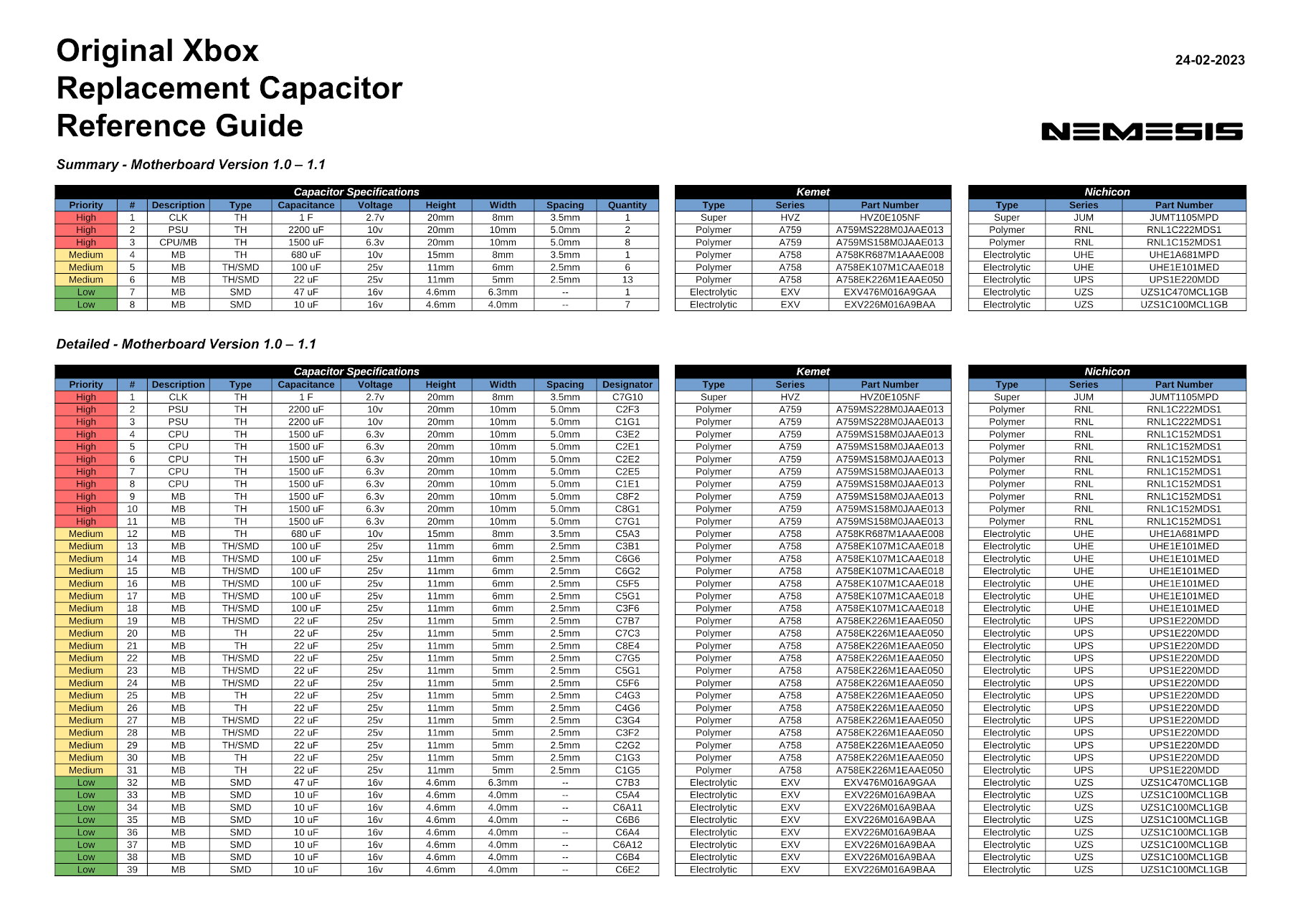

                                  Repost from EmuXtras Forum:
                                  I made a post on BadCaps way back in 2015 in regards to replacement capacitors
                                  for the Original Xbox Console. That thread has since 60,000 plus views...
                                  Special thanks to "STJ" from BadCaps for he's contributions on that thread and others.
                                  Using that thread and all the posts within it I was able to create a comprehensive list.
                                  The spreadsheet consist of a summary and a detailed list including designators.
                                  There are separate pages for v1.1-1.0, v1.2-1.5 and v1.6-1.6b motherboards.
                                  As a basic rule of thumb the larger the capacitor the shorter the lifespan.
                                  It's highly recommended to replace the CPU and Clock capacitors as shown in
                                  the priority column. Medium priority is optional where as low is unnecessary.
                                  I opted for Kemet Polymer Capacitors for the CPU capacitors and Nichicon for all the
                                  other Electrolytic Capacitors. I've installed, tested and confirmed all of these capacitors.
                                  It's possible to use other manufacturers by sticking to the specifications within the spreadsheet.
                                  https://www.docdroid.net/KjoNVm8/ogx...capacitors-pdf
                                  I hope this helps people out...

                                    Great work NEMESIS!
                                    That really ties us all of the information from all of the posts into one easy to understand piece. Again, nicely done!

                                      Thanks I actually fixed it up a bit...
                                      https://www.docdroid.net/45Rfxyw/replacement-guide-pdf
                                      I ended up dubbing the spreadsheet as a "Reference Guide" as availability may vary. Using the capacitors part numbers listed on the spreadsheet as a reference it shouldn't be too difficult in finding alternative components. However if you feel that this is out of your scope you can just follow the the suggested part numbers.
                                      Capacitor Specifications:
                                      Are based on the stock capacitors specifications, I did have to average out some of the sizes as they do vary a little from motherboard to motherboard but most important are lead spacings for the Through Hole (TH) capacitors.
                                      Reference Capacitors:
                                      I ended up using "Kemet" and "Nichicon" as references as they were the only two manufacturers that had all the capacitors at the specifications that we needed. This was mostly to put my (and I'm sure others) OCD at ease. I would recommend Polymers for the CPU and PSU capacitors whereas the others can be either Polymer or Electrolytic. I did reference for both but if you were to go all Polymer capacitors with Nichicon it will get very expensive. As a cheaper but still reliable alternative I would recommend Kemet.

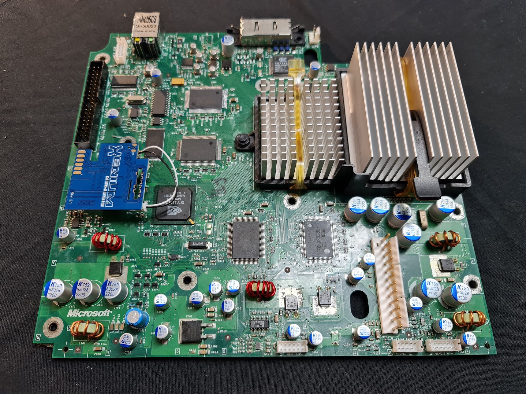

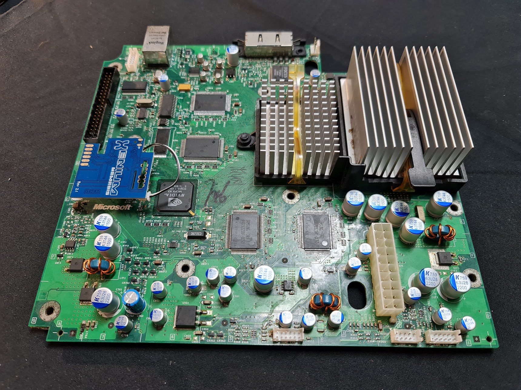

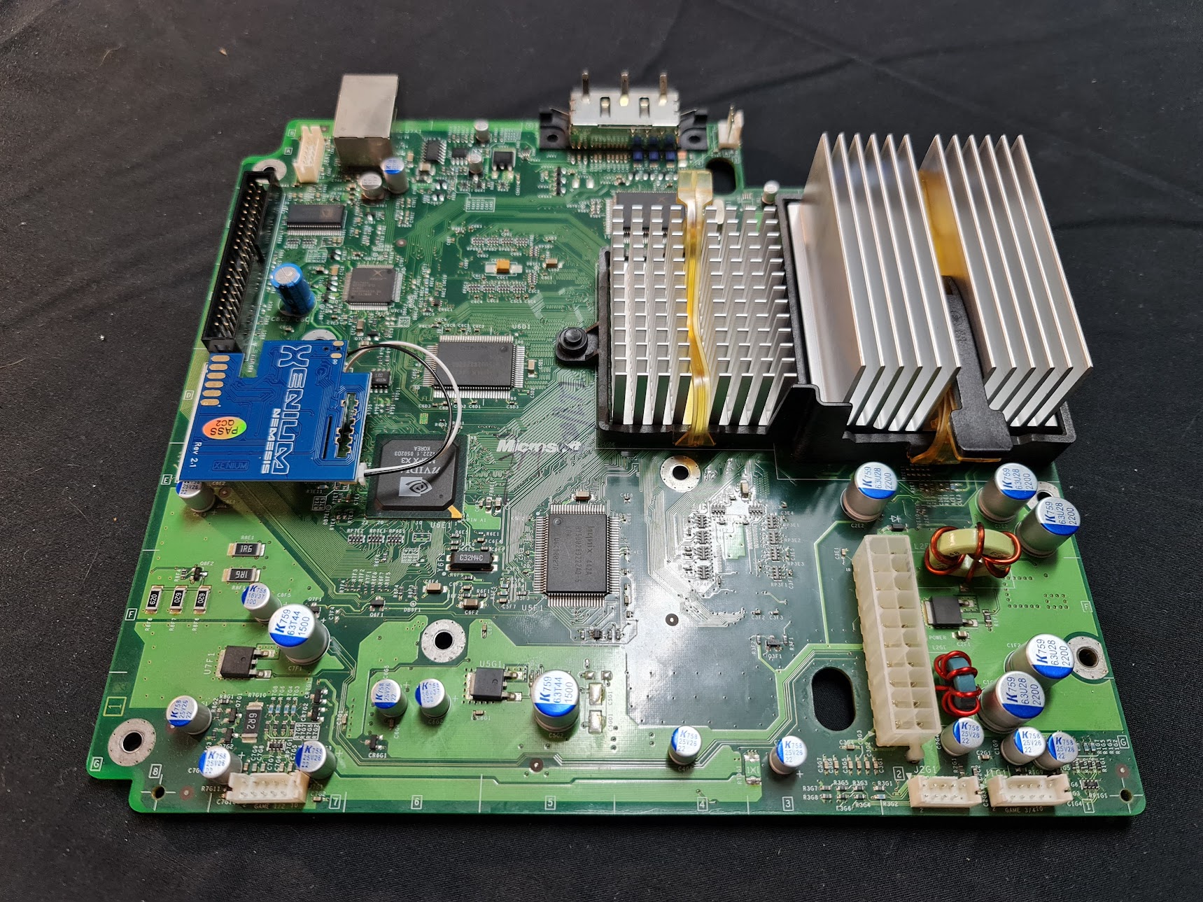

                                        Here are examples of Kemet Polymer Capacitor Replacement.
                                        Note: I would recommend replacing 4-5 capacitors or even less depending on skill level and then test the console to make sure it still boots. If it does not boot you will have to figure out which capacitor is not working. I think I used too much heat on one cap and killed it...
                                        Xbox Versions 1.0 - 1.1
                                        Xbox Versions 1.2 - 1.5
                                        Xbox Versions 1.6 - 1.6b

                                          Again, nice work NeMesiS34!
                                          Anyone else think this thread should be stickied?
                                          Seems like a common recapping solution has been found for pretty much any of these boards now.
