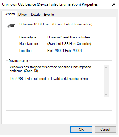

    Trying to connect xbox 360 slim memory unit to PC
    i get unrecognized device (error 43)

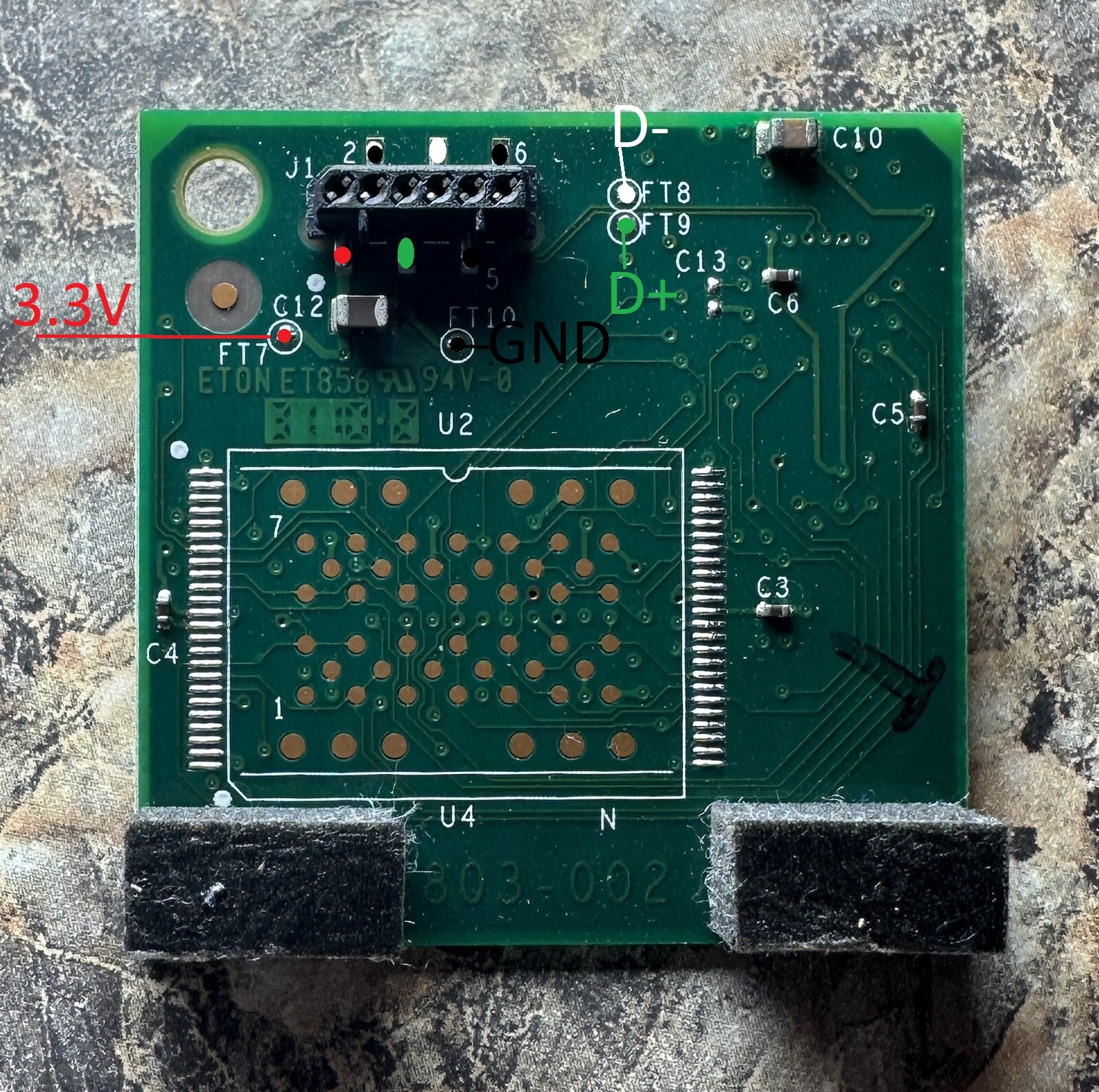

    USB cable connected to these points:
    FT7 - 3.3V (using 5V to 3.3V regulator, connected to USB cable)
    FT10 - GND (sharing with voltage regulator, connected to USB cable)
    FT8 - D-
    FT9 - D+

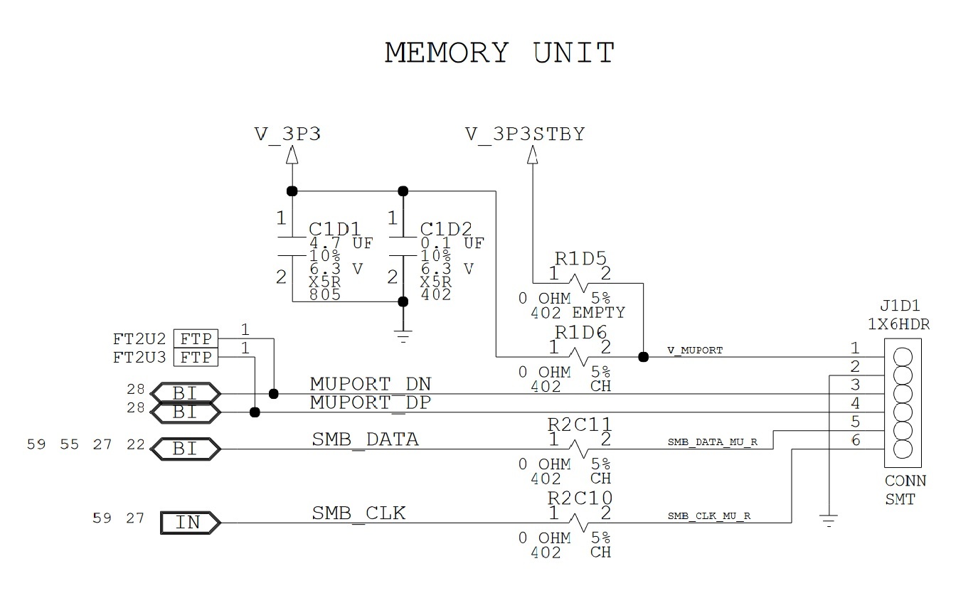

    double checked the diagram, looks like i connected data wires reversed. After correcting i still have the same problem.
    At first i used this guide: https://imgur.com/S04Nzfk

        This is what i get.
        This is whit corrected wiring. Before i get unrecognized device.

            USB\UNKNOWN - HW_ID.

              so your grounding pins 2,5 and 6?
              i dont know why the guy grounds the serial bus on 5 & 6 but i would try it grounded and unconnected
              is your 3.3v good? a regulator needs a capacitor across it's output pins to stabilise the voltage

                Tried with grounded 2, 5, 6 - same thing. Then tried without 5, finally without 6 - same.
                On the memory board itself is a tiny capacitor should be alright.
                Must be a reason for serial bus.

                  under linux it gets detected. But file system is fatx, only windows have tools made for it.
                    • 31199
                    so you need a windowz device driver maybe?
                      Looks like it, because there are fan made drivers for older removable memory units for Xbox360. I did image backup on linux. And then mounted it on windows with software made for fatx partitions, etc. And it worked. You are really right for saying that these types of troubleshooting is done under linux. .
