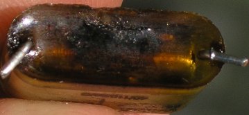

    Wima MP3-X2 failed in AC line filter
    Over a week ago, there was a strange smell in the house when the heater was running (the line filter was connected to the TV and other equipment, along with the heater - it was not overloaded). Yesterday, the 10A fuse in the line filter blew and upon opening it, a Wima MP3-X2 0.047uF capacitor was leaking, and tests shown it had electrical leakage.
    This capacitor was apparently under stress, causing it to heat up and eventually started to short when it overheated.

    Re: Wima MP3-X2 failed in AC line filter
    The failure mechanism probably was something like this. Whether due to weak spots or voltage surges, arcing occurred at multiuple locations over time. While metallized caps "self-heal", there is residual carbon at the location of the arc, a high resistance current path. Each of these arc locations generates a certain amount of heat, and as the number of arc locations increases over time, the generated heat increases, eventually leading to overheating a dramatic failure. This has been a known failure mode with X caps for some 20 years that I'm aware of.
    Was this a metallized film or metallized paper cap? BTW, Wima makes good film and paper caps, so this wasn't the film/paper equivalent of crap caps.
        Those Wima caps are usually really robust, so i think normal electrical stress should not cause any harm to them, at least not beyond the self healing capability.
        I think PeteS has already described the failure mode for this kind of cap more than correct.
        I have seen this problems in many TV Focus boards too, where the FKP1 6000v caps are used, two in series to get a healthy 12kv device.
        But unfortunately, the cold soler joints, the resulting heat and smear will kill them too.
          Here is a picture of the failed cap.
          Note the split on the top, which was caused by pressure building up when the capacitor started heating up, causing the impregnation material to melt and subsequently leak through this split.
