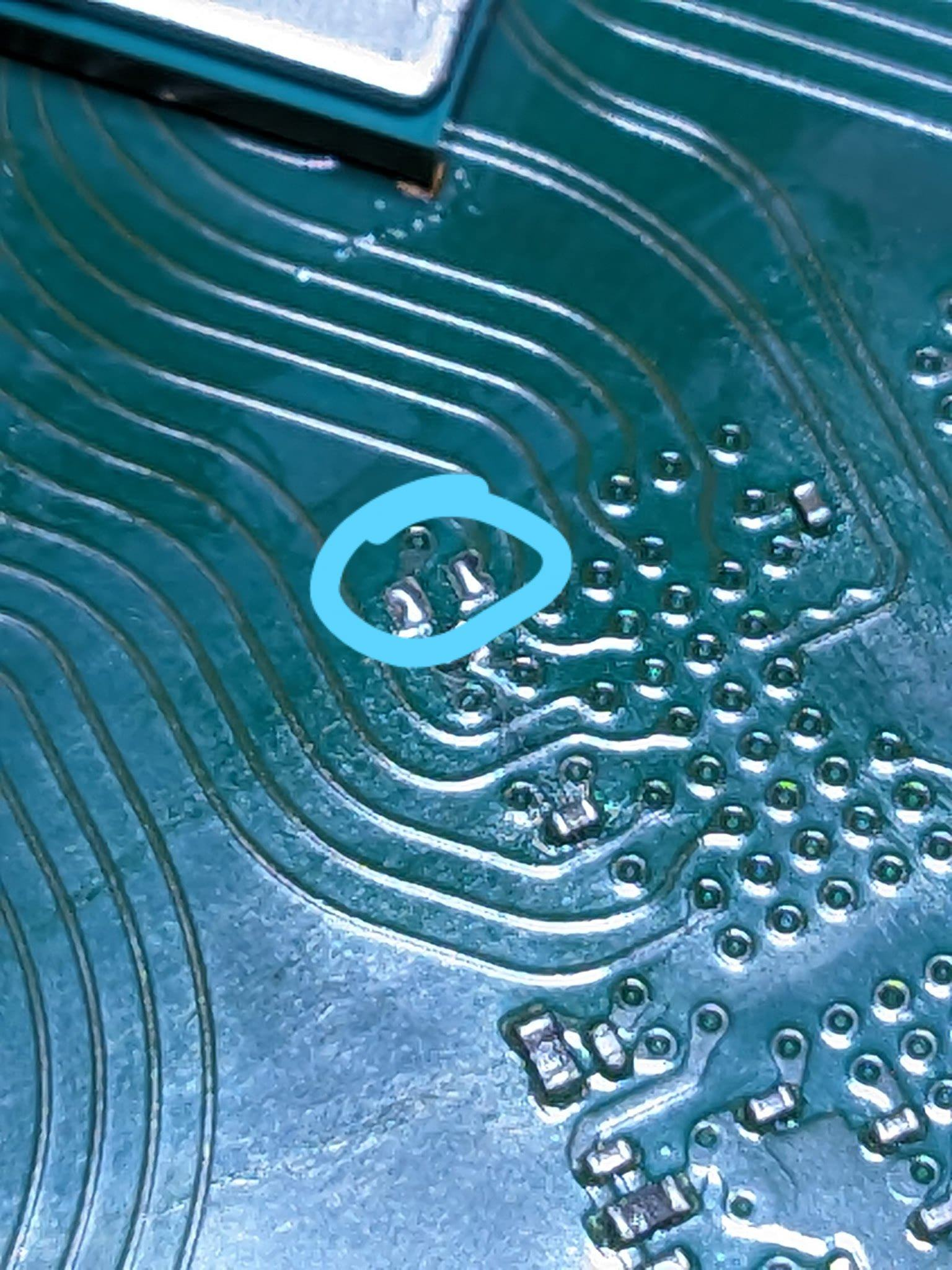

    PS5 EDM-020 LOST CAP
    Hello, does anyone know the value of the capacitor that g​oes here? It is between the processor and the SSD controller. I would be eternally grateful if you could help me. Best regards.
  • LaPCon_IT
    • Sep 2022
    • 82
    • Malta
    4.7uF 6.3V 20%
    • ReyDxD
      • Mar 2025
      • 5
      • Mexico
      Originally posted by LaPCon_IT
      4.7uF 6.3V 20%
      Thanks a lot man.
