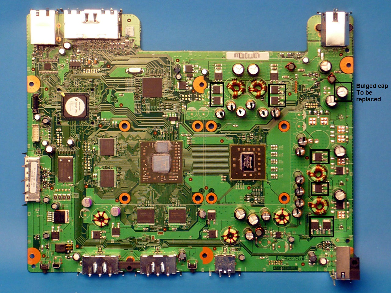

    So after making sure the PSU is good , i have decided to open the console it self and see whats going on inside .
    I have discovered a leaky capacitor ( sanyo 1500 uF 16V ) , and checked all the MOSFETS around the power supply section , i was really surprised , all the ONSEMI 4806 ones were having a short between drain and source .
    I don't know if that's part of the circuits design or they are all fried ??
    Also is it possible to change the 1500 uF cap with a 2200 uF or 1000 uF?

    Please post a picture of your board and indicate which MOSFETs appear shorted. *Some* of the MOSFETs around the CPU and the GPU should indeed appear shorted, but not all. It's a synchronous buck circuit - you have a group of MOSFETs between 12V and CPU/GPU Vcc, and another pair between CPU/GPU Vcc and ground. The latter always appear shorted until CPU/GPU are removed from the board or the torroids around CPU/GPU desoldered.
    Yes, you can use a 2200 uF or 1000 uF cap, as long as it is rated for at least 16V. I suggest keeping capacitance the same or going up (i.e. 1500 uF or higher) but not going lower. The 1000 uF cap will work too since the other 1500 uF 16V caps are in parallel with it so the drop in capacitance won't matter as much overall.
    That said, if you do have more of those Sanyo 16V 1500 uF capacitors anywhere on the board, replace them too. I've been told they fail fairly often. Can't confirm it from personal experience since I've seen very few boards with these Sanyo caps. The boards with Panasonic FL, Nichicon HN, and Rubycon MCZ on the other hand, always appear to be fine in my experience.
    Your replacement cap(s) should have matching or superior ESR/impedance and ripple current rating specs, though. So you can't really just use any 1000 or 1500 or 2200 uF cap. Has to have at most 12 mOhms ESR/impedance and at least 2700 mA ripple current.

      Now , i am glad that they are normally shorted , like you said not all but only the 4806 that are .
      In the mean time the problem i got with this xbox is that it displays 3 red lights with a 0001 error code or 4441 using the sinc button .
      And the xbox was rarely used BTW
      Here is the mobo with the shorts in black and cap to be replaced that i found bulged :

        Are you sure that's a Sanyo?IIRC the T vent was on Panasonic caps,while Sanyo caps had a K vent.

          The mobo on the picture is not mine , its just to show momaka where i found the shorts
          And you are right the sanyo one have a K vent similar to rubycon .
          Could this 0001 error be caused by aging caps all around the mobo ?

                  Yup, as the wiki article says, 0001 is a power problem. Take the power brick where you can see its light and power on the Xbox again. When you turn on the Xbox, it should change from orange to green and stay green until you press the power button on the Xbox again. If it changes to red, you might actually have a real short circuit across one of those MOSFETs that appear shorted or perhaps somewhere else on the board.
                  However, if the light on the power supply goes back to orange, try a different power brick or external power supply (a PC PSU with at least 16A on the 12V rail may work - I can show you how to wire it if needed).
                  Normal for those MOSFETs to appear shorted. However, they can still be shorted, though. It's hard to test them due to the CPU and GPU on the board (the CPU and GPUs appear as a very low resistance on the meter). The only way you can narrow it down is after you perform the above test.
                  Yes, possibly.
                  Was the board ever overheated? Also, are you the original owner? If not, beware that someone before you could have performed the "towel trick", oven reflow, or a heatgun reflow - all of which can damage the caps.
                  Either way, I suggest replacing all of those Sanyo caps. If one has failed, the others are probably not far behind.

                    What made me think that they are not shorted is the resistance , the resistance is very symetrical between all the mosfets , i guess if a dead short has happened it will display a near 0 or at least 0.2 on diode mode , but on the first group i get 0.4 , second group i have 1.3 .
                    And i have already usoldered the first group and found no short at all .
                    Any ways i hope its just a power supply problem , and not a reball thing .

                      Hi again , the xbox now runs but i get 0012 error , i didn't put the heatsink yet

                        All OK AFTER HEAT SINK SET UP
