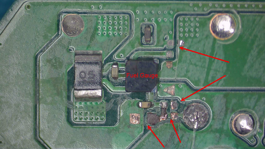

Nintendo switch drown victim help needed
  • CraigR
    • Dec 2013
    • 969
    Nintendo switch with some water damage came in and I need a picture of components and values on both sided down by the fuel gauge ic. If anybody would have a pic or could help me out it would be greatly appreciated!
  • nasmad
    • Aug 2024
    • 2
    • France
    I'm measured all in circuit. as you can see there is only one capacitor (120uF on topside). For the bottom I got 18uF and 220uF for capa, 10k Ohm resistor and A2N18AA.
    I'm bad to identify componant so if you find a documentation about this chip, make me know

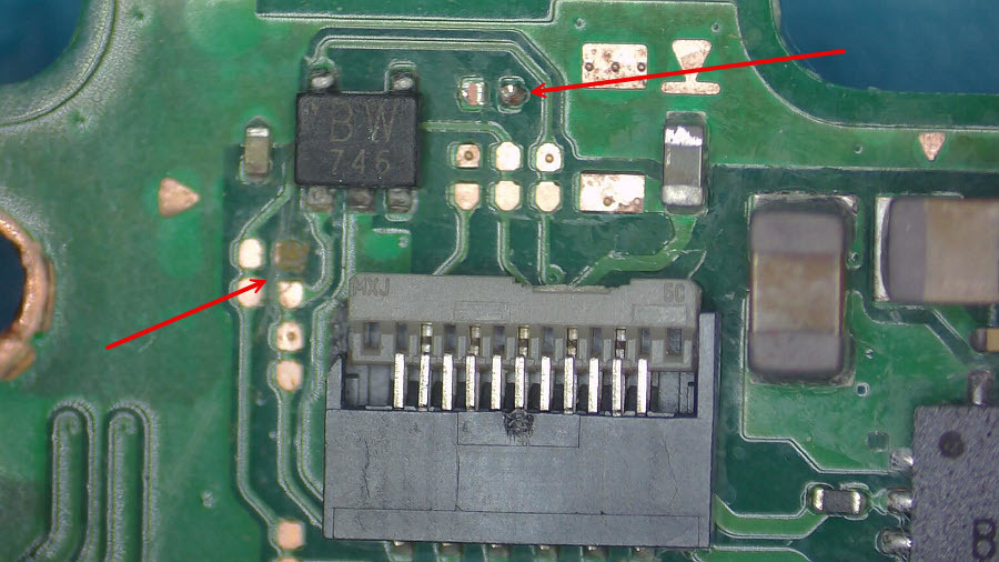

        No LCD image after connector replacement – lifted components and damaged resistor (Nintendo Switch Lite HDH-CPU-02)
        by Tomylee
        Hi everyone,
        Sorry for the person who’s going to read all this !
        I'm on a Nintendo Switch Lite, motherboard HDH-CPU-02.
        While replacing the left joystick, I had to remove the motherboard to access the connector underneath. When I lifted the LCD connector latch, it broke (the plastic had become brittle over time), so I replaced the entire connector.
        During the desoldering of the LCD connector using hot air, three small components located just below the connector (likely 0402 capacitors) came off and remained stuck to the bottom of the...
