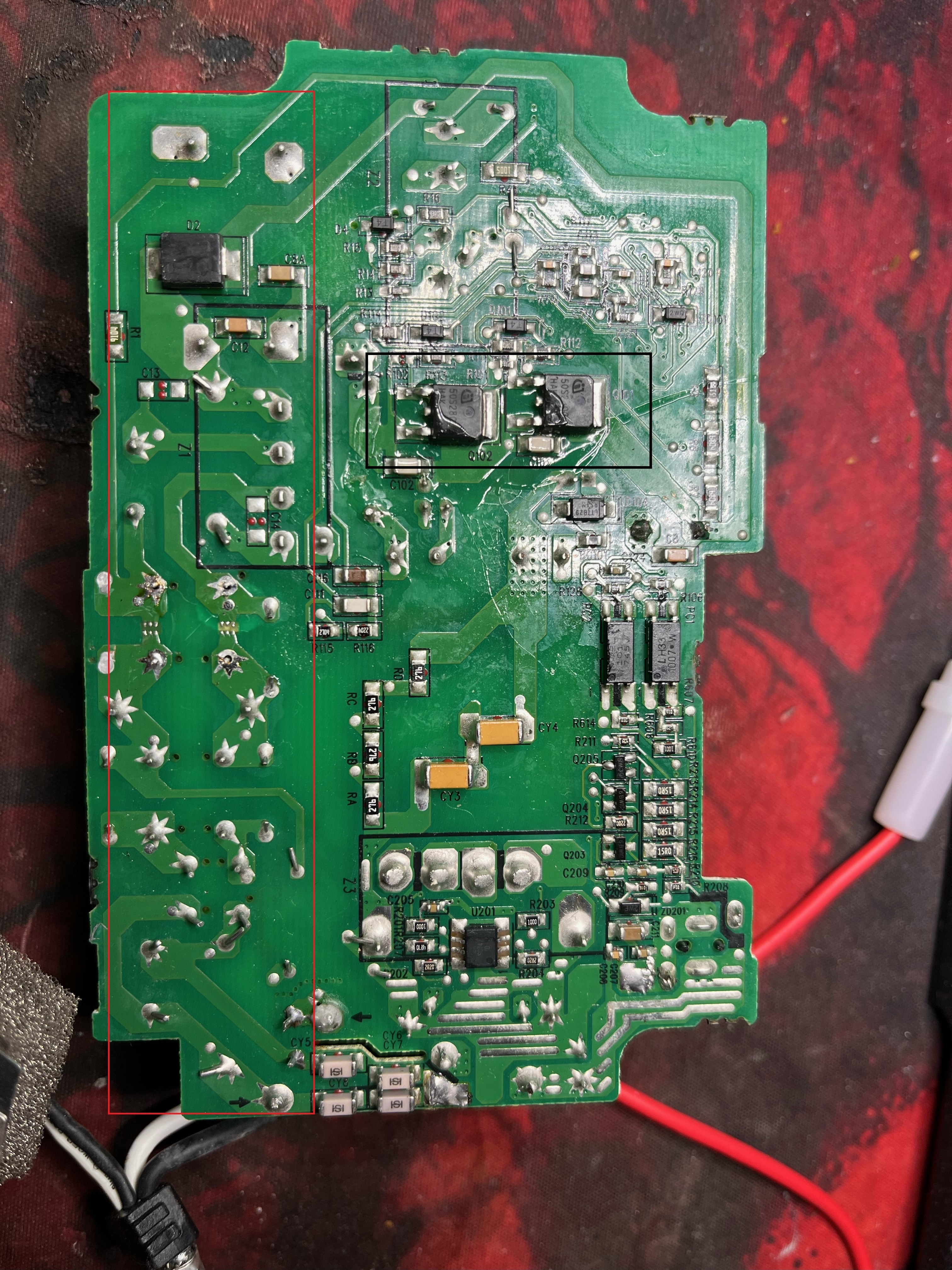

    Hi !
    I have followed the short and removed 2 mosfets and the short seems to be gone from the backside of the board totally.
    i would like to ask how can i search these mosfets i cannot find it in google from the number what is on it is 50S280CE .
    on the picture its the two in the black rectangle.
      here
        Thank you ill try get my hands on one and report back if its good.
          If the high side is shorting out but you still have 12v on the low, I would suspect a shorted PWM IC, since that is really the only thing that would be linking the high side to low side and would explain the blown rectifier. I often find that isolating the fault on a PSU can be one hell of a rabbit hole. A lot of replacing components, test, something else blows, etc. My advice would be to buy a replacement unless this is purely for practice or learning.
            Hi i have an update Q102 and Q101 had finally came , replaced first mesurements are fine every where i just have a missing R7 its a 6.8mohm smd resistor as far as i can tell but i have seen online there are diffrente wattage is given for these , i would like to know which watteg i should use than i can power it on.
            Thank you !
              Update I have assembled the psu tested it , it plugs in as normal without tripping the breaker , but there is no 12 volt, the big cap has 320 volt after pluged in . i have found a small diode that reads wrong i will change that and we will see.
                Hi, I know this thread is old, but I´ve a PSU modelo "1815" from XBOX ONE X where the U2 IC blown and I can´t get the code of it, I can read it only ends with "0022T", if anyone have one at hand to get me the code would be awesome. Thanks in advance!
                  Hi ! On my psu u2 is SH3P0022T T805 102 ZXD 17371 its a bin 16 leg ic.
                  Hope this helps!
