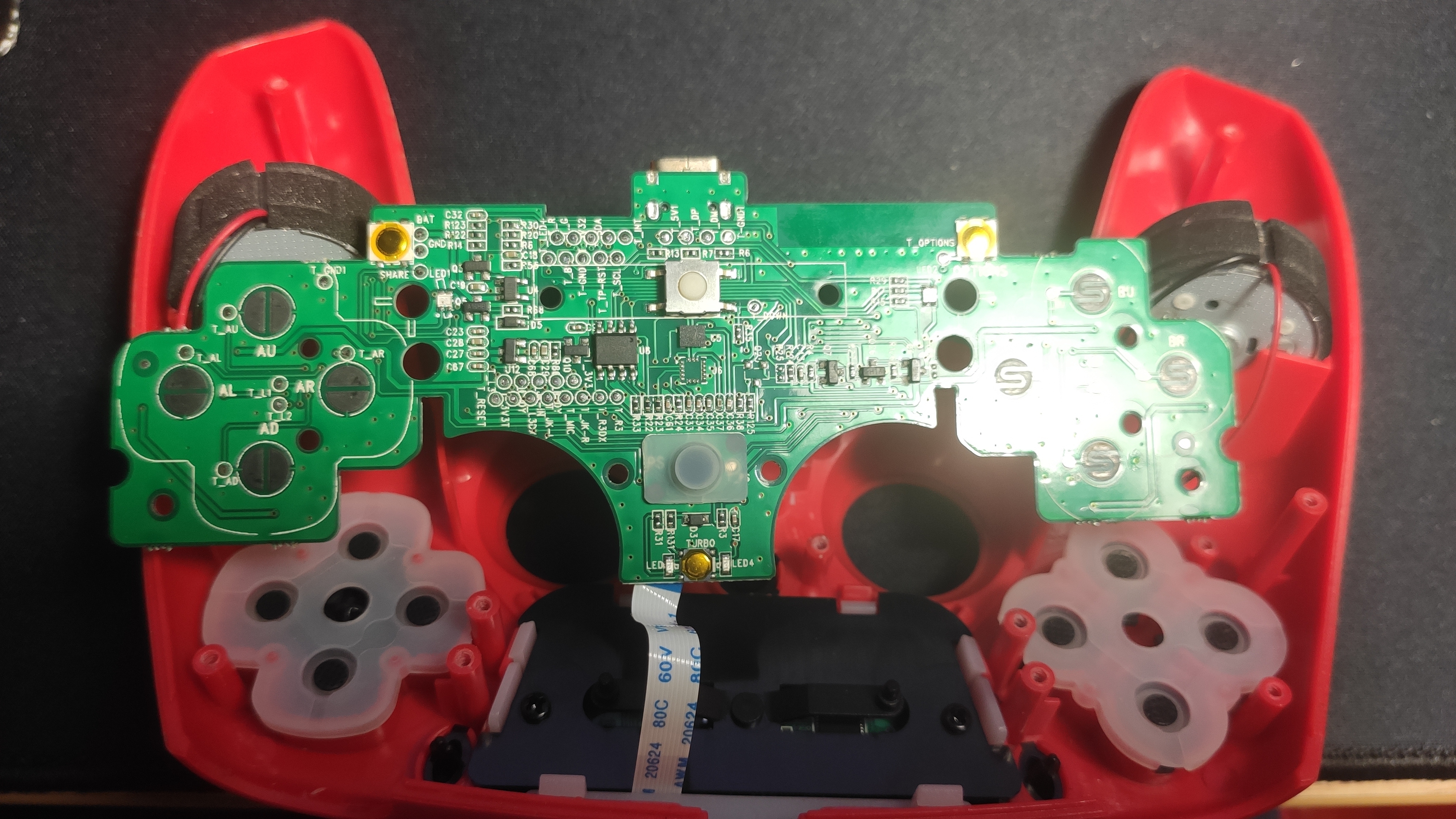

    I have got an Steeldigi Steelshock 4 v2 controller won't draw any amp from outlet.
    I have disassembled and removed the battery. I have tied to measure some points. The usb connector shows 5 volts. There are test points and shows 5 volts everywhere it should. The battery connector in diode mode shows 0.009v is it ok?
    There is an U4 chip place, but no chip, between the battery connector and the charging port.
    How should I progress to identify the problem?
    Can anyone help me with this?

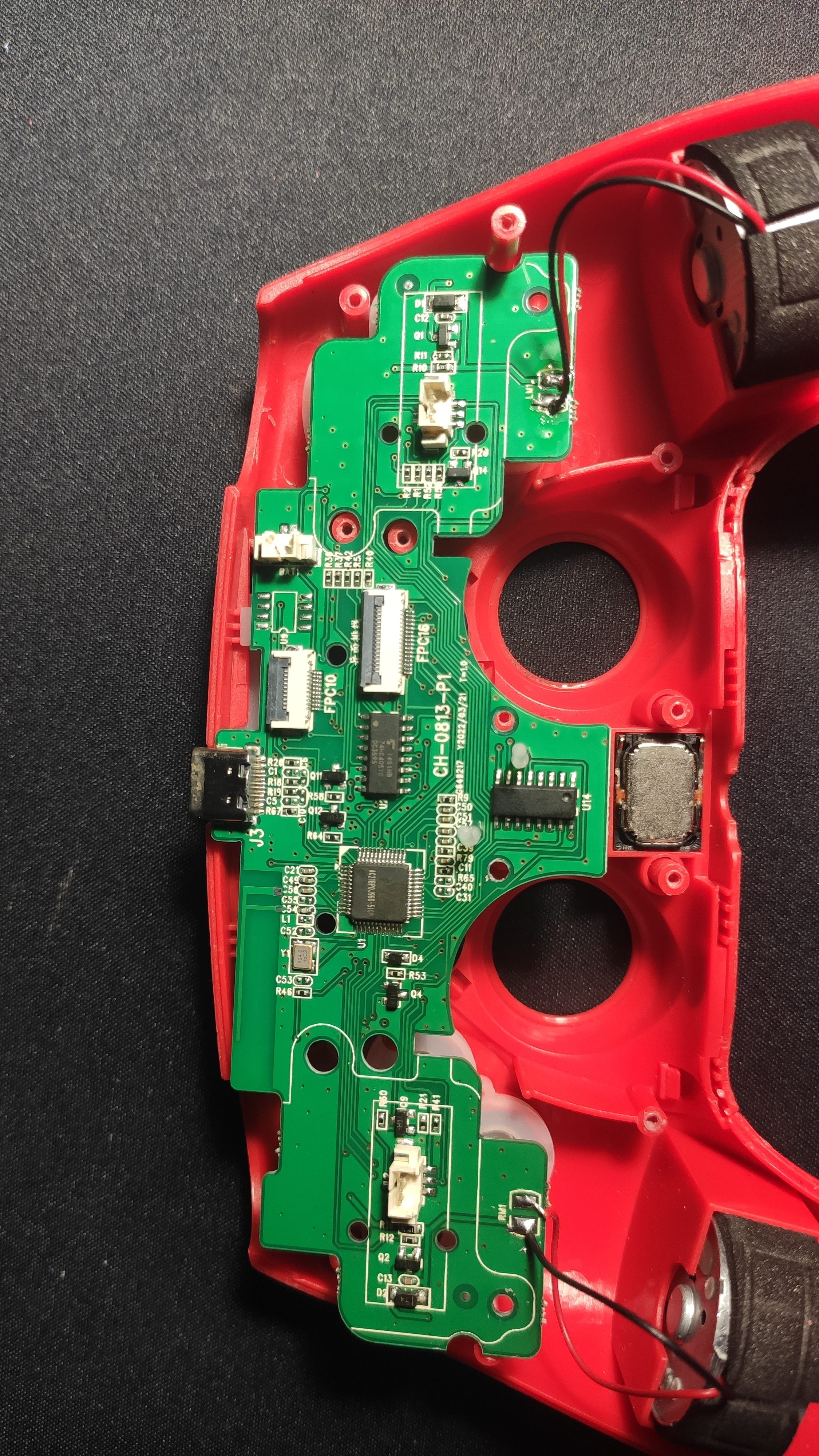

            Considering the traces I think the LM1 is in the correct order.
            Here is a picture from the other of the board.

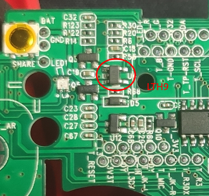

              I tried again to inspect the board with replaced battery and found a very hot components on it.
              After it cooled down tested it with IPA and reconnect quickly turned out that is a LTH9 IC Battery Management chip, 600mA single cell Li-Ion Charger.
              Can it be hot because I've tested it with Li-Pol battery 3.7V 500mA?
              Or because it is faulty?
              If it should be replaced I cannot find any page where I can order replacement.
              I have found LTH7 can it be a good replacement?

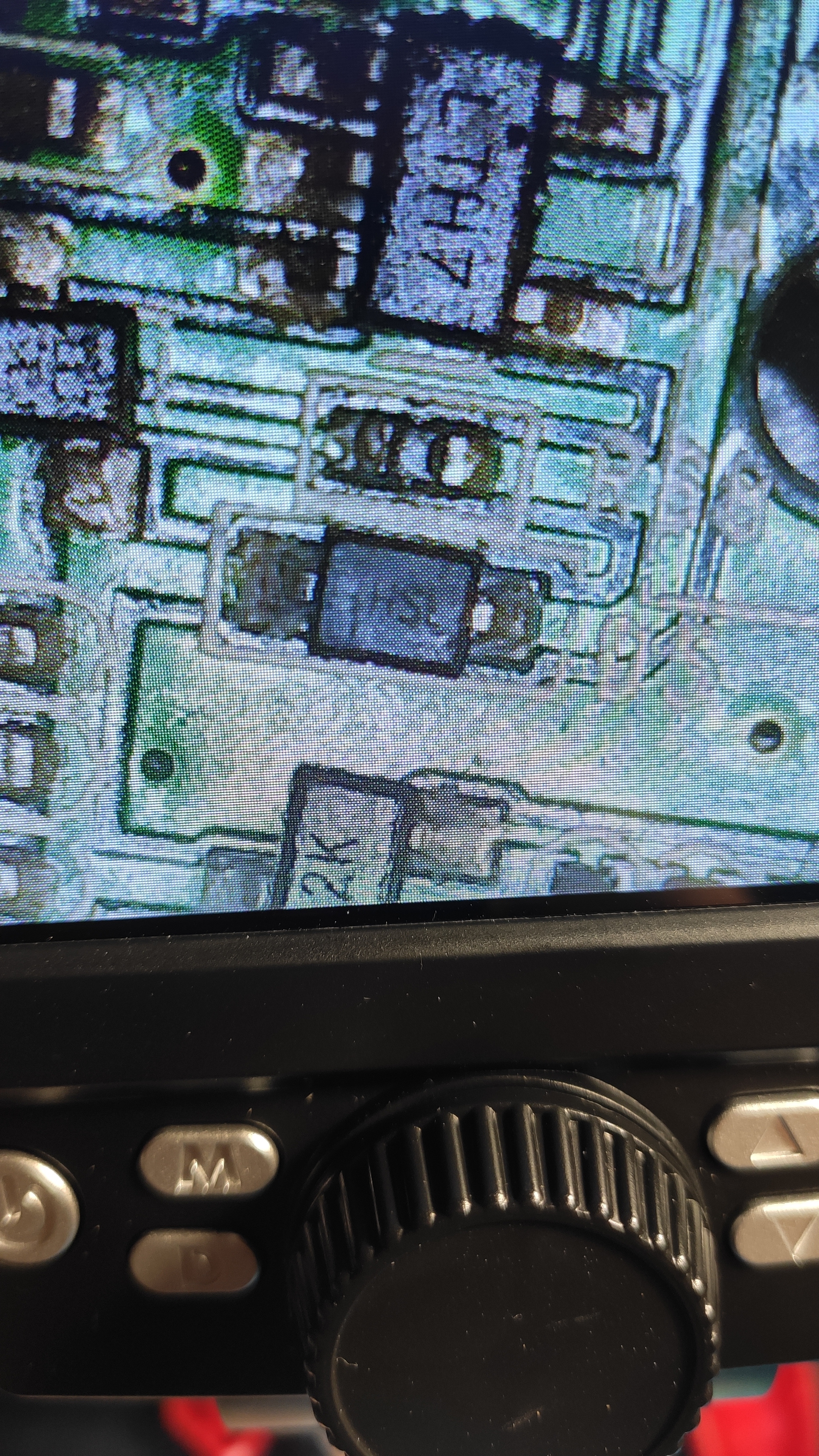

                        As I measured from the battery, I have found that diode (HSL, D5) cannot measure any voltage at the output. And seems like it has a little crack or I missed It?
                        If this is the problem, then I cannot find any component like this on Aliexpress or anywhere else.
                          • 31079
                          try a 1a rectifier like a 1n4007 just tacked across the pads and see if it works
                          HS is a 1a rectifier
