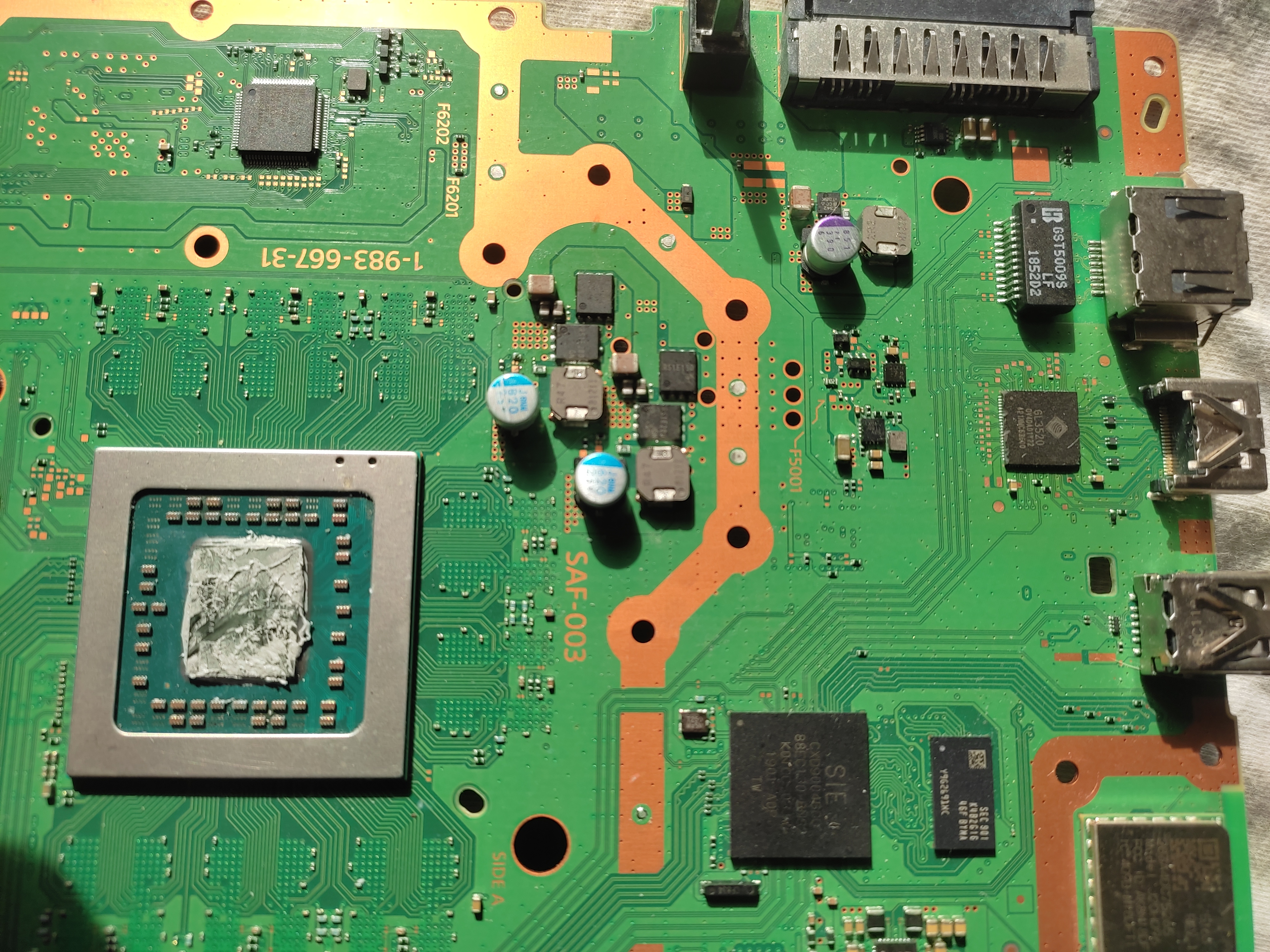

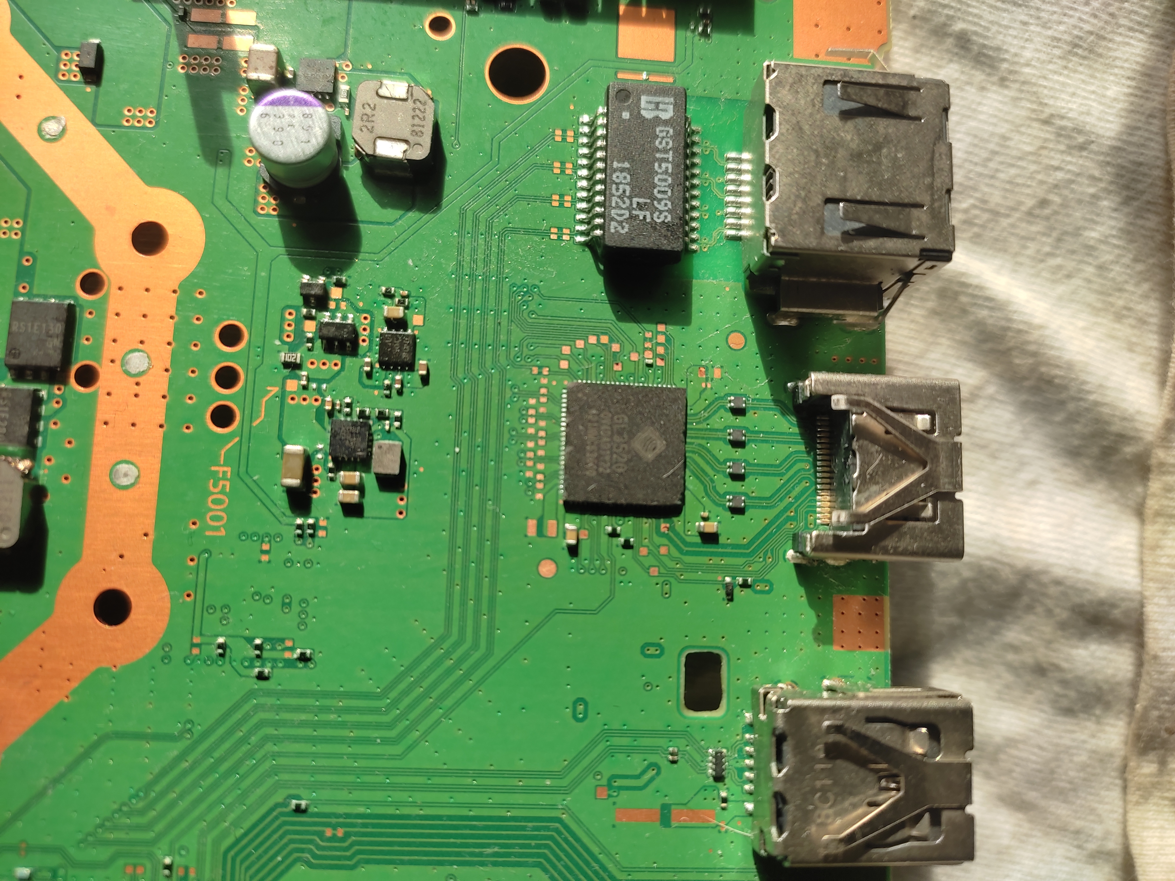

    Hello, can someone with experience help me with the PS4 CUH 2216A (SAF 003). I bought a defective PS4 with the error "no picture on TV". After connecting several HDMI cables and changing the console to two TVs, there is still no picture. I disassembled the PS4 and noticed one for me on the motherboard a very confusing detail. IC GL3520 is used for the output to the HDMI connector, although the pictures of the motherboards that I have seen show the Panasonic MN864729. Please, someone explain to me what I am doing wrong. The IC GL3520 looks like it was soldered originally. I have attached a picture of the motherboard. Any help is welcome. Thank you.​

    It is clear that the chip is not original and what kind of “master” soldered it there, he probably thought that if the case matches, then it will fit. What you have is the Genesys Logic GL3520 USB 3.0 Hub Controller Datasheet - a 4-port, energy-efficient and configurable hub controller.
    Should be MN864729 (Panasonic)

      Thank you. You have confirmed my opinion. I am ordering MN864729 (Panasonic). Is there a service manual for this console?​
