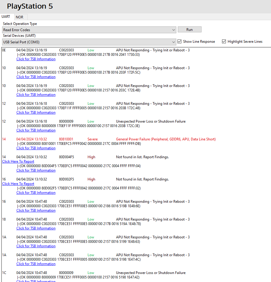

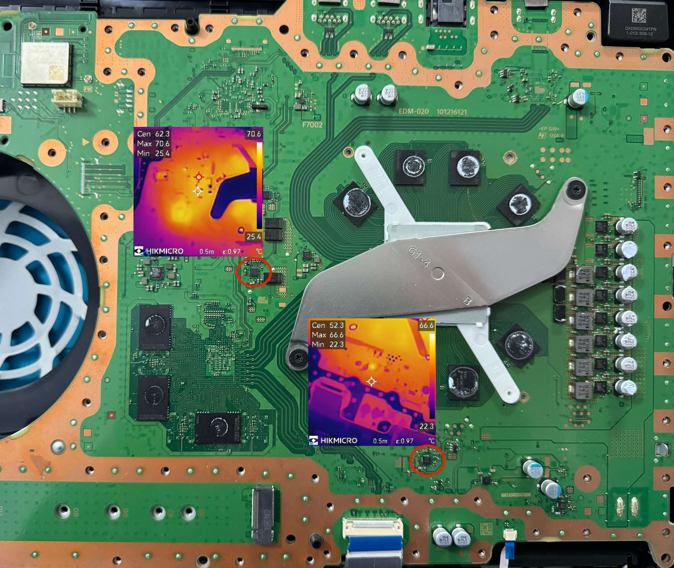

      Hi guys. I put this Playstation 5 back on the workbench. I checked all the major voltages following the directions in TheCode3r video (https://www.youtube.com/watch?v=HXa2L8QxrQg&t=2072s), and they all seem to be correct (at least as far as TheCode3r says). I then took some thermal pictures of the mainboard, finding after a few minutes some hot spots, but perhaps not so abnormally, considering that the fan was not installed. I attach the images.
      Do you have any suggestions, any control procedures? I remember that PS5 remains constantly with the blue led flashing.
      I also attach the error logs taken with UART

        No help? I can try to reballing or change RAM, I would like to know whether you think this is the right way
