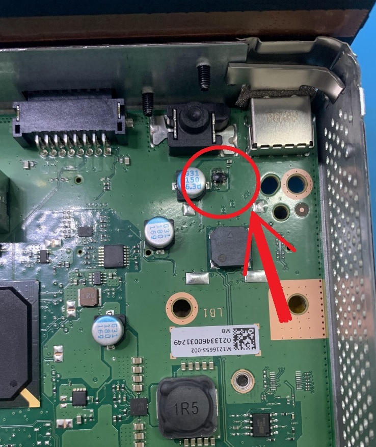

    Hello guys,
    XBOX series s

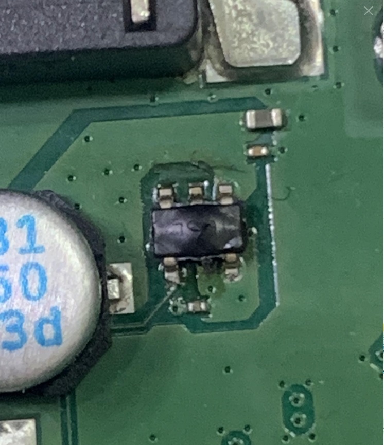

    please can you identify burn component. I can't read anything from it. It is located next to the front USB port. Console stil works except USB ports
    • 31199
    if you dont get an answer by the weekend i'll open one up and check for you
    gotta fix one anyway.
    • pcconnect
      • May 2019
      • 79
      • uk
      Thanks stj, I was able to read it and it looks like 1E6L. USB power switch TPS2001D. Any chance to find it somwhere else or some replacements?
        • 31199
        https://www.ti.com/product/TPS2001D
        request a sample?
        • pcconnect
          • May 2019
          • 79
          • uk
          thanks for the tip but they dont let me register for some reason. error 403
          anyway I have ordered it from ali and will post the result once replaced
          • pcconnect
            • May 2019
            • 79
            • uk
            just to update. after replacing TPS2001D all USB ports work again
