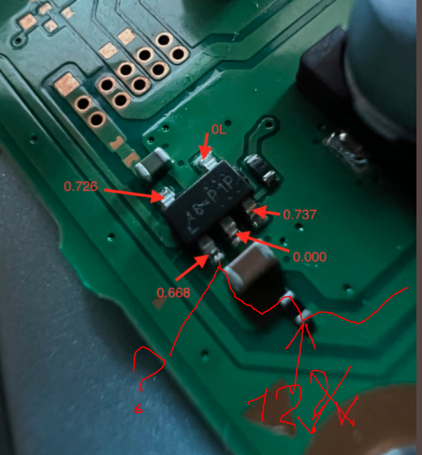

    Is it possible that the component (the one with 5 pins) is bad? If so, anyone can identify it? It says A8-P1P on top of it.

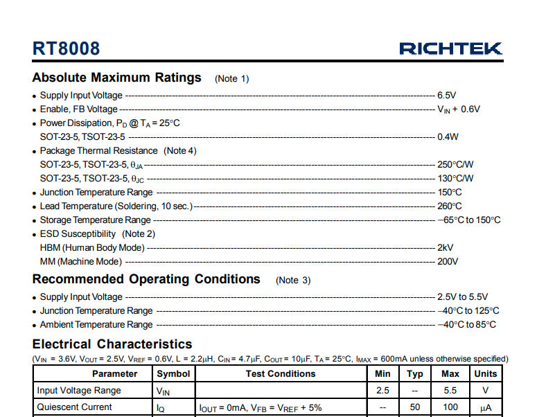

        Richtek RT8008-18P
        • lotas
          • Jan 2016
          • 4859
          • Russia
          RT8008

            Thank you. Based on the data sheet you provided, it implies that there's 12v on the EN pin only. This seems strange. Also, the ground doesn't seem to be at the same place on the board vs the data sheet. I'll have to investigate further
            edit: ground is at the right place

              Remove the chip and look where the 4 pin (VIN) goes.
              Yes, and the input voltage exceeds (your input is 12V), but it looks like it’s not.

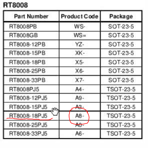

                Rather, your pinout, look here, maybe you will find yours, look for the markings (A8-xxx) and the body.
                Or do you have (A8=xxx)?​

                  are you actually getting 5v and 12v going in?

                    Check diode readings on this component, and come back to us. I will check a working one

                      It does look like A8=XXX, hard to tell
                      I am only getting the 12V
                      Here are the diode readings.
                        So where are these 12v?, which are supplied if there is no power supplied to the input, and accordingly there will be nothing at the output.
                        ​​​​​​Is there some tension here?

                          The tension at the point you mention is 12.09v

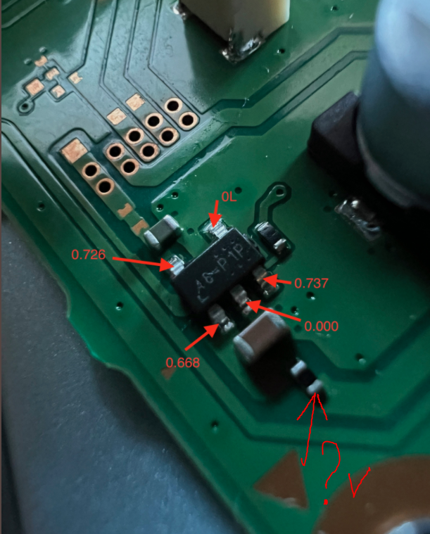

                            Sorry for the double post, but I’d like to add that the shorted component that I removed was there (see photo). Could it be the reason it is not working? I thought it was only a capacitor and that it could work without replacing it. Can anyone confirm the component that was in this location?
                              It’s not clear, if at this point you have 12.09v, then why on 1 pin. you have 0.668v when it should be 12v?

                                Diode reading looks good compared to mine. The component you're missing is indeed a capacitor, and shouldn't be necessary for testing
                                  Because this is a diode mode measurement, and not voltage measurement
                                    Thank you for confirming. Could it be that the MAIN motherboard should be supplying another voltage, other than the 12v? I checked everywhere else on the disk drive board and all I can find is the same 12v at its source

                                      In order for voltage to appear at the output (pin 6) of this LDO, the controller must send a command (voltage) to turn it on, this is to the 3-pin EN (turn on).
                                        Pretty sure there should be 5v and 12v supplied to the disc drive daughter board.
