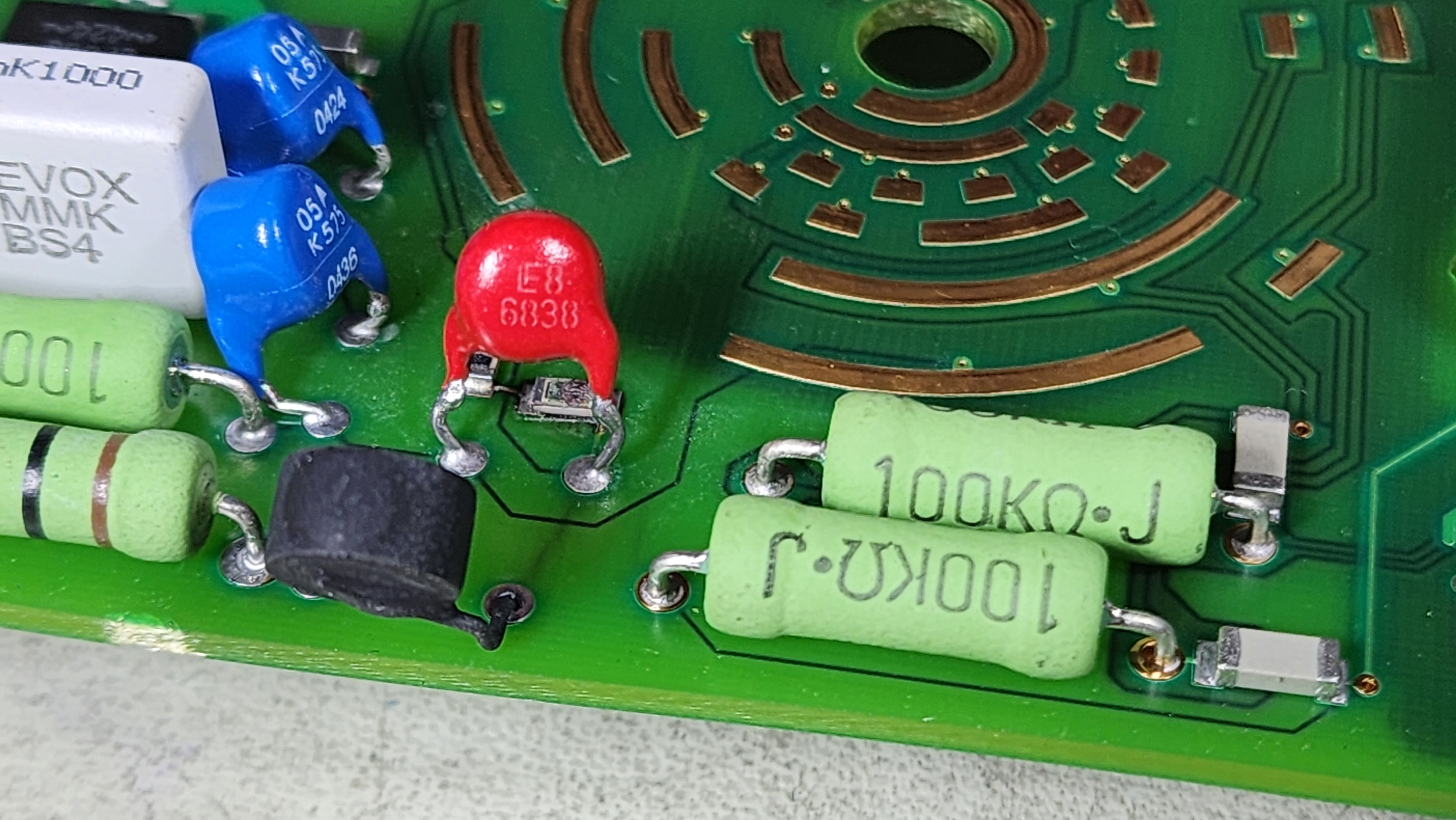

    Fluke 189 series 1 DC voltage is off
    I have just realized that my meter is off, when I measure the car's battery, and I can't imagine how that happened.
    I also have a 87, and when I doubled checked the voltage, the 87 was showing 3.5V higher, than the 189. Most likely the 189 is off.
    Where should I start with the 189?
    Switched leads between the two meters, but nothing has changed.
    I have not opened it yet.
    Any help would be appreciated.

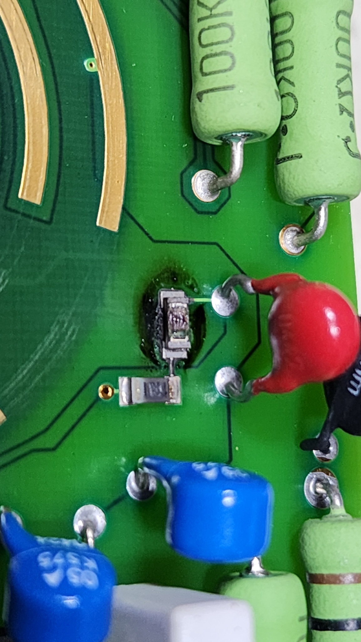

            Opened it and found at least one resistor blown, with trace lifted as well. The one next to it, in series reads 1.152KOh. I'm not sure, if that OK, or not.Click image for larger version

              Those appear to be the shunt resistors for the uA and mA ranges? The bridge rectifier and diode are supposed to clamp and protect the shunts and just blow the 440mA fuse... so I don't quite understand what went wrong here.
              One horizontal resistor going to the via I see in another pic is a blue precision 100Ω. There should be a 1Ω somewhere... the badly smoked one I cannot see clearly in any pics maybe 251x? or something written on it.
              I have a Fluke 189-II service manual 2008 with schematic- but it's different than your pic. They might have fixed an error or beefed them up.
              Current shunts:
              R167 100Ω 1% 1W
              R165 1Ω 5% 2.5W
              R5 0.010Ω 2% 1W WW big shunt for 10A range
              I can't see them causing problems for the Voltage and Ohms functions. Unless it's the leakage current from the shrapnel

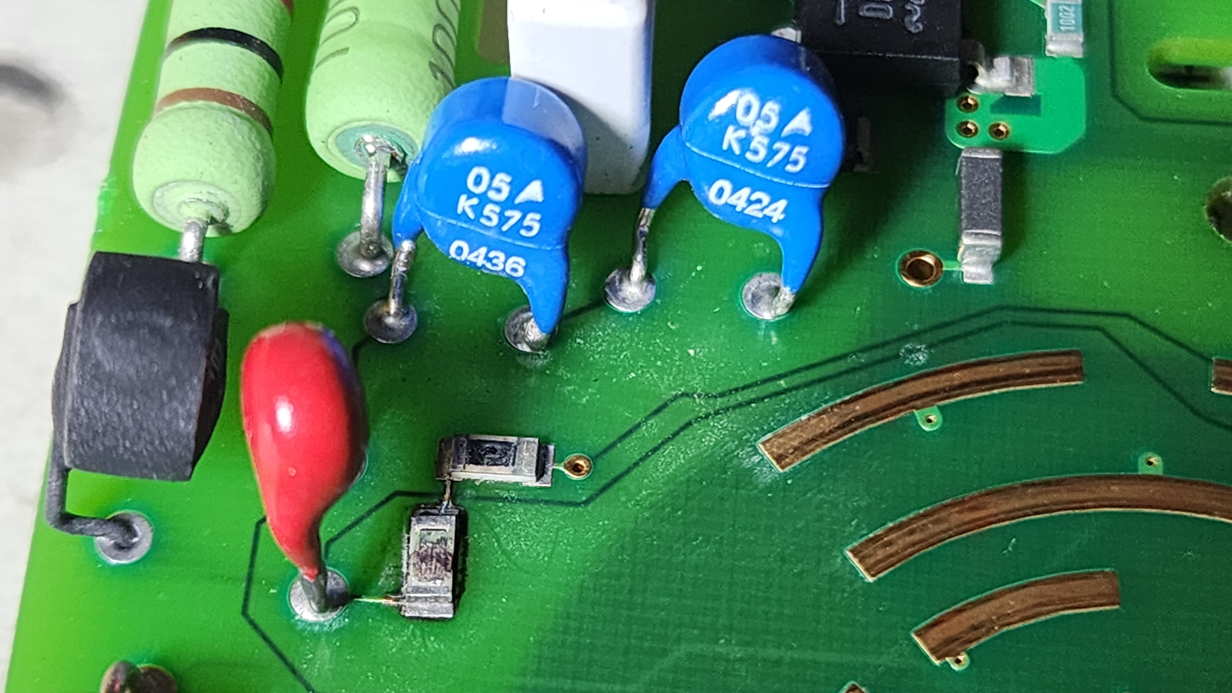

                  the blue parts are MOV's (varisters) and should meter open-circuit.
                  whats printed on the red one?

                    The red MOV is an old GE part and must be a different voltage than the custom blue Epcos S05K575. For the old Fluke 87's it was V575LA10P or V910LSX1399 5mm red 910V 1mA almost same as the Epcos part.
                    I would guess either a MOV is leaky or the protection clamp is damaged, for the voltage channel - leakage would make it read lower V.

                      The red one measures 1.107Kohm.
                      I was measuring parasitic drain at my wife's CRV, maybe I did something stupid and I did not even realize?!
                      What should I look for at the voltage scale?
                      MOVs show OL with the Ohm meter, except the red one.
                      Which one is the protection clamp?

                        whats printed on the other side of the red part?
                        btw, all 3 are protection - that whole area below the switch is.
                        i suspect it's the same part as the blue ones - i hope anyway.

                          I found a Fluke 189-I board pic with the two burnt resistors "2611" for 2k61 1% and "1001" for 1k00 1%, in series with each other? and then PCB trace to the red part. I forgot the blue (foil?) ones, I thought a Vishay line but 1206 1% would be i.e. CRCW12062K61FKEA. It's probably better than 1% part though.
                          I don't see those resistors used in a Fluke 189-II. I wrongly thought they are the mA-range current shunts- but those are 1R (big black through-hole) and 100R 1W both located on the other side of the board.
                          For curiosity, can you tell us ALL markings on the red part? I did see "LF" for Littelfuse. Apparently it is not a MOV, but is a PTC (also used in 87-I) and it's normal to read ~1.1kΩ resistance across it - so it looks fine right now- but failed at its job so the 189-II ditched it lol. I think early Fluke DMM protection was a bit unrefined.
                          For reference data I have: Fluke p/n 1277360 THERMISTOR, POSITIVE, 1.1kΩ, +-20%, COATED, RADIAL Original G.E. YS3961, possible substitute Amphenol YS4020.
                          So anyway, back to the reading low V problem... I doubt it's the burnt resistors but not sure. I would replace them, clean up the smoke with IPA and a Q-tip, and see where that takes us? Red part seems OK.
                          Otherwise, it's the protection clamp and with no schematic a little hard to point those parts out.

                            the carbon that was the board could be conducting between traces

                              What wattage could those have, 0.25W?

                                They look like size 1206 [Metric 3216] 1/4W resistors, Fluke uses Vishay/Dale CRCW series so I would guess: CRCW12062K61 and CRCW12061K00.
                                To burn them up, say at 1W would be ~82V for them. 12V work could not have cooked them.

                                  On the back of the red part is D44, not sure what that means. I did not se the LF logo.

                                    clean it up with IPA - see if the board is damaged or it's just soot around the resistors

                                      The PCB is black under that resistor(the resistor's shape), but it is not conductive. I also managed to pop up the PCB with the hot air station(yeahh).
                                      I have just realized that that one of the big fuses are open.
                                      I can swear that it was good when I started.
                                      I guess I will place an order for those two resistors, and a fuse, and we go from there.
                                      Will be back, when I have replaced those components.
                                      Since the trace is lifted and one side is gone, should/could I use through hole resistors?
