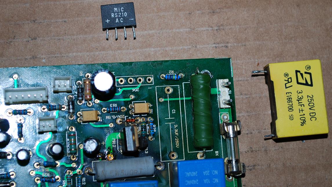

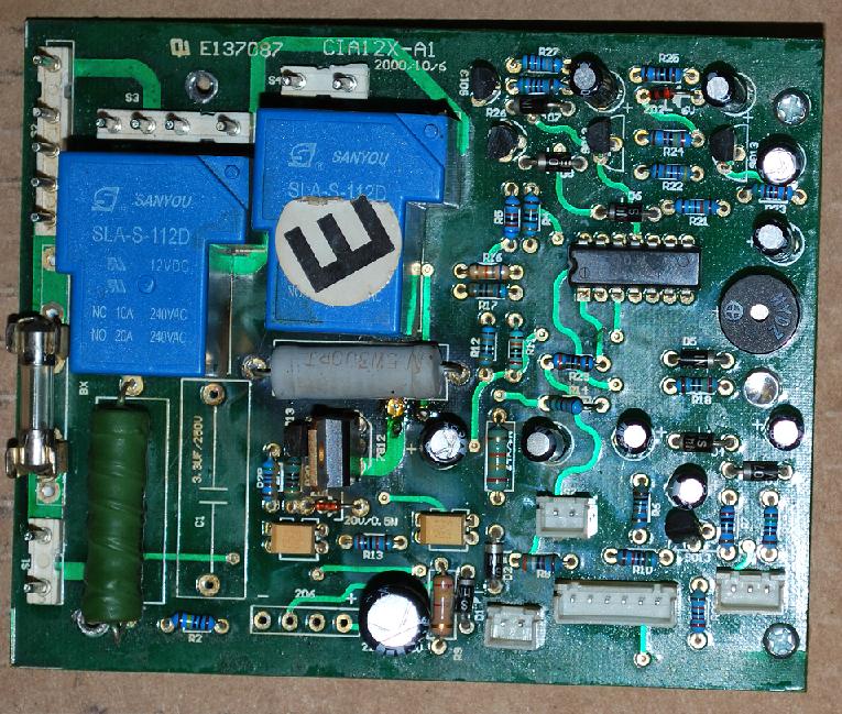

    My old Royal CIA12x shredder quit and the wife wants it fixed so here I sit scratching my head.
    It has a transformerless power supply that is nothing more than a inline cap feeding a rectifier. The DMM shows 121 volts ac coming into the cap and 2.5 going out. The rectifier tests good out of circuit. In circuit the output is almost 0 volts.
    What should the typical voltage drop be through the 3.3uf 250 volt 10% cap with a 1m ohm resistor in parallel shown in the first picture? Will the Blue esr meter check a cap like this? (looking for a good excuse for the wife to buy me one)

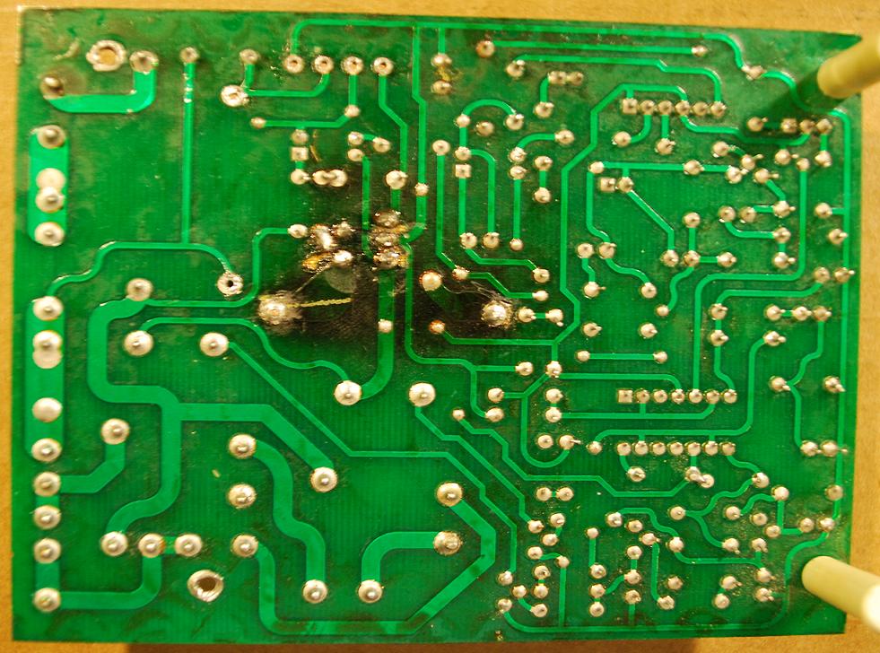

    What is on the other side of that big burn mark in the last picture?

      Re: Royal paper shredder control board
      shorted 20v zener or 7812.
      quite crude.

        yep it is a 7812. It was replaced 9 years ago after it fried the board. Also a trace on the board is now a jumper wire. Like they designed the board so that regulator doubles as a fuse.
        Crude isn't what I called it but that is a very good g-rated description.
        But for the life of me I can't remember what that cap dropped the voltage to.

            Take a quick look at the back of the board. It really is used to drop the voltage. It ought to be near 12 volts if my math is not totally screwed, which I think it is.

              You cannot calculate the voltage drop of the capacitor in series with the mains without knowing the power drain of the device. Put an amp meter in series before the 7812 and see how much it eats. If it's more than 1A, you have something wrong down the line. If it's close to zero, maybe that cap failed open.

                looks like the zener clamps to 20v.the 7812 does the regulating from there.crude DISPOSABLE junk.
                  Well it is drawing 149 milliamps at 2.5 volts before the rectifier

                    I asked before the 7812 not before the rectifier... but either way 2.5 volts will obviously not power a 7812. Replace the series capacitor and see how it goes. The cap also acts as a current limiter - in fact, a capacitor in AC is a resistor - that's why the need for a zener and regulator after it. So depending on the design the cap may be good and something wrong downstream of it instead.
                    PS. You have checked for the obvious, like shorted zener and shorted 7812, right?

                      Sorry, It was easier to flip the cap and hang one end off the board than bend a pin up and solder the rectifier to board twice or use jumpers, so I just had to cheat there.
                      Yep, the 7812 was the second thing I checked after seeing that low voltage and it was what failed long ago.
                      Replacing the cap is what I'm hoping will fix it, but like you say it very well may still be something downstream.
