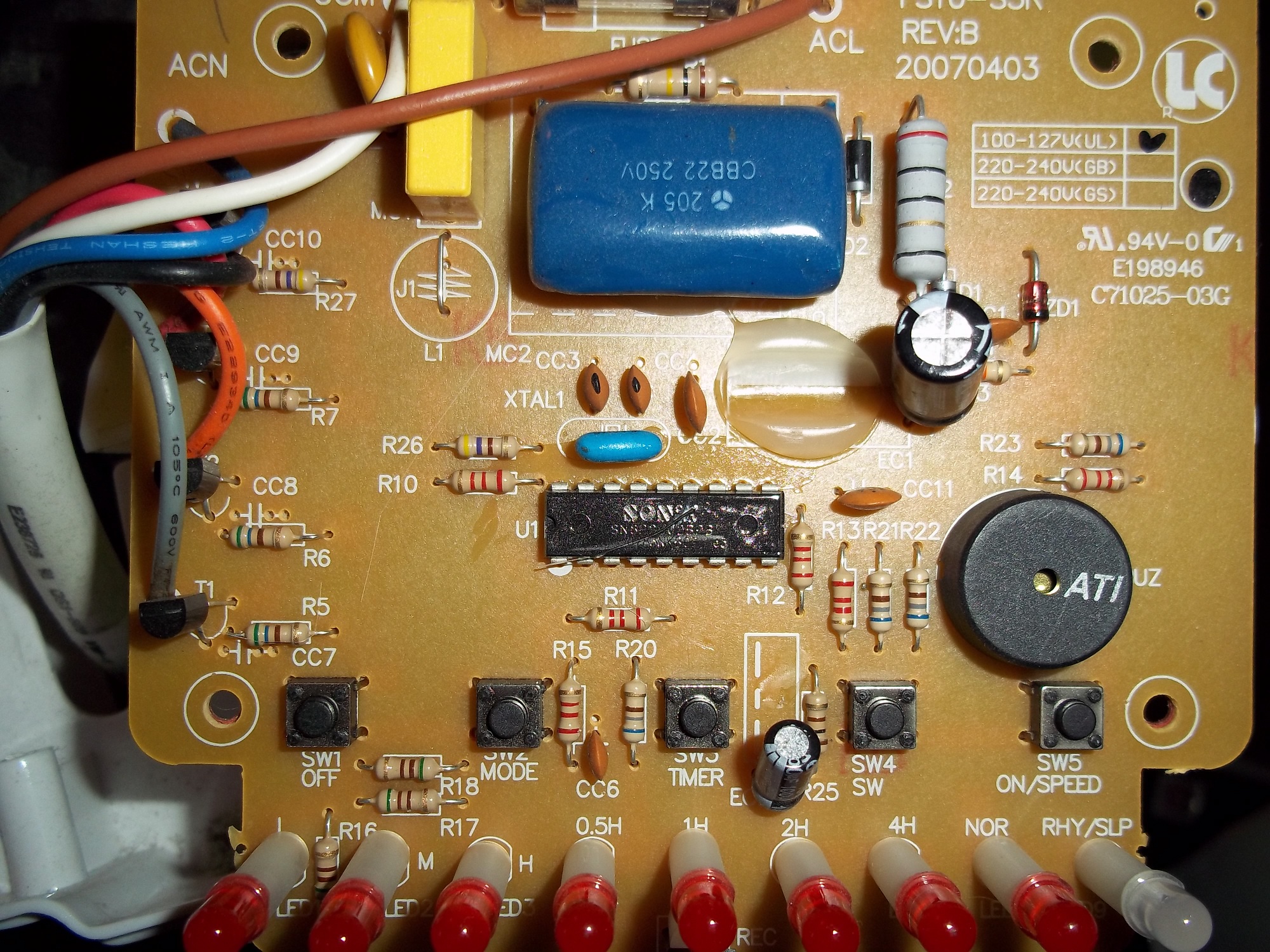

    It died sometime after I turned it off last night. This morning when I turned it on, it would not come on. I unplugged and replugged and felt the motor turn on but watch the led's briefly come on then turn off then barely blink, before going completely dead.
    It looks like this.
    Taking it apart was a pain but I finally got to the panel, there's two lytic caps made by BOR or TBOR, they are 16v 100 uF and 1000 uF.
    Any one got any information on them? Should I replace them and with what?
    I also got a question about the polymer caps, I have two polymers with brown marks at the top of the caps. They don't look like others so I assume this is either by manufacturing or the discoloration means the cap is or has gone bad.
    Re: hawaiian breeze fan
    I replaced both lytic caps with nichicon HN 16v 1000uF and Panny FM 25v 100uf but the results are the same.
    It looks like the unit tries to power up watching the motor attempt to spin as in go/stop motion in split seconds on and off type thing.
    The only thing that could be the problem is the ZNR/MC1 or the big poly cap CBB22 or the blue poly next to the big black chip.
    Any ideas?

        This circuit really isn't that complicated.
        Input power is routed past the fuse and through the rectifier it's then filtered by the poly cap it's then passed through the zener diode the rippled voltage regulated DC is then passed through the larger lytic cap. Which filters it and provides the microcontroller IC with a somewhat voltage stable ripple free power supply. Very primitive but since this is made in China bargain basement stuff as much is nowadays I'm not surprised.
        The micro sends current to the base of one of the four transistors on the outskirts of the board this causes one of them to conduct from collector to emitter like a digital switch. Each of those wires go to a different tap on the motor winding to control the motor speed.
        Check the power supply at the microcontroller first if it checks out check the ceramic resonator the tiny blue thing directly on top of the micro. Again a cost cutting measure since an actual quartz crystal would cost more. You'll need an oscilloscope to check for a stable repetitive waveform or a DMM with a frequency counter function will be required to check this part for proper operation.
        If all of the above checks out the microcontroller probably is at fault I don't see any protection in that circuit for power spikes.
        Micros don't take kindly to poorly designed power supplies.

          Thank you I appreciate your response, I'm still learning. Sadly I don't have an O-scope or have knowledge on how to use one. Perhaps I should invest in USB one and learn. I also don't have DMM with frequency counter function.
          When you mean check the powersupply, do you mean check for voltages? or do I still need a O-Scope.
          But just incase I checked the volts at CBB22 poly cap it 3.5VDC but 117VAC and at the big lytic it's 5vdc.
          So in the event of no O-Scope what would be the first thing to replace to determine problem?

                Well I tested all the wires for continuity, they check out fine.
                I plugged it in and messed with each one to see if their was a loose solder joint with the wires, but to no avail. Everything is controlled from the main board including power.
                One thing to note is that it randomly does come to life for few seconds and the motor spins up just as if I just plugged the thing in then goes dead and does the pulsing thing again this includes the control board too as in the LED1 pulses with the motor.
                Yes pcbonez there's a cap down there it's CBB61 seems common in fans, it's wired to two motors actually, the other one is for the oscillation motor.

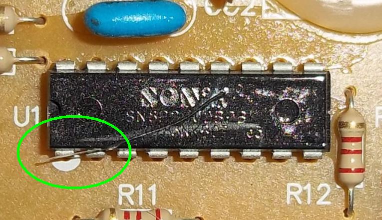

                                Looks like a random strand of wire is bonded to the IC with conformal coating and it may be grounding two pins.
                                  I look at it, it's glue or something I went ahead and scratch it off, then plugged it in and hope that was the problem, then sadly no.

                                    What are the numbers on the IC [and logo].
                                    Mann-Made Global Warming.
                                    - Dr Seuss
                                      Sonic
                                      SN8P2602BPB
                                      0783NKB07
                                        Sonix, actually. SN8P2602B
                                        A 95 page manual: https://cdn.badcaps-static.com/pdfs/...90923eb075.pdf
                                        Doubt that it's knackered, though. If it is, it's trashed as it's a factory programmed chip.
                                        Motor(s) or controller transistors make more sense.
