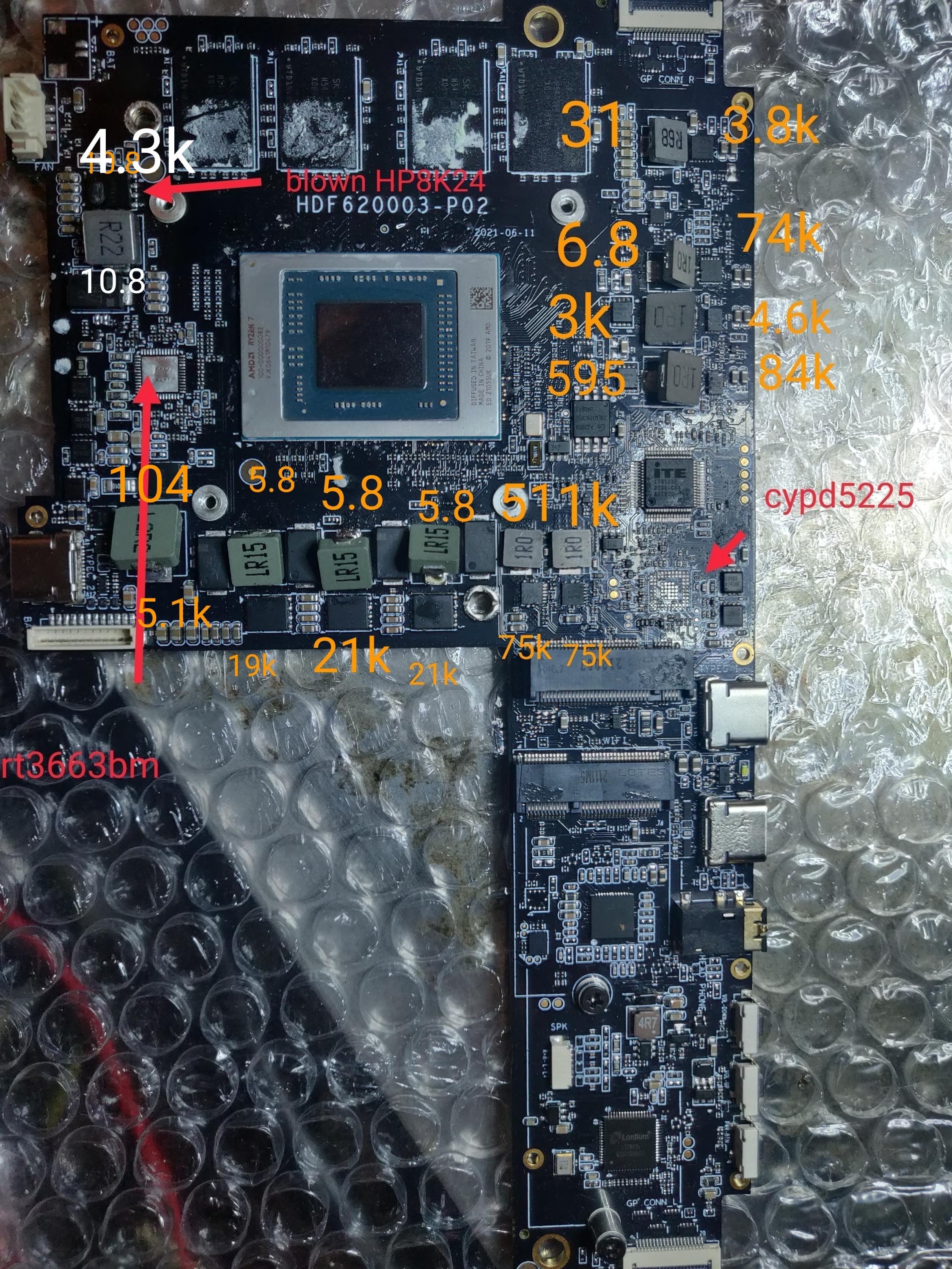

    Hi,device had removed usbc pd driver chip cypd5225 because it was hot,when i got mainboard i connected it to usb charger to test,and after 2-3 tries HP8K24 chip got fried.main voltage was ok(it is ryzen 7 4800u console with 11v battery).Im not very familiar with this design,but after long time i found short on rt3663bm chip on OFSAA( pin24 & 23(resistance to ground0.4ohm),which is doing overclocking through NB of CPU.I have pulled all coils,but
    lowest resistance to ground is 3ohm on cpu side...Is cpu dead?

    Re: Ayaneo 2021 pro short help
    In the meantime i removed rt3663bm chip,"short" is still there on traces that lead to this chip pin24&23...In manual says :23 Over clocking offset setting for the VDD controller.
    24 OFSA Over clocking offset setting for the VDDNB controller.

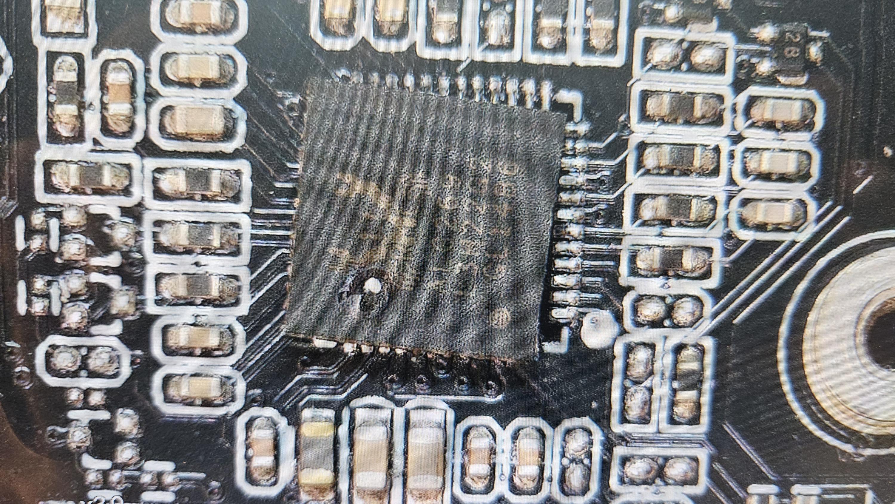

      Post some pictures please
        Here are pics with coils lifted

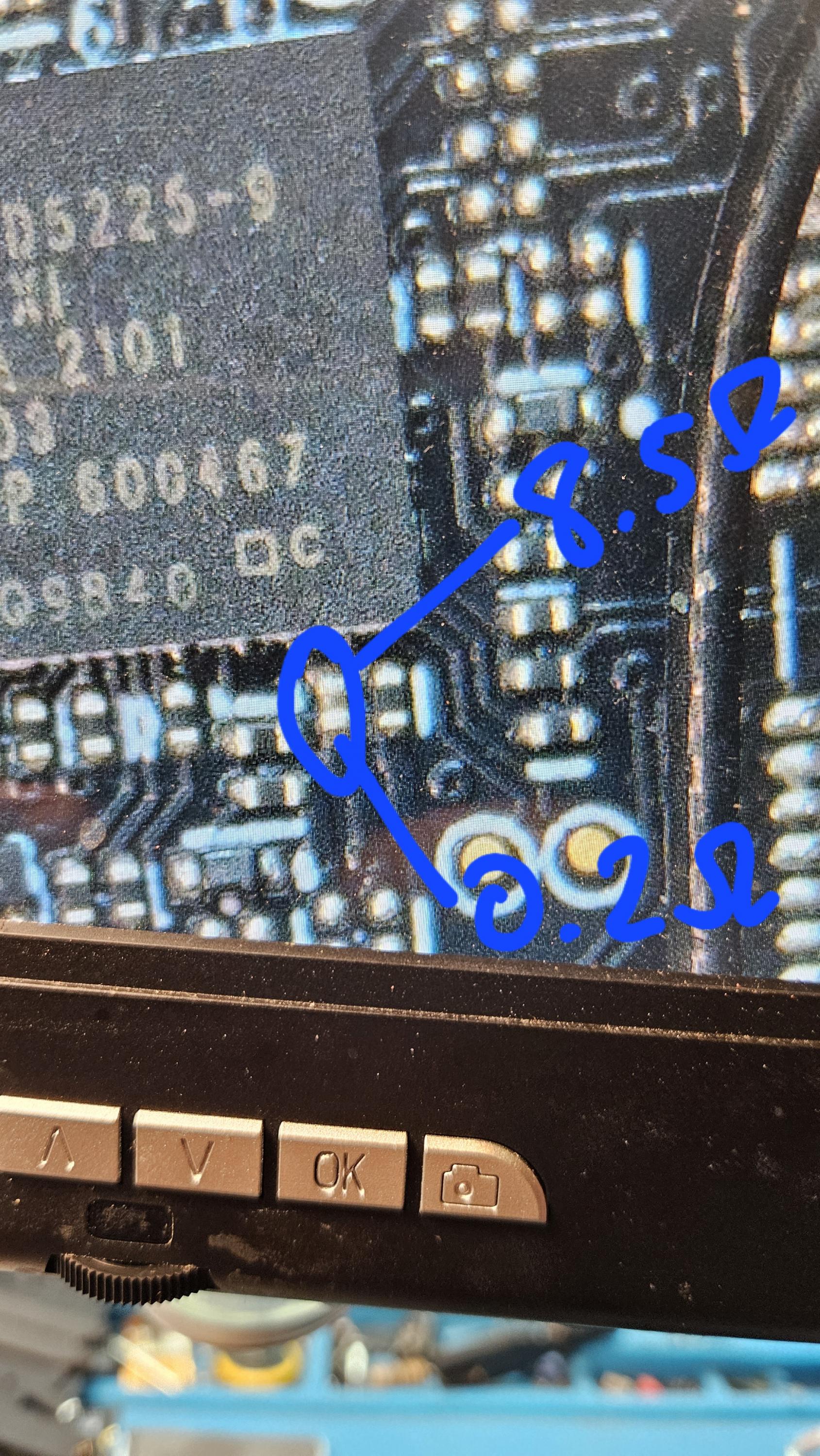

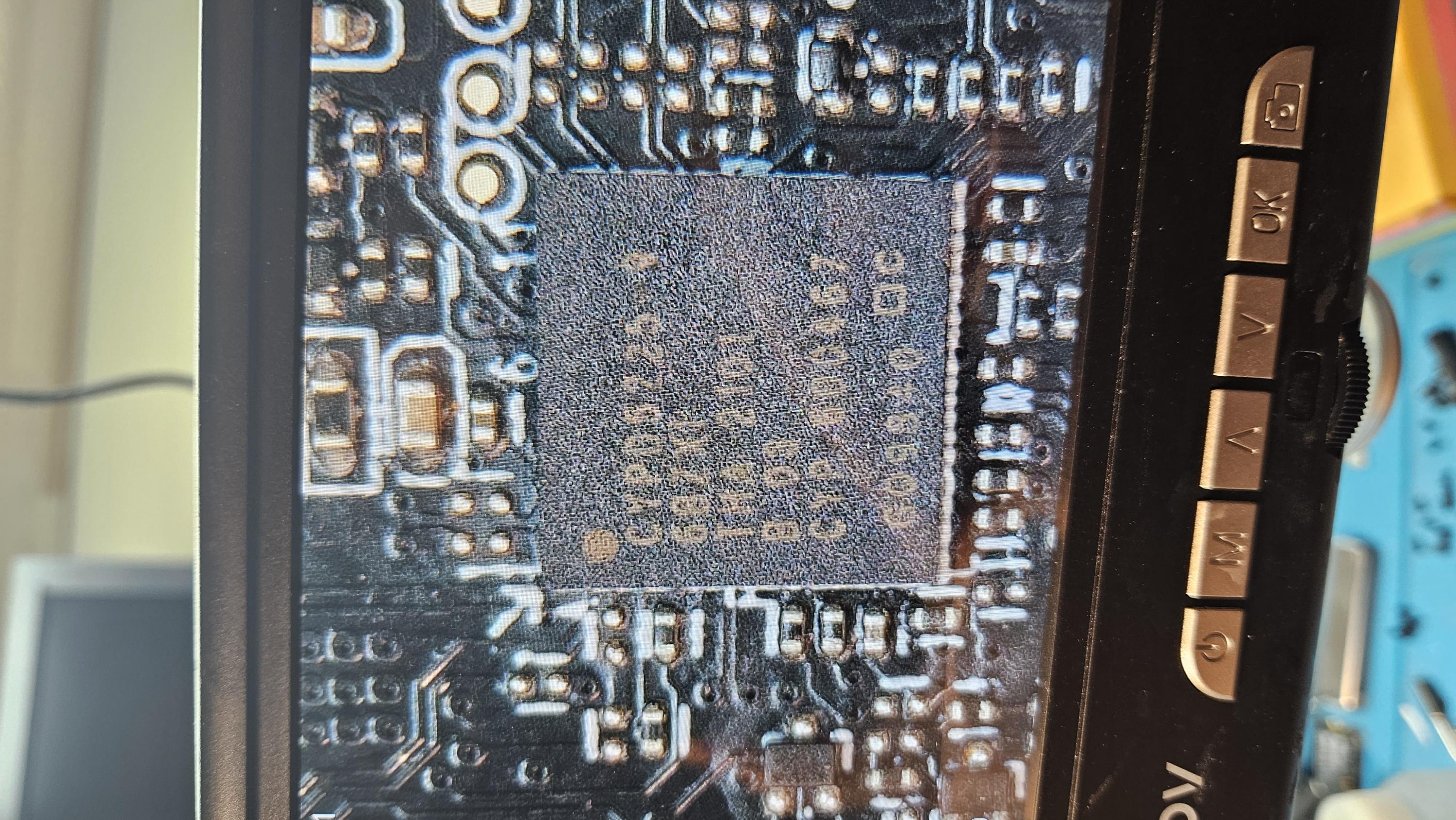

          Has anyone got any further with this? I've got one that won't charge at all and the CYPD5225 IC is the only thing that gets warm. One cap at the bottom right reads 8.5ohm at the top nearest the IC, and 0.2 ohm at the bottom (assuming ground). See attached pic
          Any help is greatly appreciated, never worked on one of these before!
          Andy

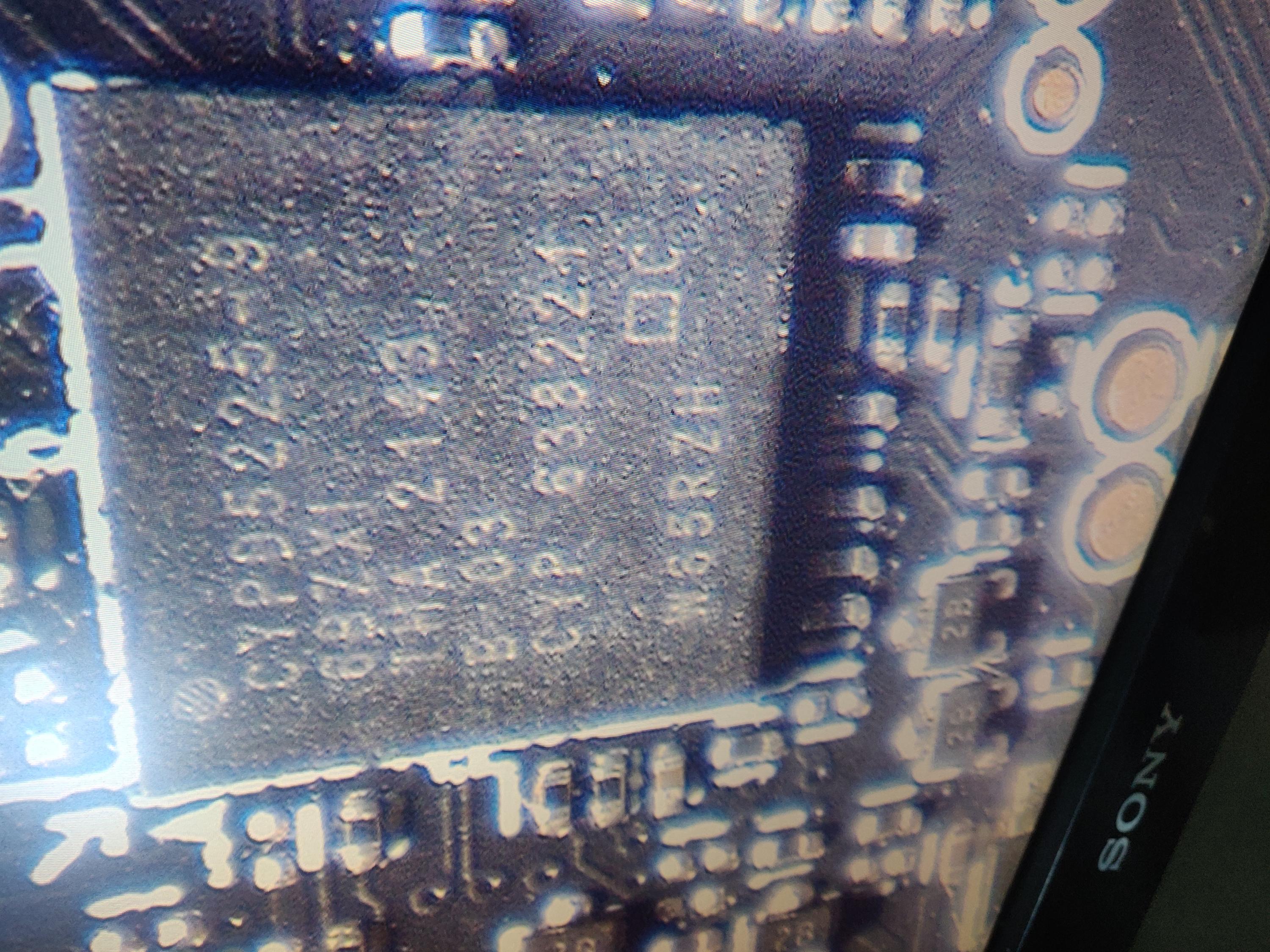

            Post the full topside markings of this power delivery controller. Is it a bga or qfn package?
              Andy
              Mine is 9.2ohm top,0 bottom

                It is bga chip...

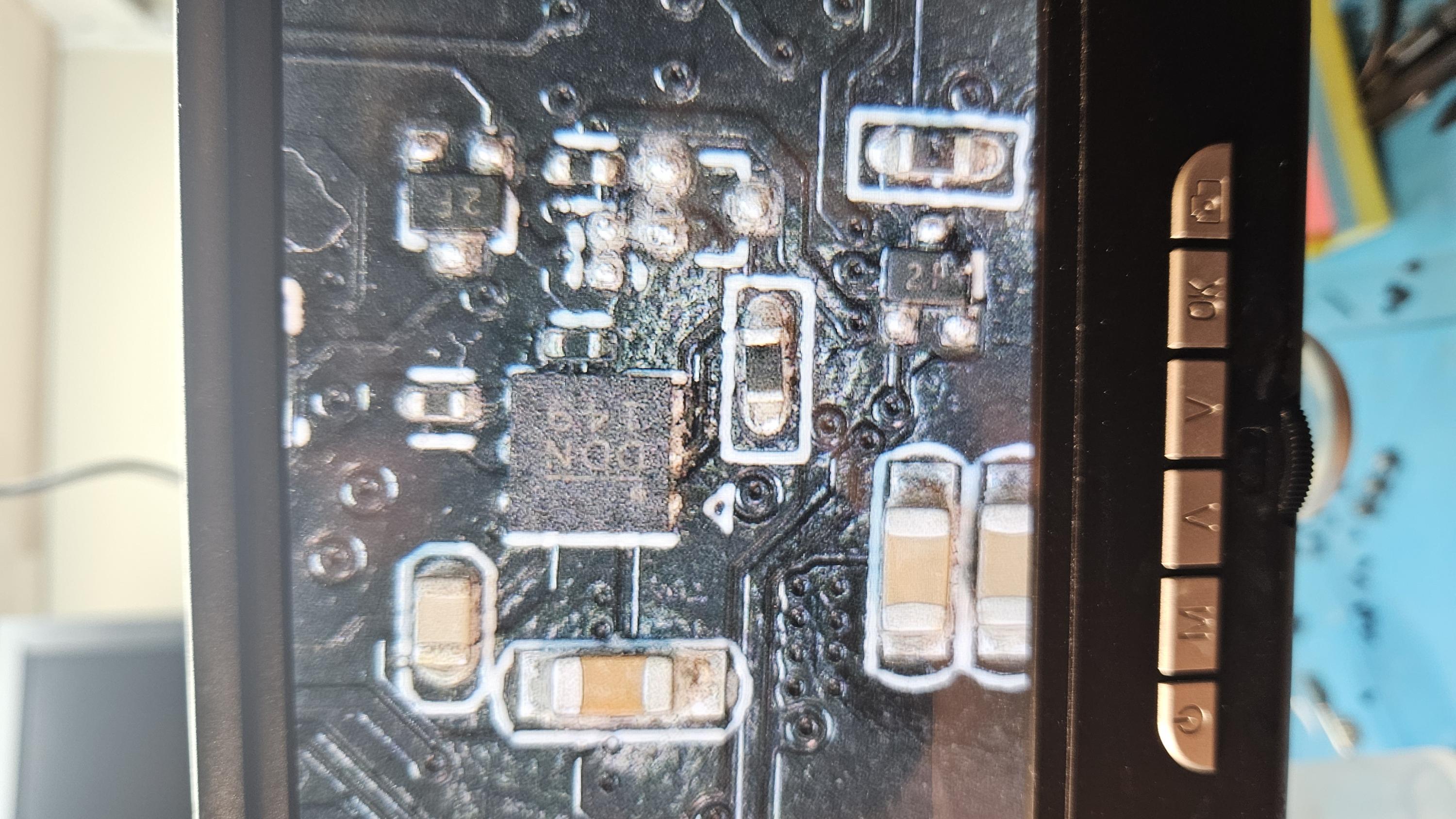

                  I also found the audio IC had gone pop.... seems to have arc'd to the bottom of the wifi board. I also get a lot of heat from a small IC marked DDN149, on the opposite side of the board to the CYPD5225 IC, but i can't find any info. No shorts found around the IC. It has 3.3v one side and 8v the other, not sure if it's up or down converting.
                  Pics for reference
                  Thanks for the quick replies!
                    So that appears normal then. Is that with the IC removed?
                    I haven't taken mine off yet as I don't want to have to reball it if it isn't the issue!

                    • kew1701
                      • Nov 2013
                      • 40
                      • Poland
                      No,i soldered another IC then measured,i don't know where to start with this������

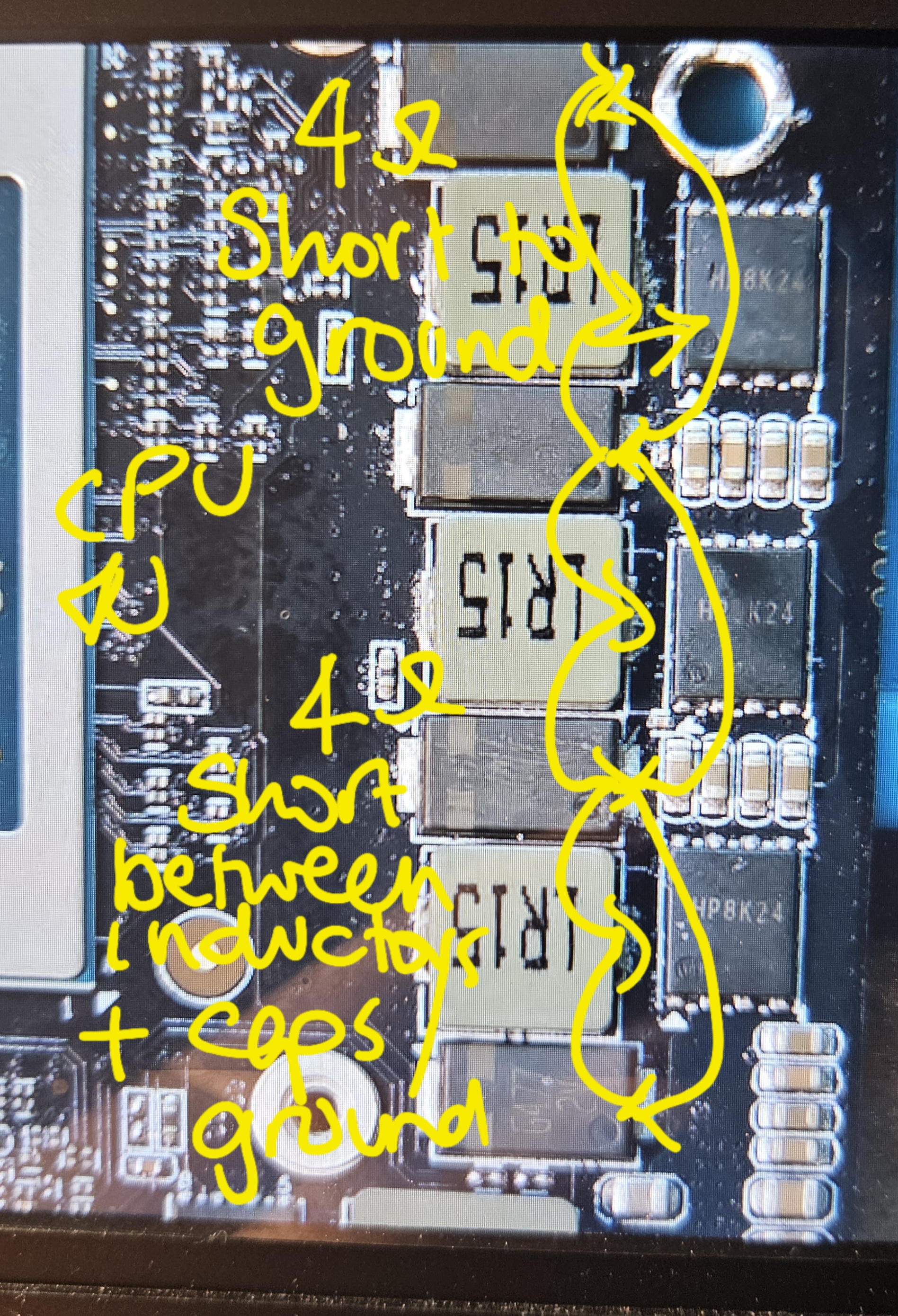

                        I'm also getting a 4ohm reading to ground on both sides of the caps and coils next to the CPU.... it's not looking good...
                        • kew1701
                          • Nov 2013
                          • 40
                          • Poland
                          The cpu has southbridge which is connected to pd controller directly,probably when chip died,it has taken cpu with it...it is such design...that is me thinking loud...

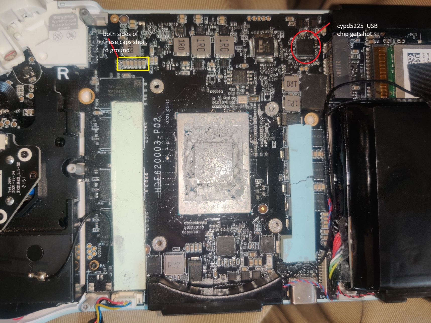

                            Hello
                            I have an ayaneo NEXT with the same PCB and the same shorts. Mine stops working one day and smoke comes out around the power button. After opening it the usb-c chip was burned.
                            When I try to turn it on, it turns the cpu fan at max speed and no video output. The battery is fully charged.
                            The usb-c port only takes 5v. I'm planning to remove the usb-c chip and try to use the device with battery only to check its health or something.
                            Also, I notice that there is another battery connector that only has + and - contacts so maybe use it to power on the device.
                            The thing is that I came across this post and after checking the image I have short to ground one mosfet and all coils around the battery side of APU. I will try to find what causes the short.

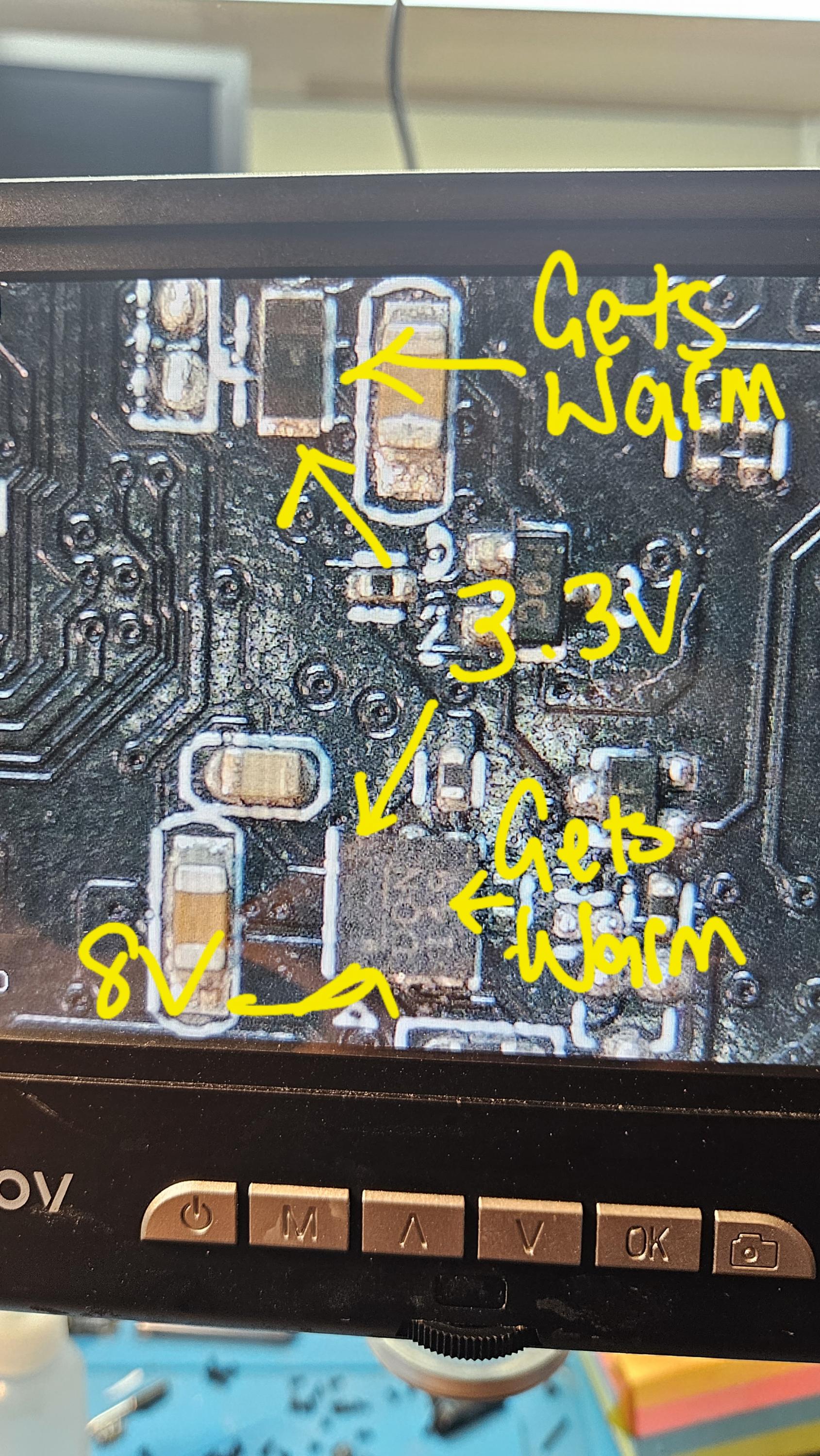

                                Hi. I'm wondering if anybody has successfully managed to repair this. Is there any confirmation that the APU gets fried in these situations?
                                I have an Ayaneo Next with the same exact problem. It powers on to the fan spinning, no boot and only that cypd5225 BGA USB chip gets extremely hot.
                                I don't see any physical damage to other chips. Here's a picture. I bought it used and the previous owner semed to really enjoy thermal compound!
                                Thanks for any advice.
