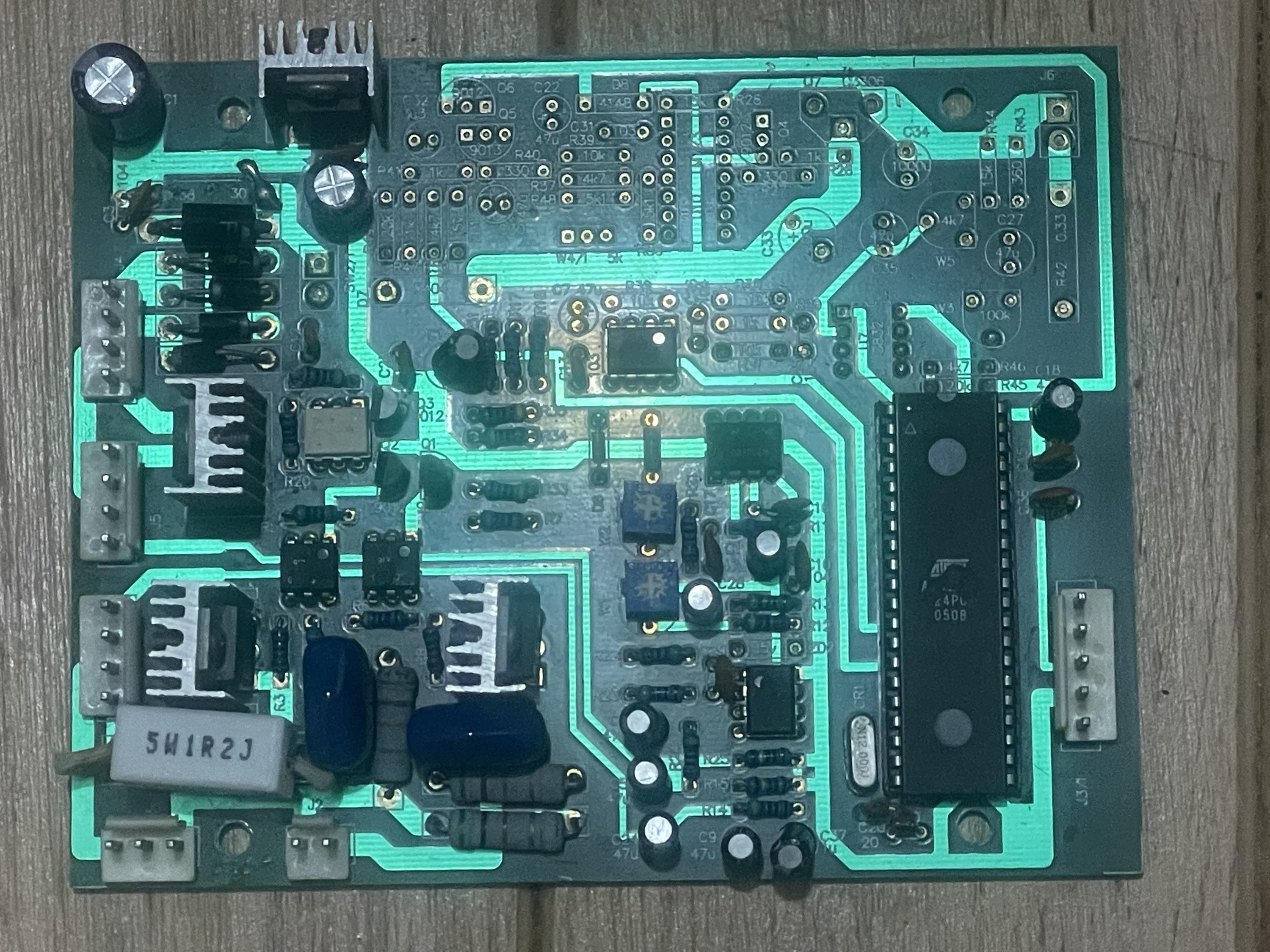

              looking at the pictures in the original post,
              R7 is almost gone - blown away!
              it's under and left of the optocouplers
              • redwire
                • Dec 2010
                • 3912
                Re: Aoyue 738 4 in 1 solder station power board
                R7 is the opto LED resistor, driven by Q1, for the triac to the upper left of it. Like R5/Q2 is for the triac to the upper right. But R7 looks not blown, maybe a bit baked?
                If it is cooked then the opto-isolator should be checked for shorts.
                It is normal to see low resistance <100R between the output pins (in-circuit) going to the triac gate, but not between sides.
                Somewhere there is a thermocouple input resistor that could have gotten cooked. The whole section around trimpots W1, W2 is for the TC amplifier it looks like. That is what the long traces running under the opto's from J1, J5 are bringing in.
                So R24 looks a bit cooked? but the pictures need to be better quality less fuzz and more light. I have no idea how the GX connector makes it to the board.
                        For the low voltage DC power supply, J4 yellow wires from the power transformer go to 4-diodes for a bridge rectifier that feed C1 and the 5V regulator input. It looks like mostly your standard fare.
                        The only thing odd is the huge diode and solder bodge looks like it might be a zener or TVS? - if you find the input voltage too low then suspect that big diode.
                        But the 5V output being low and fluctuating - you'll have to take some more readings.
                        To troubleshoot the 5V power rail, you don't need all the mains stuff connected to the board, only J4. This is assuming the power tranny has power, I'm not sure how it is wired or the on/off switch etc. It would be less stressful and a bit safer.

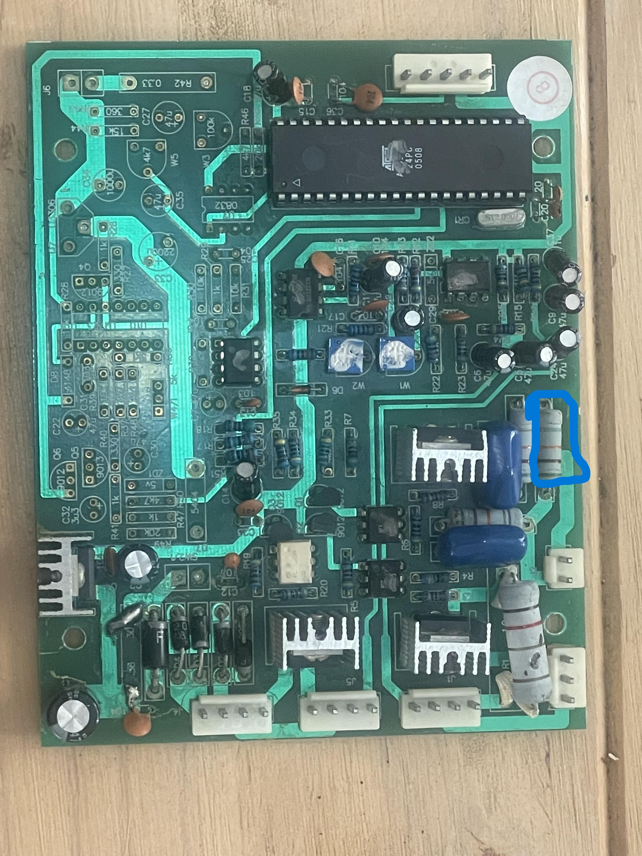

                                      • mentholflash
                                        • Mar 2013
                                        • 36
                                        • Western Australia
                                        #39
                                        It was this 1
                                        The display is the five pin header @ the Atmel
                                        Cheers
                                        • redwire
                                          • Dec 2010
                                          • 3912
                                          #40
                                          Yes that's the one resistor connected at J2, across or in series with a load? Is that the air pump?
                                          edit: I can't see any problem with that output causing a display problem though. I wonder if the MCU is still alive.
