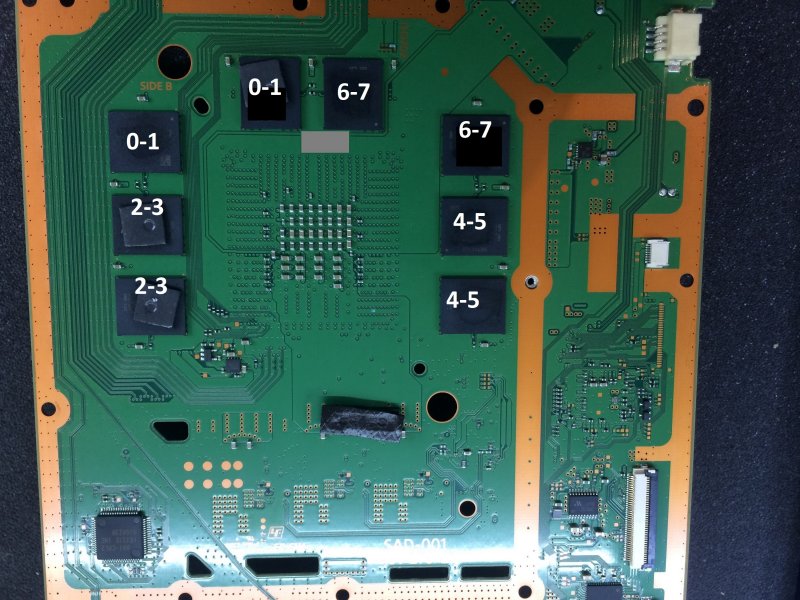

          Re: PS4 with BLOD - Getting UART enabled ?
          Originally posted by orion78fr
          Okay guys ! So it has been a few days and I managed to find an old version of the BwE PS4 NOR Validator that I successfully used to enable UART on the PS4. I won't link to it directly (as I don't want it to be taken down, it's useful stuff) but I can give it to you via private message if you need it.
          I don't know if it can be done on all versions on the same offset, but for my BIOS version (ps4 dump checker identified it as firmware 1.62.0000 ?), it changed the FF at 1C931F to 01, according to HxD (it's in an FF block, so the address seemed random, but it worked).
          So now that I have UART enabled on the PS4, I can look at the logs. I tried to use pins 2 & 5 on a serial port on an old Dell D600 on linux but didn't manage to make it work, I don't know why (I've set the correct baud rate of 115200 but I seem to only get garbage).
          I have a CH341 that have another mode than bios dump (written something in chinese TTL on the back) that I can change with a jumper and gives me a COM port on my PC, I just had to connect the TX & GND points of the PS4 to the RX & GND points of the CH341 and use PuTTY.
          So what did I get ?
          "ERROR: DCT[0] is disabled" "ERROR: DCT[1] is disabled"
          Which means the first bank of RAM is dead.
          However, putting pressure on the ram with my finger, it managed to boot correctly. I even put a game disk and played for 15 mins, no problem...
          ... until I walked a bit too hard near it and it crashed (with an MC4 corrupted message or something like that).
          I think a ram chip has a cracked solder ball or something like that, I'm going to reflow them and see.
          You must replace the RAM according to the attached picture
            Thanks for the confirmation, I already saw a crop of this image.
            The RAM on the opposite side of these are part of the same bank right ?
