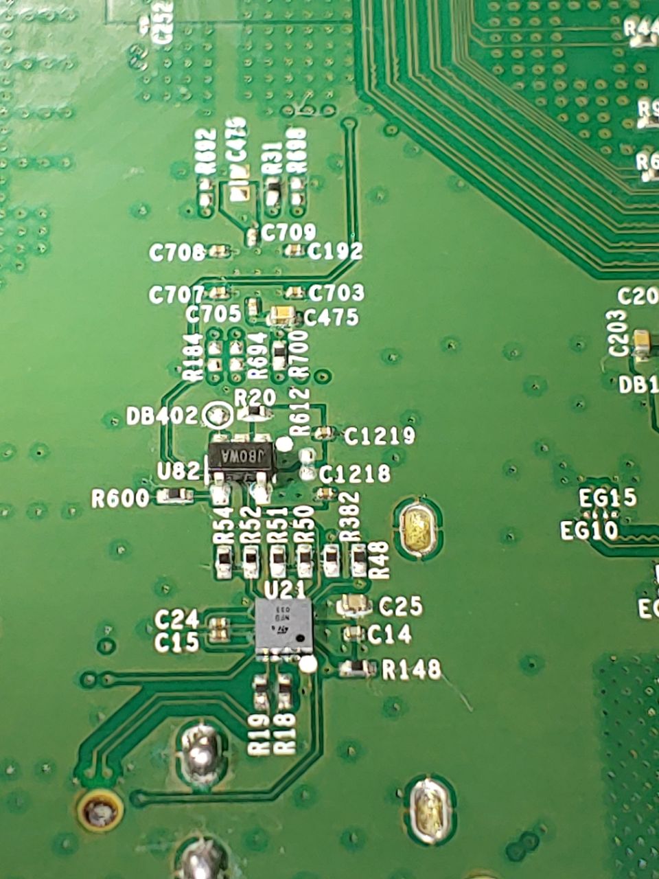

                          I am troubleshooting Xbox Series X shutting off immediately after HDMI port replacement. I am trying to identify values of R18 and R19 resistors. When measuring across, they both show near 0 ohms. I do not know whether this is normal or what. Take a look at the enclosed photo for reference. Thanks.
                          • liquidzorch
                            • Oct 2016
                            • 134
                            • mexico
                            Re: Xbox Series X shuts off after ~6 seconds
                            Those are 0 ohms. Try looking at u82, that seems to blow if anything is shorted at the HDMI connector. There should be 3.3v on pin 1 I believe. And when turned on, pin 6 should have 3.3v. If pin 6 doesn't get 3.3v when turned on, replace the u82, you can find them on other boards. Any chance you could take a measurement of the GPU core voltage side to ground, how much resistance do you get?

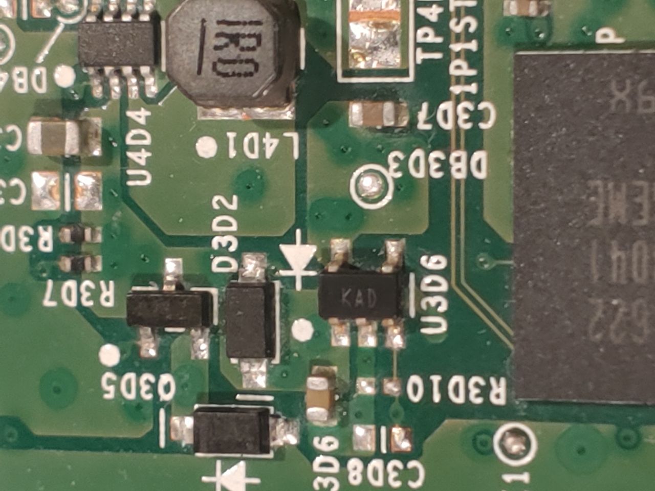

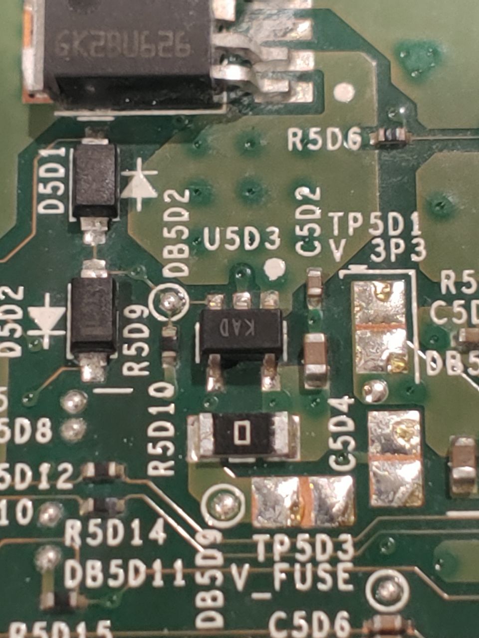

                              I currently have an Xbox One S motherboard available to steal components from. I found similarly looking components with markings "KAD" on it. Is this the one I can use as a replacement? Take a look at the enclosed photos.
