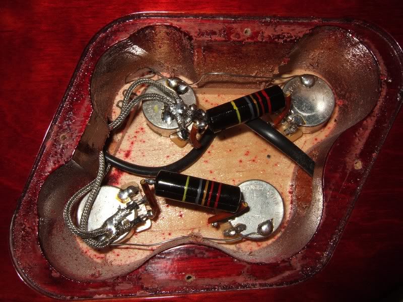

                              #34
                              Re: Suggested Caps for Xbox360
                              when you say bumblebee cap i think of these.
                              • PCBONEZ
                                Grumpy Old Fart
                                • Aug 2005
                                • 10661
                                #35
                                Nah, those are clearly wasps... LOL
