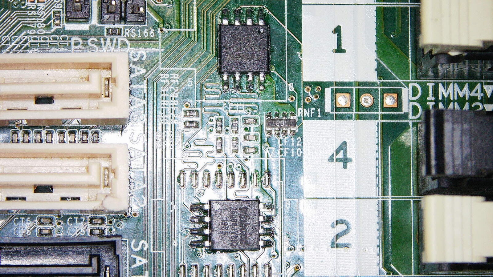

                              I hope someone can help me. I am a complete noob when it comes to BIOS flashing. I corrupted the BIOS in my Dell 9010 desktop trying to update it via an .exe file. Fans run and error LED blinks a BIOS code, but no screen or any other function. I have procured the ch143a programmer and the 9010 desktop BIOS files. I have found the location of the BIOS and EC ICs. Both are next to each other and they are both 8 pin SOP-8 packages. One of the ICs has a dual mount option 8 pin or 16 pin. I have attached a picture where both ICs can be seen. Sorry about the washed out contrast, I can send a new picture if needed. I need to know which IC is the main BIOS and which IC is the EC before I start try to flash and mess up something else. I have looked all over the internet and found everything but which IC is which. Thank you!

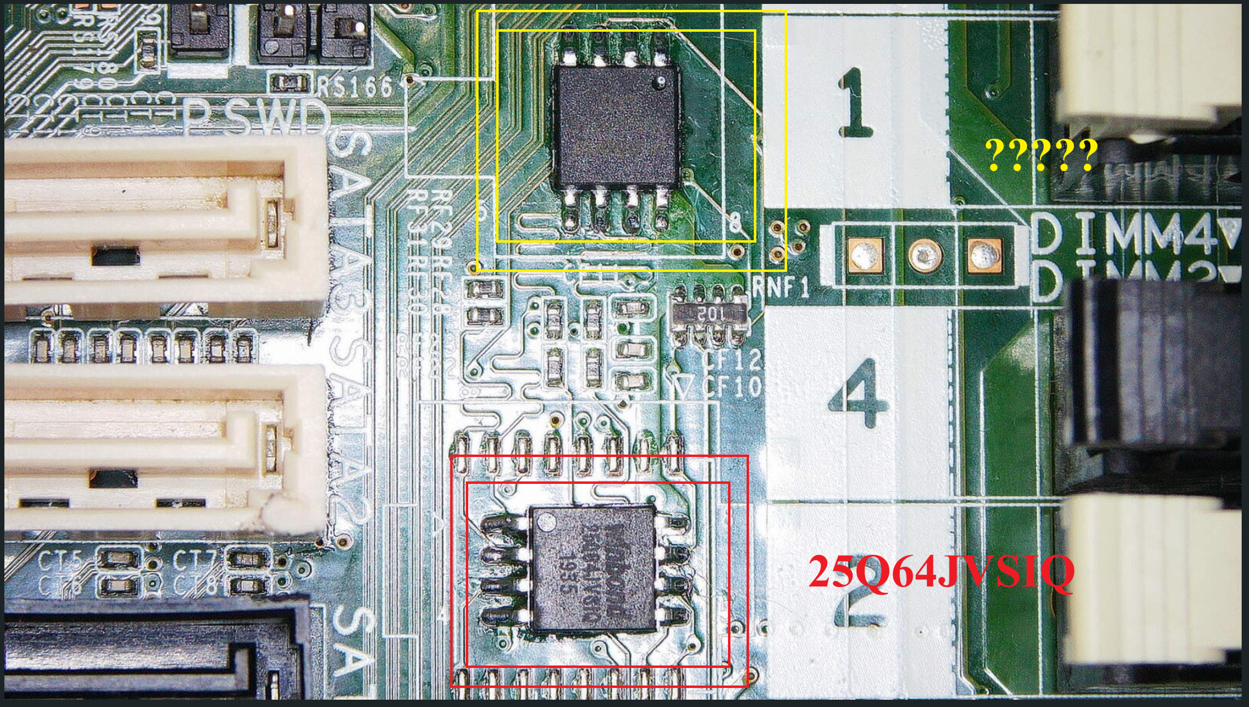

                              What is the name of the yellow chip ?

                              • mikeybass
                                • Aug 2024
                                • 8
                                I did mean to post the IC numbers. Top chip in the picture which you highlighted in yellow is Winbond 25Q32JVSIQ. The bottom IC is a Winbond 25Q64JVSIQ, which I suspect is the main BIOS IC, with the upper IC being the EC IC. Thanks!
                                  Both chips are bios chips, your bios file is 12MB split on one 8MB chip and one 4MB chip.
