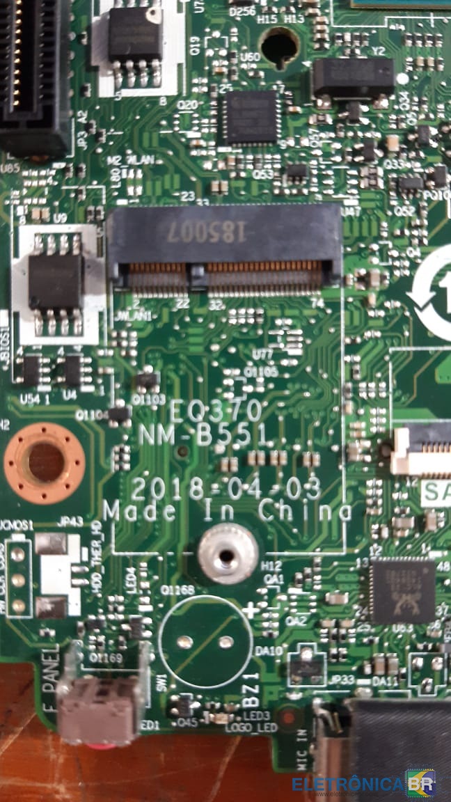

lenovo m920q EQ370 NM-B551
  • fdonato
    • Jul 2020
    • 2
    • Brazil
    Hello, i'm needing bios file 16 mb for lenovo m920q EQ370 NM-B551 REV 1,0

                  Lenovo M920Q - black screen
                  Patient - Lenovo M920Q
                  Board EQ370 NM-B551 iq3x0il
                  Issue: No display after BIOS upgrade
                  PC starts automatically after connecting power,
                  solid green led, solid red led (iluminates thinkcentre logo),
                  Fan spins,
                  No beeps,
                  CPU Replaced,
                  RAM Replaced,
                  SSD Disconnected,
                  Tried both video outputs (HDMI and DisplayPort),
                  Disconnected BIOS Battery,
                  Dumped original BIOS & EC, checked BIOS with MEAnalyzer - "Firmware is incomplete/corrupted"
                  Flashed (With TL866II) BIOS only, provided by @hoaca388 found on this topic - no change.
                  Flashed EC also - no change.
                  Tried different BIOS & EC Found on "vinafix" website - no change.
                  Tried to flash chips with CH341A - still nothing..
                  Anyone have any idea what to do next?

                                    I've found out that RAM is getting about 0.3V instead of 1.2V (PL902), but I cannot figure out what causes the voltage drop..
