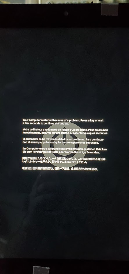

          Hey Guys, i have a 2019 iMac 21.5'' after flash the unlocked bios i cannot startup the OS X but i tried install Windows and worked well, any tips? thank you.
