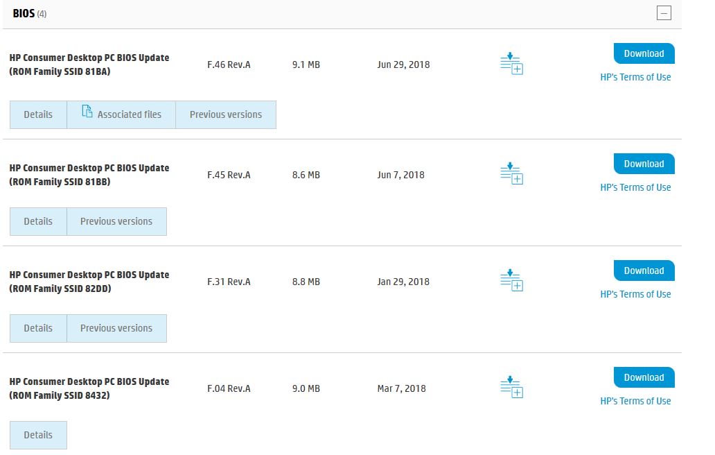

        Re: HP All-in-One bios
        Go to the HP drivers support page: https://support.hp.com/emea_middle_e...model/11792264
        Choose your OS version,then on BIOS.There are 4 different bios versions for this model: 81BA,81BB,82DD and 8432 .

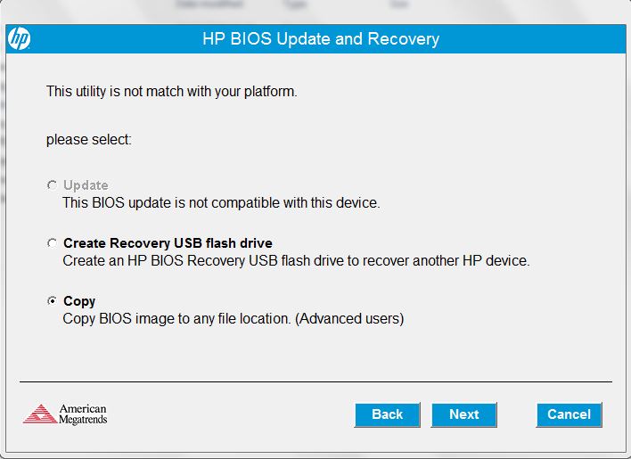

        Download the first bios (ROM Family SSID 81BA) F.46 Rev.A and run the exe ,it will give you the option to save the bios to a file location.The saved file will be the full 8,192KB 8MB bios .
        The second bios in the list (ROM Family SSID 81BB),F.45 Rev.A i found doesn`t give the option screen to save the bios, in this case you have to download an older Previos version , F.41 Rev.A or older. Save the bios for all 4 and try each one .

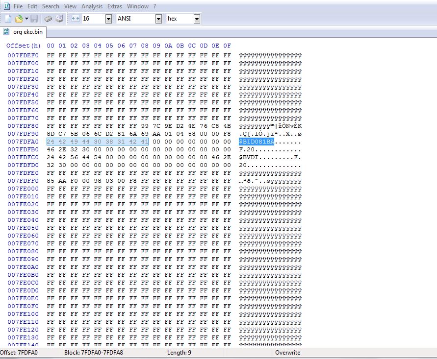

        (You`ll have to try them all,as you havnt provided your bios backup.The bios backup will have one of those ID`s in it,you can seach with a hex editor to find out which one you need,instead of trying all 4 versions)
