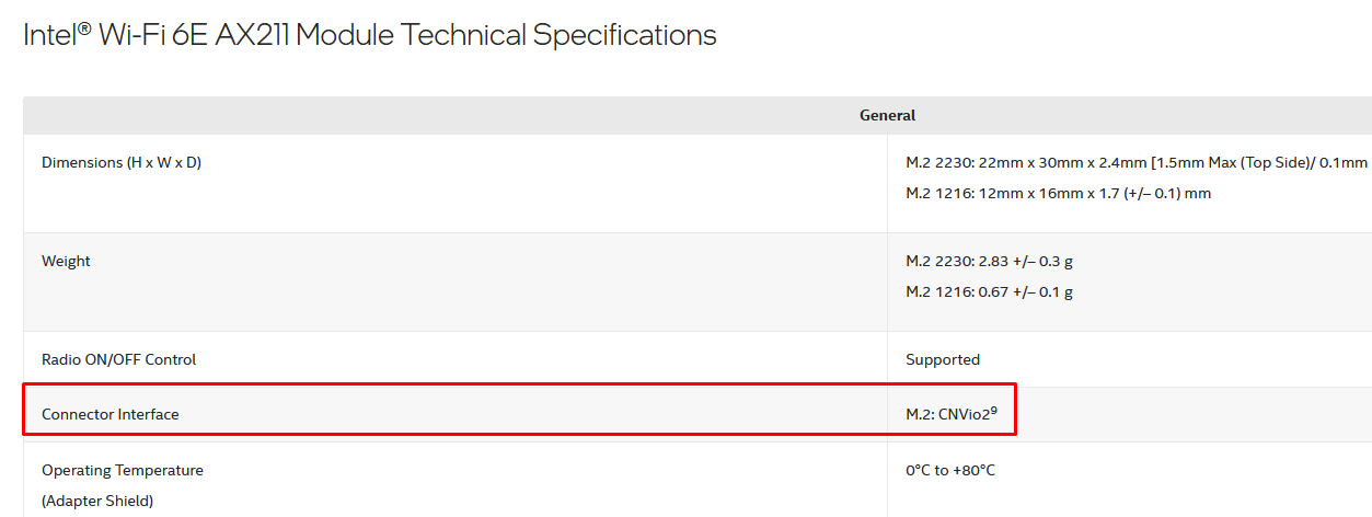

      The new card is an Intel AX211NGW, but once installed the unit does not even power on

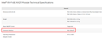

        You're trying to use a CNVio2 card (AX211NGW) on a PCIe/CNVio slot, it's incompatible, that prevents you from even powering on, see this:
        https://community.intel.com/t5/Wirel...on/td-p/731493
        If you have a 8th or 9th gen mobile CPU and CNVio interface you cannot install the AX201 as it is incompatible. This incompatibility manifests in a complete inability to power on (confirmed on multiple systems). This wont be a failure to post issue, the system will literally ignore that you pressed the power button. Fortunately this is temporary as remove the card returns the system to normal.

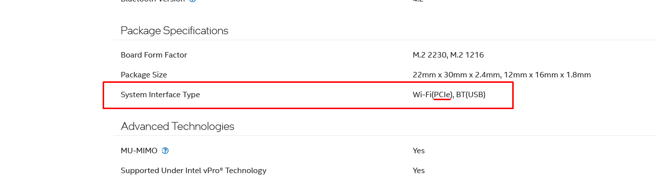

          Your problem is not whitelisting...when there is an incompatibility problem then the laptop starts OK but the booting process is halted with a message like 1802: Unauthorized network card is plugged in...
          The Interface Type of the two cards are different:
ID:	3686571 Click image for larger version
