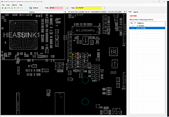

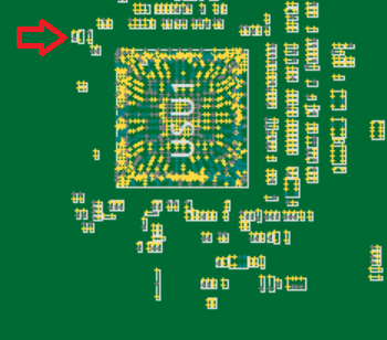

        • McKey
          • Jun 2024
          • 53
          • Hungary
          Originally posted by jeffer dacon
          Hello bro, if you need a special location I will be attentive
          Hi, can you get values on that view?
          I need the value of the fourth resistor from the top (non wifi variant, but should be the same).
          I belive that the other pads around it are not populated, but the fourth from the top looks like its been knocked off:

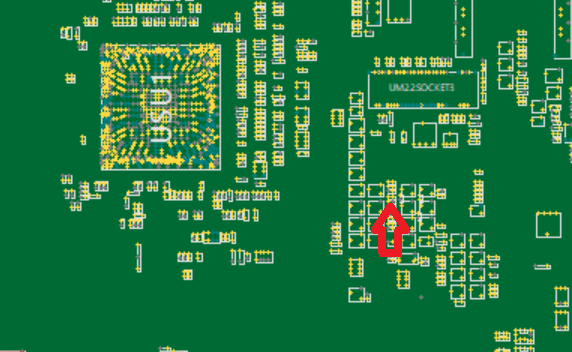

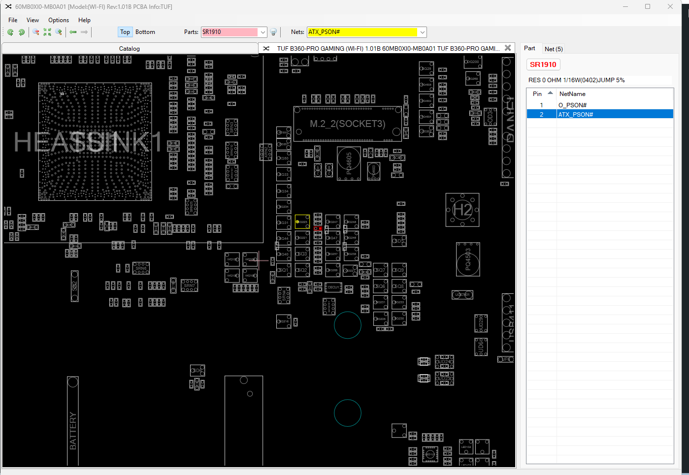

          • noname2024
            • Aug 2024
            • 275
            • CỎ MỸ XỊN
            Click image for larger version Name:	kép.png Views:	0 Size:	2.51 MB ID:	3556748
            Thanks in advance!
            try Click image for larger version

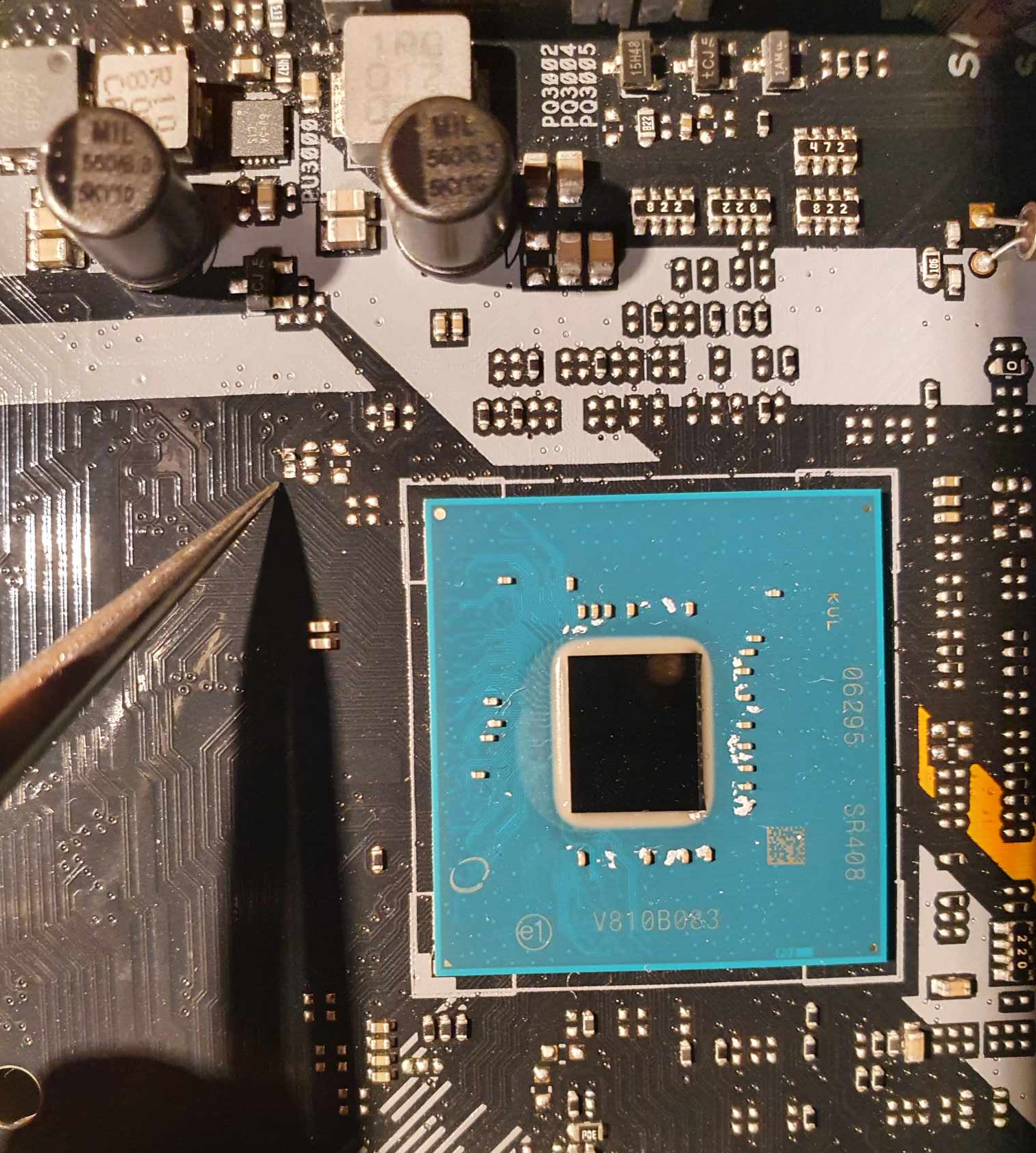

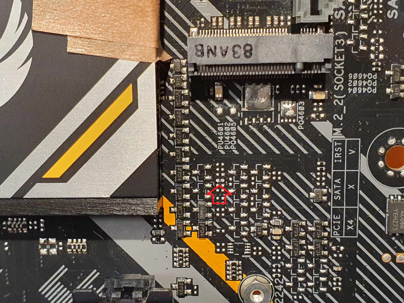

            • McKey
              • Jun 2024
              • 53
              • Hungary
              Originally posted by noname2024
              try
              Thank you!
              Sorry for bothering you, but i found the real problem, a missing component below the PCH heatsink.
              Please let me know how can i return the favor!

                • McKey
                  • Jun 2024
                  • 53
                  • Hungary
                  HI BRO I don't see a resistive value, I hope it helps.
                  Thanks! I did found a similar sch, and there is a 1uF capacitor there and it works with that!
