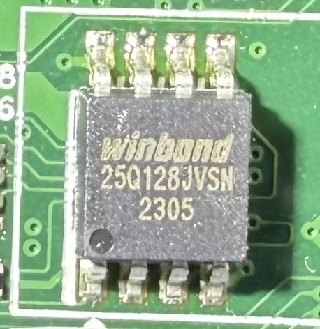

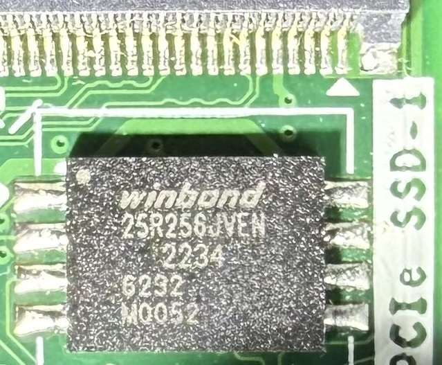

                        Hi everyone, very new here.
                        I have an Optiplex 7010 with a 13th Gen 13500.
                        The Service Tag is: 67CYCX3-8FC8
                        I've browsed many threads on badcaps and saw similar posts about PCs with 2 BIOS chips, but I'm still unsure about mine.
                        Mine has 2 chips:
                        Code:
                        Winbond 25R256JVEN
                        Code:
                        Winbond 25Q128JVSN
                        I have a chip programmer on the way, but if anyone has any tips please let me know.
                        I'm not sure which of the 2 chips I need to dump and flash, or if it's both?
                        Thanks in advance.​
