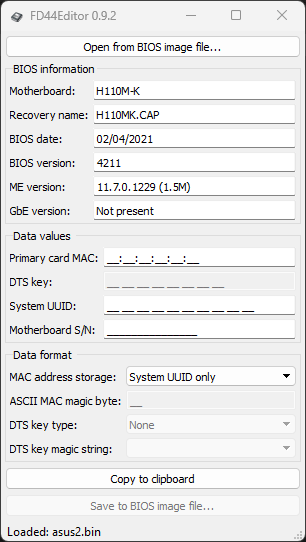

    Look for a soft called FD44Editor, u can read and and enter these data with it manually. MAC is mandatory, other data not necessarilly.

      I tried the software to read the dump file. but I can not find any UUID or mac or any data showing in the software. May be I have to manually add them to make new bin and flash it?
      Picture attached: tried to read old bios dump.

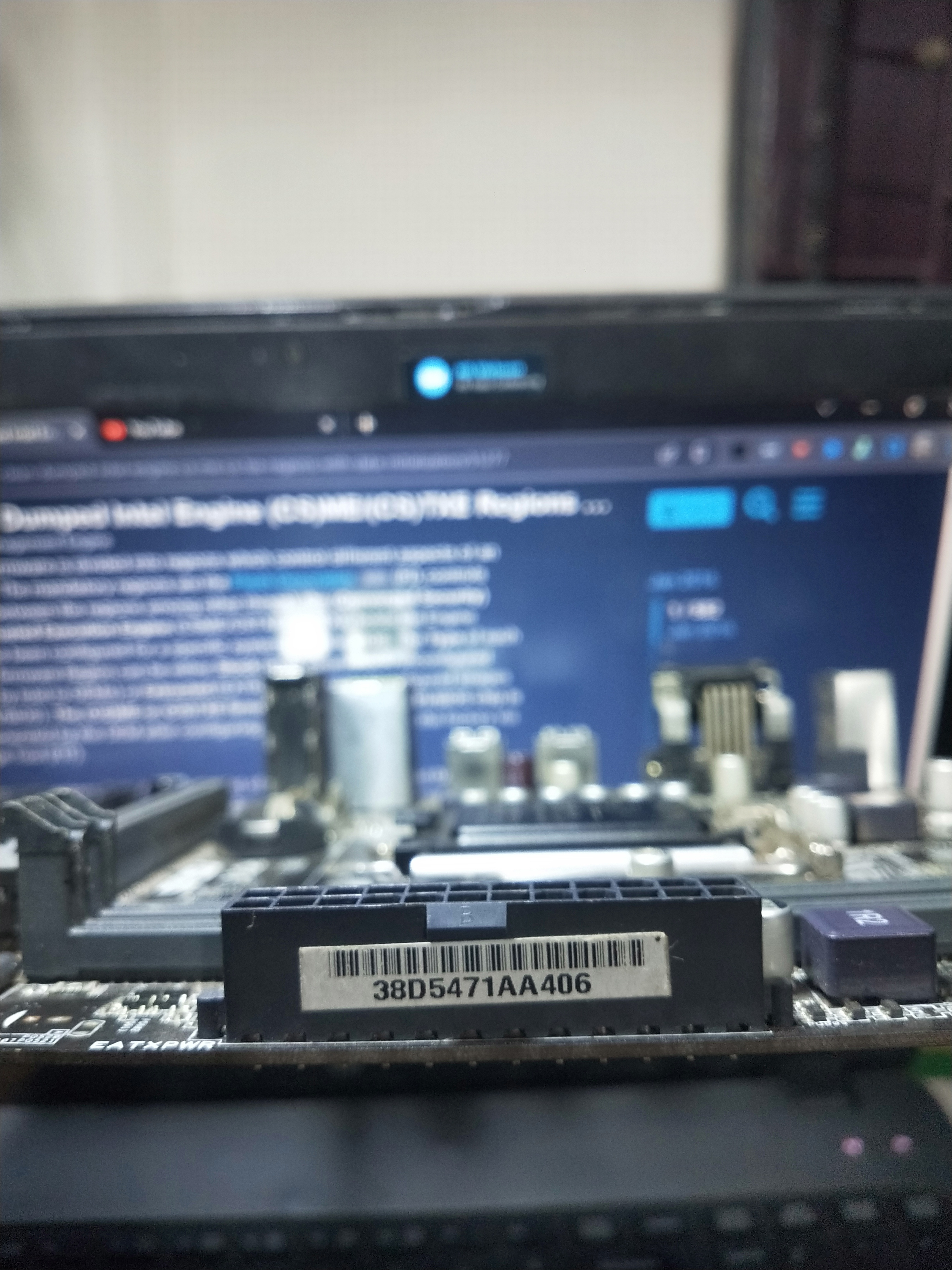

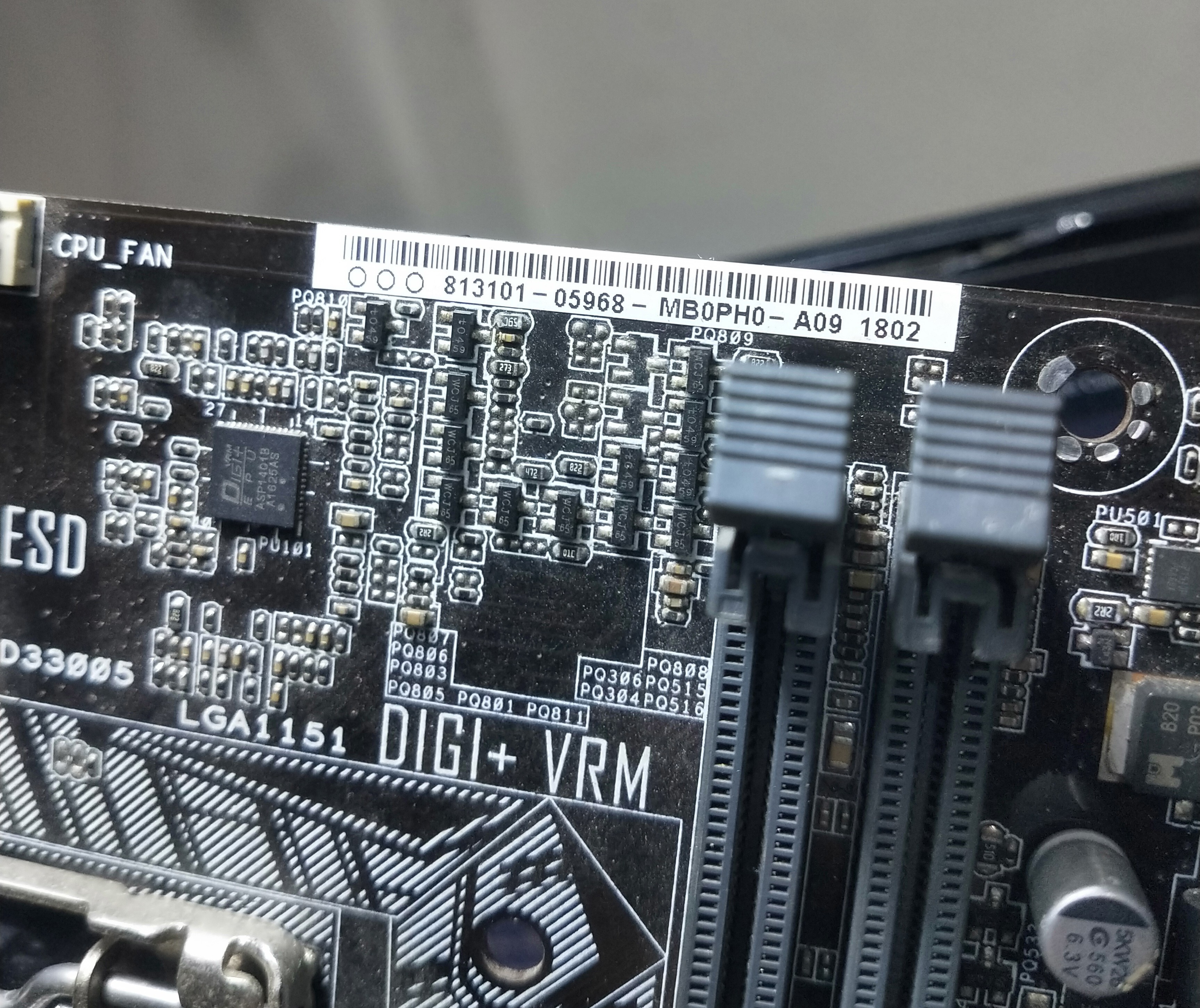

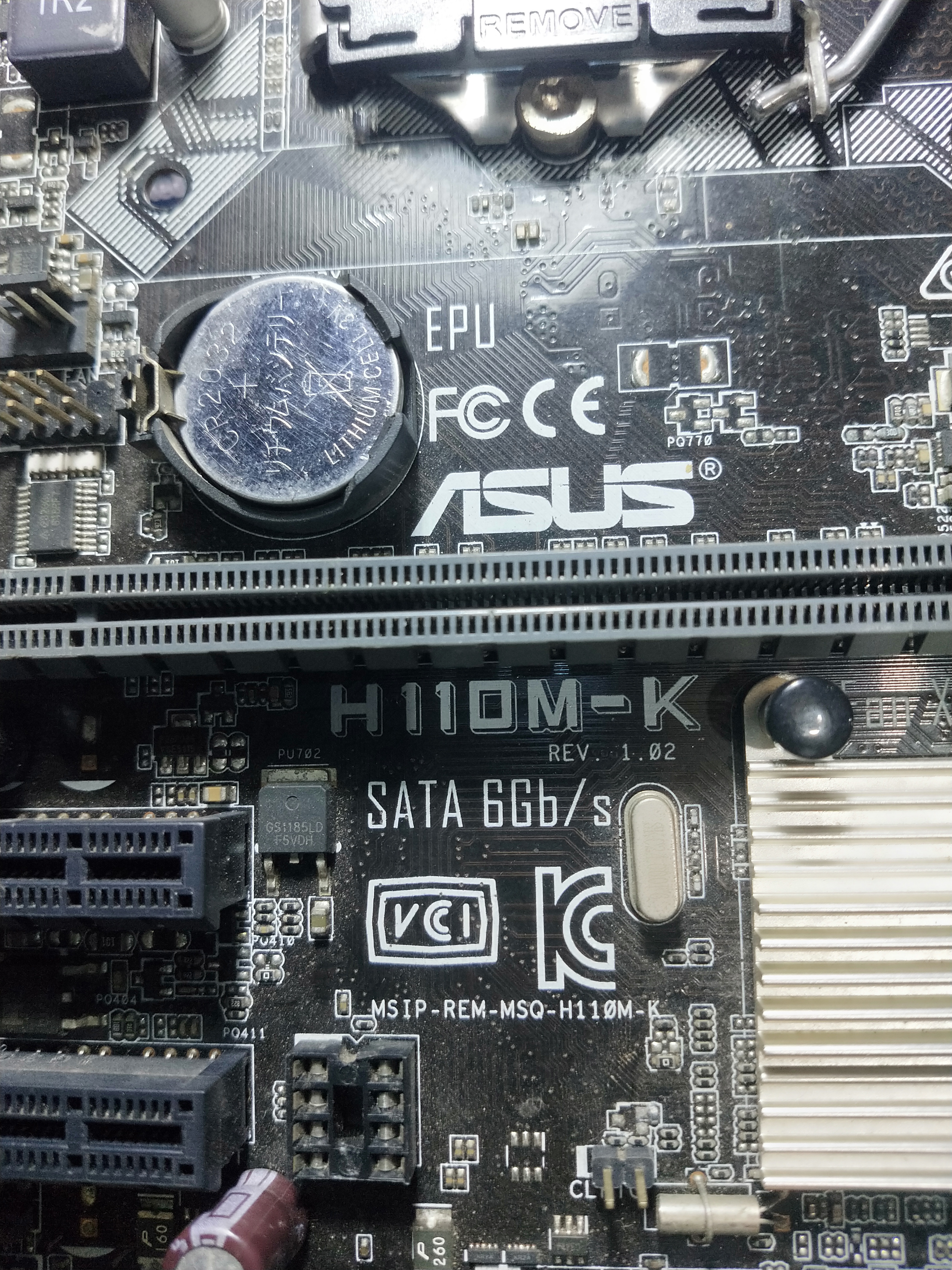

            hi,
            I have an Asus H110M - K (rev 1.02) motherboard got from my friend. problem is someone flashed a stock bios downloaded from asus website. So even I have dumped the flashed bios in it, I can get no info like ME, mac, uuid etc..... After reading countless posts and guides I have learnt that I need them an im novice Hence posting here.
            Here is the dumped bios attached.
            So can anyone give me a proper bios for this motherboard ?
            And photos of the motherboard attached too it has some numbers, dont know what is what .
            Click image for larger version  Name:	image.png Views:	0 Size:	22.1 KB ID:	3460716

              If so this means that u have already a stock bios programmed on the board and the data is lost. U can try to program the missing data to a stock image with FD44, the data is usually to be found on stickers on the board or on the motherboard case. However sometimes a board will not work with a stock bios due to some checks in the bios and different Management Engine programmed into the chipset. Try then to load the first stock bios available on asus site, if u see that the board is starting and updating the Management Engine u may have luck. Check if your cpu is supported by the first bios. But unfortunately this not always works as asus not always publishes the real first stock bios on the support site. The real first bios for asus boards is some kind post production bios, which has the capability to bind the bios with the board and load the Management Engine into the chipset. This works only for asus.
